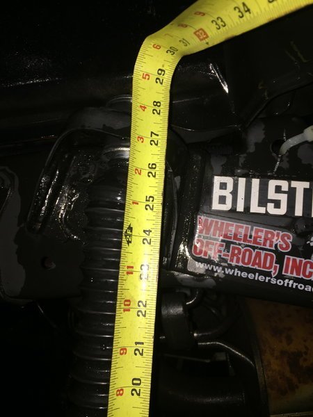

    Craig - are you shackle flipped too?

    No issues with the B110's extending beyond the max shock extension length?
    With my OME Dakar leaf pack + OME 29 XL AAL, I seem to have maxed out my B110's.
    I'm afraid that the shackle flip may go beyond the shock full extension length

    He doesn't have the 29XL AAL. Not sure of that's the cause of my full extension and that he doesn't have the same problem.

    The extra AAL leaf was to provide additional suspension compliance and improve the droop. Didn't need the 2nd Overload because I don't routinely carry heavy loads.
    Adding the shackle flip, which also does the similar thing, just a different way of doing it. With BOTH, now it's gonna go beyond the max extension of the B110's.
    That's just a theory of mine, of course.
    Check out pic below. Already at max extension 27.25" with Dakars + 29XL.
    Where do think the extension will be after adding the shackle flip to this setup?
    Theoretically, the shock rod would pull out of the shock body.

    Shock relocate yeah! Then I would need to change out my 1 month old B110 Bilsteins that replaced my 3 month old 5100 Bilsteins with a longer quadruple priced Icon or King.

    How close to full compression are you when on your bumps?
