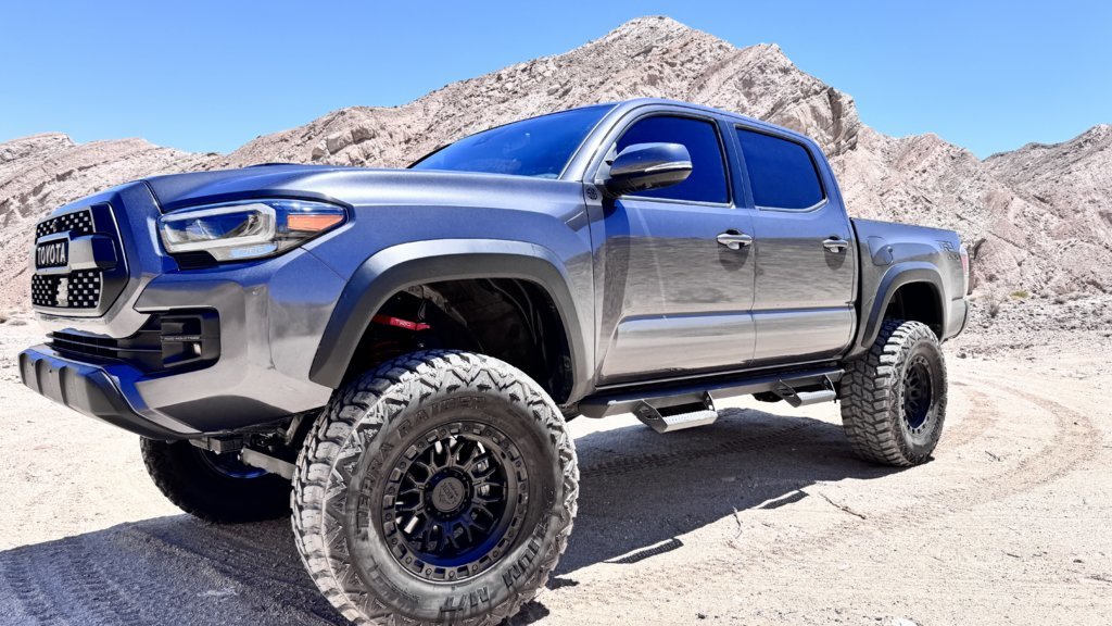

    It's 2025. I just had mine permanently disabled for $200.00.
    They programmed the system to turn off on ignition. The other option was to fry the system rendering it useless.
    My Tacoma had a 6" lift with 35's. Best Tacoma I've had. The PC would shut me down anywhere and it was dangerous. Couldn't turn off truck to turn back on.
    UPDATE AUG-30-2025
    Pre collision still going off even after it was programmed OFF on ignition. Toyota showed me how my SPRINT BOOSTER was causing all the chaos. See video.
    https://www.youtube.com/shorts/T347yICu2eg
    I was changing Sprint Booster settings while still driving, you're supposed to be completely STOPPED when modifying anything. I removed the whole thing just to be safe and Tacoma is 100% back to normal.
