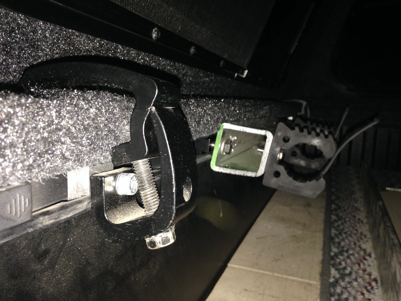

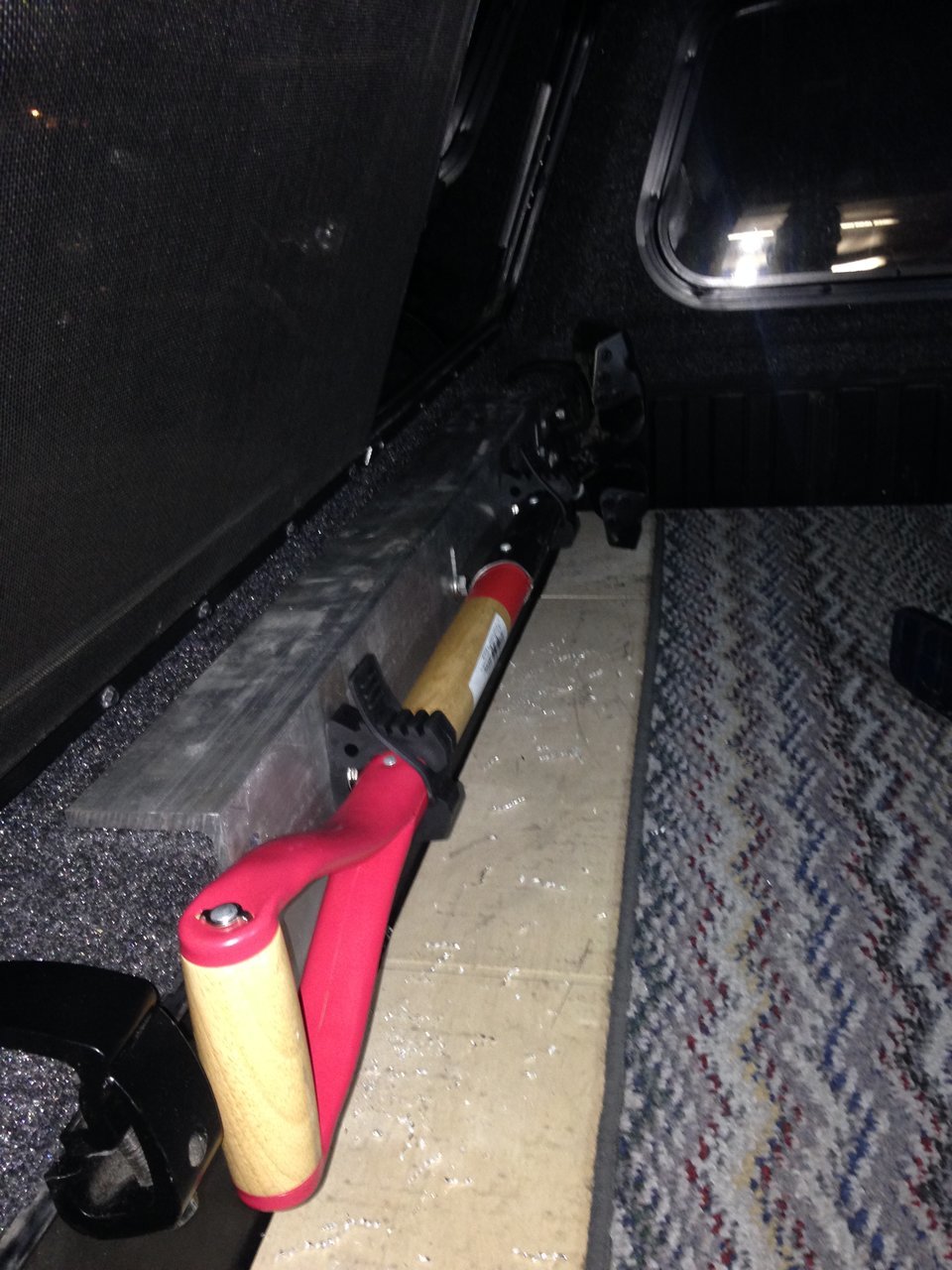

    Wanted a way to mount shovel/axe out of way in the shell.
    First attempt w/ square tubing: fail
    Too much force on lip of shell forcing it to break the seal.

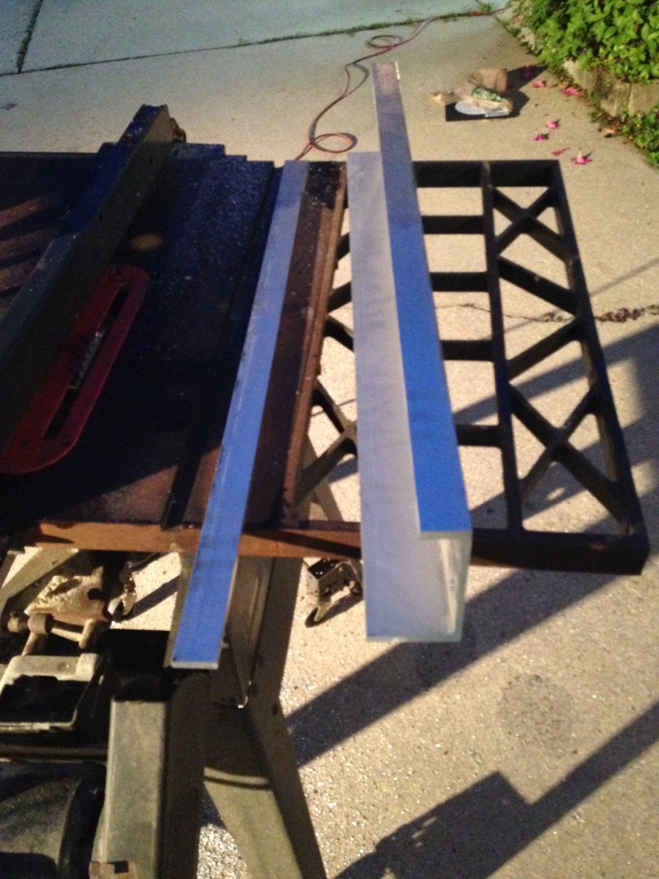

    2nd attempt: success
    Chunk of aluminum channel I got from work.
    Cut down one side w/ table saw.
    Allowed the top lip to hang on the shell ledge.
    Sorry for crappy photos.

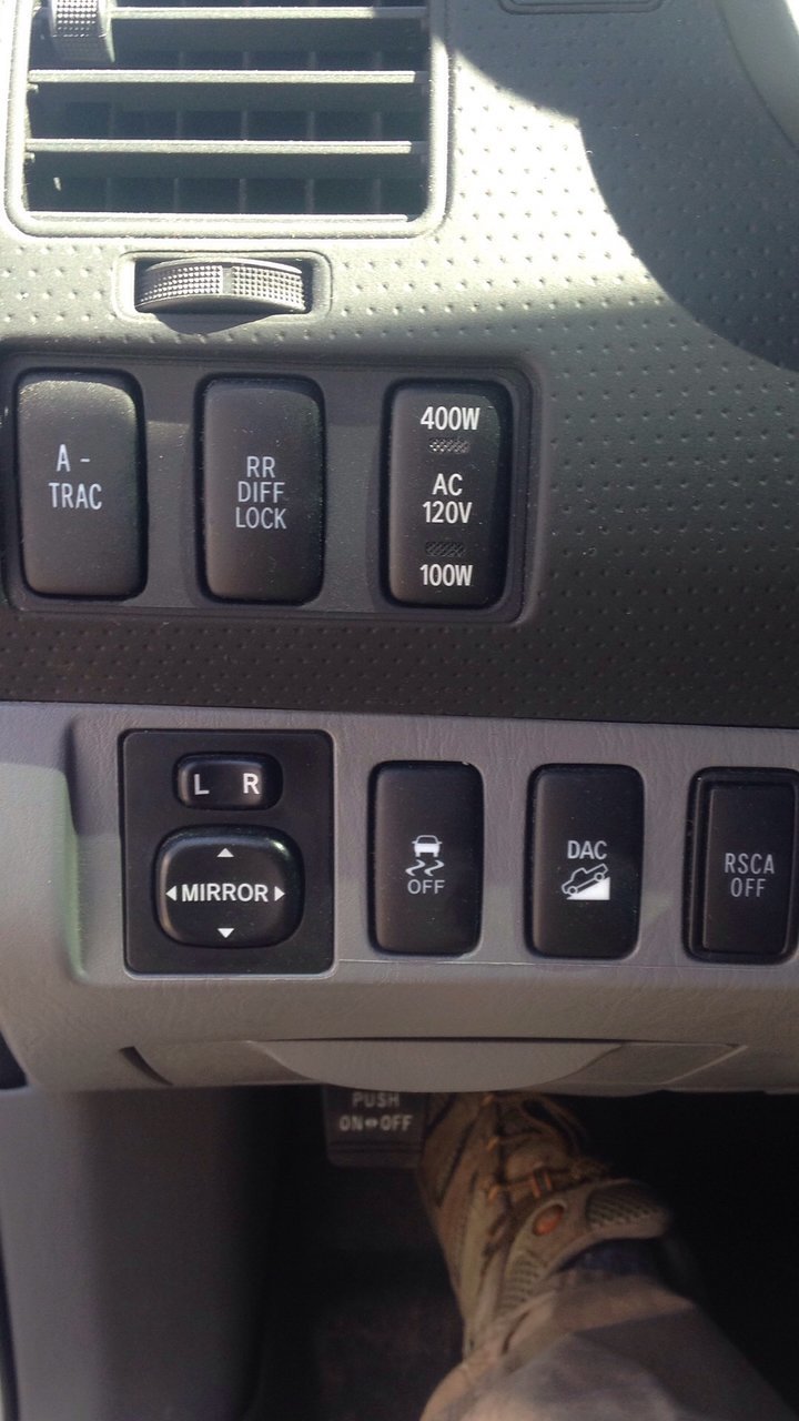

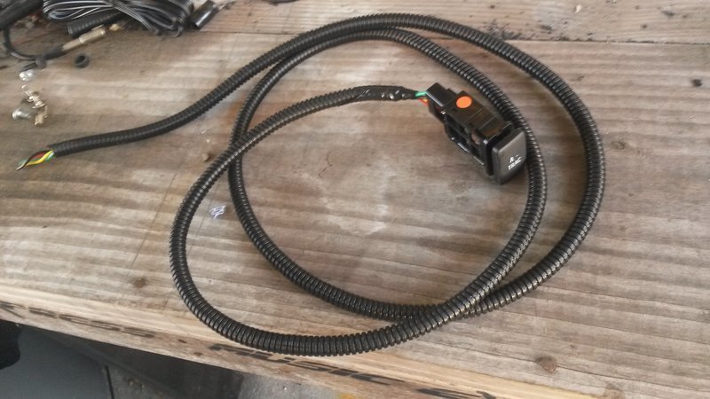

    A-trac switch switch relocate. One of my favorites.
    Lost photos of the wiring...fucking iPhone.
    Acquire OEM FJ A-Trac switch
    Step 1) remove OEM foglight switch to create blank for new switch. I simply jumped the wires the switch connected and tucked them back in the dash.
    Step 2) Swap light bulbs from Taco switch (Taco/green vs FJ/Orange)
    Step 3) create wire harness (4 wires)
    Step 4) remove Taco A-trac switch
    Step 5) cut off taco A-trac plug (do this, I attempted to splice into the wiring and it only caused issues)
    Step 6) solder new wiring harness into Taco harness (these are the photos I lost, I have a diagram of what connects to what somewhere)
    Step 7) run new harness, connect plug
    Step 8) enjoy all you driveline options in one location.

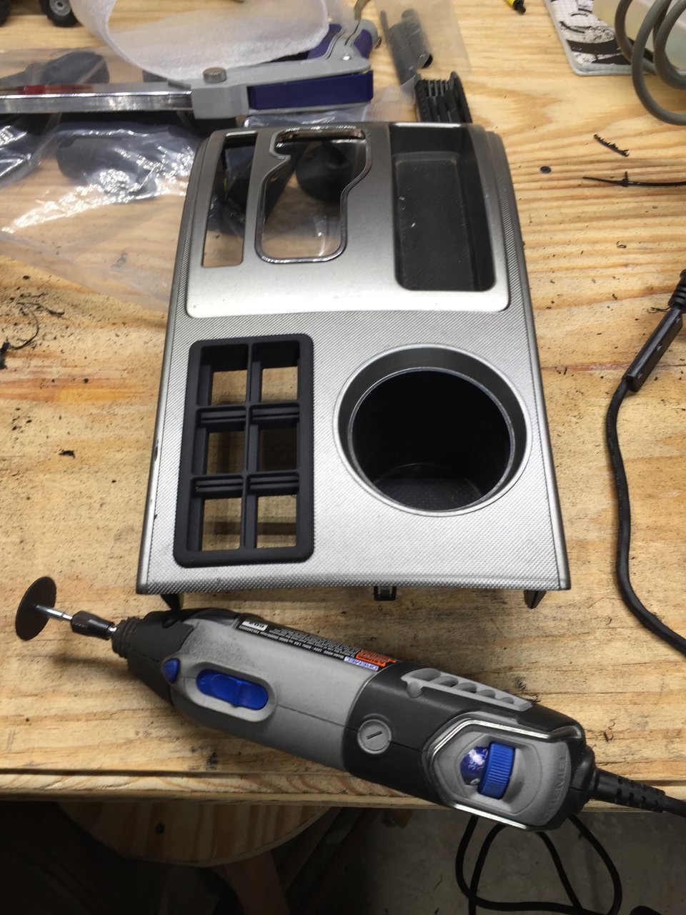

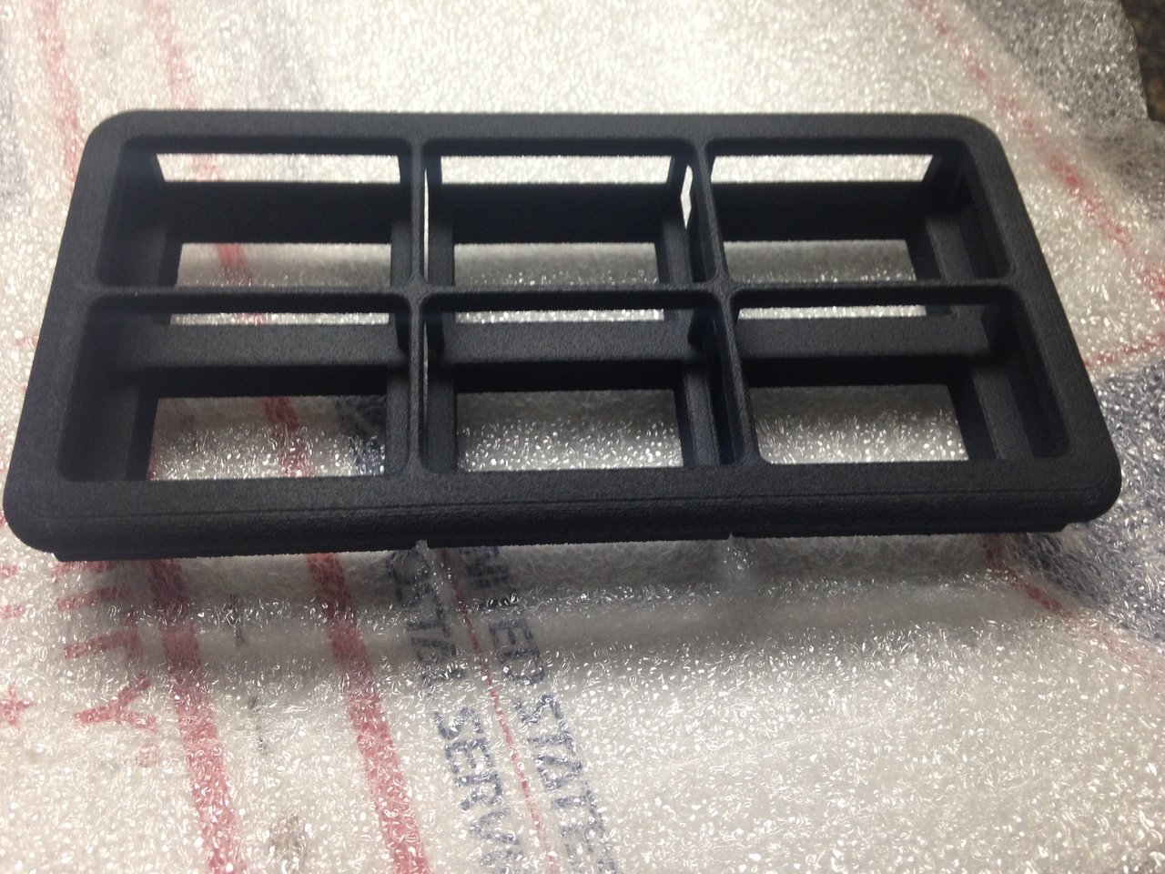

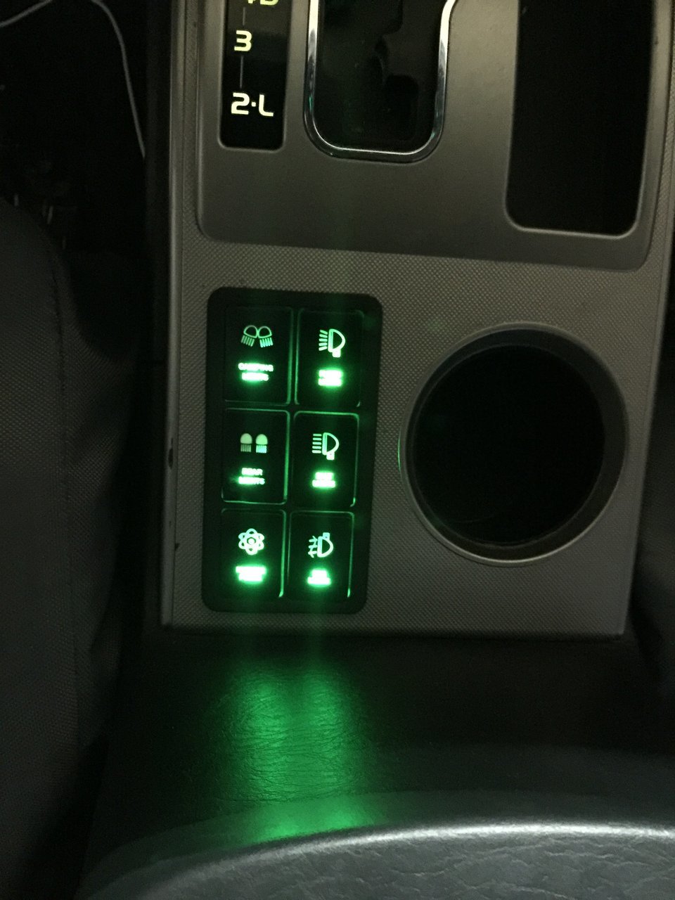

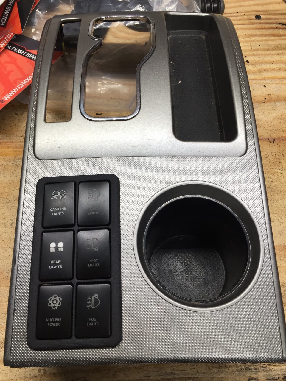

    Decided to relocate all my switches within arms reach.
    6 switch panel from @docloco.
    Switches are from AirOnBoard & CH4X4

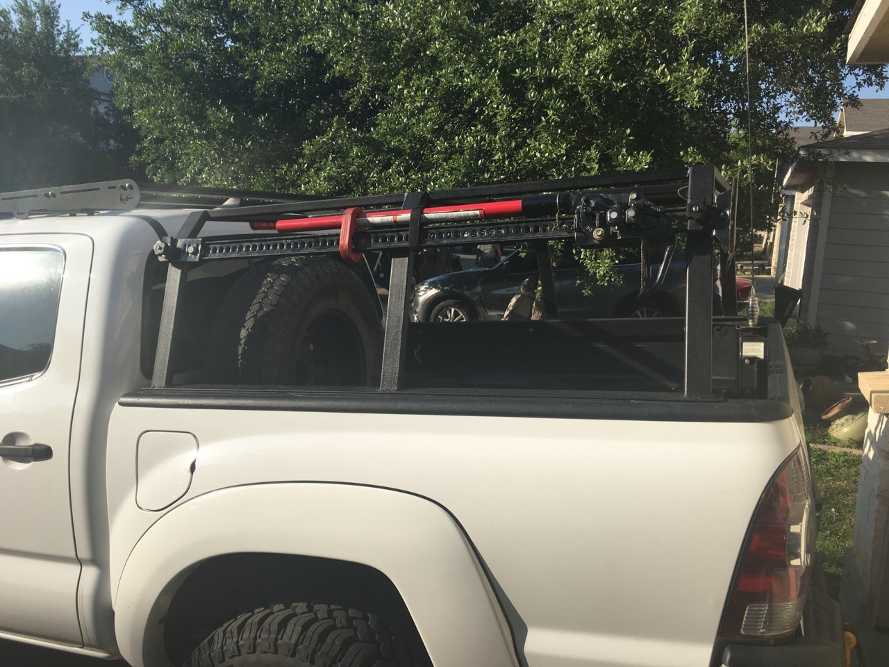

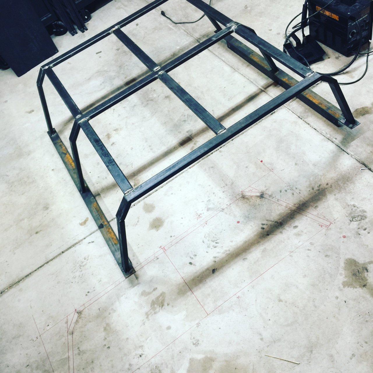

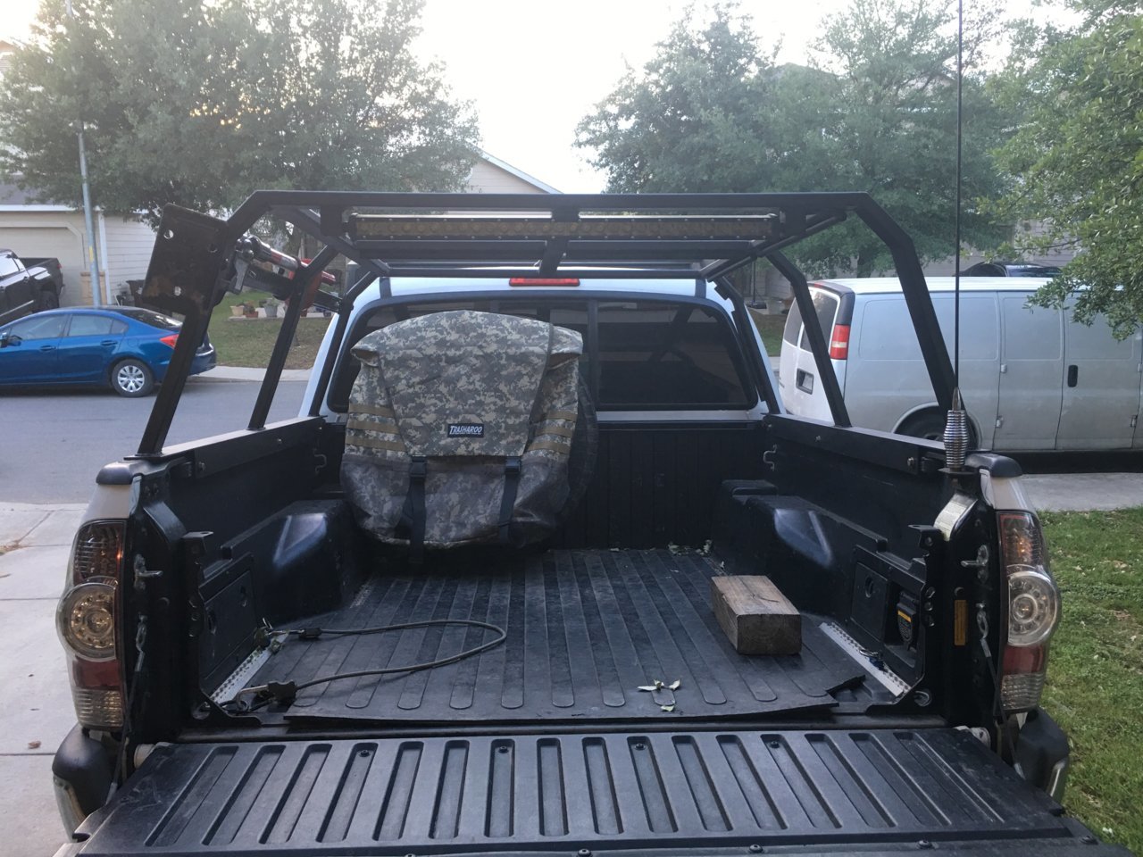

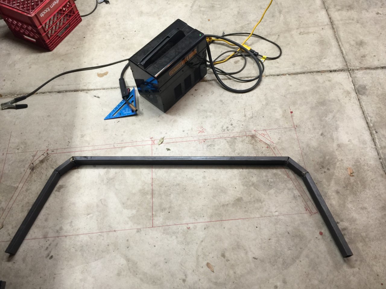

    Learned a few new tricks.
    IMG_E3072.jpg IMG_3075.jpg IMG_3099.jpg IMG_3082.jpg IMG_0034.jpg IMG_0029.jpg
