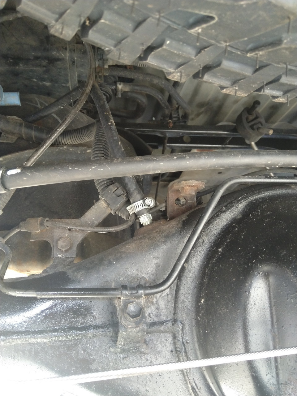

    The Toyota part num for the breather is 90930-03031. You can also do a breather relocate that will route the breather valve higher up in the bed to keep it from getting clogged. I routed mine up behind the fuel filler neck. That job requires:
    Toyota P/N 90404-51319
    6ft of 1/4" ID fuel line (expect a tight fit)
    Dorman 924-284 (could use the Toyota one, but Dorman is cheaper and works)

    If the breather clogs up the pressure buildup forces oil out of the seals. If the axle bearings are worn out then replacing seals is no good without first replacing the bearings.
    The leaking oil removes the grease from the axle bearings and they start to wear down more quickly.
    You can just clean the breather without replacing it. It is just a pretty simple part, you can spray it out and blow through it to make sure its clear then put it back in.
