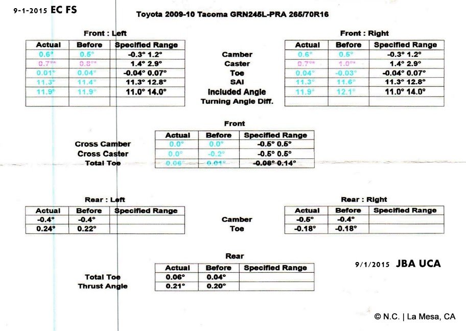

    Now it makes sense...
    It's because cross caster is 0.7*, indicating a difference between the sides. That's why you feel the pull, IMO. I'd recommend getting another alignment.
    Really good techs will try to get both sides to match, although it's quite difficult.
    An example of one of mine from last year.

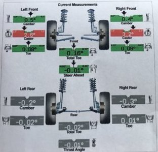

    I usually stay away from 4wheelparts, but they got my alilgnment spot on. I would reccomend them for alignments, as they mainly deal with lifted vehicles. They also have more experience with adjustable UCAs, when some other shops dont. Just my 2cents.

    Mine is off by .6 (2.6 and 3.2) and drives straight as an arrow. Some shops do this intentionally to account for road crown.
