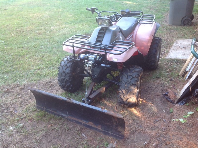

    Hello fellow CT'er... You won't find many on here that advocate a snow plow. But those that actually have one on their Tacoma and use them have posted that they like them. Obviously you'd have to plow with the storm if we were getting the 18" that we got two weeks ago. The biggest issue with a plow, for me, isn't the added stress of plowing itself but if you use it as your daily driver. A commute across town with the plow up isn't too bad but if you have to go any distance, that weight flopping around (CT roads aren't the smoothest) it'll stress the front end. Which one to get is all about personal choice. I looked at Fisher, Myers, and Sno-Way. I think Sno-Way has a hydraulic down which is nice for back blading. There's a bunch of truck equipment places in the state but I know the owner of Ron's Automotive in Litchfield. Good guy. FWIW, the old Toyota trucks were popular plow trucks and they had the 22R 4 cyl engine. Stop by the New England BS thread or the CT thread in the northeast region area on the forum.
    Edit: I seriously considered one for my Tacoma but I commute daily from Naugatuck to Cheshire and didn't want to try to stop the truck in the snow with all that weight hanging on the front. I bought an old quad and put a plow on that instead for less than half of a plow set up.

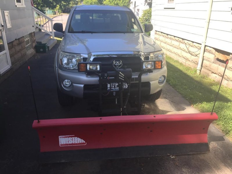

    Pro/2015 Coil-overs n shocks, Icon progressive AAL, Firestone Ride-Rite Air Bags and cradles, ECGS clamshell bushing, Extang Solid Fold Tonneau cover, 2014 Navigation radio and backup camera, Wet Okole seat covers, rcbs204 lighted 4x4 switch, Weathertech digifit floor mats and in channel window vents, Scanguage II, Hayden 678 Trans cooler, Western Suburbanite plow, Pop and Lock PL8521
    I have a Western Suburbanite 6.8' plow. Its a great little plow. the whole setup only weighs around 275 lbs. Its easy to take off when I dont need it. Fisher Homesteader is the same thing just a different color, I think Fisher bought Western. I would highly recommend this plow if you are looking for a personal use plow on a Tacoma. I picked mine up used for a couple grand and its worked great for me.

    how easy are they to take on and off?

    This is true, I almost always do several of my neighbors driveways. But I enjoy it, and I am not racing around trying to get them done so I can get to my next job. I take my time and enjoy doing it. I also did my parents, and brothers house too after a recent storm. I like the convenience of being able to do it myself. One of the bigger reasons I went this route is the city tends to plow whenever. Sometimes after a large storm they may not clean the street for several days. So days after you cleaned up from the storm, the city plows clean the streets and bury the driveway again.
    I dont know what the prices are where you live, but I know you can get a used one installed at a local shop here in Rochester for around 3 grand and it comes with a one year warranty. I only paid 2 for mine and there is currently one for sale on craigslist for 1600. I dont know if it comes with everything you would need for a Tacoma though.

    You could also buy an ATV with a plow. It keeps the stress off the truck, usually costs less and is more fun.
    I married my tacoma and vssman like this.
  14. Feb 18, 2017 at 1:46 PM
    vssman
    vssman Rocket Engineer
    Jun 17, 2013
    #106440
    10,360
    Paul
    Naugatuck, CT
    2013 SR5 double cab
    That's what I did

    Brrrr... I think I'd have some trouble getting this 2 stroke to run at that temp.
