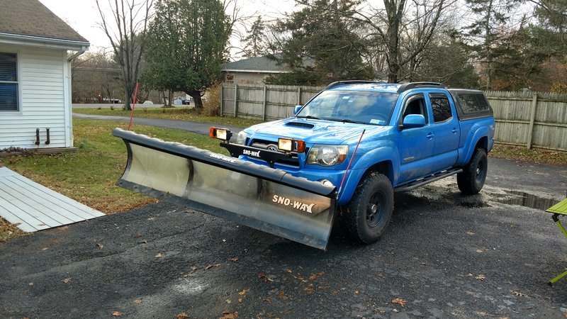

    I'm running a 22 series Sno-Way 7'6" for the first time this year in NY on a 2010 DCLB. No complaints so far. Last 2 storms I had 4 driveways to do including one that involved a lot of moving snow to different areas across the yard since there's nowhere to put the snow otherwise. Granted I tried to stay ahead of the storm since that driveway is also uphill. Bought plow and frame mount on CL and wiring on eBay. Did my own install. All said and done total cost was about 1500 or less including flashing lights, etc. Takes 3 minutes to disconnect - put plow down, disconnect light harnesses, pull pins back away a little, disconnect power, done. (Took almost as long to write that). Sure beats snowblowing for an hour for one driveway alone. That being said, I have a 4.0, not sure I would do it with a 2.7.
