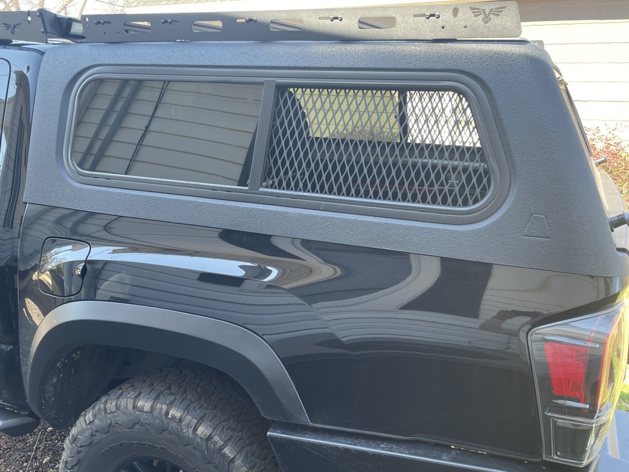

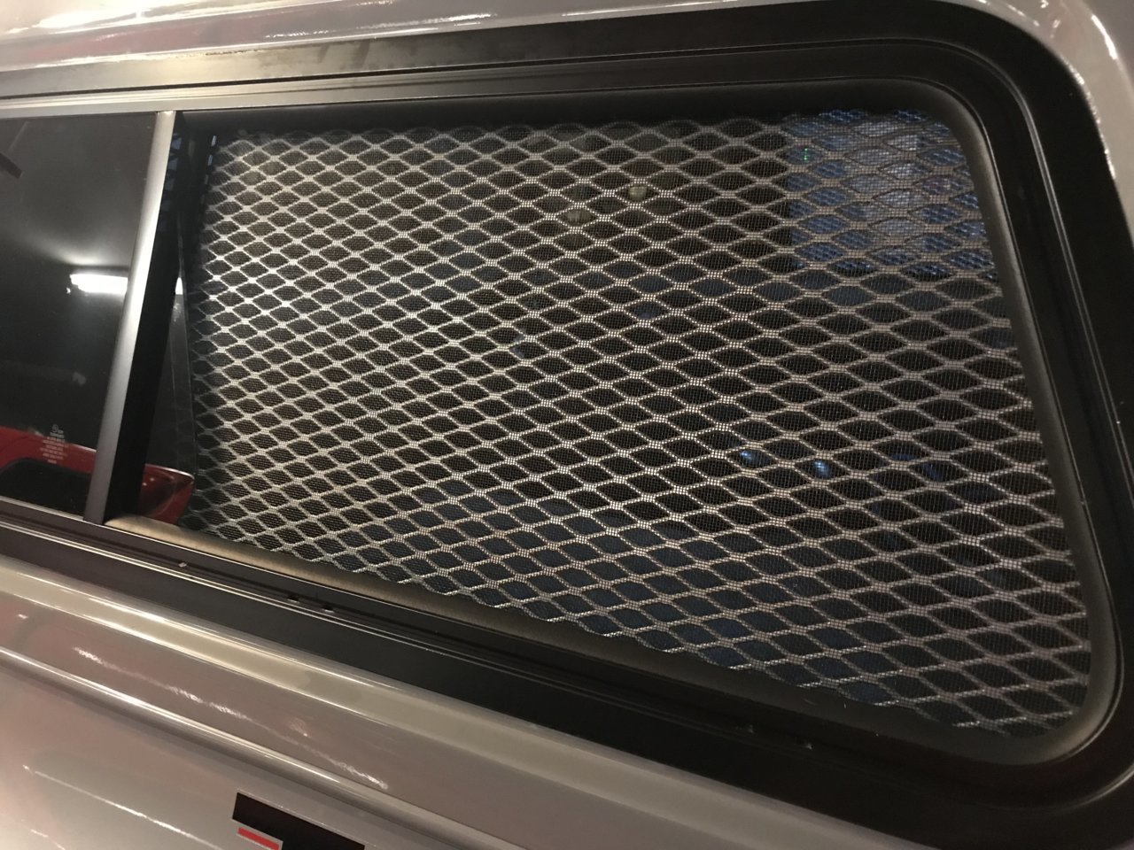

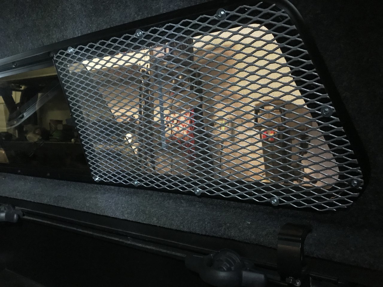

    F1324B24-7976-4358-9DE7-096EA8C79198.jpg 534110B1-241F-4BE2-AD03-3F9CA749057A.jpg I bought a new ARE CX canopy with the optional pet screens. After the first day my dog destroyed one side. So I made my own using expanded metal. It serves as a security guard also. I sealed all the windows at the same time as they both leaked.

    That’s a great idea! I’d like to do my snug top like this.

    Nice. Did you use aluminum or steel expanded metal? Are you going to paint them black or leave them.

    Steel as I have a dog that can destroy most anything. I painted them silver to match the truck.

    .11 or 3/32”. If I were to do it again I’d use aluminum if I could find it.

    Steel will rust and is probably overkill for most. I have to repaint mine occasionally.

    I think I'd have turned the expanded metal the other direction to help avoid the dog getting their nail(s) caught in it. The ex's dogs just liked to shove their nose into mine but I can imagine some dogs may paw at it.
    Gueita- I've had good luck with VHT Epoxy Paint; thoroughly degrease, apply and let cure. This stuff: https://www.vhtpaint.com/specialty/vht-epoxy-all-weather-paint
