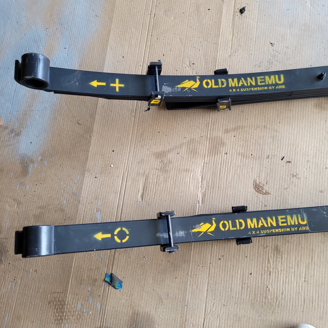

    OME El111R leaf springs.

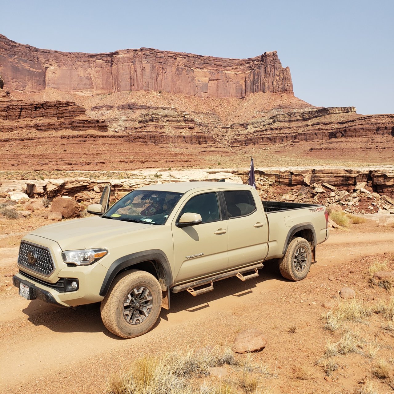

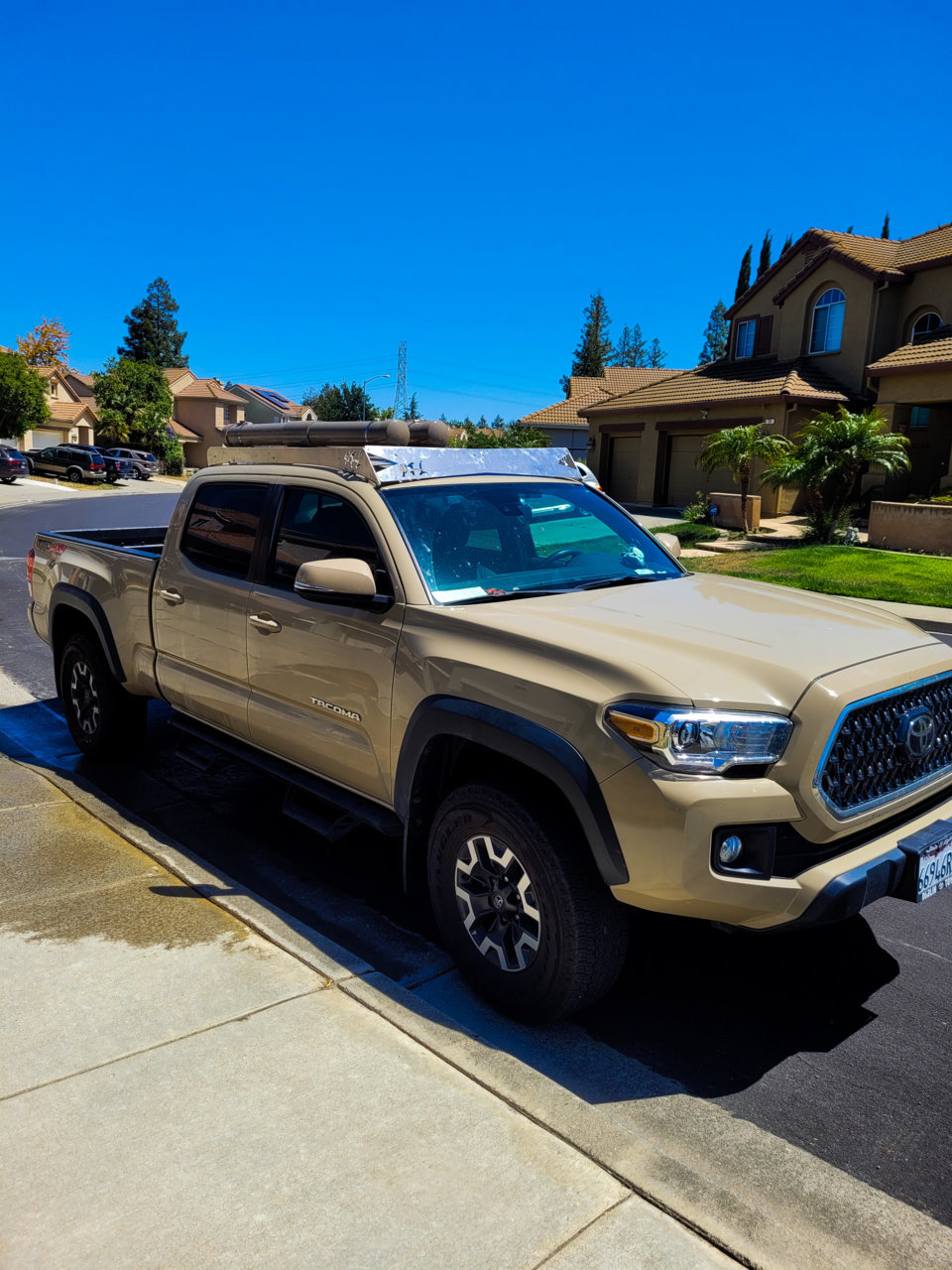

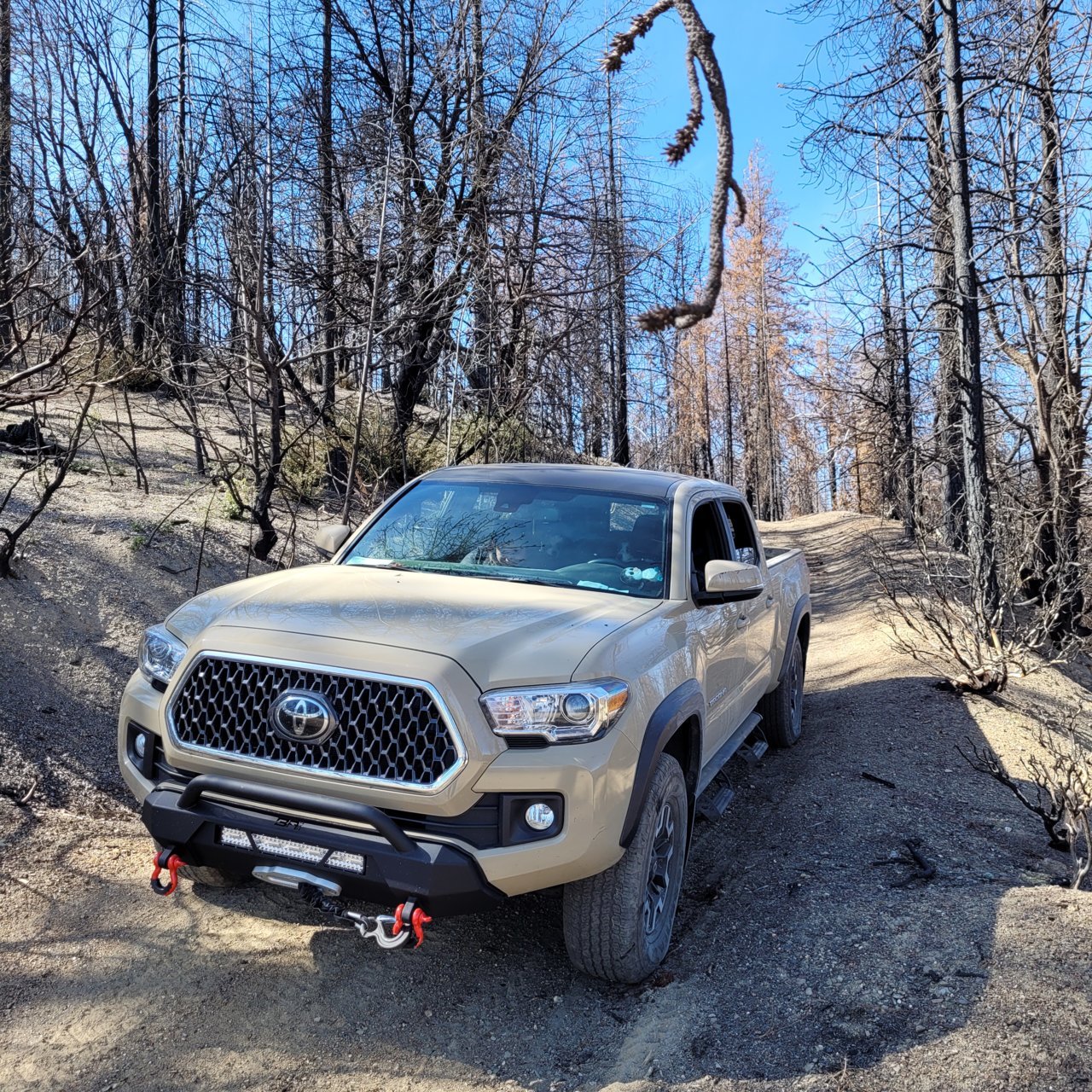

    Took the truck stock down white rim in Utah for some easy trail time

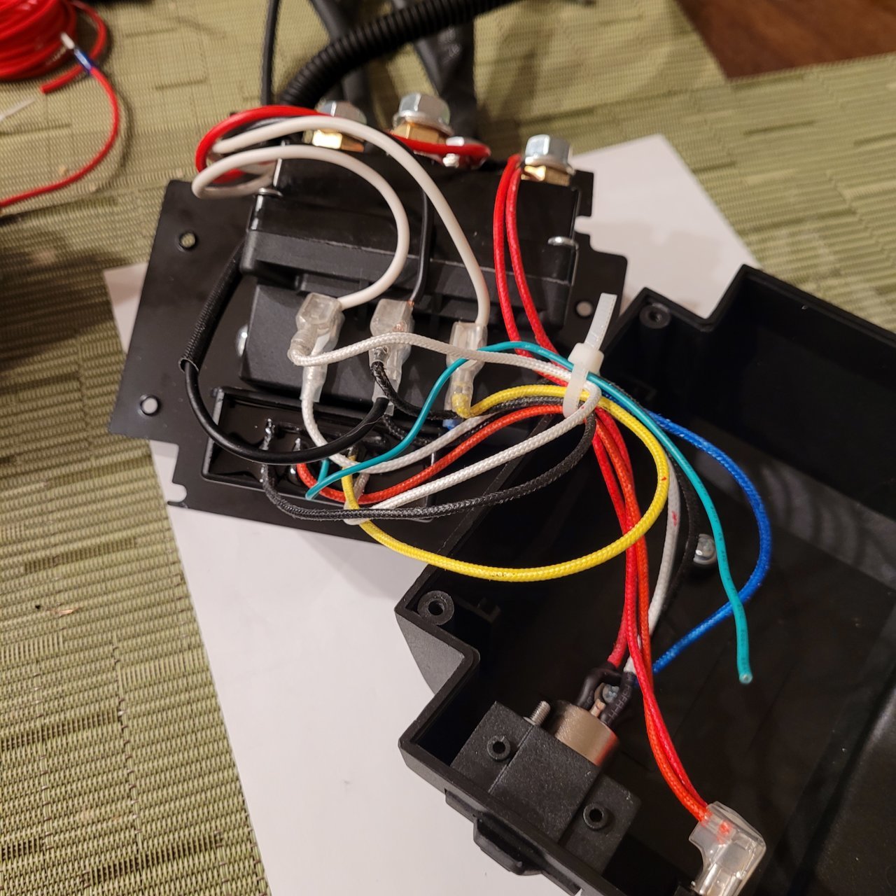

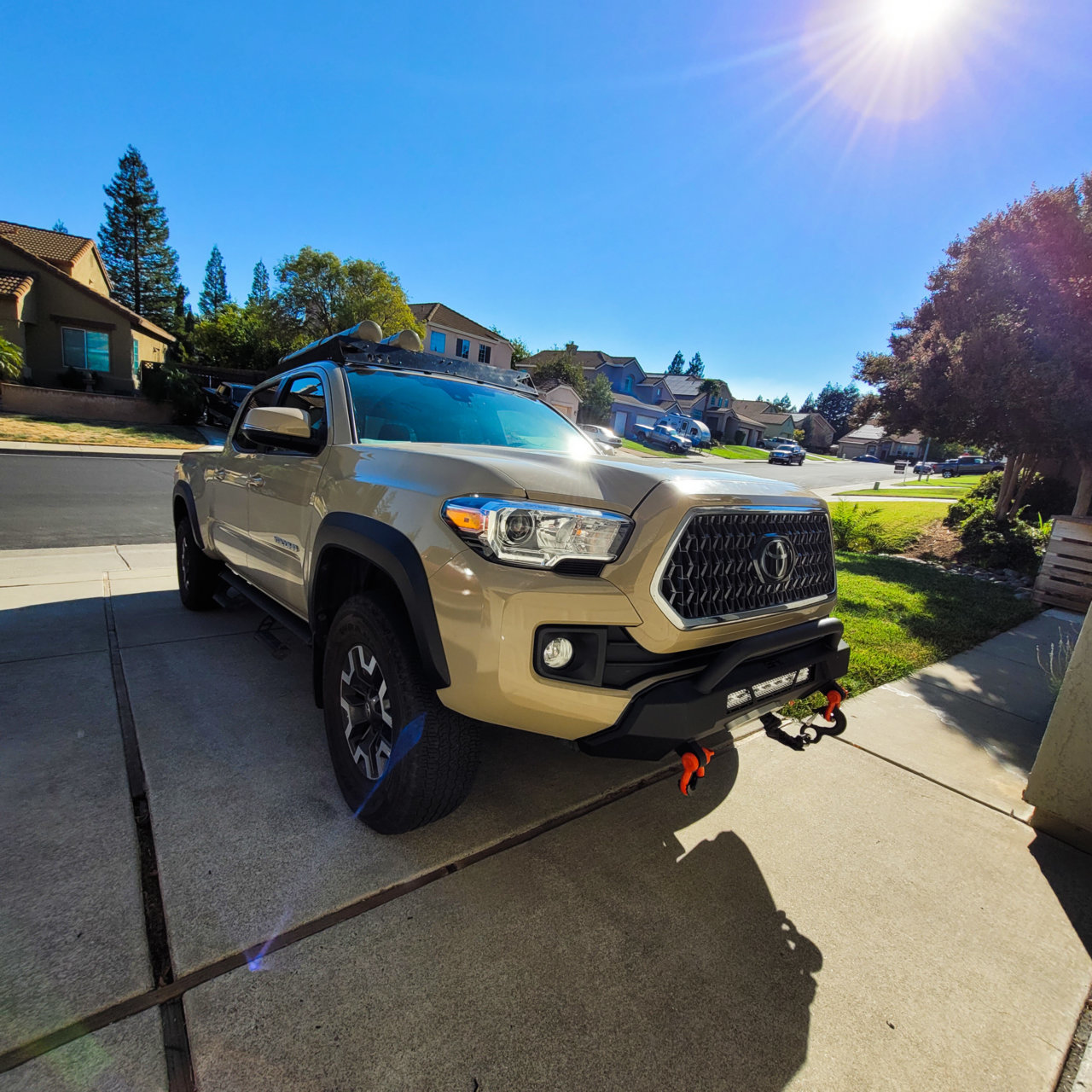

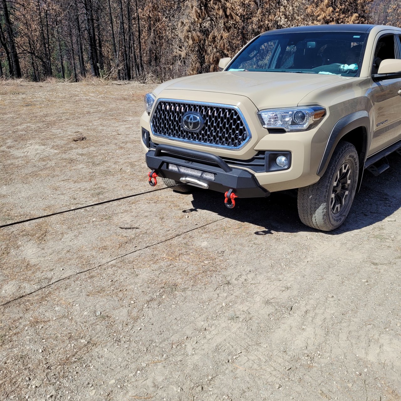

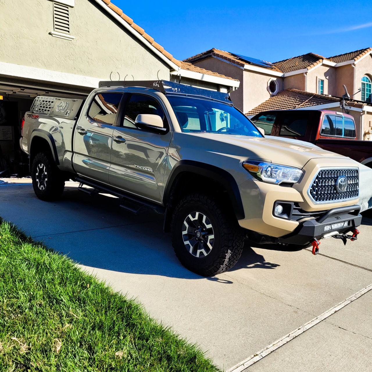

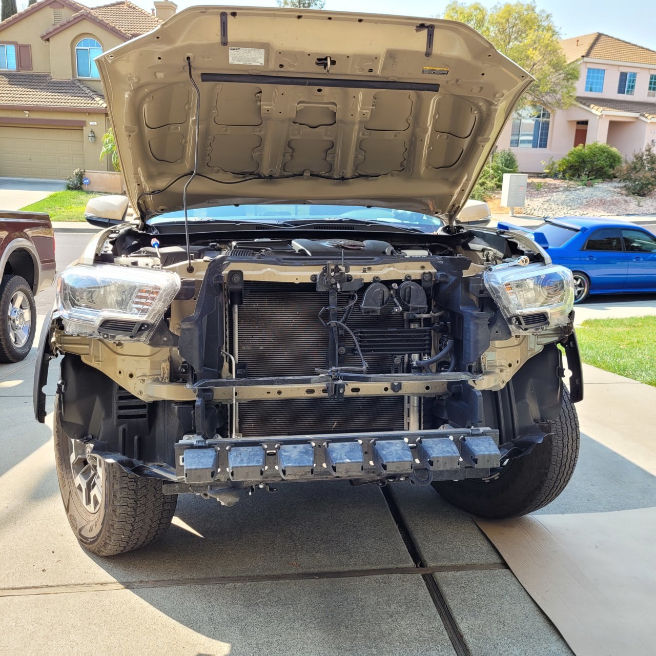

    Body Armor hi-line winch bumper, smittybilt winch and in-cab controls

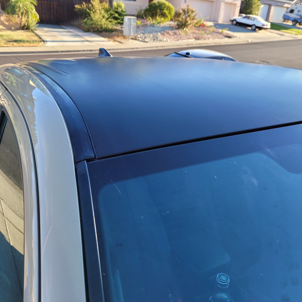

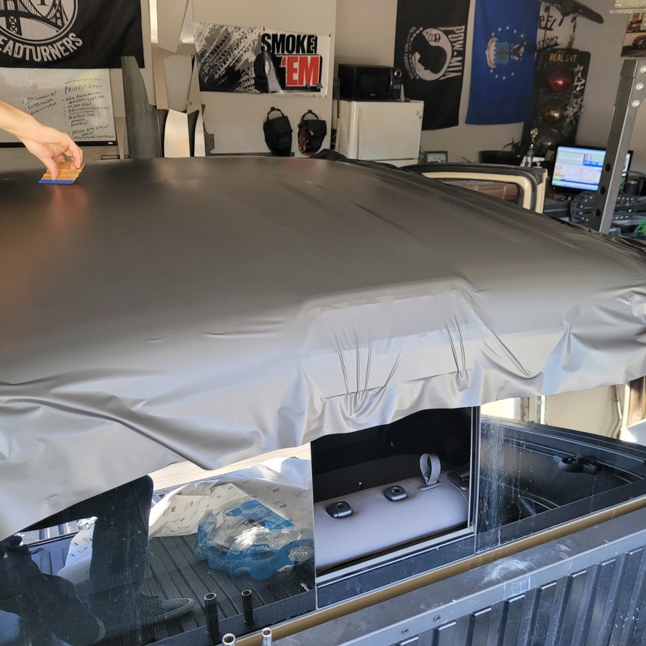

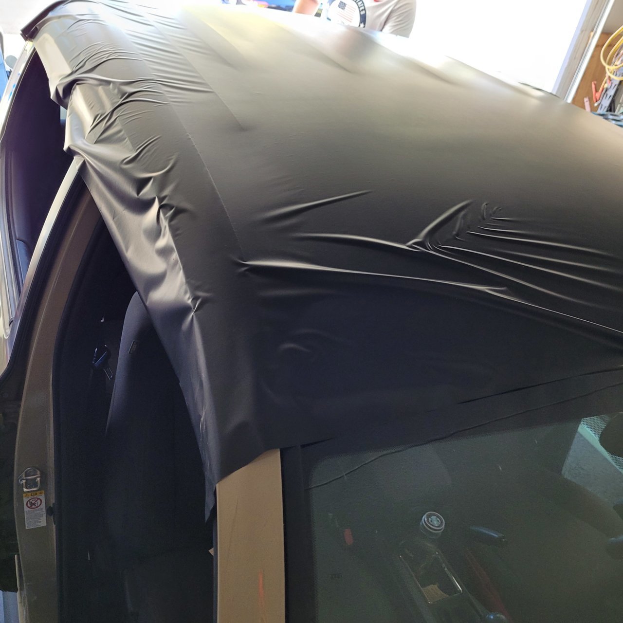

    Matte black roof wrap to go under the roof rack, protect the paint under the rack

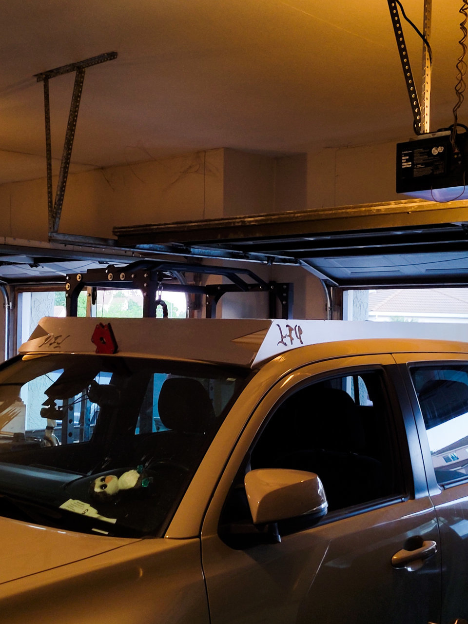

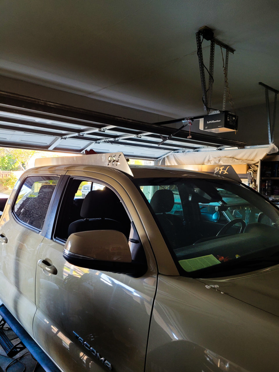

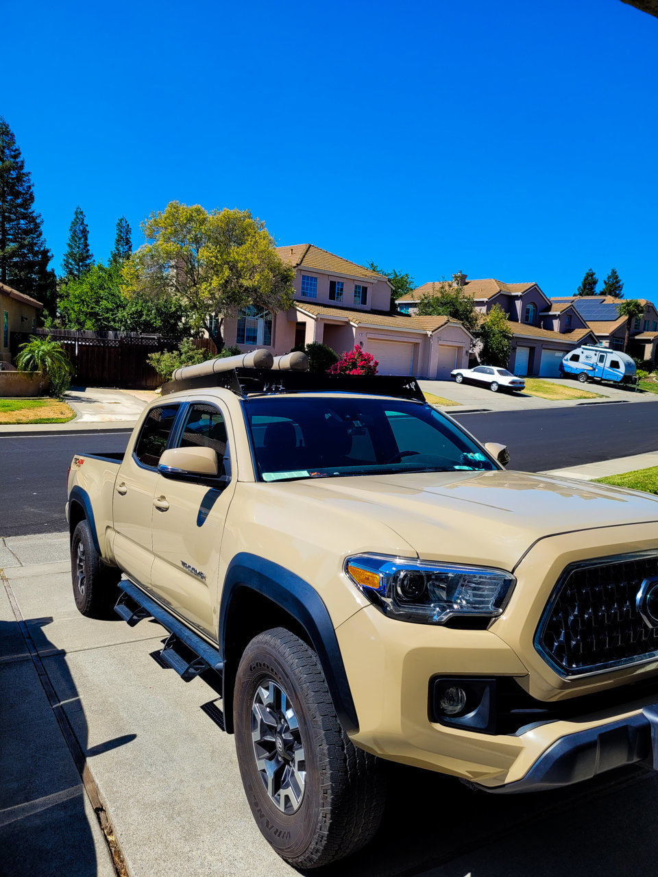

    PFL Customs aluminum roof rack weighs less than 15 pounds holds up to 800 pounds im not a fan of the front plate so will be making a new one with a light bar cut out and adding a lightbar.

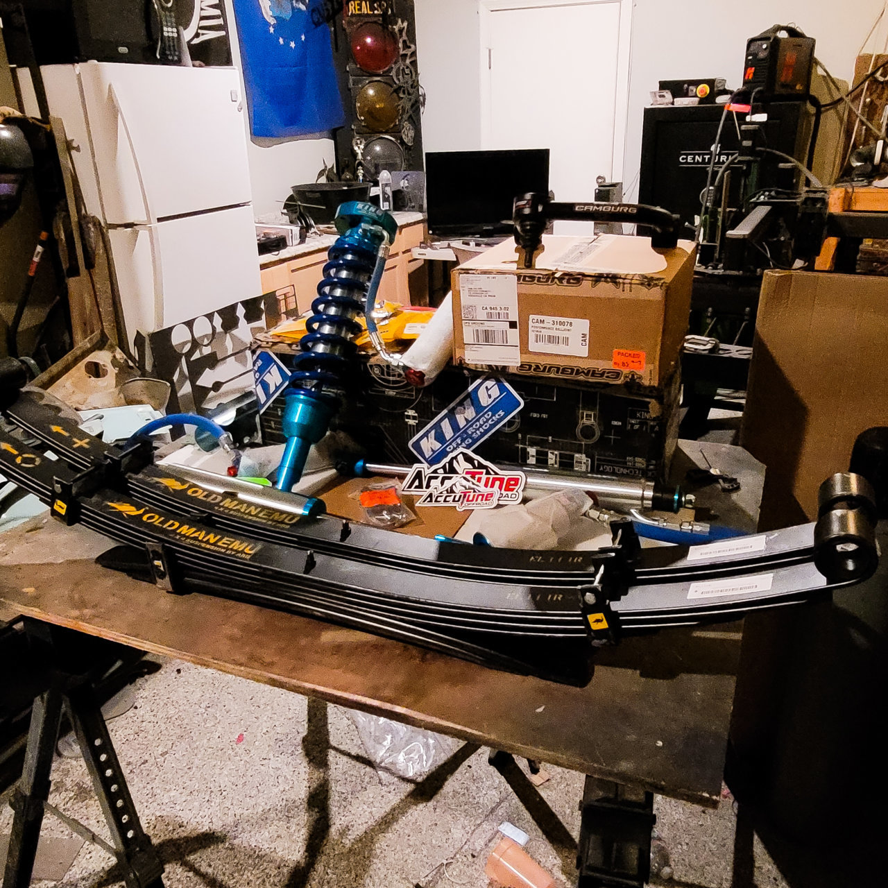

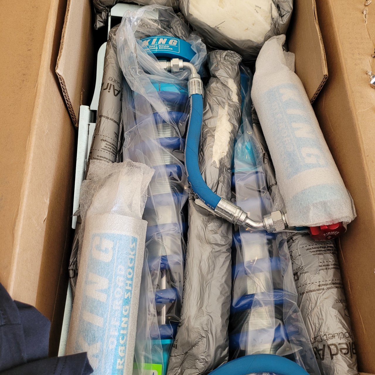

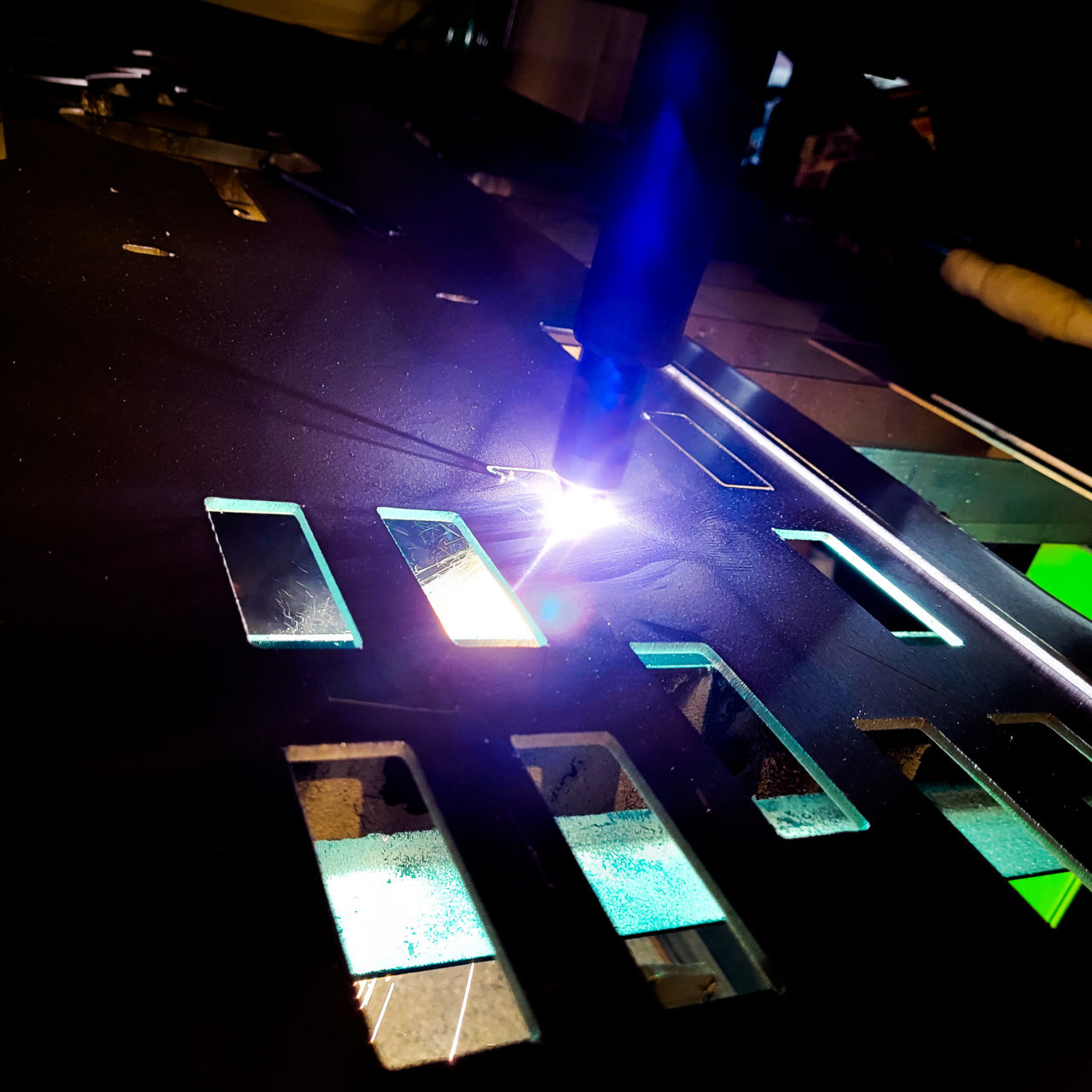

    All the fun stuff

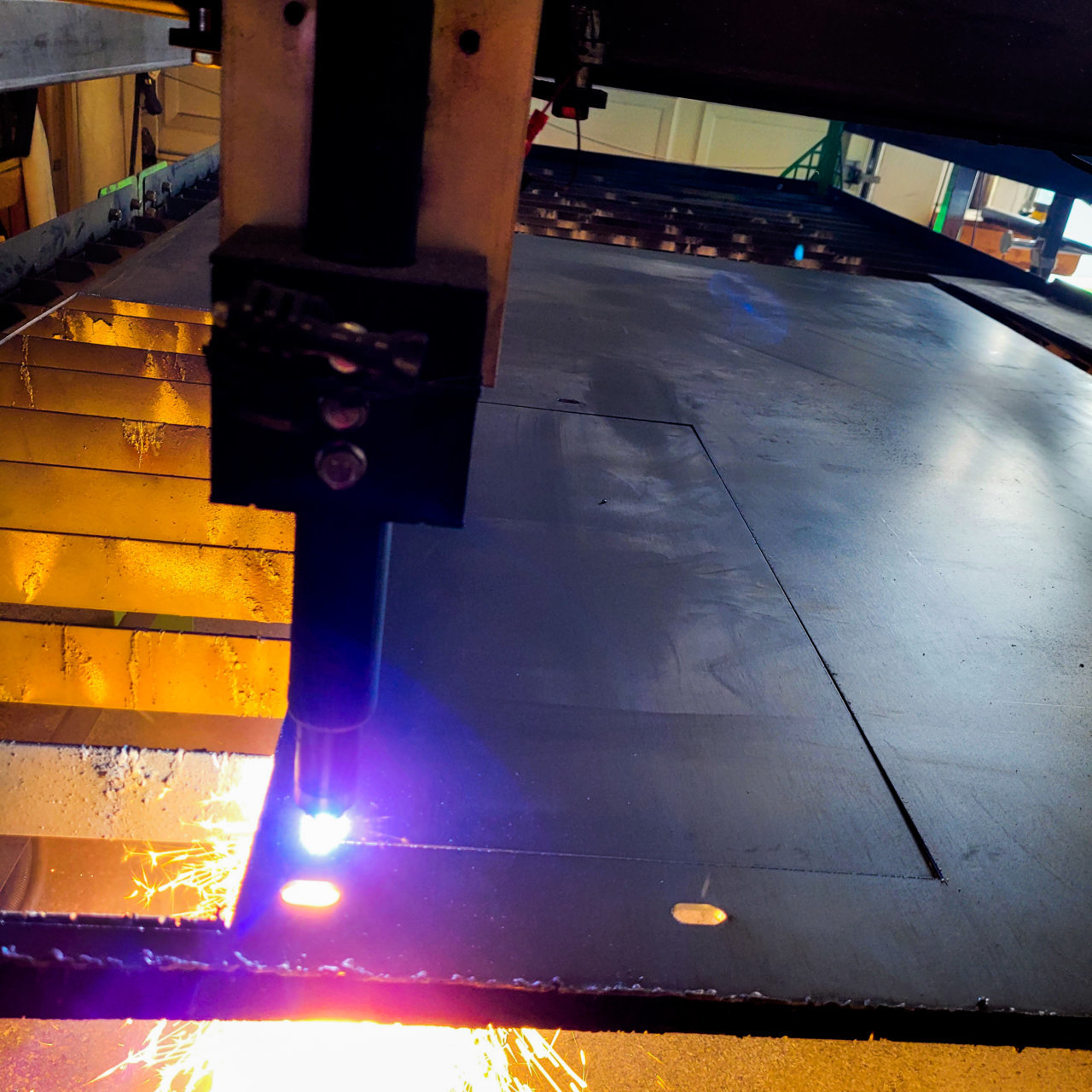

    Starting the bed!!

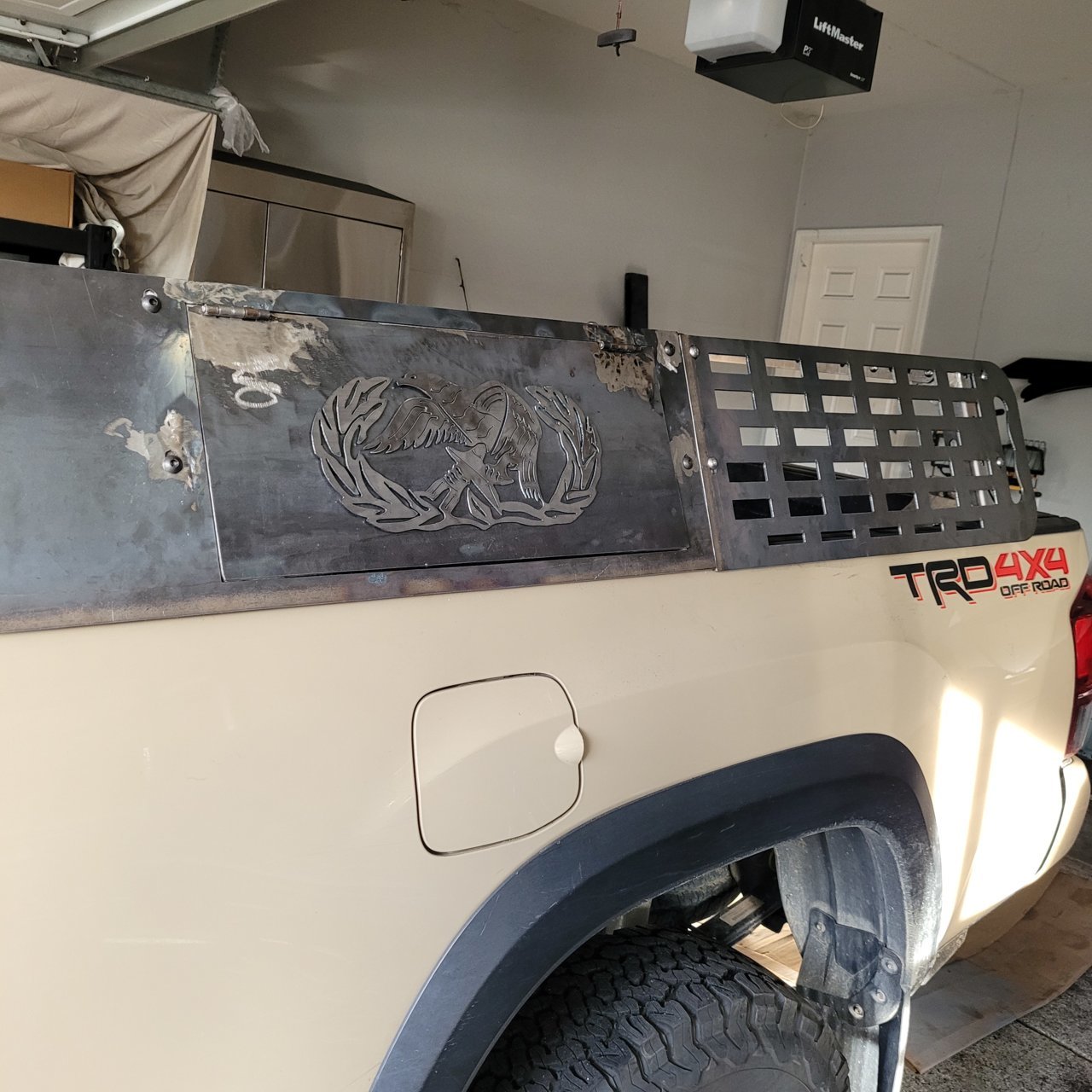

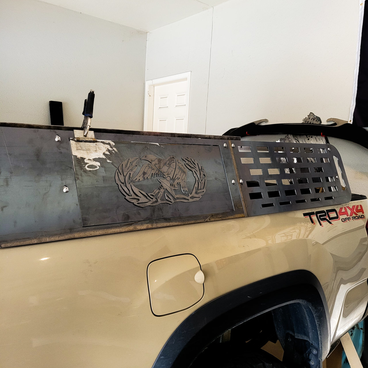

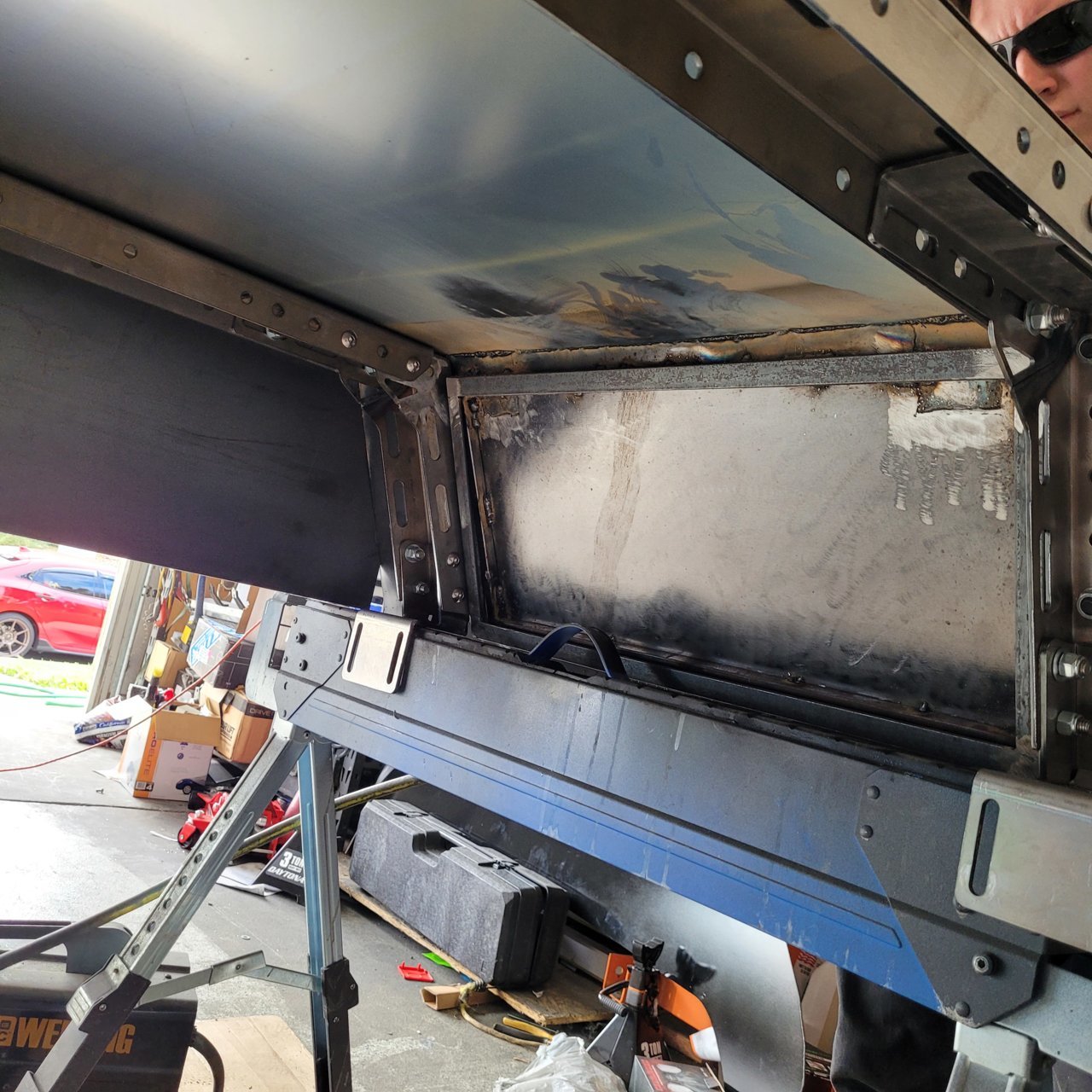

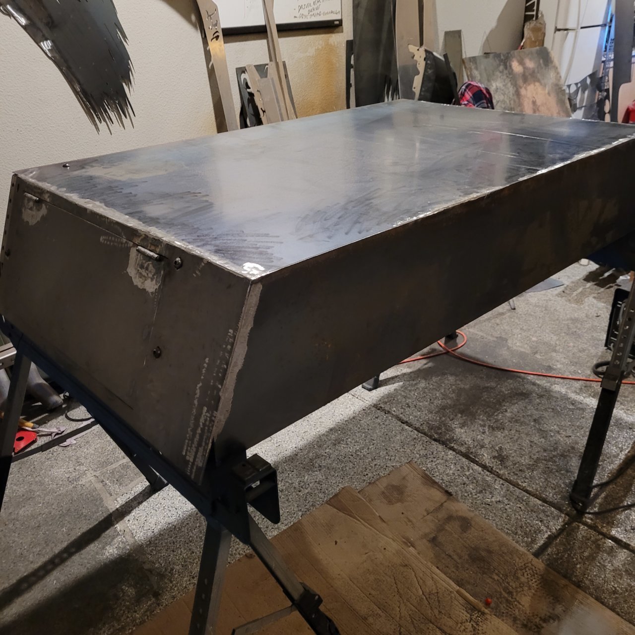

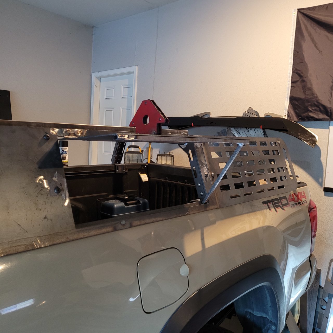

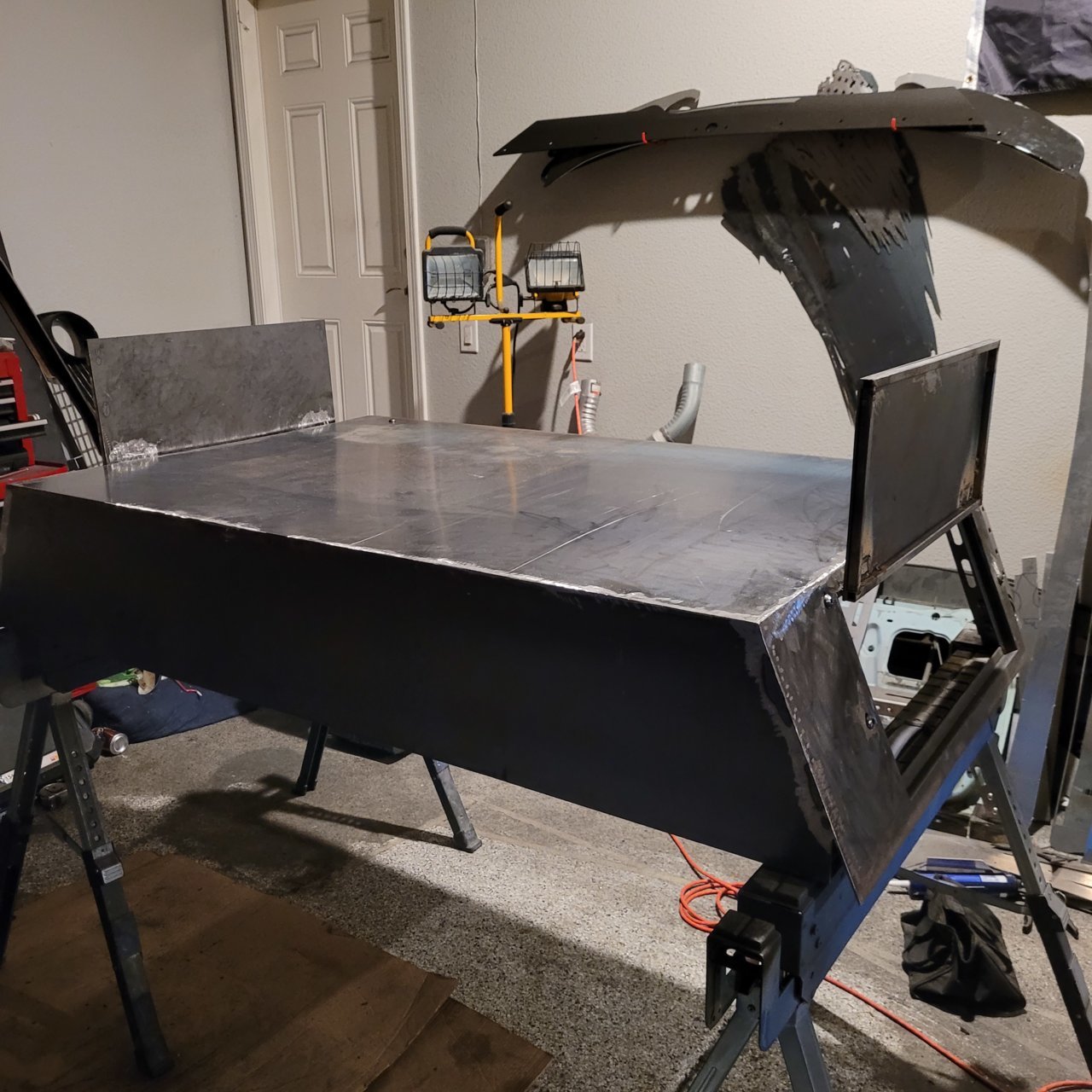

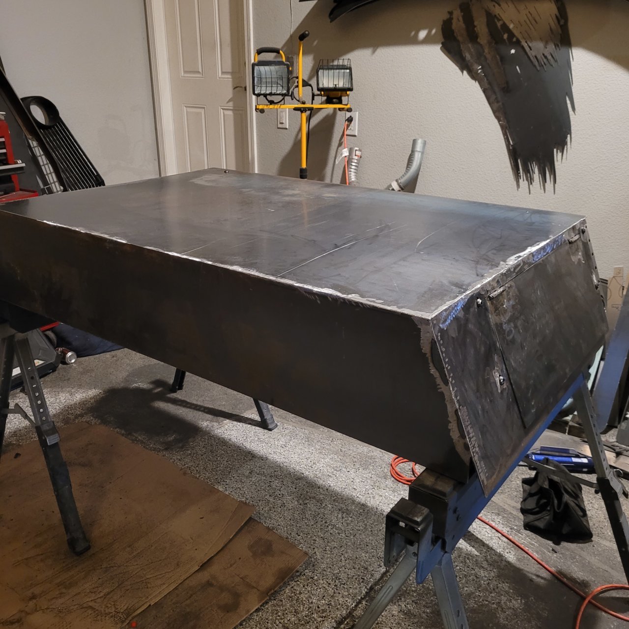

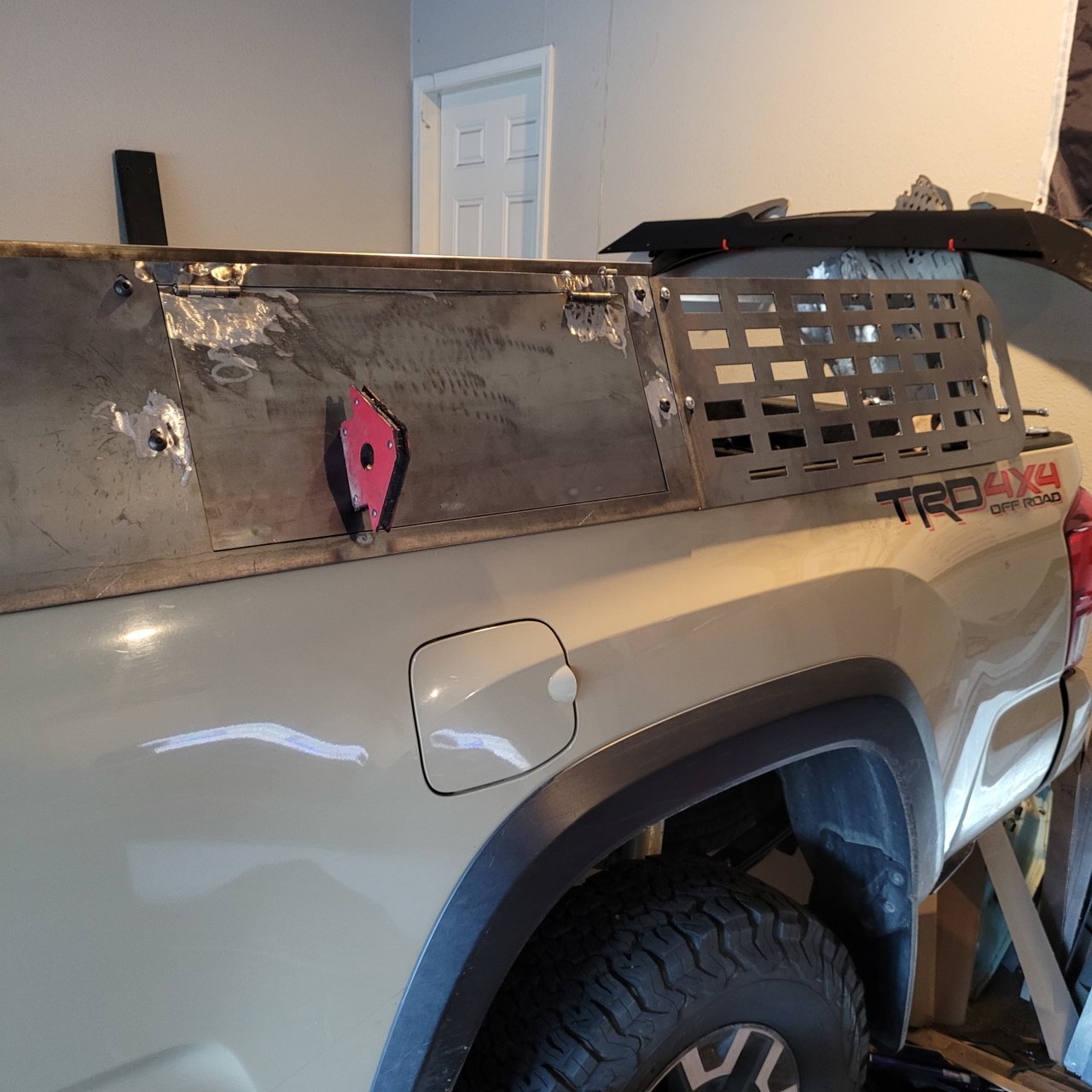

    Front stide of the bed rack will be an enclosed storage compartment, I used weld on hindges, and 1/8 inch steel for the doors, I still have to weld in the drip rails, install the handles and locks but its coming together. After I get the doors done and the compartment sealed up it will be ready for paint prep.

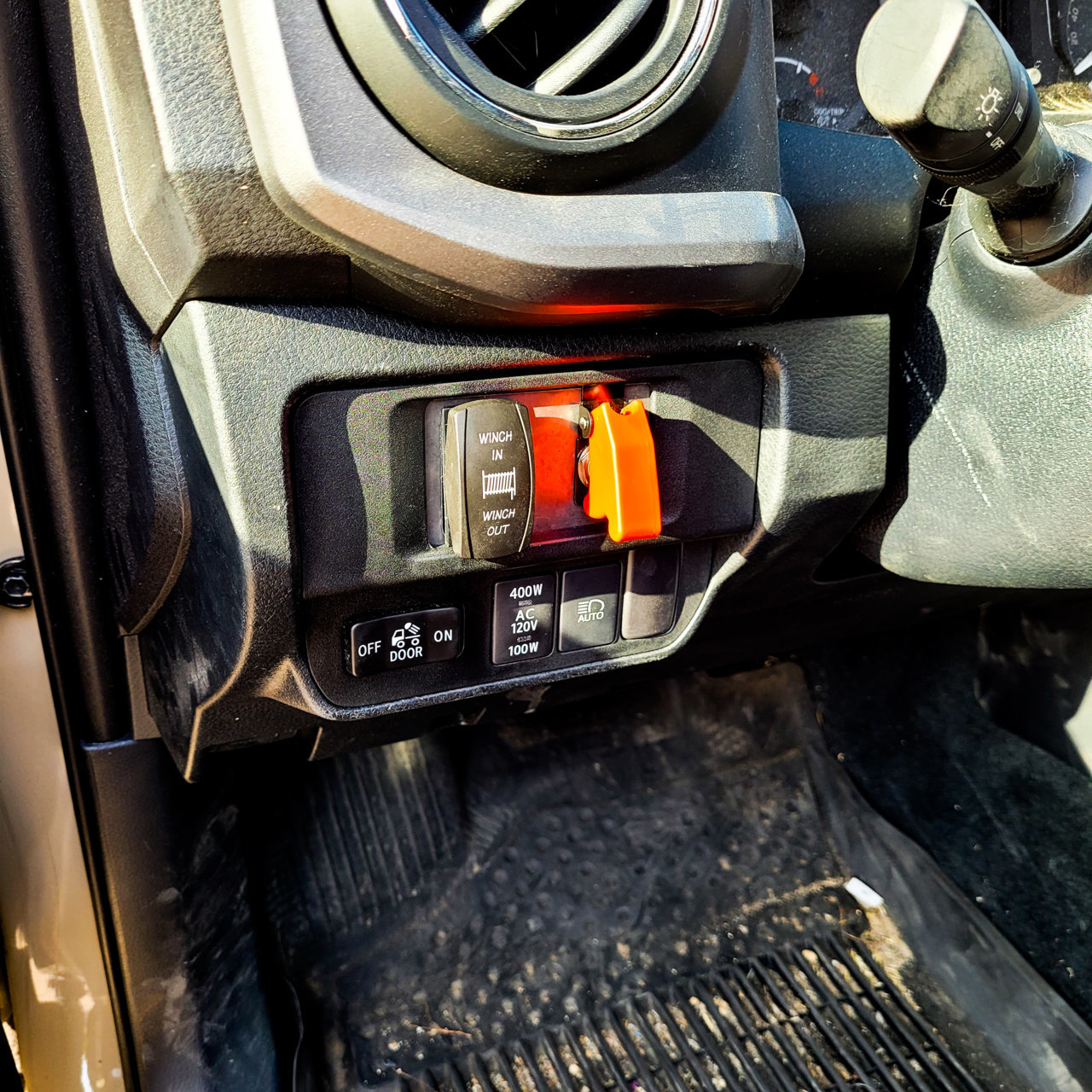

    I am in love with this bumper combo, I do recommend installing in cab switches though since the winch becomes very inaccessible in the slimline bumper. I wired the switches in cab but also wired it so I can use the wireless winch controler as well and never have to pop my hood, also made an extension handle that goes from the front to engage the clutch or free wheel the winch again with out ever even popping my hood

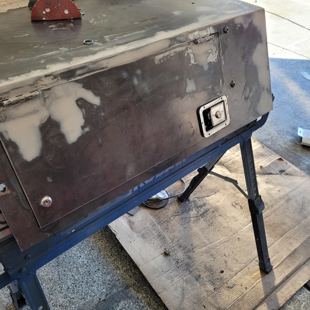

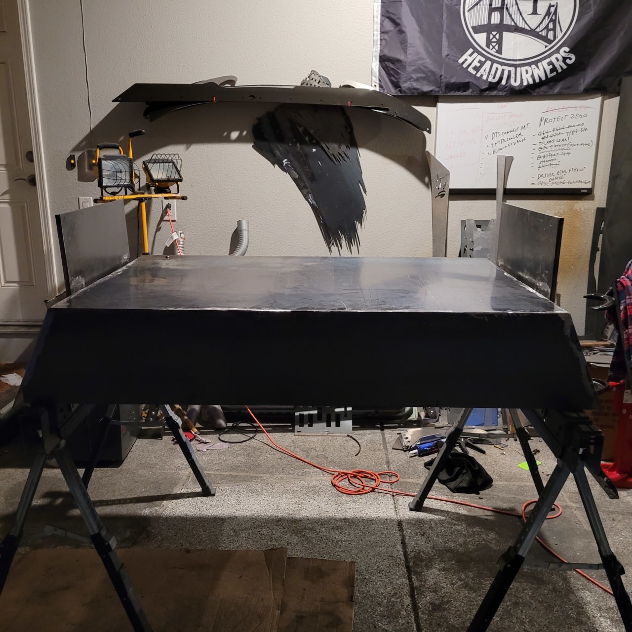

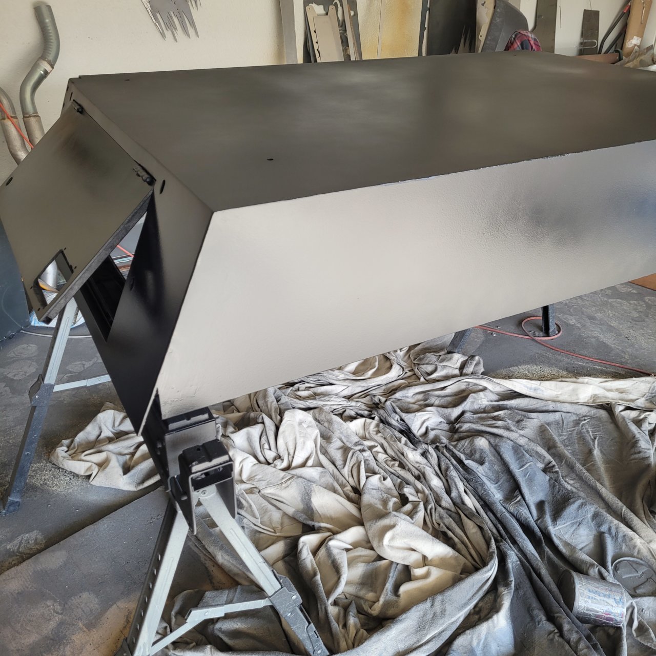

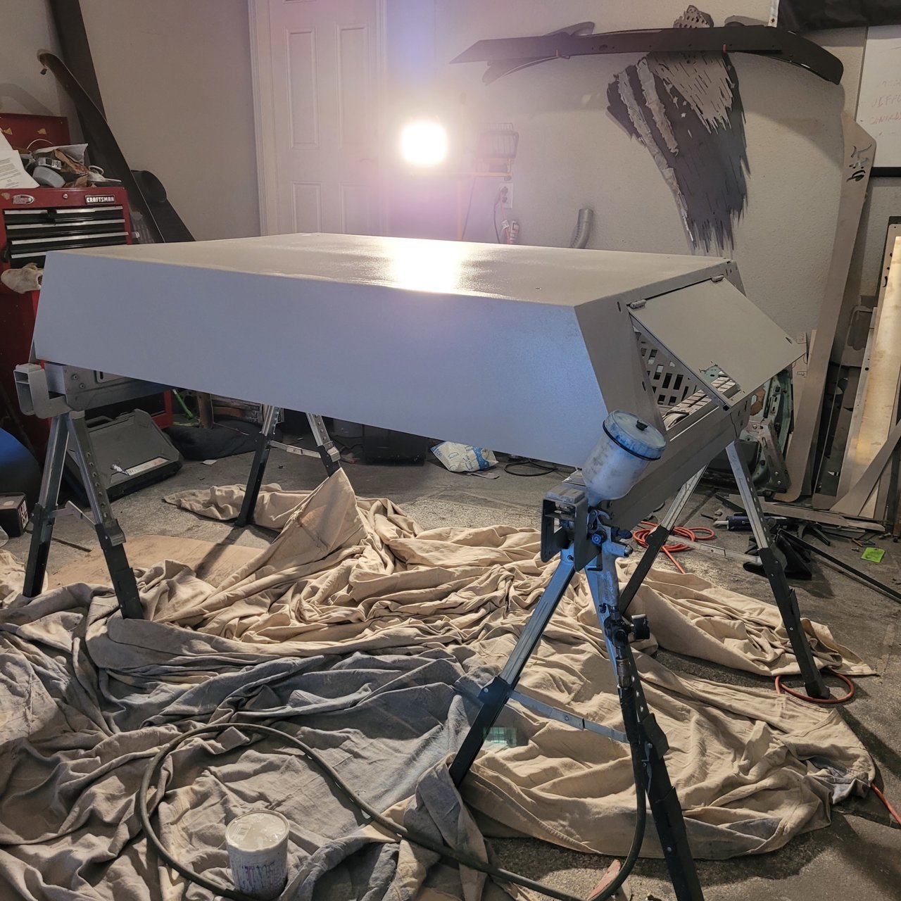

    Half shell is finally ready for paint prep, this was a great project, and turning out perfect!

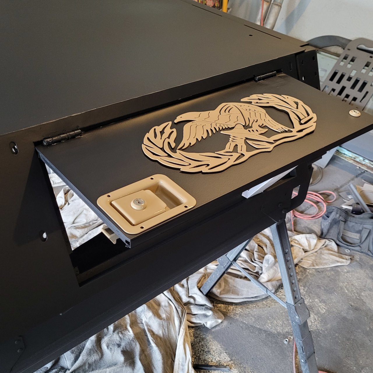

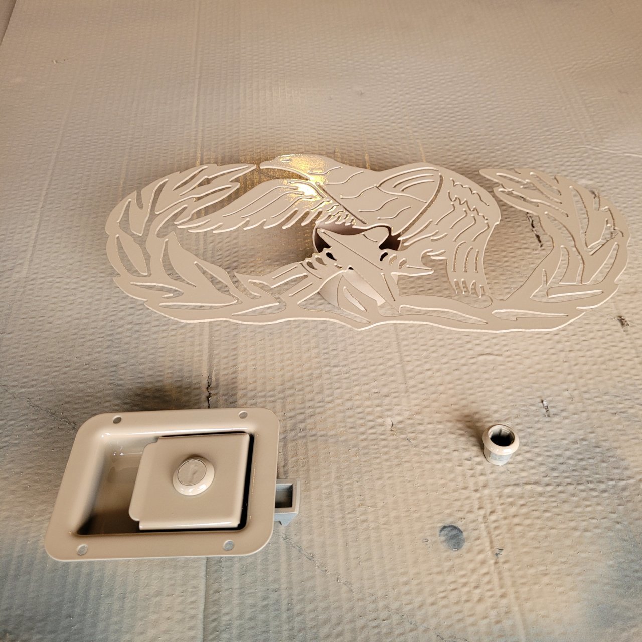

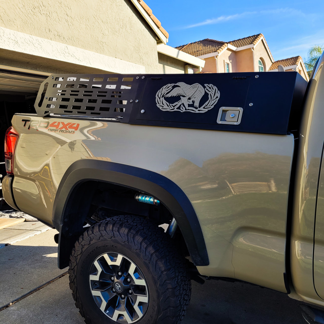

    Welp, painted the half shell, 2 coats epoxy primer, 2 coats primer sealer, 3 coats flat black base coat, 3 coats matte clear coat, I went to put the door harware on and hated the chrome look so sanded the hardware and colored matched.... and theres my problem the color match is way off, so I have to mix my own paint and try to get closer cause this wont work.

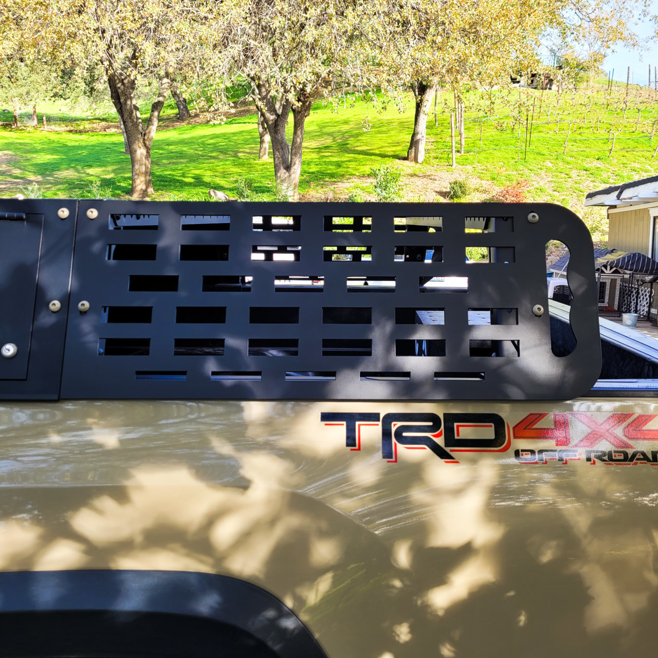

    Harware is on but now changing the design of the Molle panels I wasnt to happy with the old design

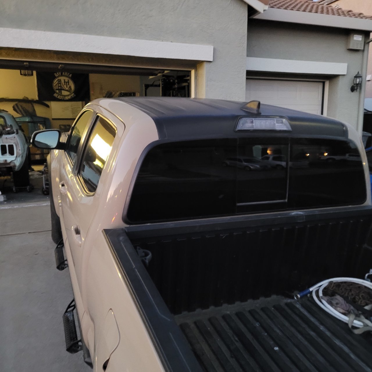

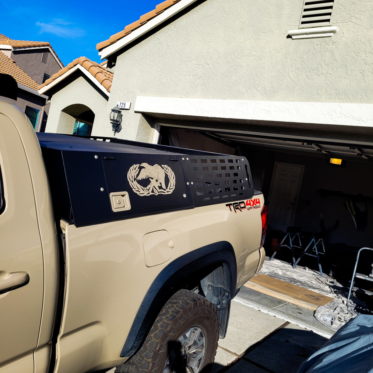

    Finally got the half shell on! It is coming together, i will be putting the rtt on thisnweekend for a hunting trip and testing this thing out

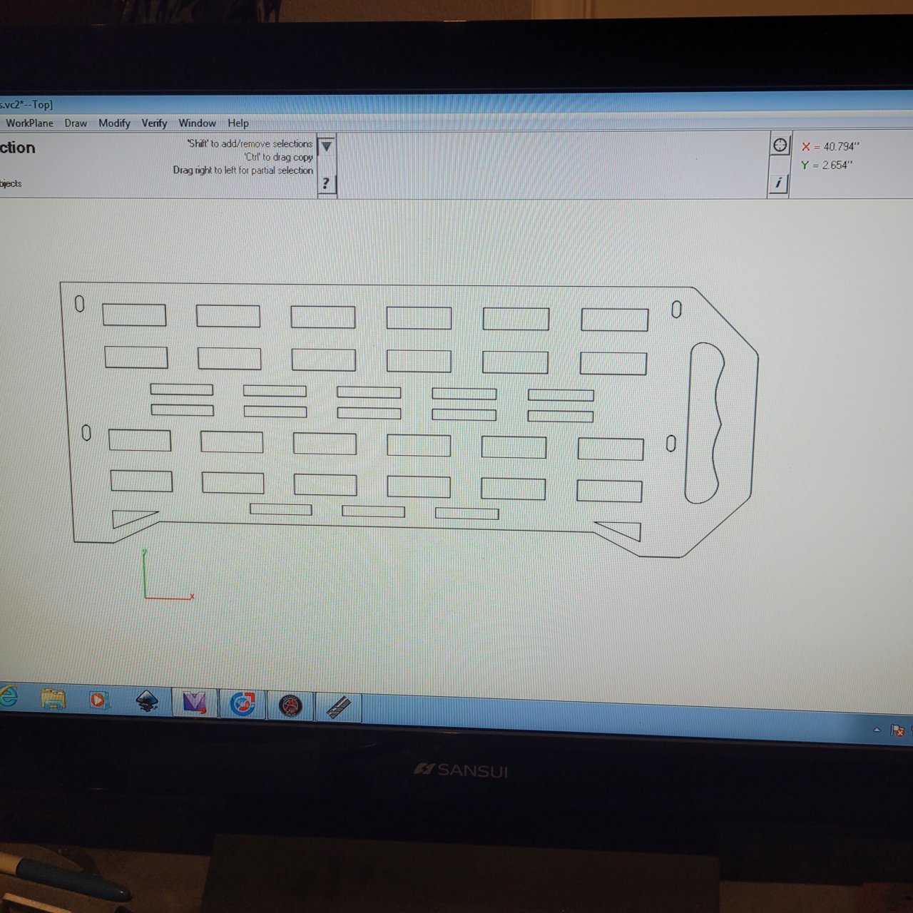

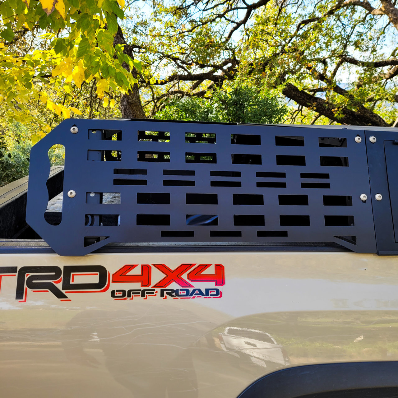

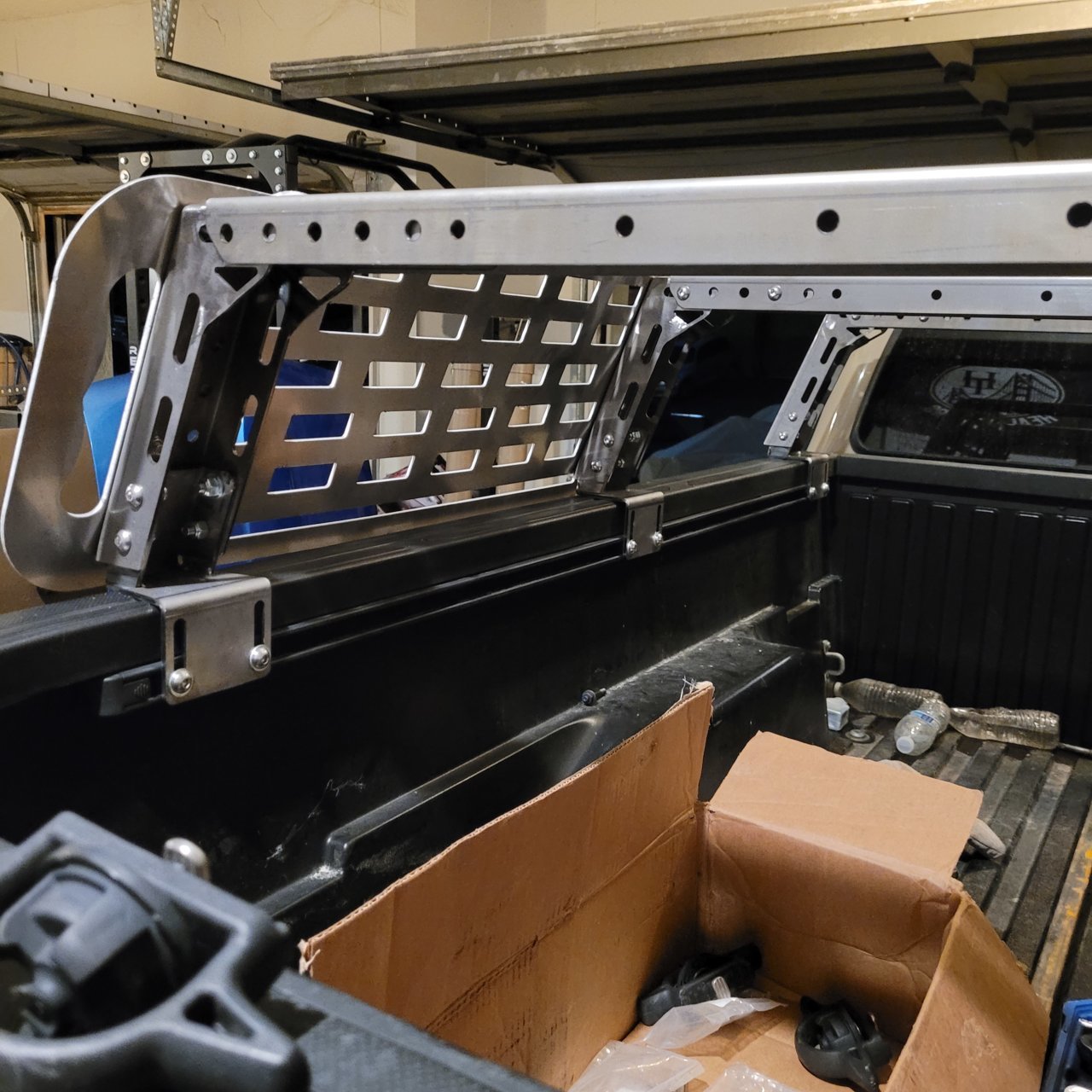

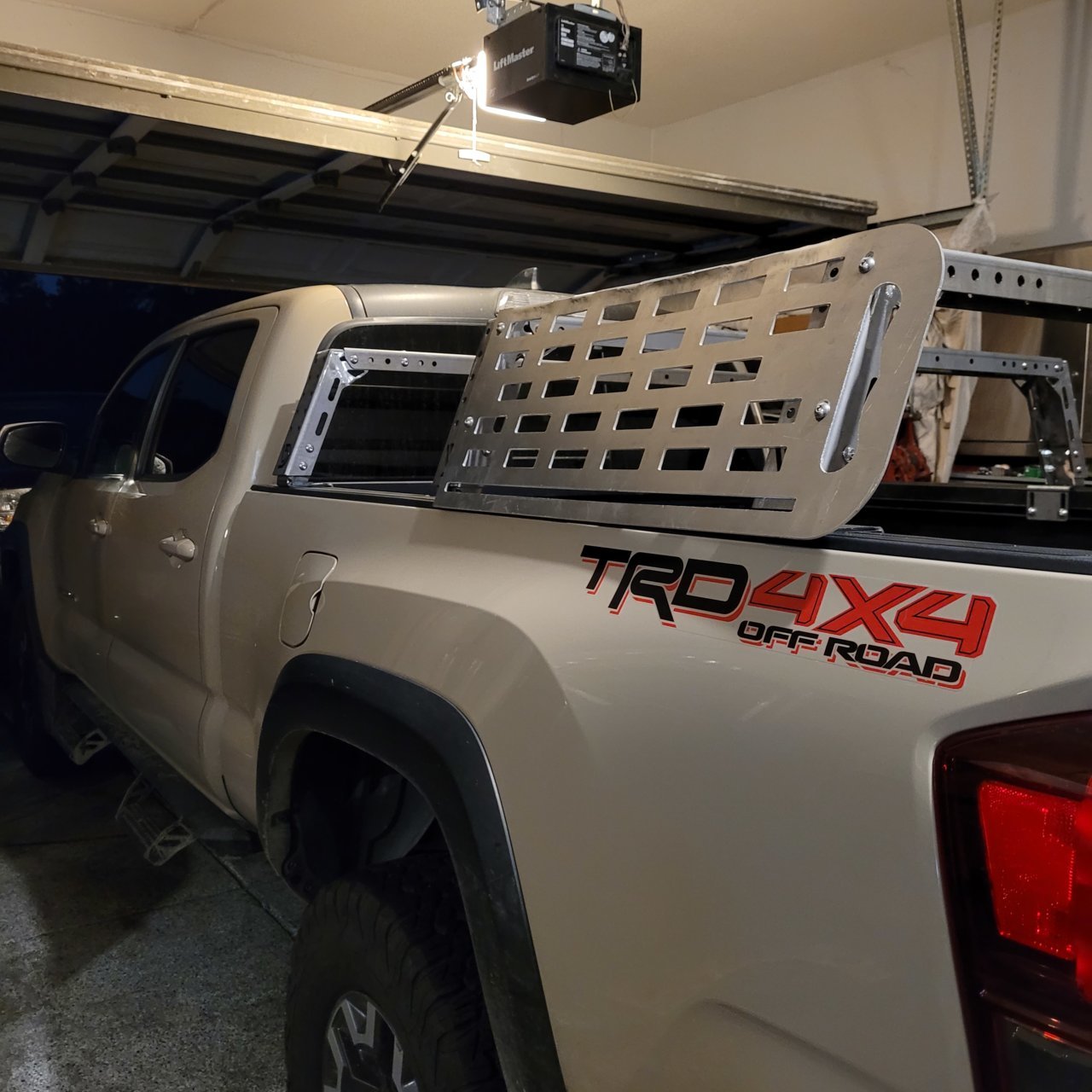

    Here is the two different Molle panel designs I used, the passenger side (top) I like best, but the driver side (bottom) i like as well since it flows with the box but i jave chosen to run the top one on both sides

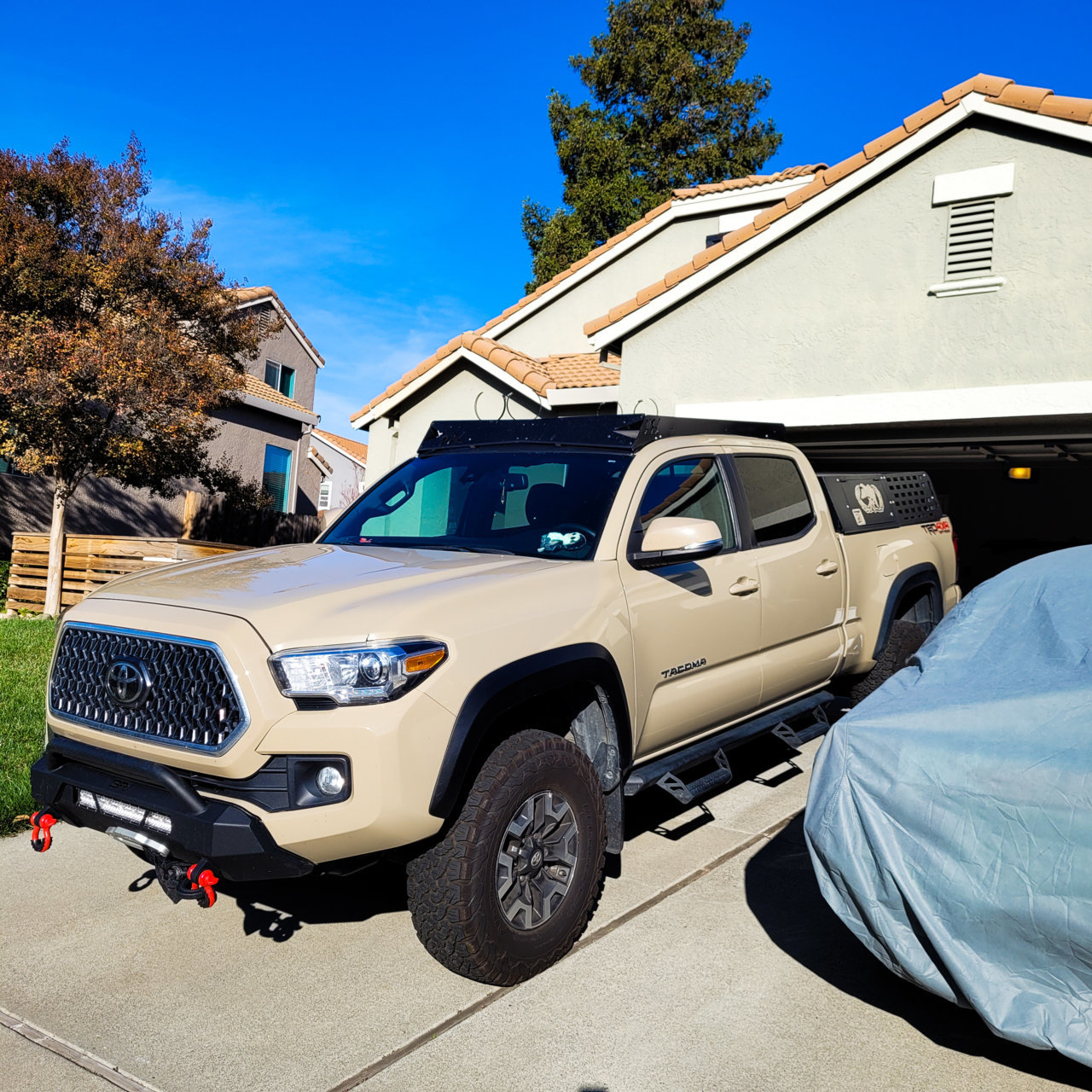

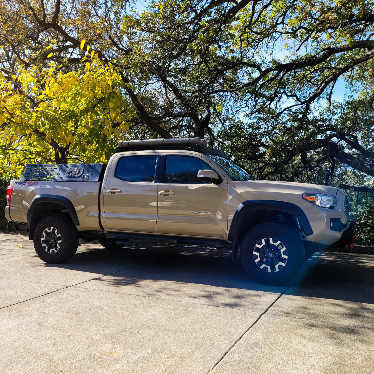

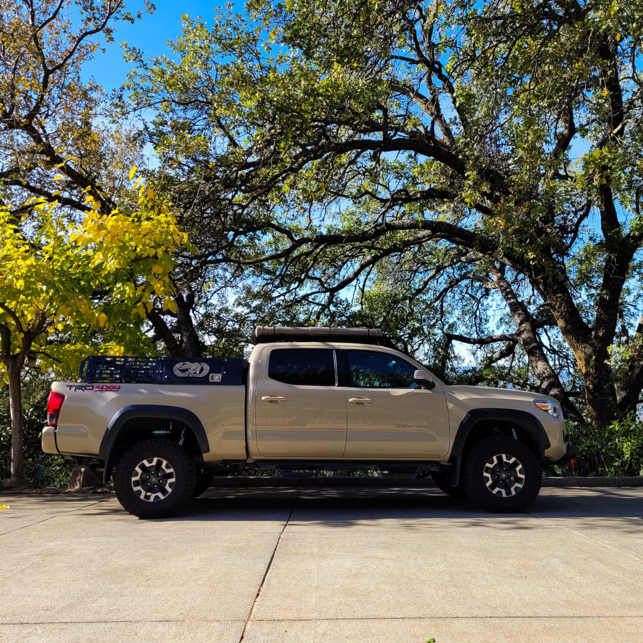

    Where it started to where we are at, next up rock sliders. Not sure if im going to build my own own buy a set since there are some great deals for black friday
