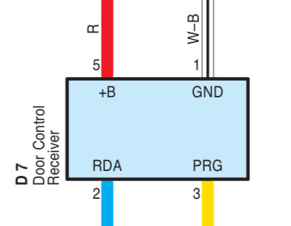

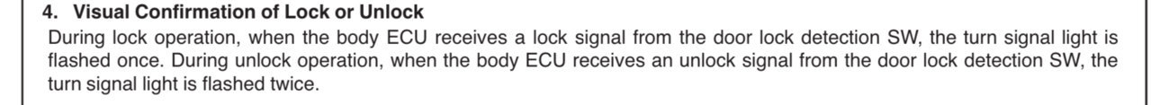

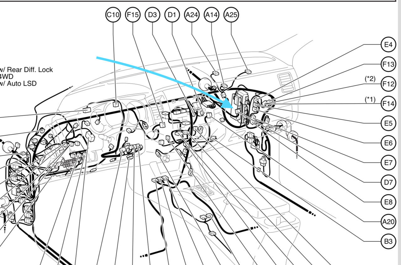

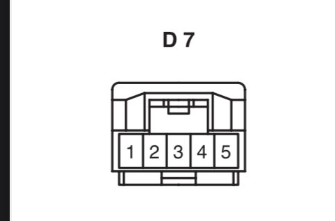

    Me, being me, and not always taking the most logical approach would,
    Unplug the wireless door receiver.
    Why? To eliminate it as the cause of the signal to Lock/Unlock
    Is that the cause? Probably not. But now we know, right?
    To the best of my research and knowledge, the visual conformation only works with the wireless remote system.
