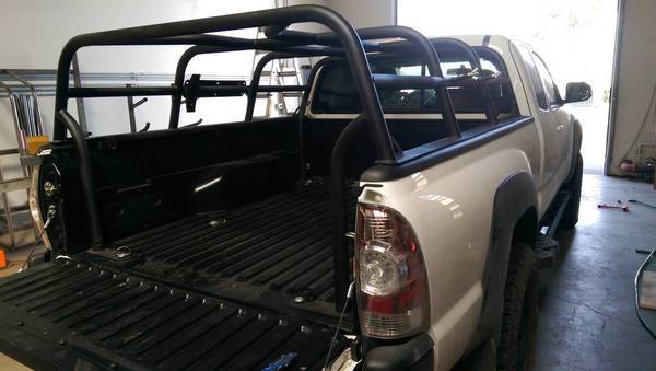

    Took a trip up north to visit Jerry at BAMF. Great guy, will definitely be back for some Rotopax gear and a RTT.
    Pics:
  9. Mar 24, 2015 at 1:36 PM
