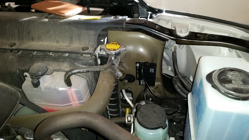

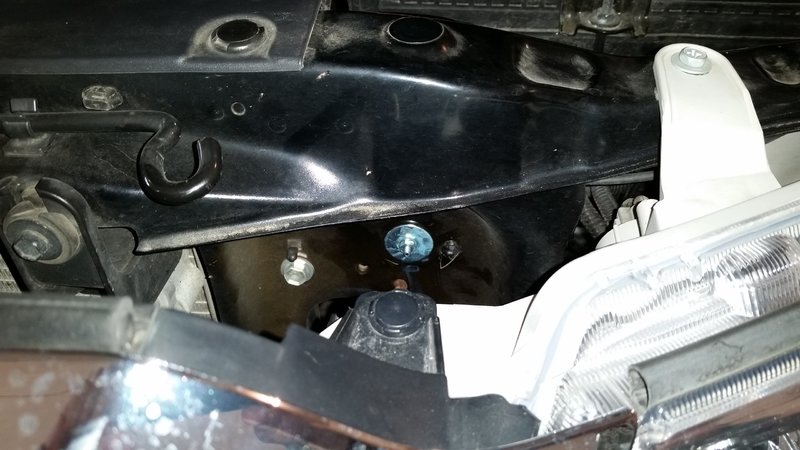

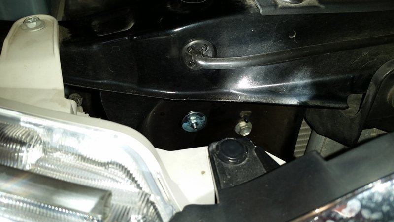

    I finally installed my Philips bulbs last night, and they work really well. Much brighter, pure whiter color, and the light goes where it's supposed to. They are true instant-on units, and they snap immediately between low-beam and high-beam. I was able to find unused 3/8"ish holes in the core support on each side, and secured the control boxes with some small bolts and big washers. A little thread locker and I don't expect any problems. The only complaint I have is that now my fogs look yellow. Philips offers H11 bulbs too, but I'm running much brighter H9s and they don't have an H9 LED replacement. Still deciding if the LED H11's are what I want to go with.

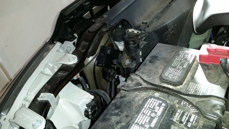

    Hey Paul, can you snap a couple pics of you ballast mounting? I still haven't permanently attached mine (still zip tied). And I agree on the fogs. I just ordered some LEDs for the fogs and will be testing them this week.

    Here you go...
    Passenger side
    05Moose[QUOTED][OP] likes this.

    Thanks. I'll have to check out those spots when the storms end.

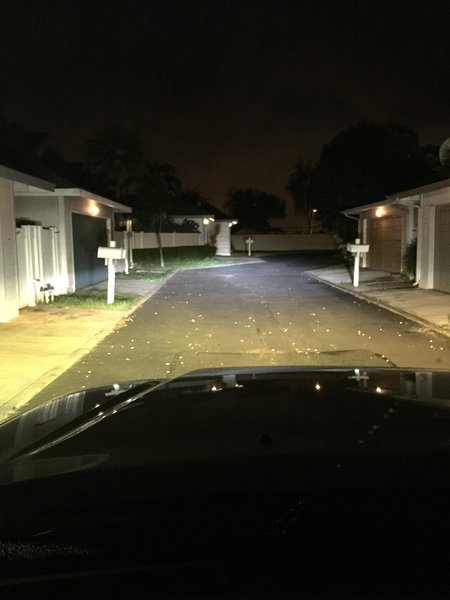

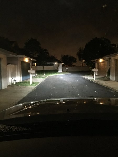

    Good color match on the new fog bulbs. Not sure if they're dimmer, same brightness, or brighter. I'll see how they are on the road tomorrow night and post back. The bulbs I had in there were not OEM, so they might have been brighter than OEM bulbs (OEM burnt out a few years ago).
    Halogen fogs:
    LED Fogs:

    Well, the fogs "looked" nice. A lot more light scatter with very little on the road. Here's a comparison of just the fogs.
    Halogen:
    LED off Amazon:
    So I'm going back to halogen for the fogs.
