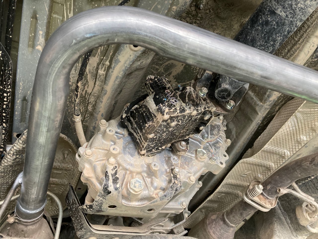

    Good question for @Speedytech7 ... how to handle the heat shield for the transfer case that Borla does include in its kit? Does the shop cover that? I have no metal-fabrication facilities but could contract it.

    You could ask the shop to take a farther path around it, 3" of clearance and it wouldn't concern me anymore, plenty of sensitive shit in the enclosed space of the engine bay closer to hot things. Or get one of the little kits from heatshield products, only needs a teeny patch nearest to the actuator/connector.
    https://www.heatshieldproducts.com/heatshield-armor
    Tiny section of that stuff tied on like they do in the pictures (half the pipe dia) works super well and avoids trapping moisture.

    The shop said "do not worry, we make it right". But a local customizing/racing shop has products like fberglass sheets and "reflectigold" if I want to be paranoid. Getting quotes on such products today.

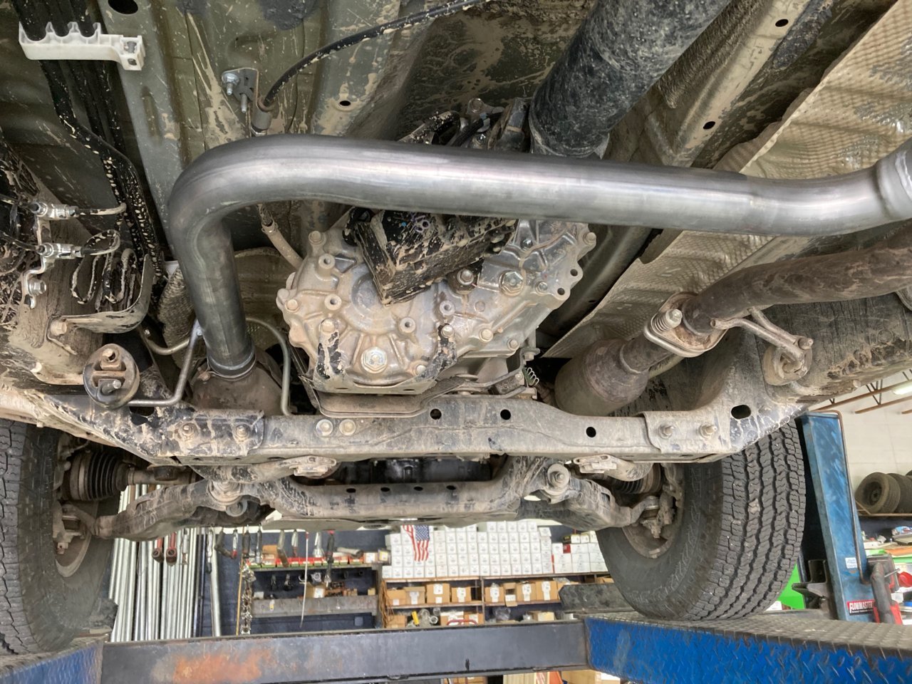

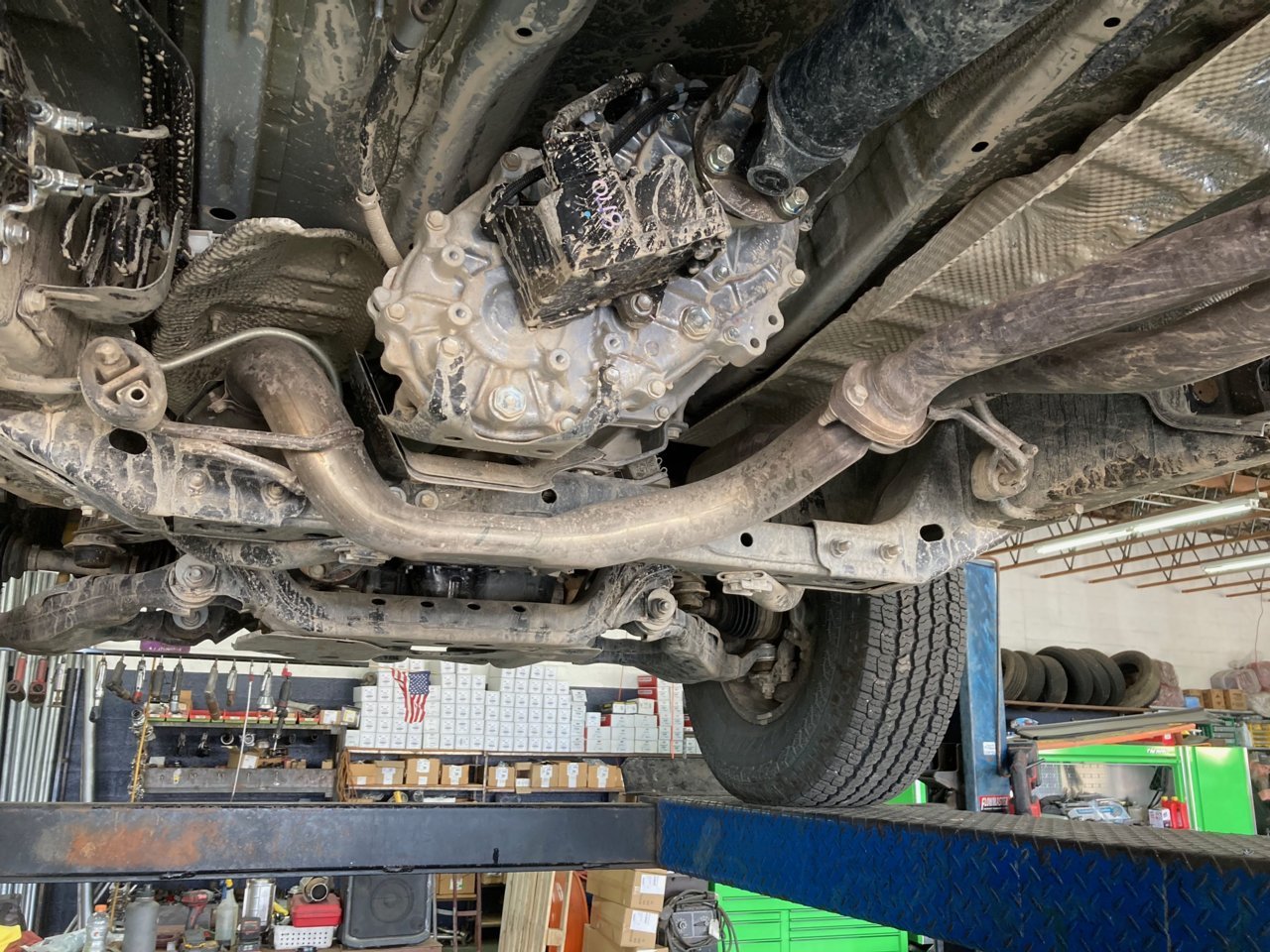

    Cost $93, done in 30 minutes.

    Looks good, no heat shield needed
