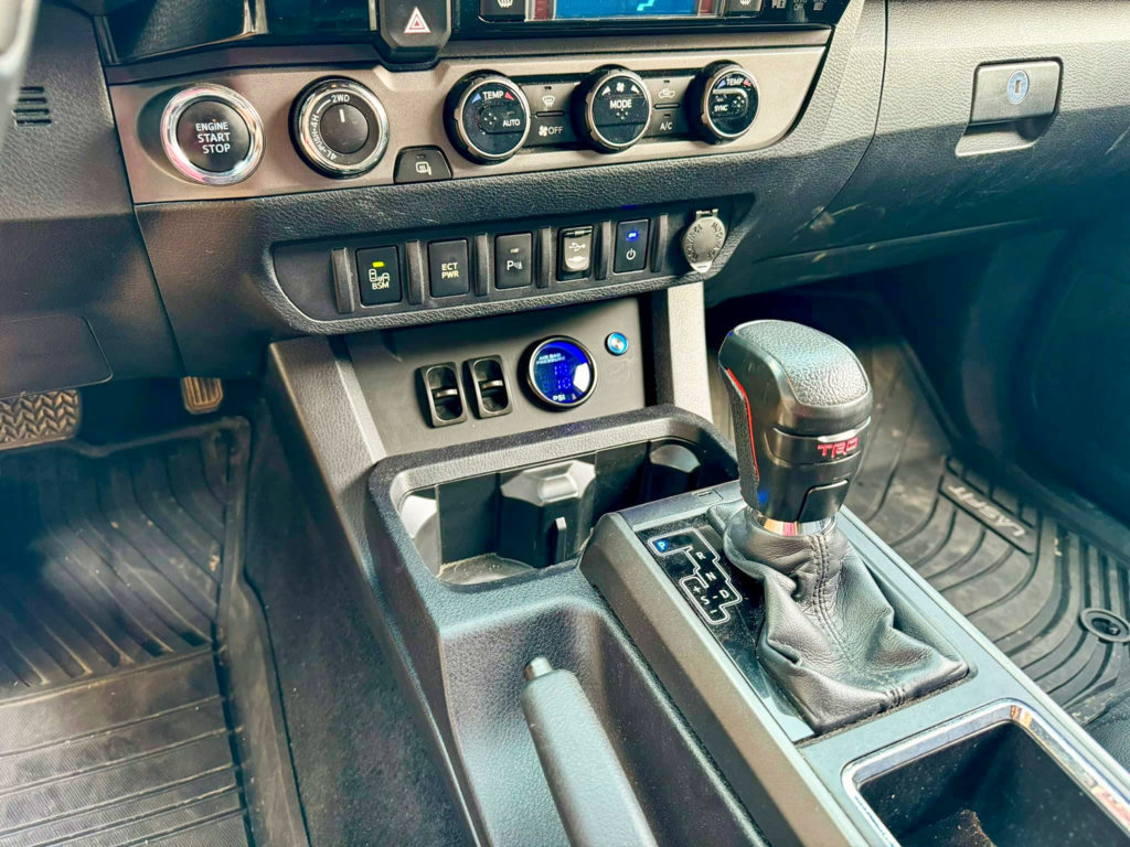

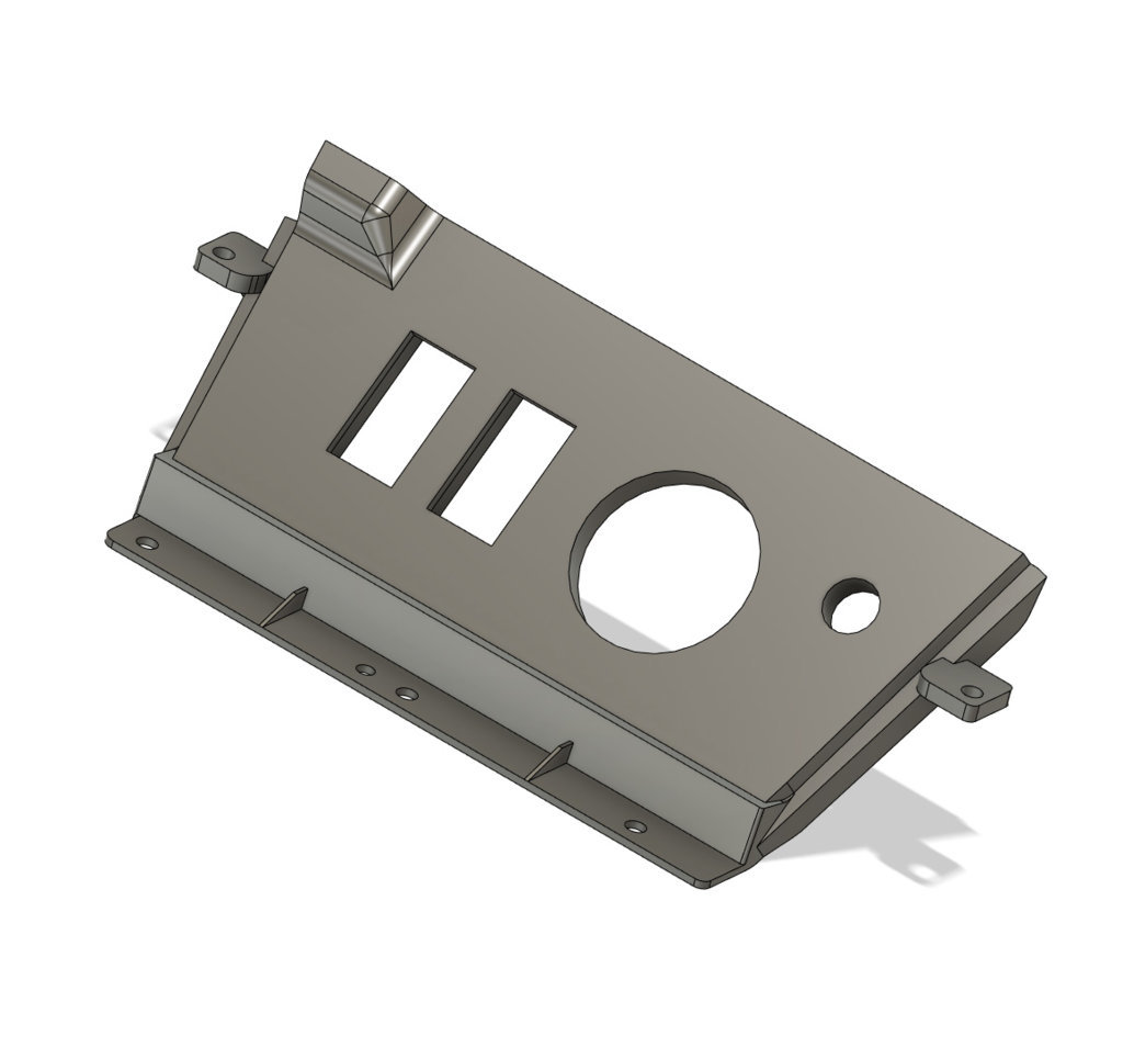

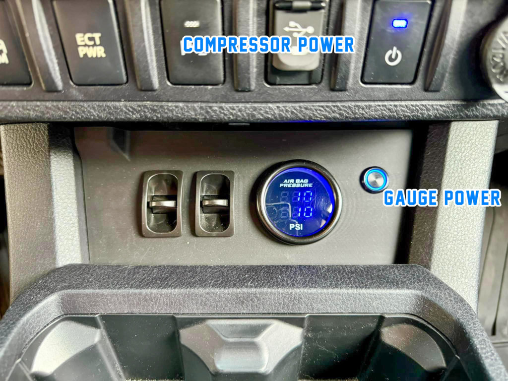

    I finished this up about a month ago but hadn't shared it yet. When I put on air bags I added on board air and wanted to make sure I could control them in cab. I couldn't find a great place to mount everything in a clean way so I went overboard. I removed the wireless phone charging cubby and replaced it with a custom switch panel.

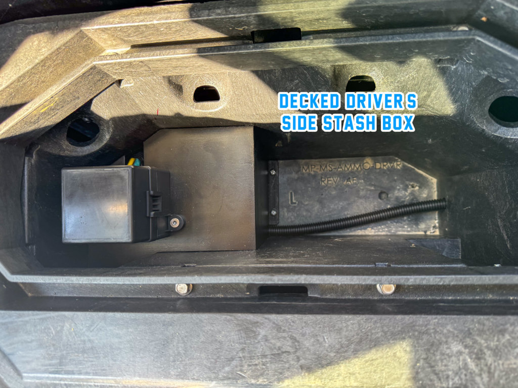

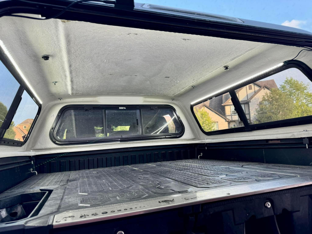

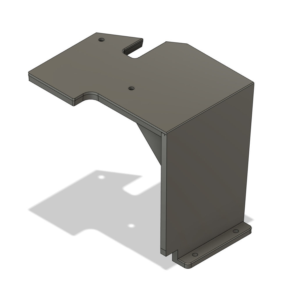

    Since I was routing more wiring and air lines, I decided to go ahead and add power distribution and lights in the bed. So I made a fuse box mount to put in the Decked Stash Box that also hides the wires and hoses.

    This turned out amazingly. What did you do for a battery? Any upgrade to the stock? Really like how you repurposed the useless wireless charging dock. That cover you printed (assuming 3d printer) is next level.

    I run a stock battery. The compressor only pulls at most 23amps and it's not running very often unless I'm airing up tires, but in that case, I'm not running much else.
    It is easy enough to tweak. Shoot me a PM we can figure it out.
