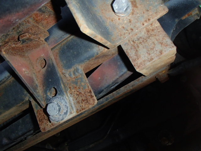

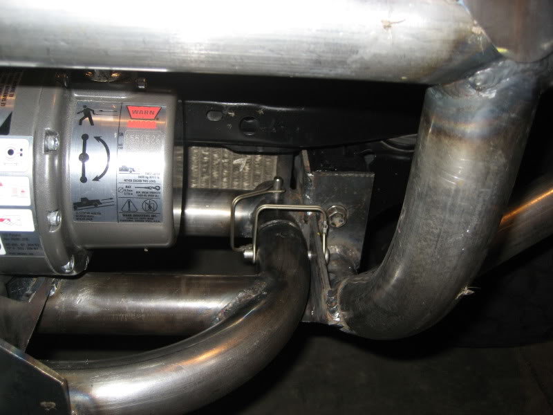

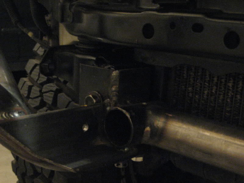

    Now since this bumper is for a first generation Toyota (1983) nothing really was made to fit a Tacoma.
    As it turned out I was changing the radiator to get to the lower bolts the bumper cover must be removed on pulling this off I discovered all that was there was the plastic cover.
    I had the Smitty Built bumper sitting in the shop.
    First thing I did was run a piece of 3/8" flat across where the hooks bolt to the bottom of the frame then bent brackets to tie into those 4 bolts holes drilled and tapped for M12 x1.25 bolts003.jpg

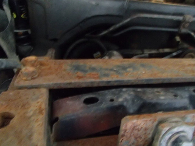

    Then I made piece that went between the frame rails allowing another 2 bolts 002.jpg

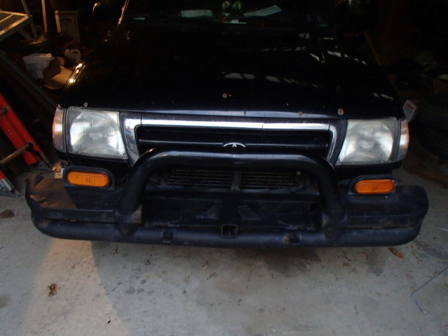

    Here is a picture from the front I took sheet metal from a Lincoln DC 600 to make platforms to sit the marker light/turn signals on.
    Itis also tied into the front body mount bolts
    I wanted to make a piece of expanded metal to go below the bottom of the grill I just never got to doing it to many other more important projects.
