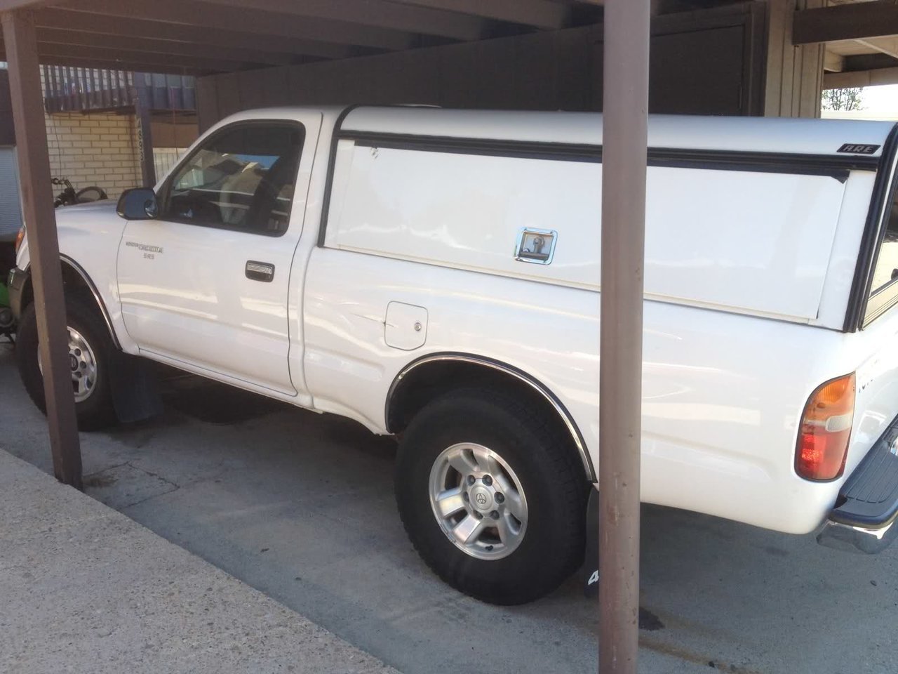

    What I started with was a 2000 Toyota Tacoma SR5 with 58000 miles, 2.7 Manual with Firestone Destination LE 265/70R15s.
    Not to bad imo. And that's my Finance smiling. (Its really her truck atm... :cool: my aunt sold it to us at a great deal right before this)

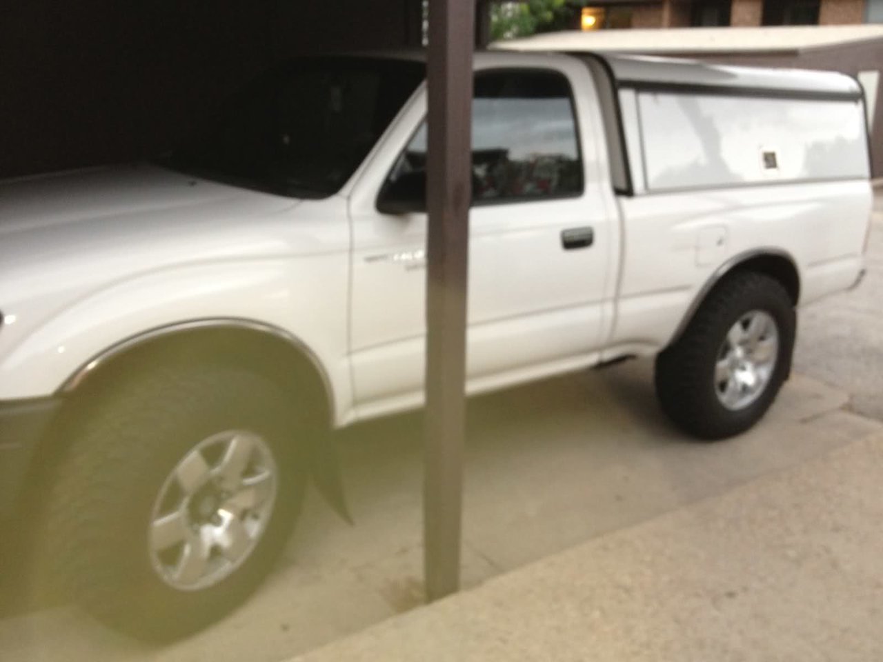

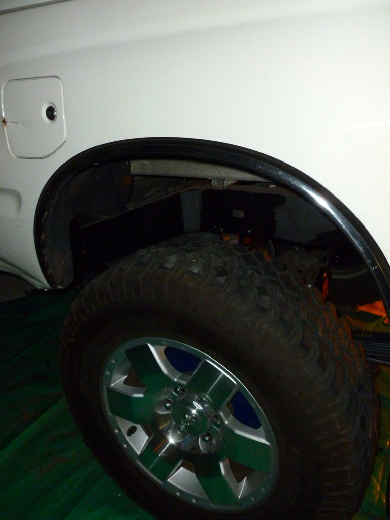

    Goodbye 15" hello 17" FJ rims and 255/75R17 BFG MT Tires. ( Sorry for bad pics, maybe this week end ill take better pictures if people want ).
    Wasn't to pricey as this as take offs for people pimping their rides. So far there great, they are louder than before but thats to be expected. Feel more nimble driving around now. and shifting and gearing feels better.

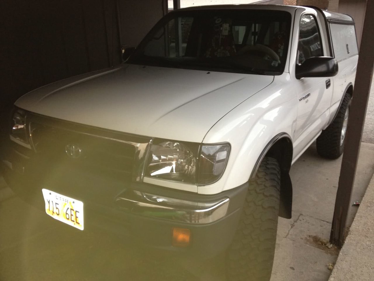

    And just tonight i got some ebay black-out Headlights.
    Looks much better. :cool: Just need to re-aim the lights.

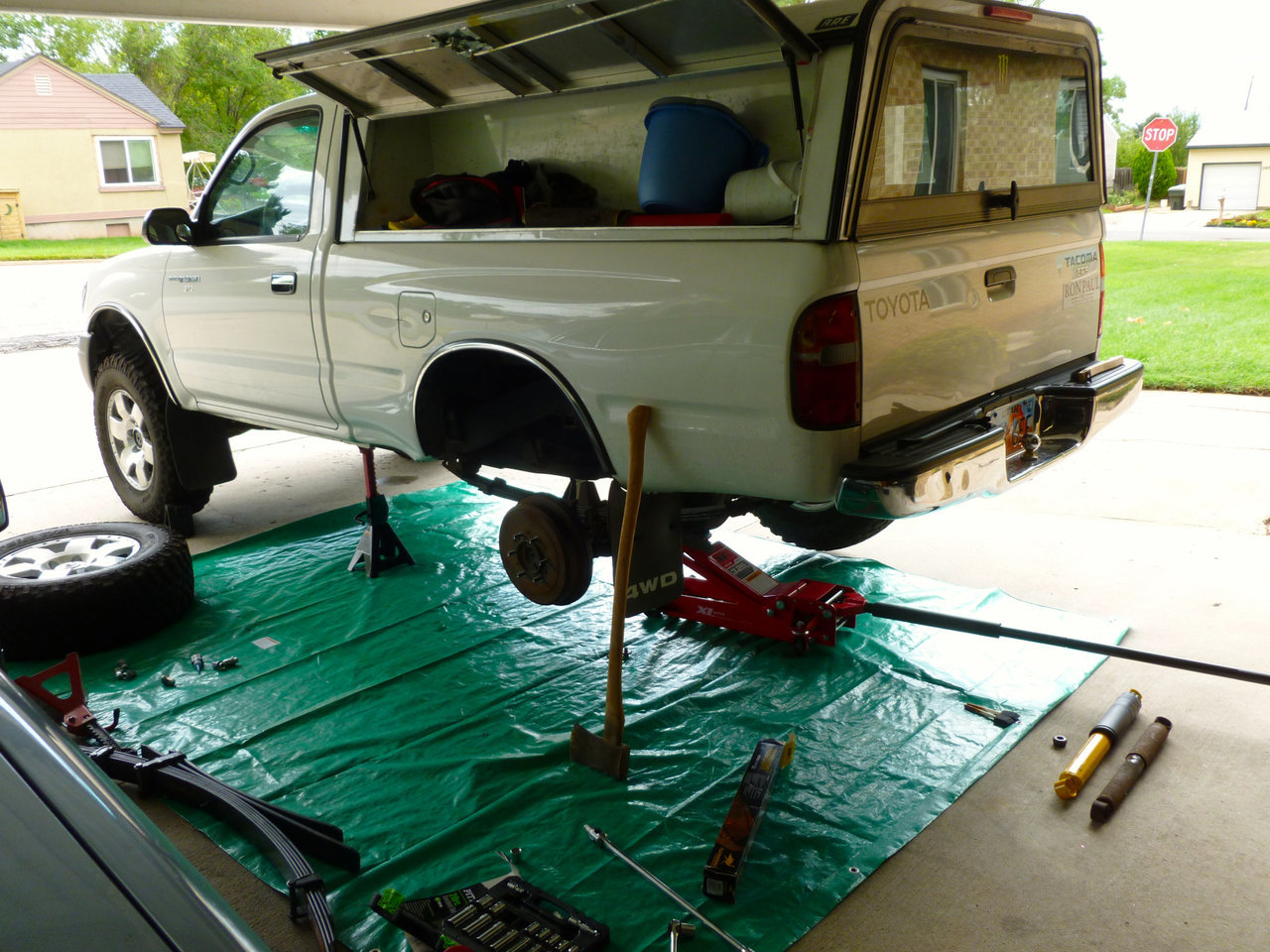

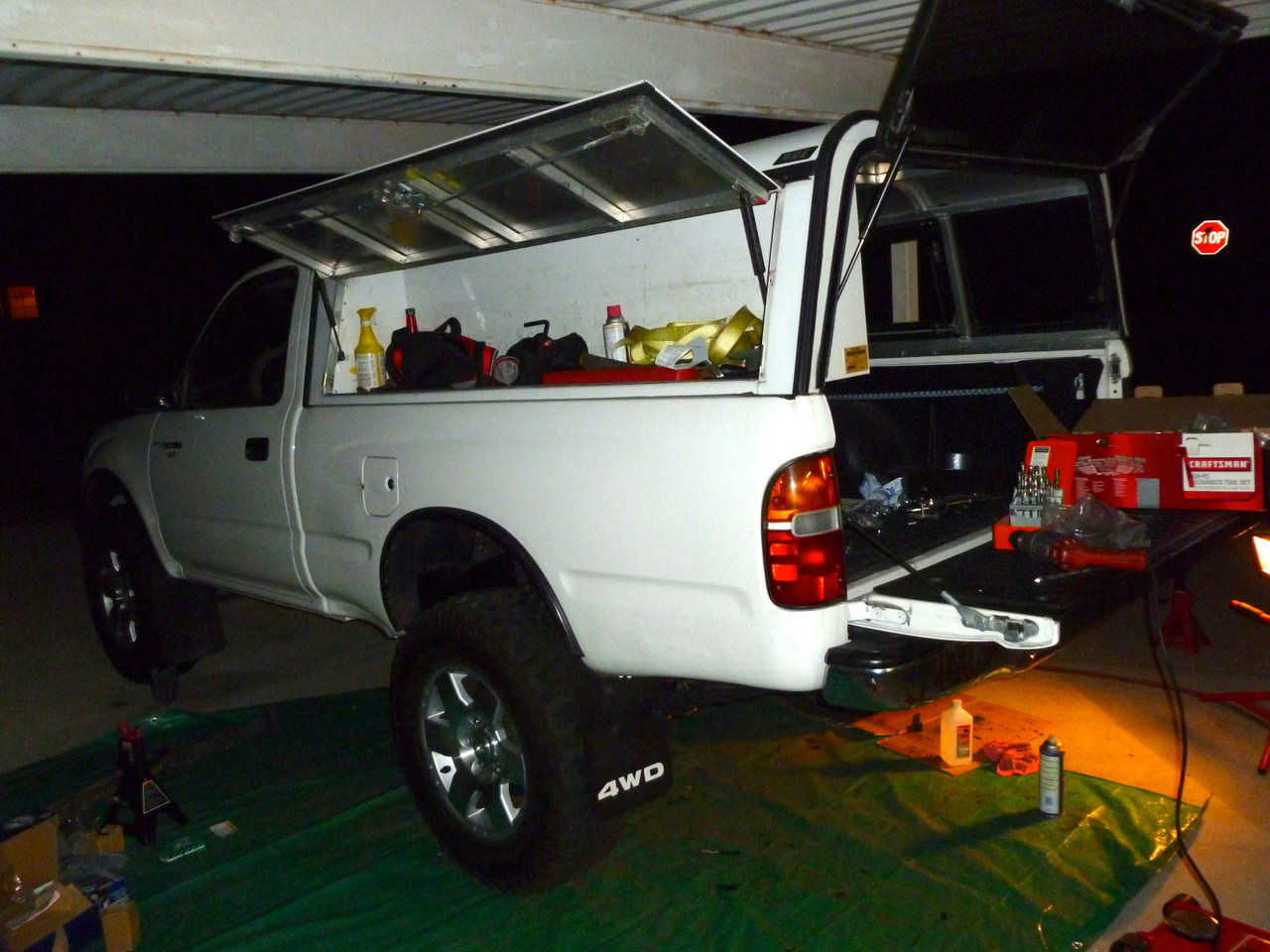

    Got Lift installed.
    Purchased main kit from Lowrange offroad here in utah, service was ok but a tad lacking. Have been getting the rest of my stuff from wheelers offroad and they are awesome imo.

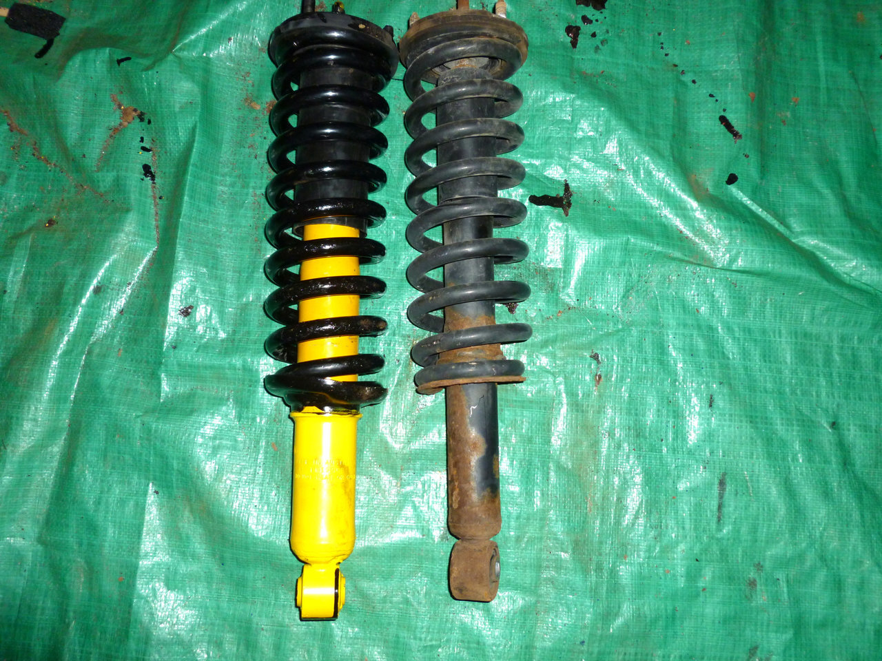

    New vs Old.
    Umm overall not to many Problems. Alignment is off slightly, , and will be until weather warms a bit and i have money for light racing UCA, and new unfrozen tie rods installed. then i should be spot on.
    As far as how the lift is its great right amount of height. But maybe a tad to firm/harsh without the shell on. Idk maybe i need to take out the second overload leaf from the rear springs.
    I have removed the sway bar and it did help the ride.
    Also have one of BAMF BPV braket installed. works great.
