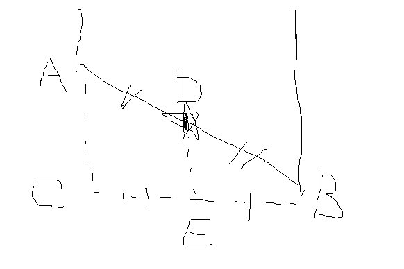

    No need to use sin or cos on this problem. If you understand the triangle ABC and triangle DBE are similar (and understand the length CE = length EB), you do not have to use sin or cos. You do not need to calculate the length CE or EB

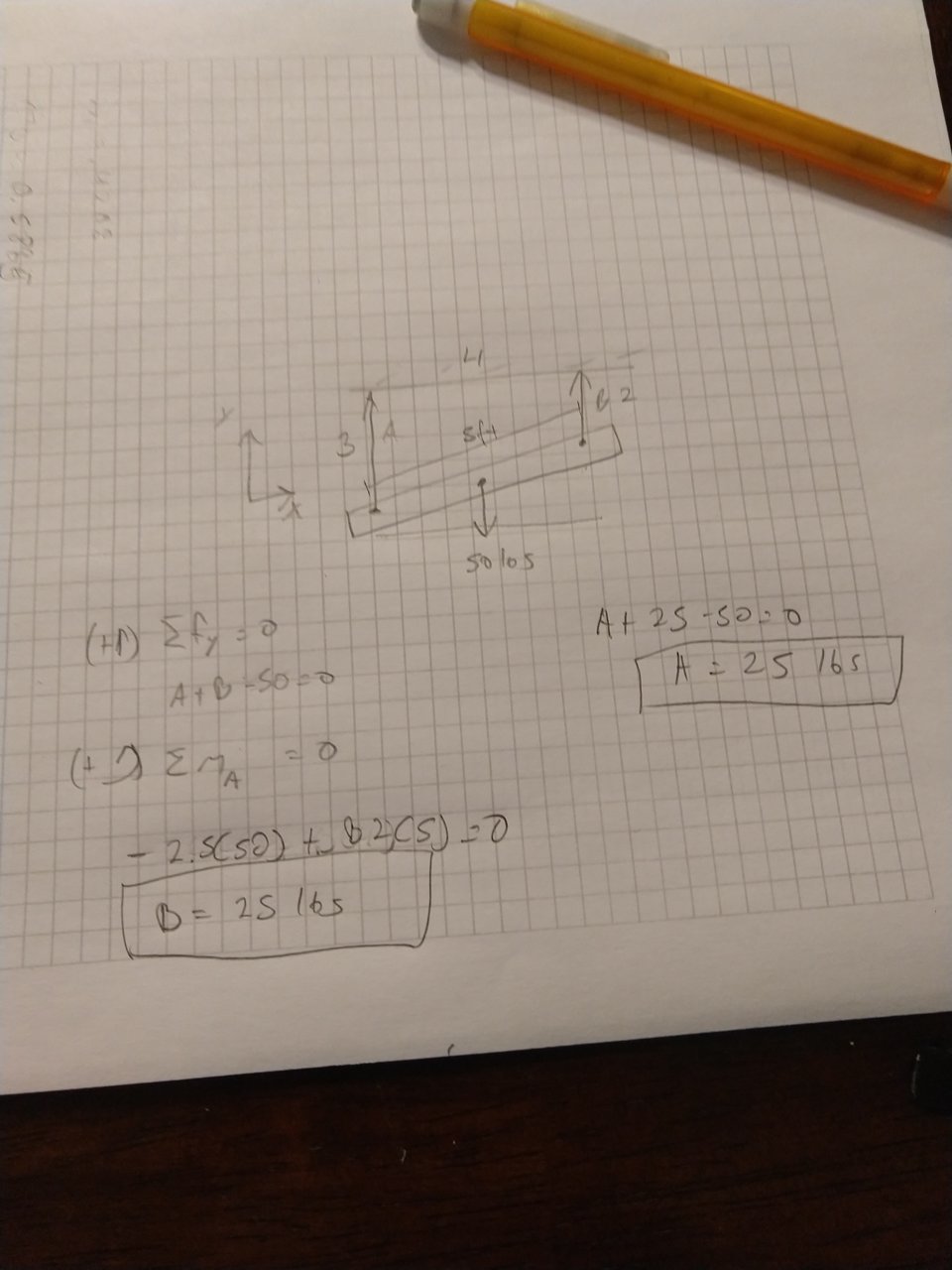

    Sum of the moments about a point bud :)

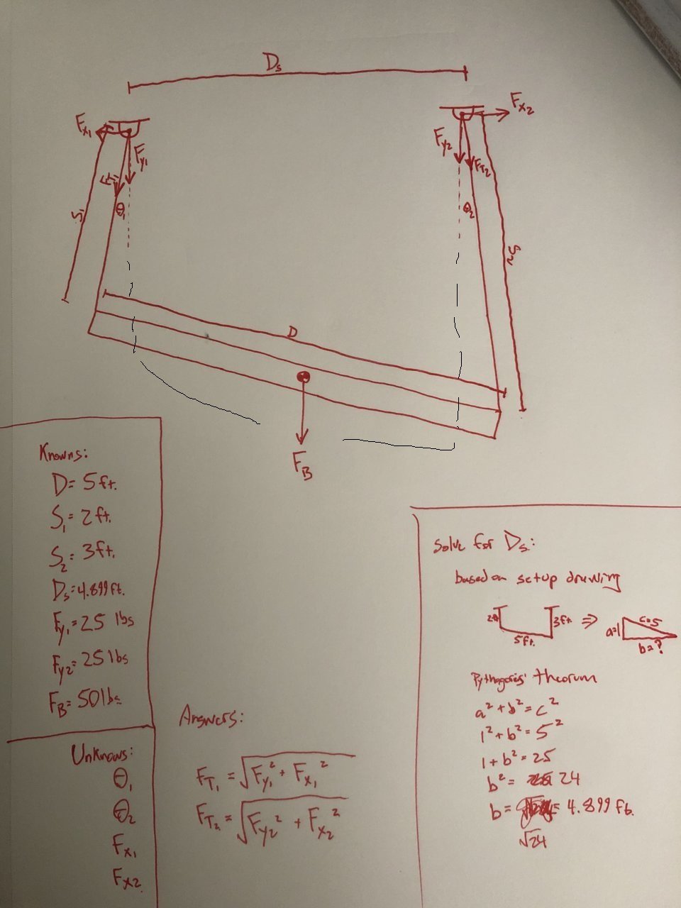

    I didn’t read this whole thing, and maybe someone beat me too it, but This isn’t a static’s problem, as the starting point given by the OP is not a static state.
    The bar is going to equalize once you hang it. Because the bar is being hung at an angle, the attachment points in the ceiling will be closer than 5ft.Once the bar “equalizes” itself it will impart horizontal forces on its support structure (and a compressive force on the bar) because the cables are angled. The tension in the cables is function of those horizontal forces.
    As you hang weight on the bar, it will “equalize” more, and the tensile forces seen by the cables will be amplified by the additional horizontal force.
    Edited cuz I Forgot to add that the horizontal forces are gonna be tiny So nbd

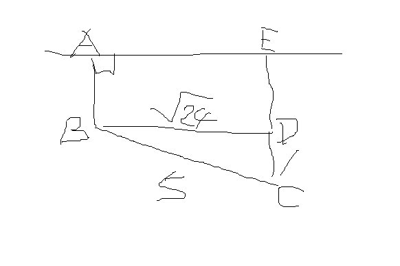

    I thought if AE=squareroot (24), angles BAE, AED, ABD, and BDE are 90 degree. In other words, AE = squareroot (24) is the requirement to have AB and ED normal to the earth (or you can say perpendicular to the ceiling). When AE is not squareroot (24), these 4 angles are no longer 90 degree. What do you think?
    OP did not specify the length AE in the initial setup - only 5 ft of 50 lb beam and 2 ft support and 3 ft support. OP can make these AB and ED normal to the earth if he picks root 24 as the distance AE.

    Somehow you estimated as Ds=squareroot (24), if that is the case, the beam length should the cross point between Fy1 and the beam, and Fy2 and the beam. In this case, theta 1 = theta 2 = 0. Therefore Fx1=Fx2=0. Are you saying that the beam will move from this position (theta 1 = theta 2 = 0) and theta 1 and theta 2 will be no longer zero?. If the beam somehow moves to the right, vector Fx1 + vector Fx2 will have the right direction. If the beam somehow moves to the left, vector Fx1 + vector Fx2 will have the left direction. Either case, vector Fx1+vector Fx2 will no longer be zero, that is not equilibrium.

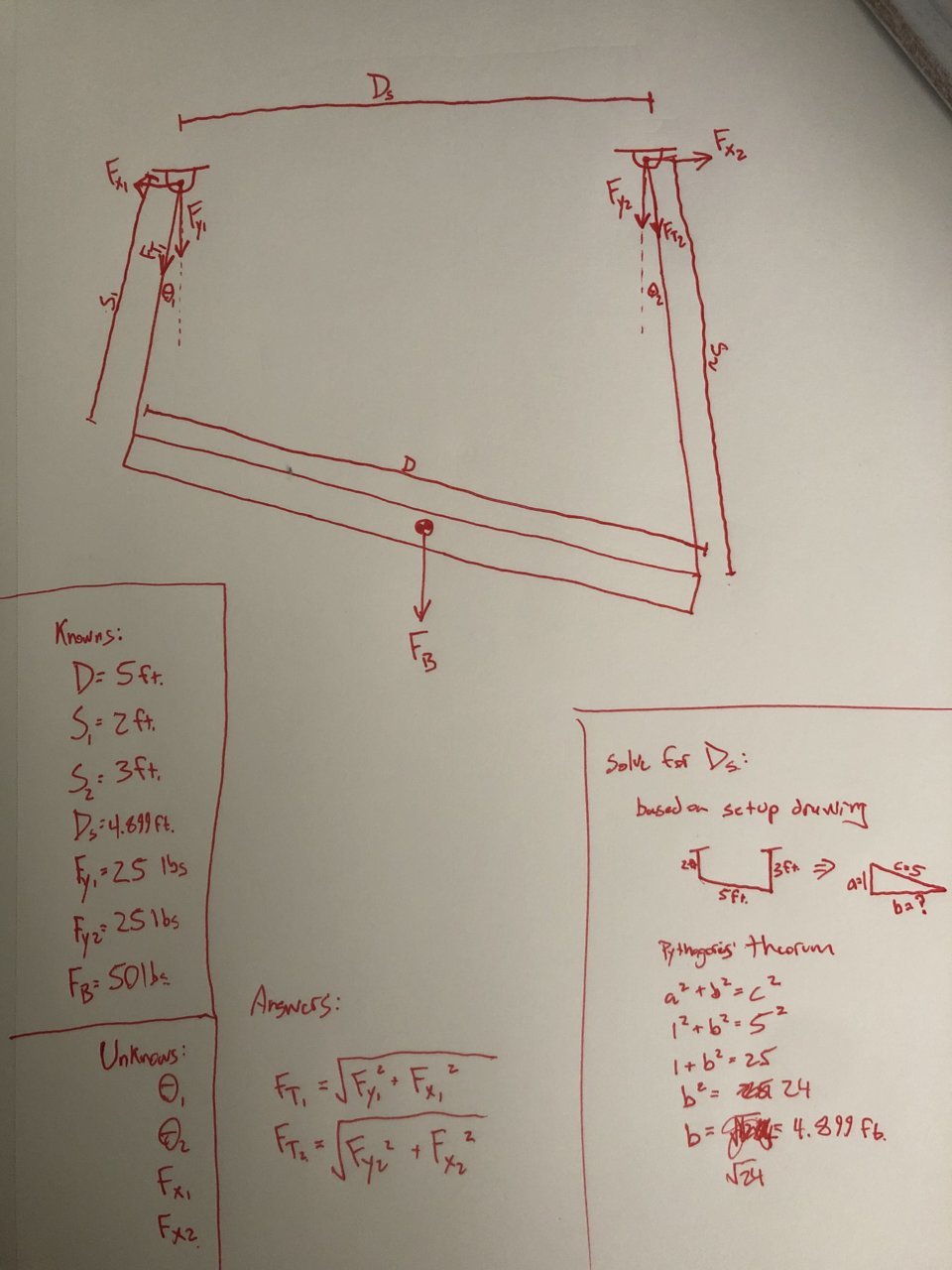

    Just came across this thread, and it was a fun read, haha. Some things were correct, some were not. Most answers used some unstated assumptions, others didn't exactly follow the given parameters, etc.,
    In the unequally loaded crane example that was posted, the centre of gravity was not in the centre of the beam (when horizontal or in the angled position), and so they are measuring the horizontal distance to the COG. That is the real question in all of this, because one of the stipulations in the original post was that the cables make a right angle with the ceiling in the final loaded position. The easiest (physical) way to do that is with rollers, assumed frictionless in the analysis to ensure that they are perfectly perpendicular.
    Assuming it is a 2-dimensional problem, constant cross-section, and constant material properties in the beam, the COG will be at exactly the geometric centre of the beam (half way between each end, halfway between the top and bottom), it is a purely static problem. If the height of the beam is very thin compared to the length (or the rigging is attached at the centre of the beam), you can assume the COG is in the centre of the two cables and that they will have the same tension in each cable, regardless of the angle of the beam provided the difference in cable length is less than the length of the beam. If you don't make that assumption, you need to consider the thickness any offset thickness of the beam and how much it will move the centre of gravity horizontally (x-direction).
    I apologize for any illegibility of these drawings or non-simple things I did with the geometry (e.g. sinϕ doesn't need to show up, it was just a bridge I used to show the similarity), or steps I didn't show, haha. I'm pretty tired.
    EDIT: I also assumed the difference in cable length to be at equilibrium, i.e. they don't change length under load.
