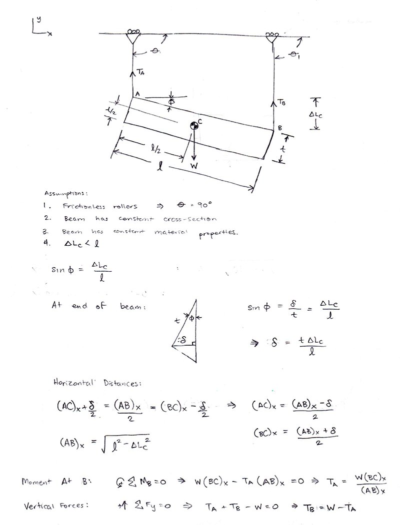

    I don't specifically know what common core is, so I Googled it, haha. They did something similar in high schools in Alberta a few years back, parents weren't super amused and so they kind of changed things around again. In any case, this isn't typically the kind of problem you'd do in high school without making the simplifying assumptions (beam supported at centre or thickness negligible). It's been a few years since I left high school though, so my memory of physics is more than a tad hazy.
