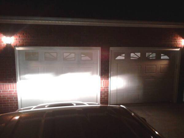

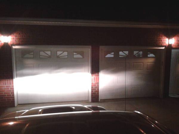

  20. Sep 18, 2010 at 5:52 PM
    #20
    SCFirefighter
    SCFirefighter [OP] on idiot patrol ;)
    Apr 20, 2010
    #35670
    1,699
    Stephan
    Cary, NC
    Silver 2010 DC TRD Sport 4x4 5'
    MagnaFlow Performance Exhaust, ScanGauge II, Map, dome and license plate LED's, Custom Fire/Rescue decals, Weathertech deflectors, Removed mud flaps, Rear spring TSB, Spidertrax spacers, Tinted windows (5%/27%), Black Tacoma badges, 5100 Billstein x4, ToyTec Coilovers, ToyTec TSB AAL, Devil horns, Hose clamp tailgate mod, OEM bed mat, HomeLink module, Hardwire GPS, Weathertech digital fit floor lines, Front Diff drop, Rear Diff breather mod, 4xInnovation welded sliders, Pioneer AVH-X5800BHS+SiriusXM.
    so I got the [SIZE=-1]100/80W Halogen Bulb Off Road Use[/SIZE] today. They're the higher wattage bulbs. Honestly I'm not sure what I expected to see, but here are the before and after pics. I don't see a difference. Maybe it will be obvious when driving and looking at longer distances.
    I'm closer to the garage door in the second picture, so the light spot is bigger because of that.
