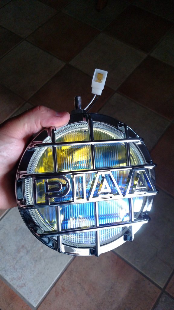

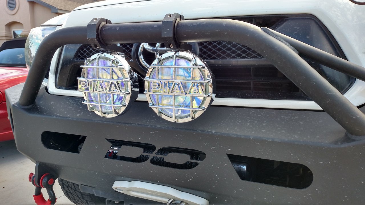

    I knew I was going to mount the lights upside down under the bar on my new Demello baja hoop bumper, so I popped the grilles off the lights and re-mounted them upside down, so they would be right side up. I also turned the vent tubes 180 degrees so they would still point downward. The grilles are plastic, though they seem durable enough.

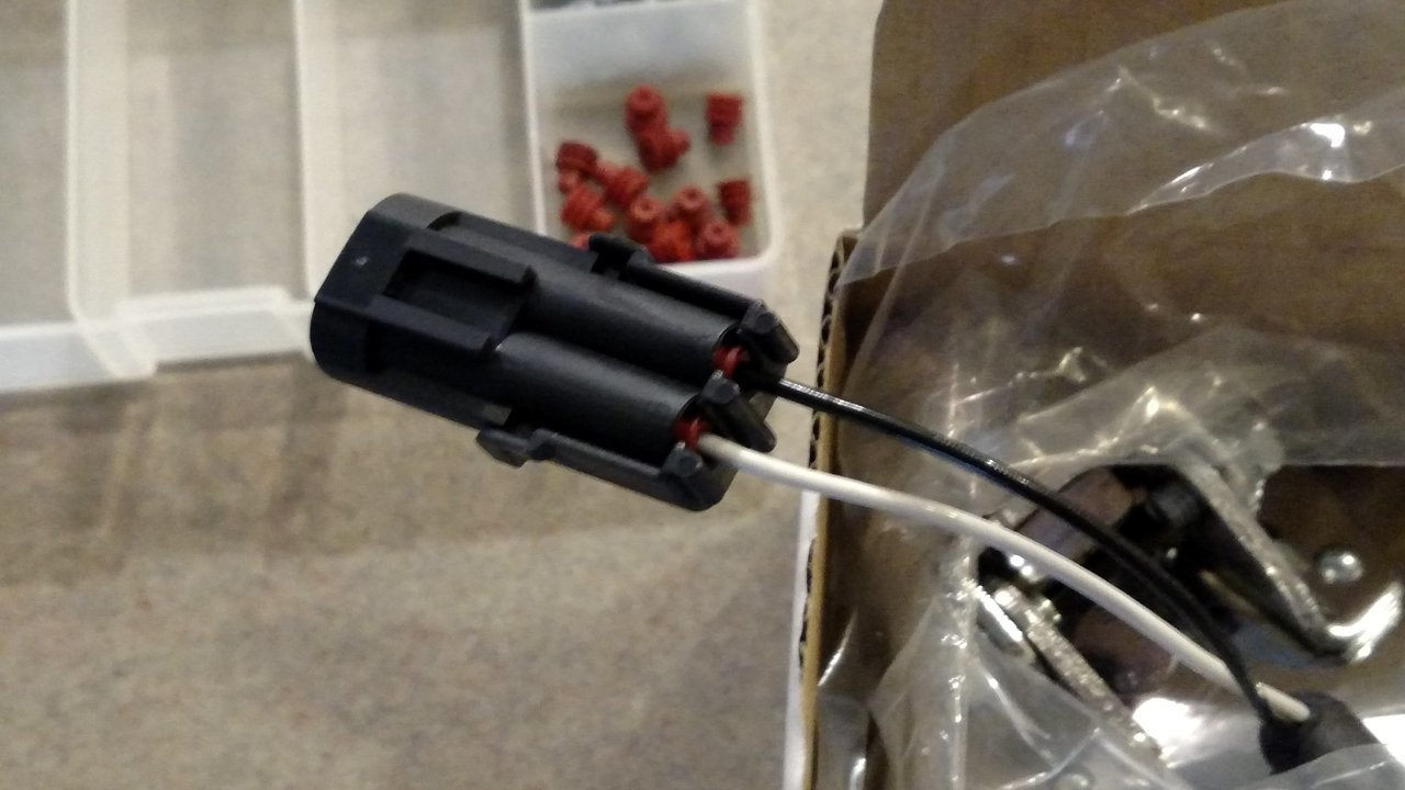

    The first thing I did was cut off the factory connectors. They are not weatherproof, so in the trash they went. Everything I built on this truck was completed with weatherpak electrical connectors, and these lights were no different. See the below image (weatherpak) vs the above (factory).
    If you're going to build your own wiring harness, make sure you take the extra time to do it right, or just buy one. They can be had for less than dinner for one. There's no reason to go the cheapo route. I've seen too many home-built wiring systems where the load (light, etc) is simply hardwired directly to the battery. And I see many charred spots on the sides of roads where a vehicle burned to the ground. Build it with a switched relay and fuse.

    Maybe I'm too used to LEDs and their ability to produce radiant whites now that they've become ubiquitous, but the warm tone of these lights took me by surprise. They are decidedly yellow. Not quite as amber as my amber LED fog lights, but yellow nonetheless. This is not necessarily a bad thing. It does make these better for fog/snow/dust/rain, as the longer wavelengths of light do not reflect off particulate as readily as the shorter wavelengths. My low beams and high beams are right around 5k kelvin color temperature, which is a very neutral white, similar to sunlight at noon. My fogs are amber, maybe about 2.7k kelvin, and these PIAA 520 driving lights are somewhere between; around 3.7k kelvin to my eyes. There likely are replacement bulbs in a variety of color temperatures if you feel the need to change it.

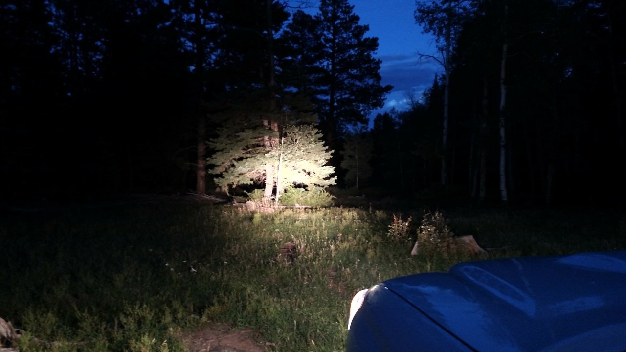

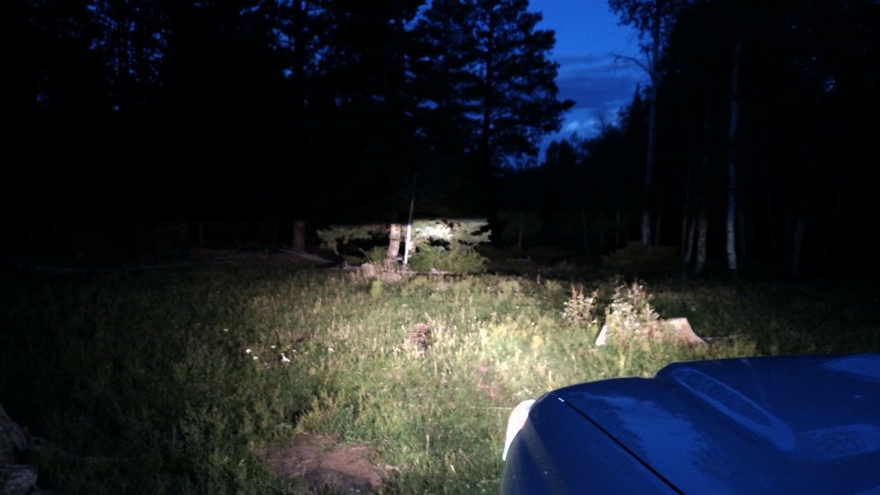

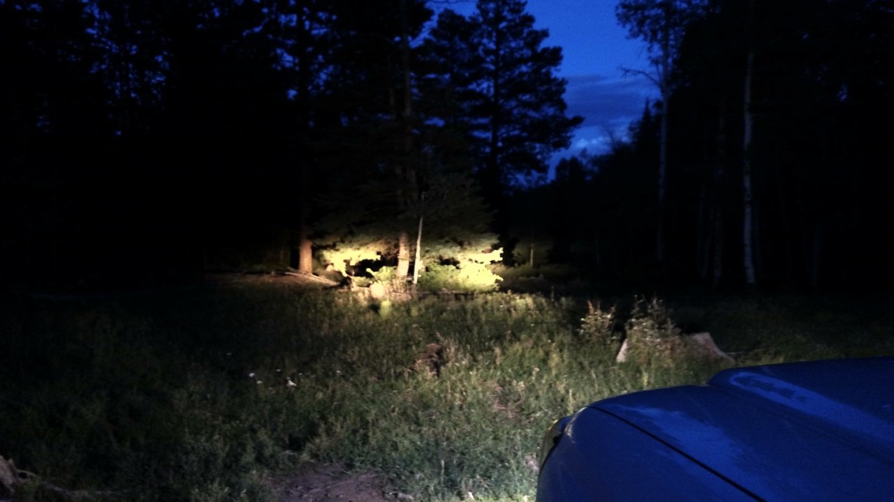

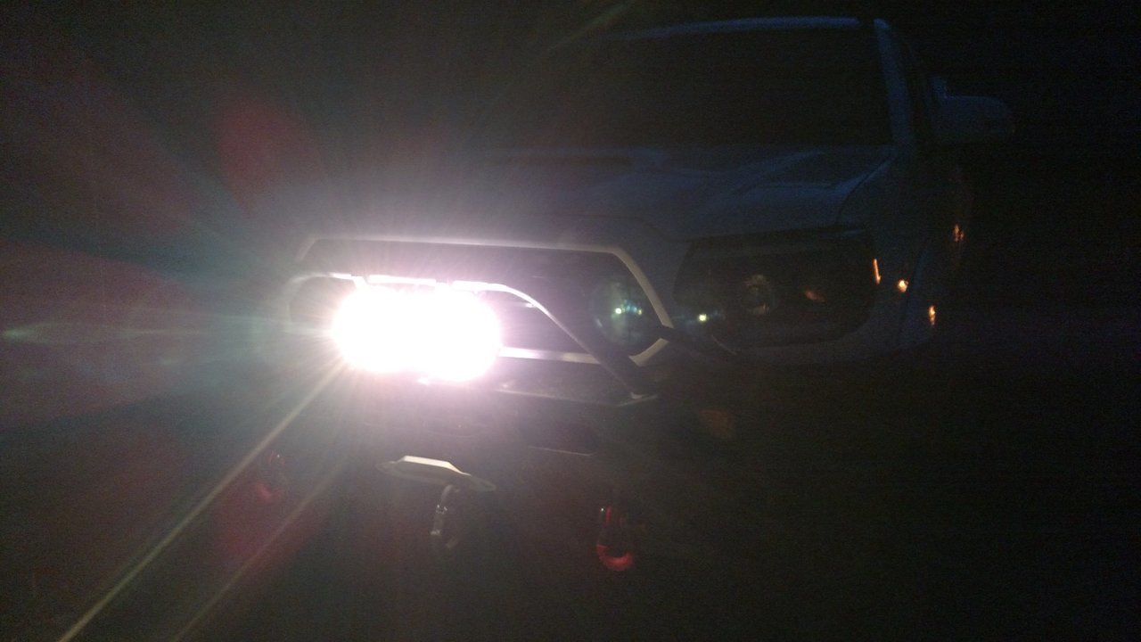

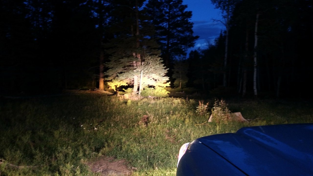

    The following pictures were taken with the truck pointed at a tree in a clearing, with some open space behind it and more trees beyond that to demonstrate projection. I wasn't worried about shooting at a flat wall to capture the flood pattern. These lights are all well-developed by established companies, so the flood pattern is not a concern. Keep in mind that my headlight housings are aftermarket, with projectors that produce, in my opinion, better light throw than the factory lights, both in low and high beam mode. Also, these pictures were taken with my android phone, because my camera was set up and ready for milkyway photography. The PIAA lights are aimed about level with the low beams, but wider, so they are pointed a bit more to the sides; just enough to fill in some extra light on the sides of a trail with either the low or high beams on. The way I have them mounted, I could easily get out and turn them to point even further to the side if I needed them for twisty, technical sections of trail at night.
    Low beam only
    High beam only
    High beam and two PIAA 520 driving lights
    PIAAs only
    The second thing I noticed is that these lights are more spot than flood. Not a pure spotlight, as they do flood a decent amount of light, but certainly more spot than my high or low beams.

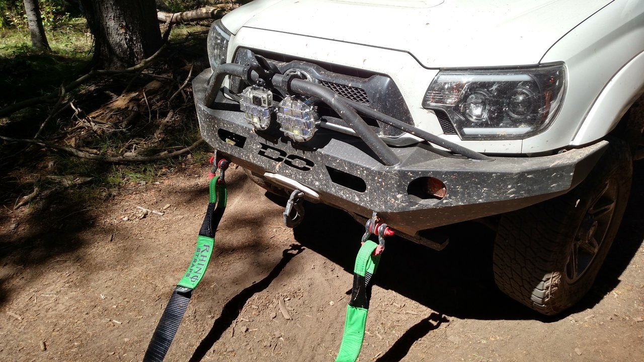

    The plastic grilles took no damage during my 4000+ mile overland trip, so I'm not worried about them being plastic. It's probably standard material on most offroad lights these days, I'm just used to using metal grills on the motorcycles I've built. These lights never showed a hint of fog or moisture buildup. They did see rain, deep water/mud (though they were not submerged), splashed water/mud, and one serious power-washing about halfway through the trip.
    Pulling a large tree out of the path with my Rhino Strap.
