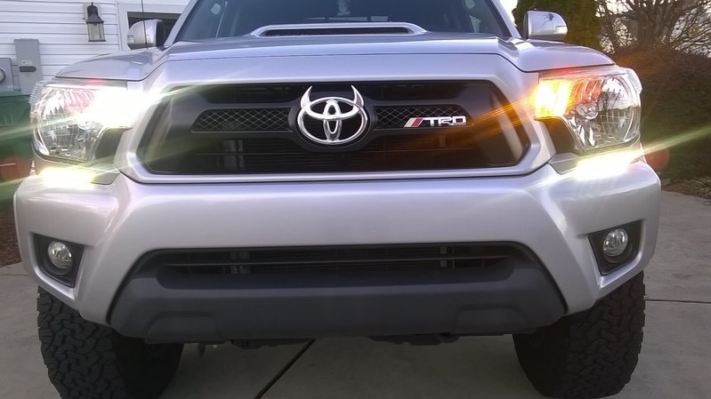

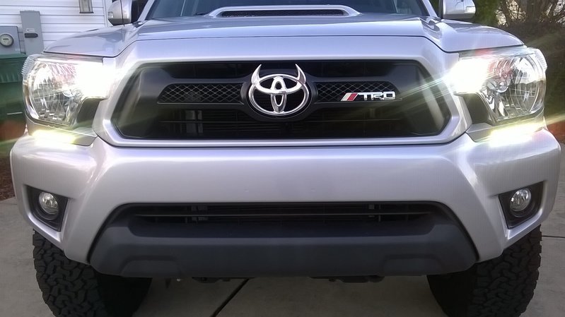

    If you really want to get all your front light colors the same. Throw on a set of LED daytime / turn signal bulbs like VLED's switchbacks so you can ditch those God awful (my opinion) Amber bulbs.
    dtopgun515, Mush Mouse and ChadsPride like this.
