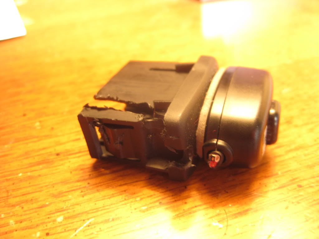

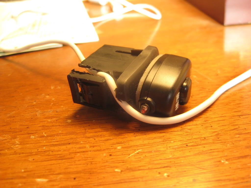

    I can throw some pics your way tonight when i get home of how I fabbed my blanks a while back to accomidate the PIAA switches. Takes patients but its not hard with the dremal tool.

    Here we go Bill. This was how the switches were done before I got the Toyota switches.
    White wire for illustration only.
