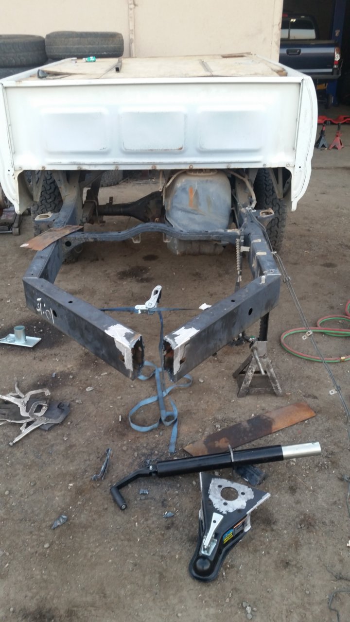

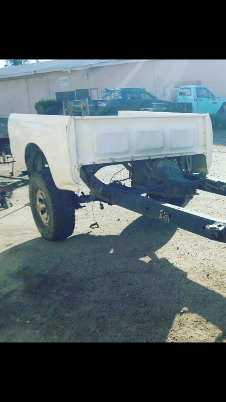

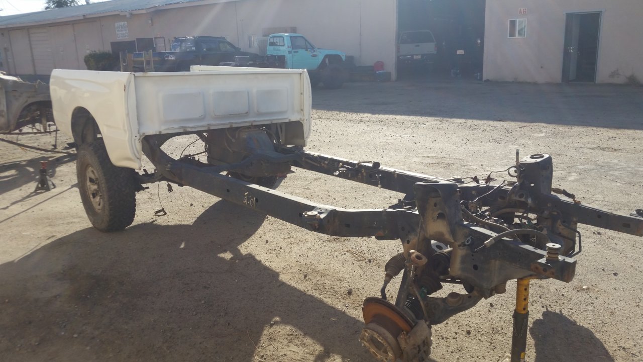

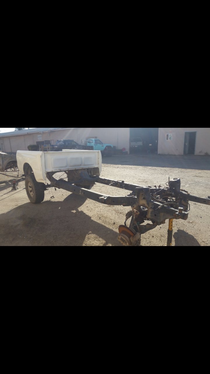

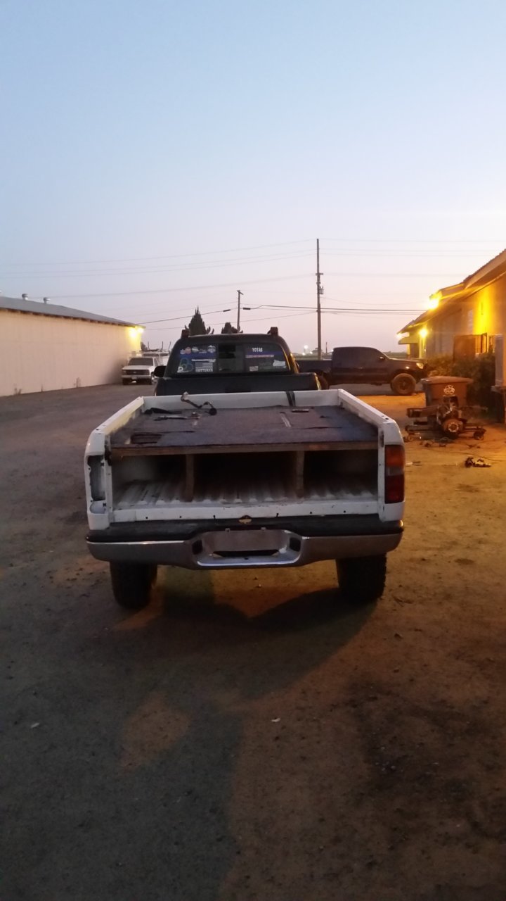

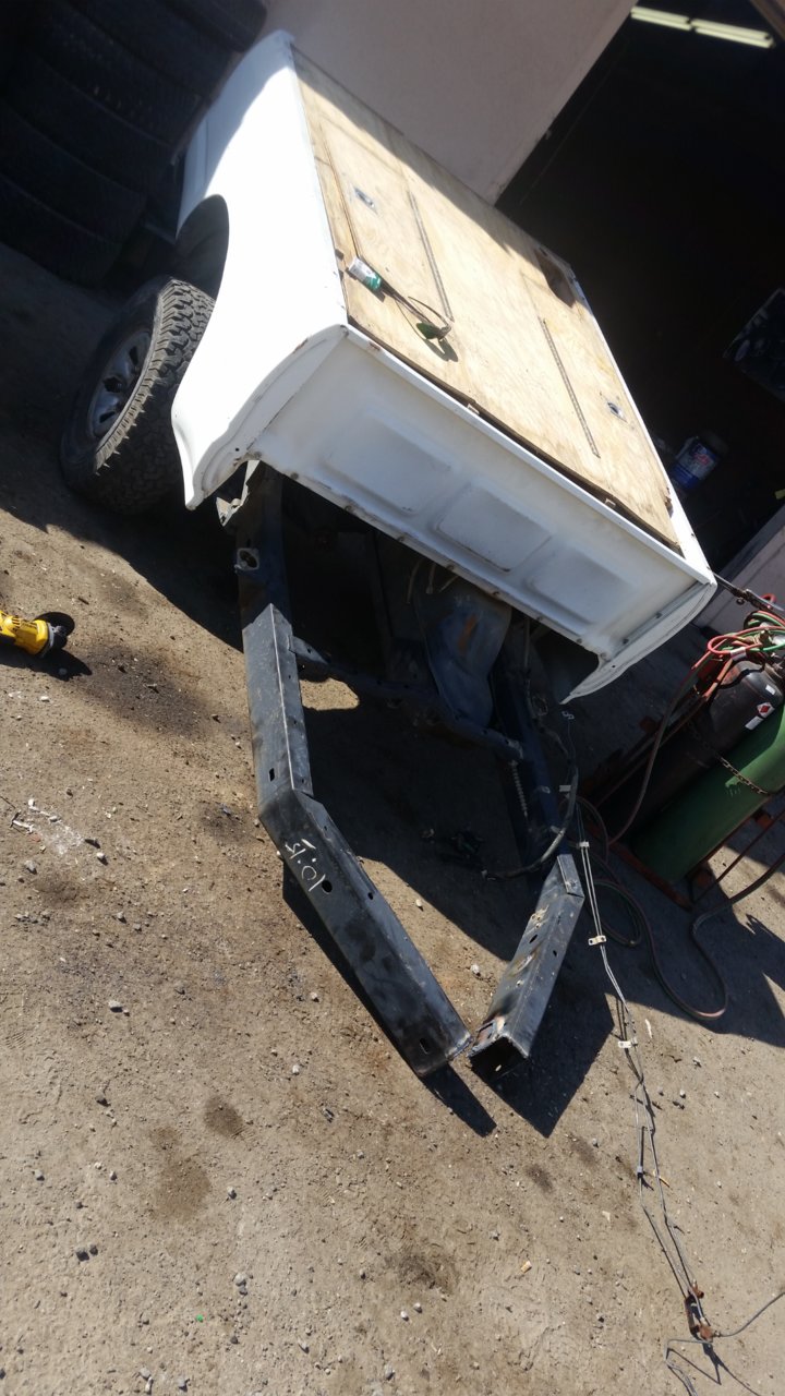

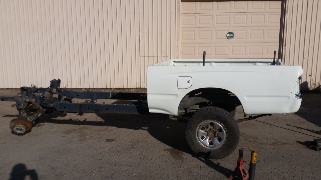

    started out as a parted out 00' tacoma bed, frame, rear/front end.

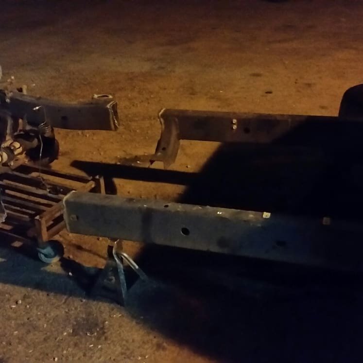

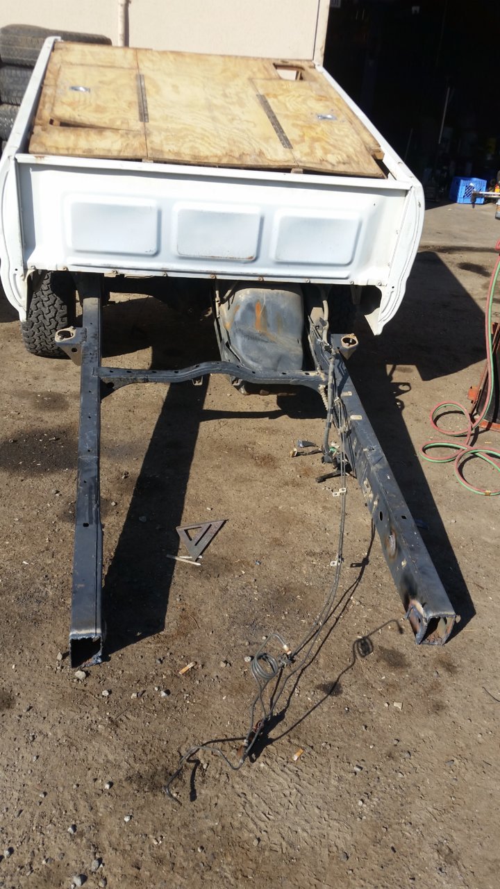

    next step was chopping off the front end

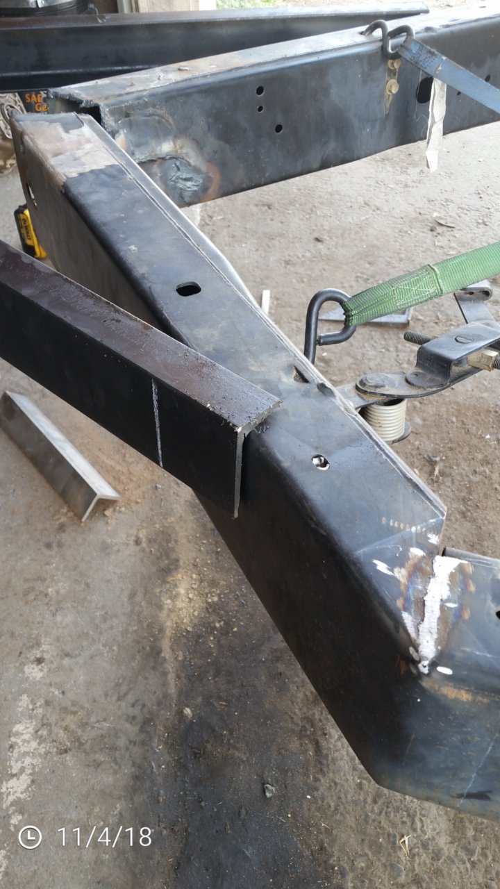

    and notching the frame so we could bend it in for the tongue/support

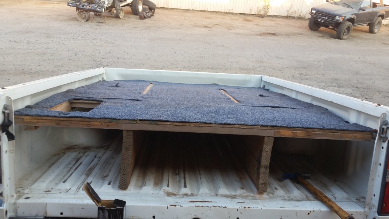

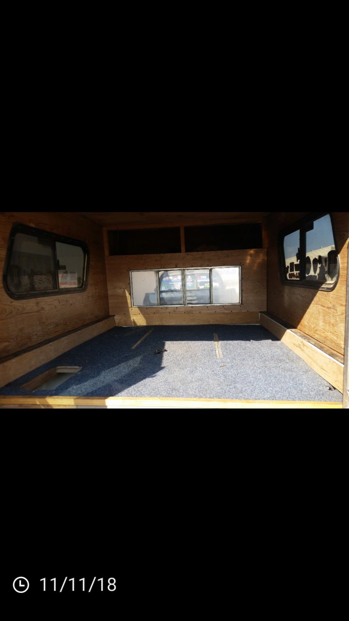

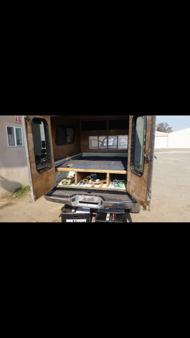

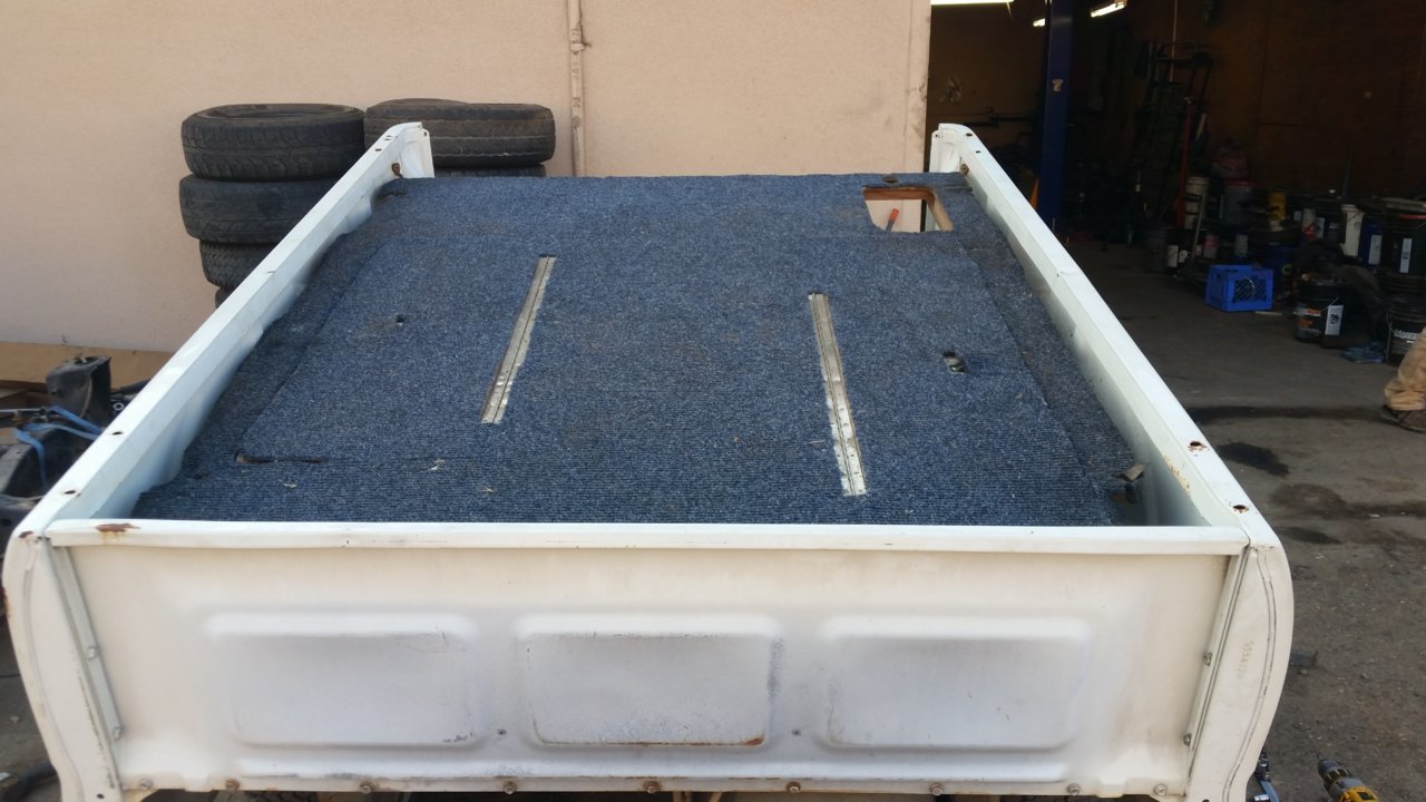

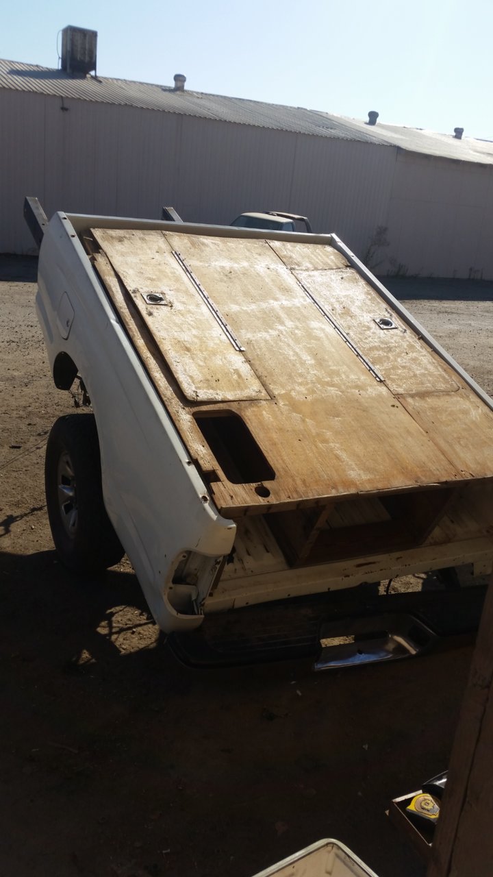

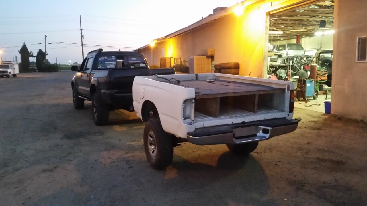

    added the bed deck/drawer system and put carpet on it
    Screenshot_2018-12-25-09-41-29.jpg 20181019_145157.jpg 20181019_172050.jpg 20181019_172039.jpg

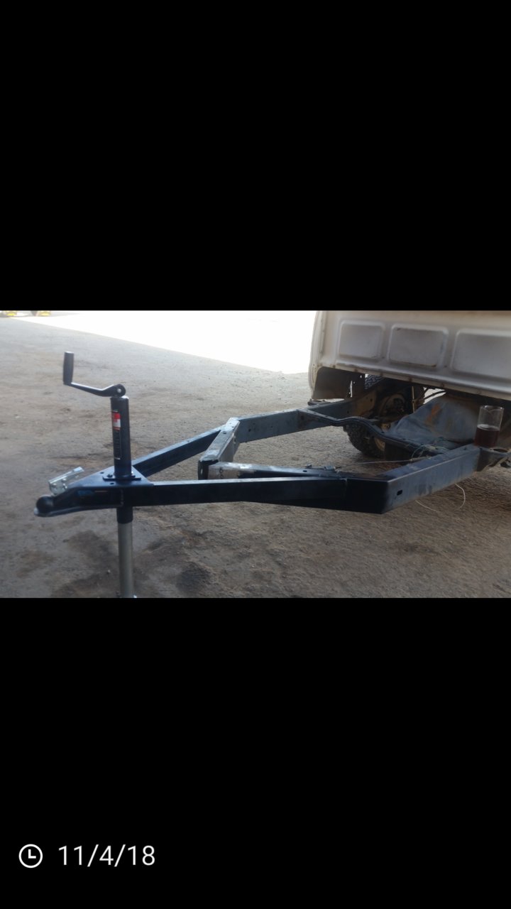

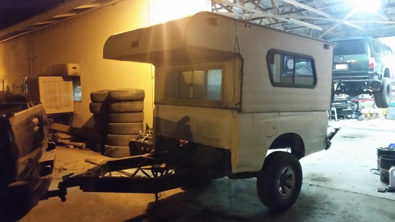

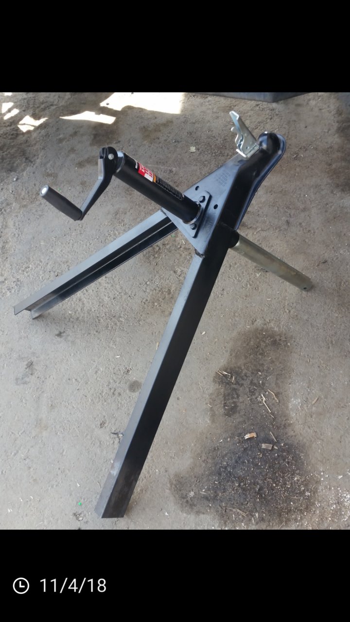

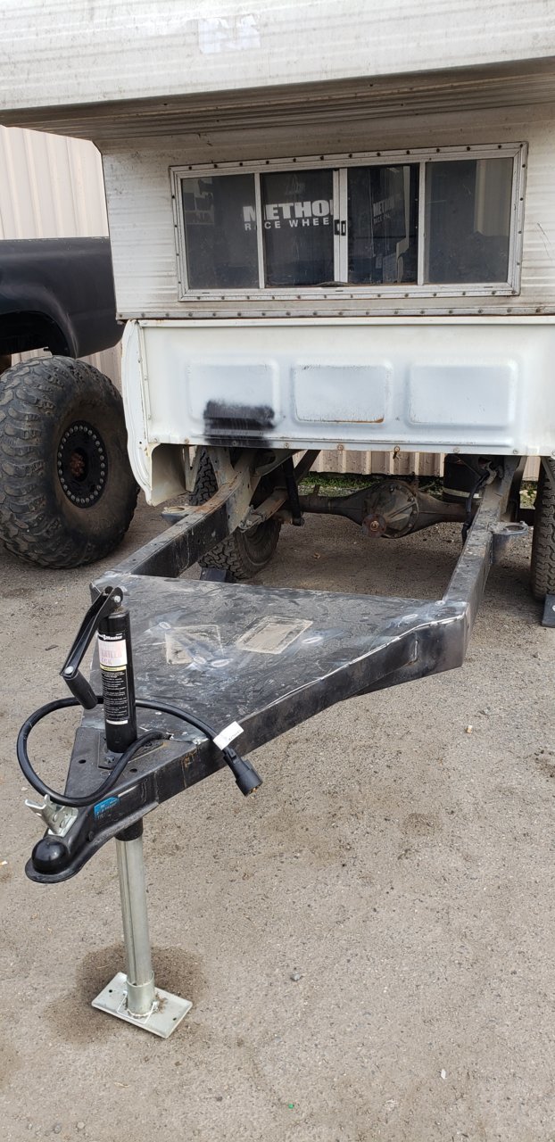

    built the tongue using 3" C channel off of the original frame
    Screenshot_2018-12-25-09-43-07.jpg Screenshot_2018-12-25-09-42-54.jpg Screenshot_2018-12-25-09-43-00.jpg

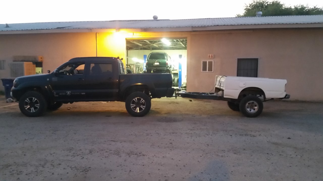

    hooked up to the truck to check it out

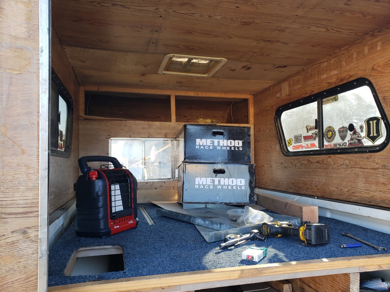

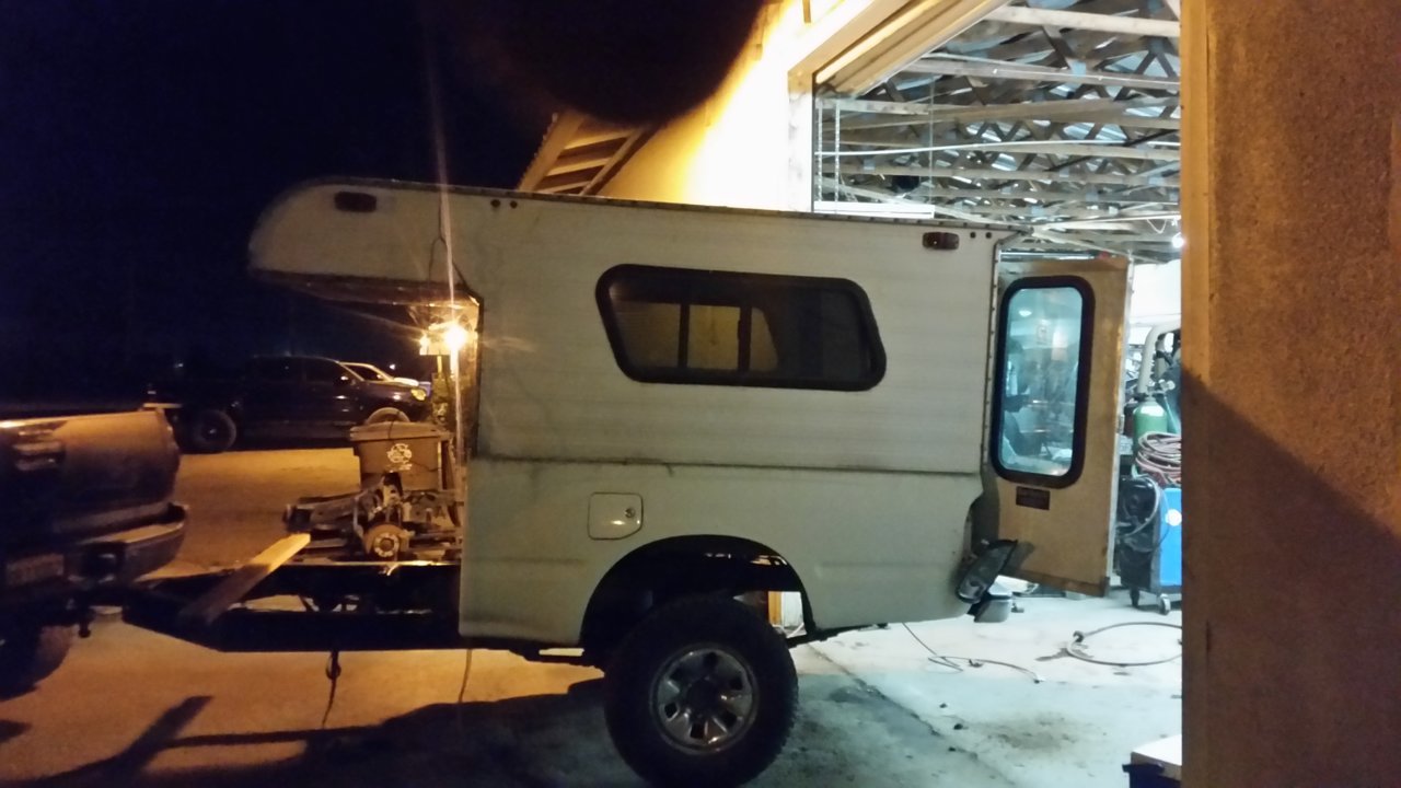

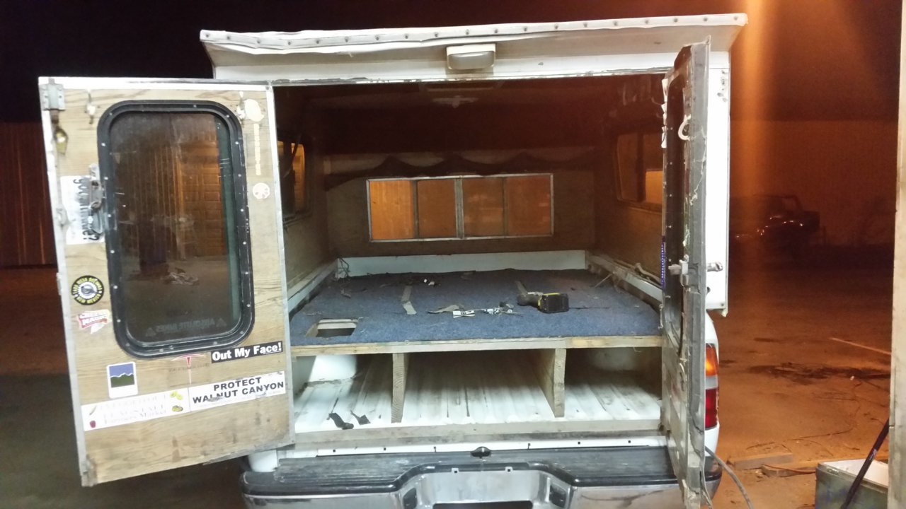

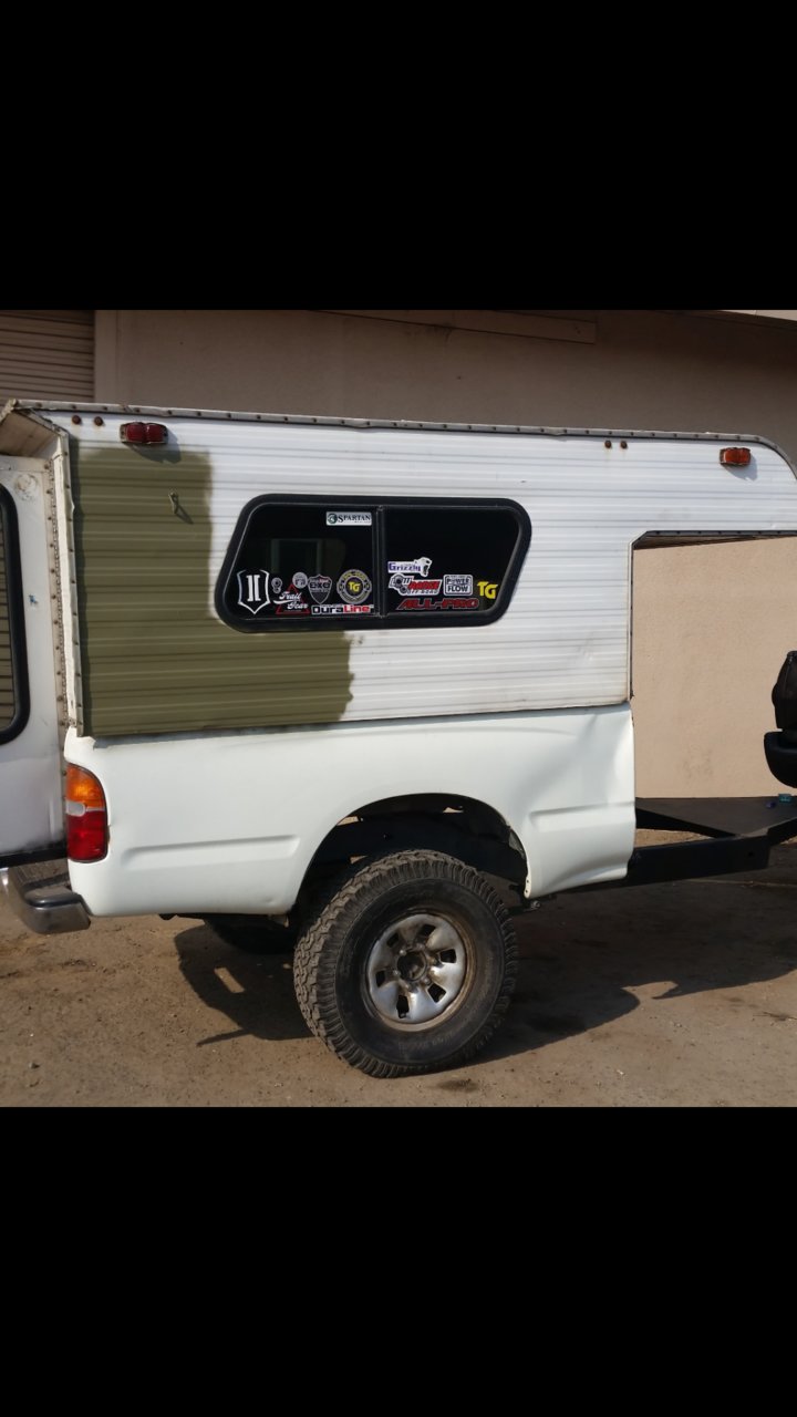

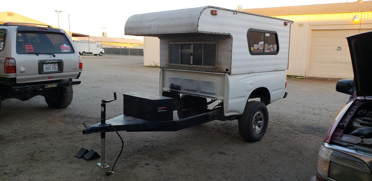

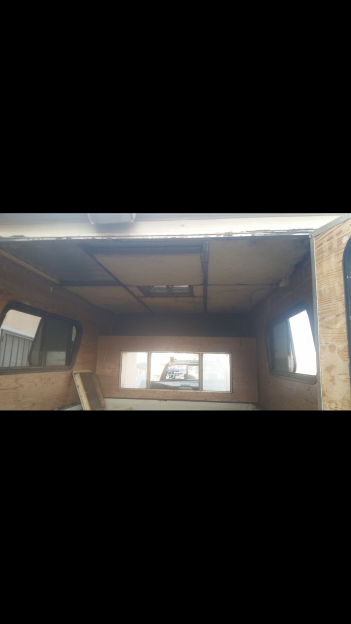

    added a cabover built for a 1st gen tacoma bed. started removing the old panels and insulation so i could run new wiring, replace insulation and install new wood wall panels
    20181019_205943.jpg 20181019_205502.jpg 20181019_205520.jpg Screenshot_2018-12-25-09-40-31.jpg Screenshot_2018-12-25-09-40-23.jpg Screenshot_2018-12-25-09-40-33.jpg Screenshot_2018-12-25-09-40-29.jpg Screenshot_2018-12-25-09-40-41.jpg 20181230_140809.jpg

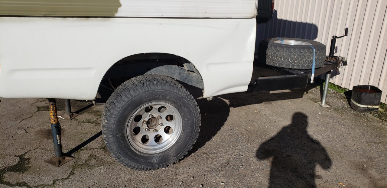

    cut and welded a piece of sheet metal onto the tongue (leaving the gap between the frame directly below the overhang)

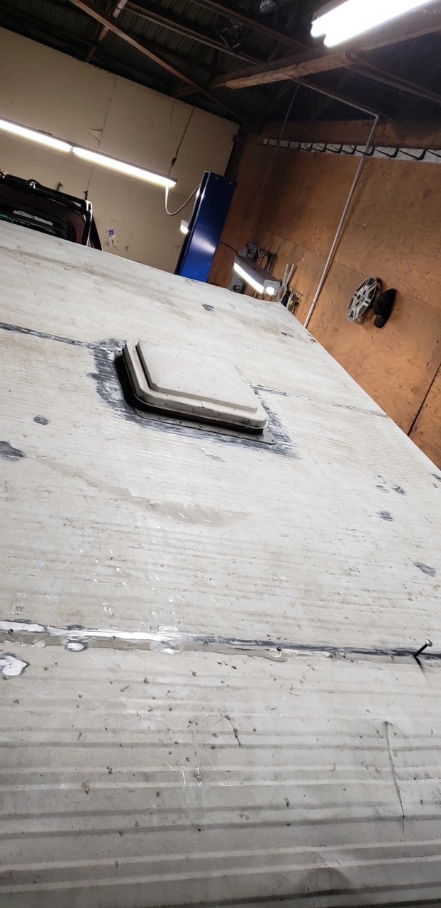

    removed all the old sealant along the seams of the roof and resealed
    new wheels and tires! :)
    went for its maiden tow to our new house 2 hours north

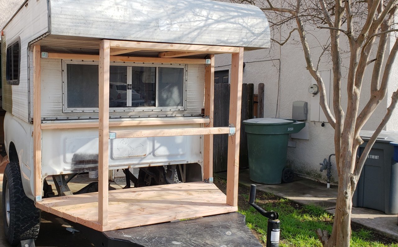

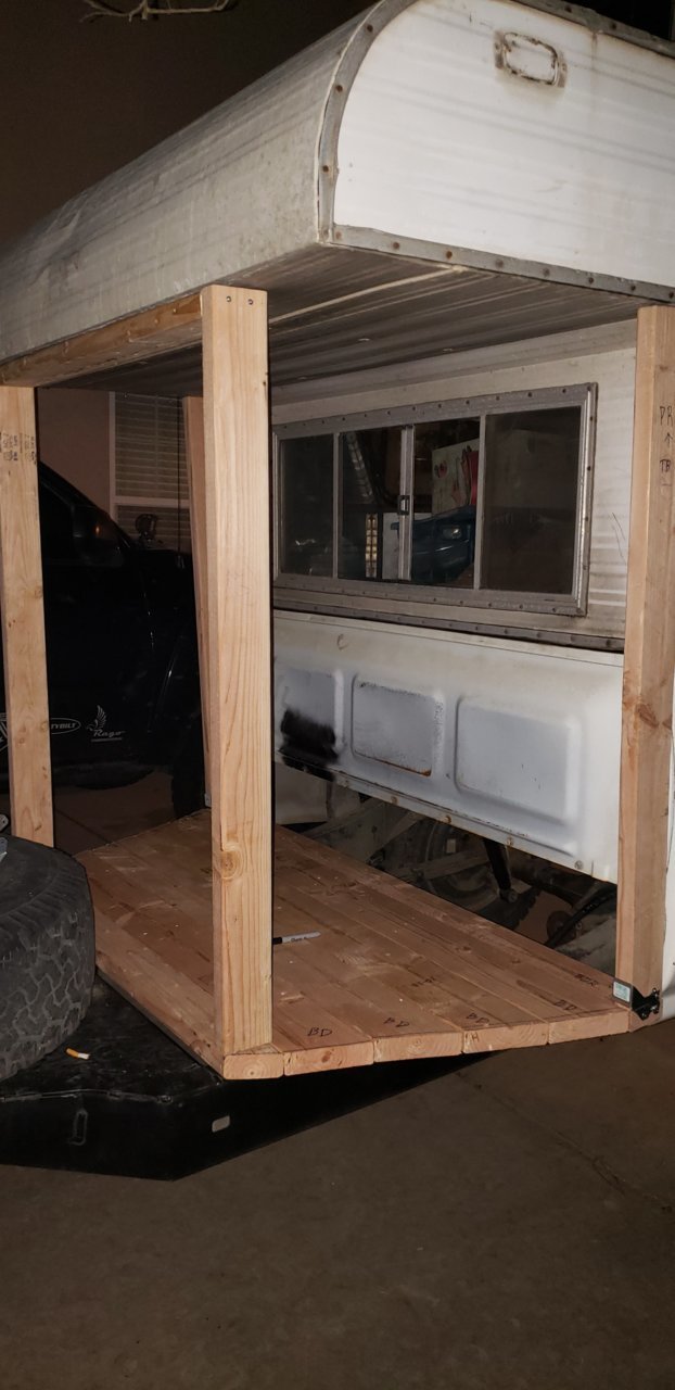

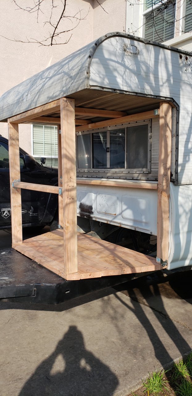

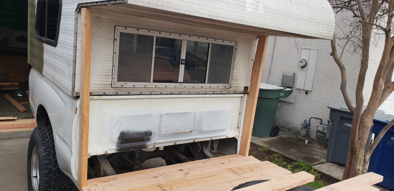

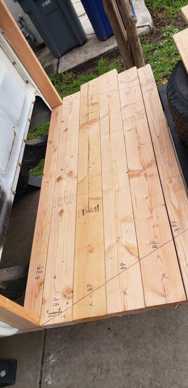

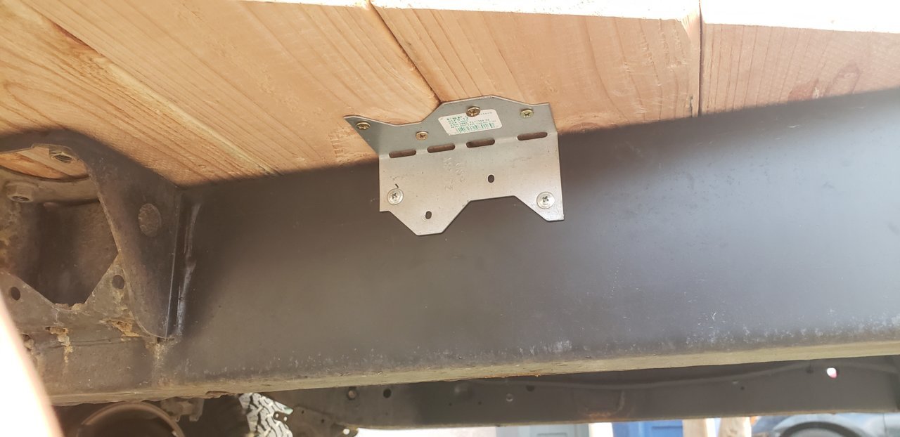

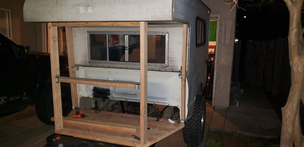

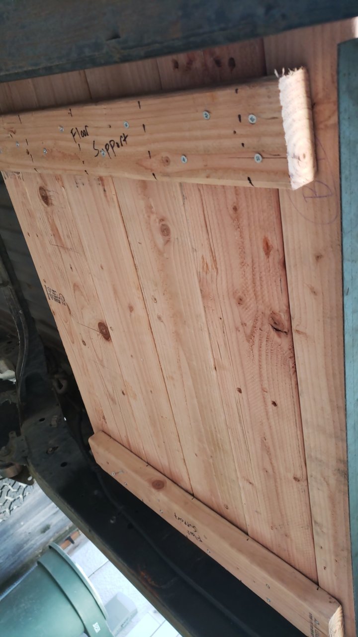

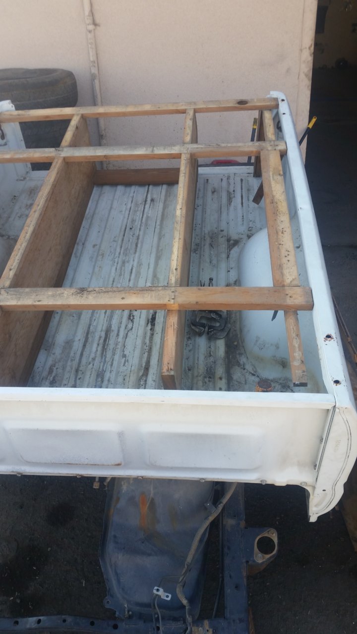

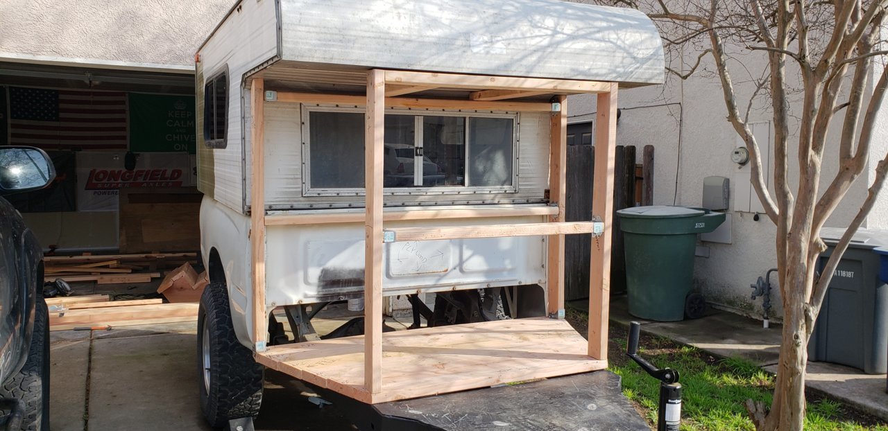

    acquired a bunch of new lumber and started building the storage compartment under the overhang on the front. got most of the framing finished, used 2 2x4s underneath the base to tie the baseboards together and secured baseboards to the frame with brackets (will be putting more brackets on the other boards)
    20190128_152707.jpg 20190128_152222.jpg 20190128_181158.jpg 20190128_194800.jpg 20190130_165633.jpg 20190130_165314.jpg

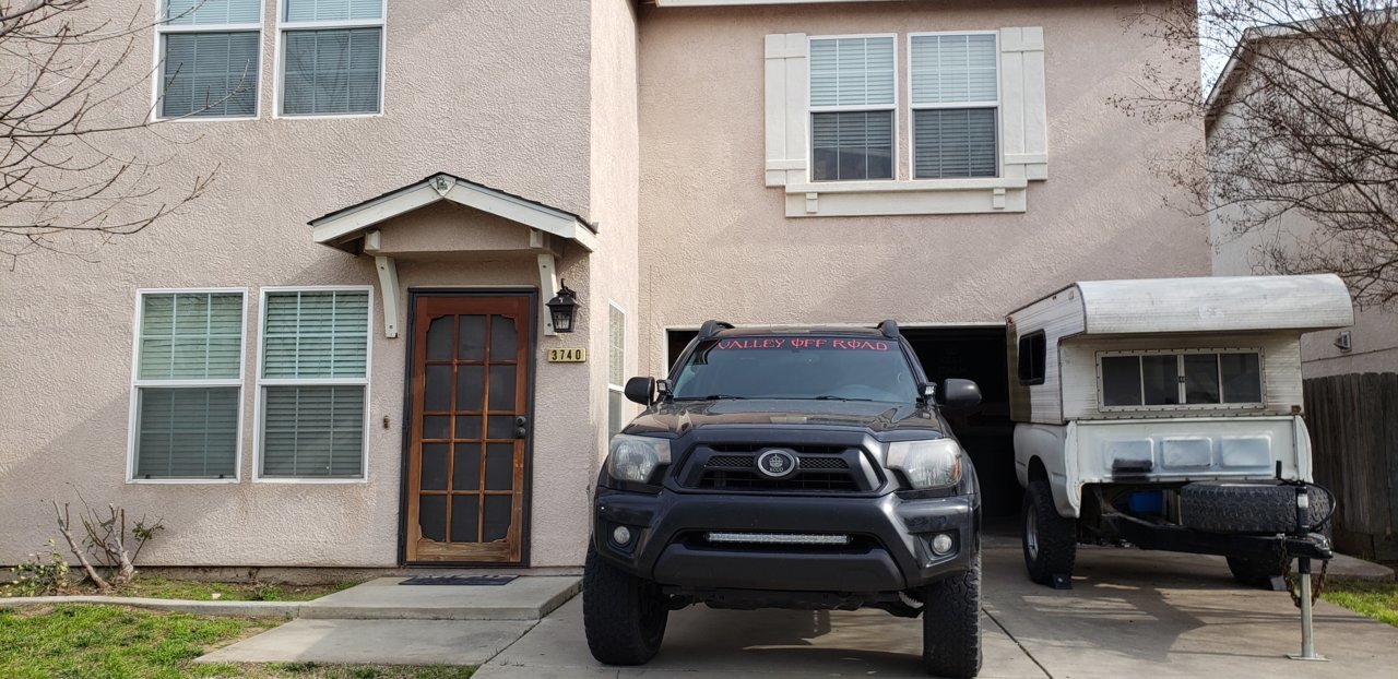

    how she sits now. until i can go get some plywood and other things

    Few other things

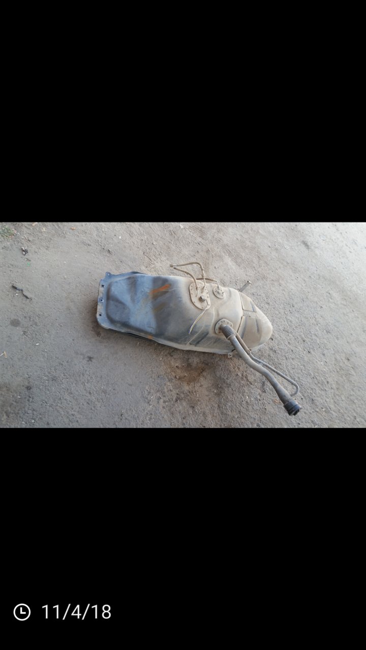

    -Gas tank was removed because i am planning on putting an RV/Camper fresh water tank underneath with a 12v pump. inlet/outlet ports will be in the stock fuel cap location
    -Front storage area will have solid wall on front side and a top to bottom door on driver and passenger side for access. there will be a shelf across the middle for a storage area accessible from the inside of the cab-over.
    -Battery, inverter, etc. will be in the lower front storage area, with propane tank either in same area or out front on the tongue

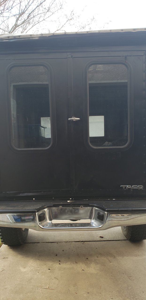

    Took advantage of the sun being out for a bit and painted the trailer. Got both sides done. Ran out of paint and sun so wasnt able to do the roof yet. The dents definitely show more with the black paint but it's a camp trailer. It will be fine lol. Rear and sides ~90% complete. Got decent coverage with the 3 cans I had. Figure about 6 more cans needed. 1 more per side and rear. And then 3 for roof
