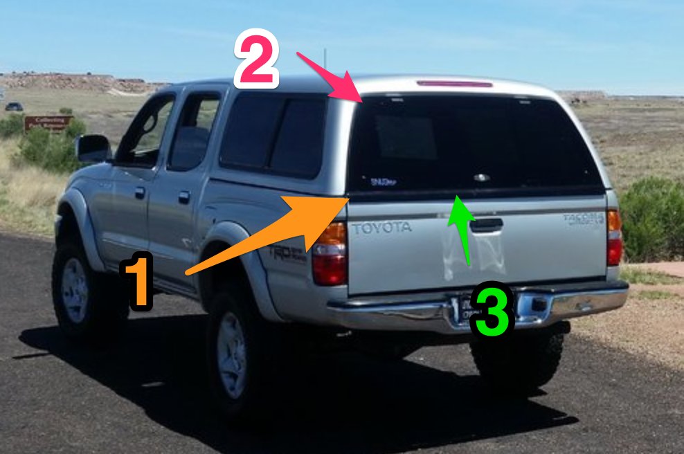

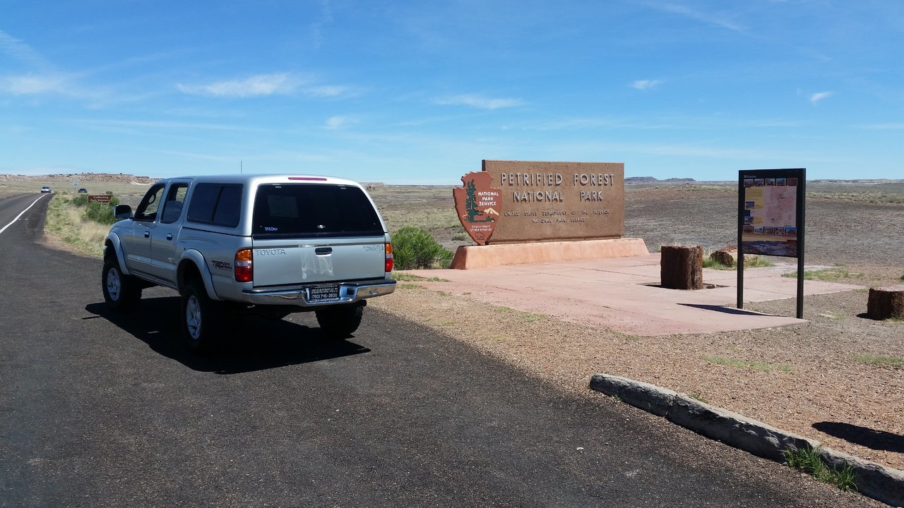

    I purchased an 03 with a snug top last year. I've since removed it as it leaked a little in the back and was debating selling it. After reading this thread, it appears the snug top is a popular top. I don't know much about tops and would like some input about what makes this a desirable top.
    The pics are from the dealer in California and my road trip back to VA.

    Because it makes the Tacoma look like an SUV? It's flush and modern looking? It fits the body lines of the Tacoma?
    As for your leaking problem, that's probably user error or dealer installation issues unless there is actual damage. Properly installed quality seals will keep water from coming in.
    Where was it leaking? My guess is at #1 because that strip of plastic/rubber looks to be trimmed too narrow to force the rain to drip outside the tailgate as it runs down vertically.
    The other thing you want to do to keep water out is to install a seal around the tailgate, which most people don't have. My truck with a commercial shell never leaked and it had seals everywhere including the tailgate.

    Thank you for the info. Until buying this truck, I've never really paid attention to the tops available and that all makes sense.
    The overlap on the tailgate covers enough but I had a feeling it was a combination of a worn out back glass gasket and bad adjustment. The friction pad on the left side of the lift glass had rubbed all the paint off of the tailgate. I have subsequently had it repainted since bringing it home but would need some new parts before installing the cap again. Cheers!

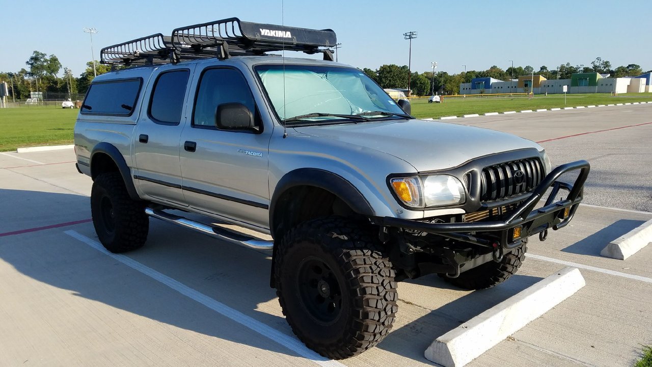

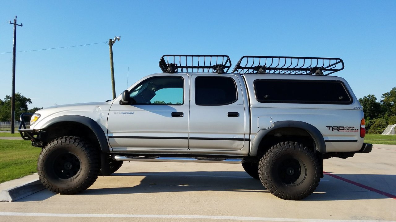

    ARE Shell
    ARE shell. I love the windows that flip up and allow full access to the bed. I added yakima racks/baskets up top. I also have drawers i built the bed. Im planning on sleeping back there on bike trips. I do have to fix a leak at the rear of the bed though.
