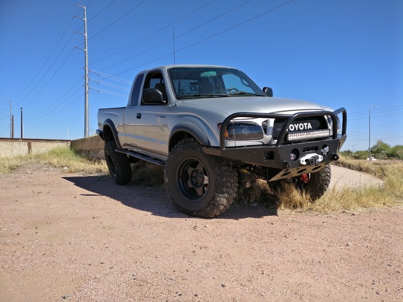

    Axle relocation in the rear, trimmed plastic and beat the pinch weld. 3.5 bs wheels

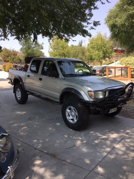

    King extended coilovers w/AP uniball ucas, Bilstein 5125 10" on AP Expo leaf pack. 255/85/16 KM2 on Weld Racing (4.5bs)
    Haven't had to modify anything so far, slight run on frame when turning passenger and it barely rubs at full articulation. Not enough to warrant any modification to the wheel well.

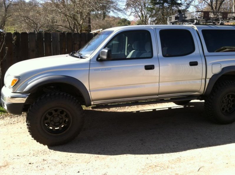

    This has come up several times lately. Seems like 3.5 BS is what you need to stay off the frame. I'm at 4.0 BS with my wheel+spacer combo and still barely rubbing frame. Pinch weld smash and plastic trim for me as well.

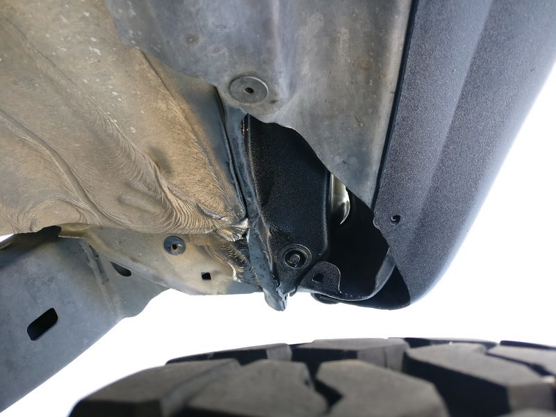

    Interesting...
    I've trimmed the rear of the well and smashed the pinch weld. I'm clearing there now. I'm still rubbing the top of the well at full stuff and some plastic in the front of the well. Both should be an easy fix.

    quetzal your picture wont load up for some reason.
    rngr, I've looked at that many times, it's great.
