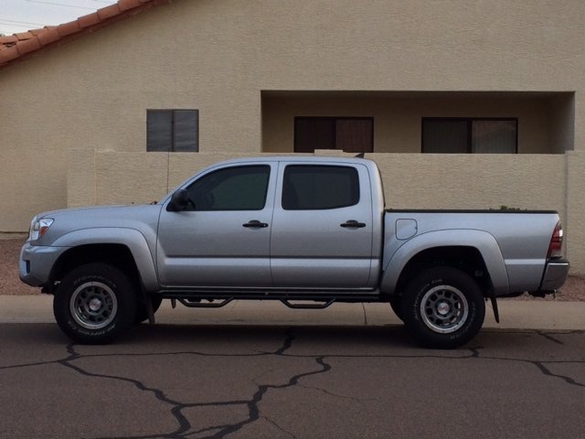

    I have the standard wheelers 3 leaf lift. 5100 all around. Front set to 2.5 on trd offroad springs in the front. Removed overload leaf in the rear. No complaints though I've never rode in a 1 leaf AAL lift.

    standard(non-hd) wheelers 3 leaf progressive aal. added on to non tsb leaf pack.
