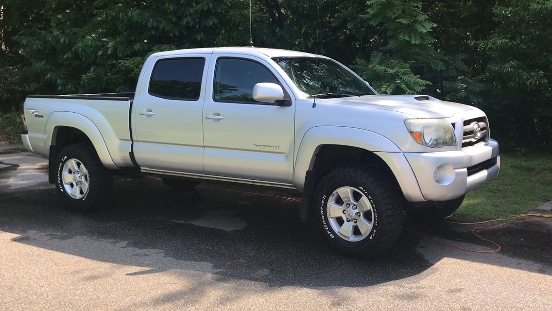

    IMG_1251.jpg Billstein 5100 all around. Front set at 2.5 and rear with 2 in add a leaf. BFG ko2 265/70r17. I'd steer away from body lifts if possible and go with a suspension lift, just my $0.02

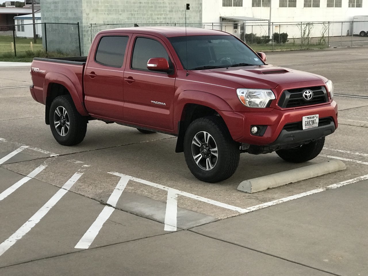

    Heres when my truck had 2in up front with 1.5 in the rear with 265/70/17 youll be fine it wont look like you described.

    What did you use to lift the front and rear? Blocks or what? If you have the specific product, I’d like to just replicate your lift setup. Your truck is really beautiful.

    Thanks my truck has evolved alot more since this was taken. Set up st that time was icon coilovers up front with SPC upper control arms, rear was 3 leaf AAL an icon rear shocks.

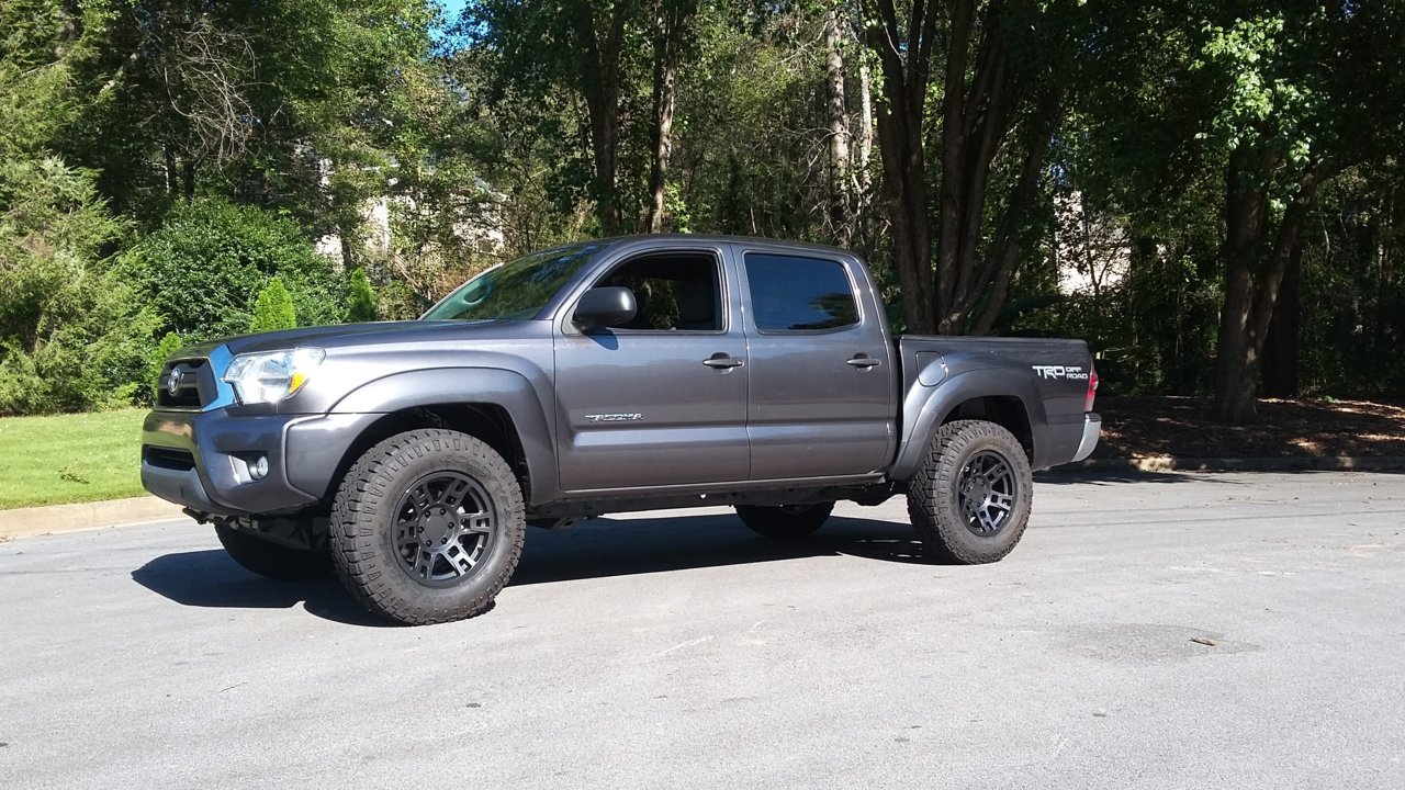

    Don't do a body lift unless it's just a 1in and you need to to help clear much larger tires in combo with a suspension lift. Have you ever seen a jeep that's frame was pretty low and it's body was high and you could see straight through to the other side between the two but it at least had bigger tires....looks like garbage. IMHO
    front: 5100 bilstein shocks set at zero, 885 old man emu springs.
    Rear:5100 bilstein rears, Deaver 1.5-2in add a leaf
    wheels: 17x8 fn fx pro's
    tire: 265 70 R17 Goodyear Duratracs

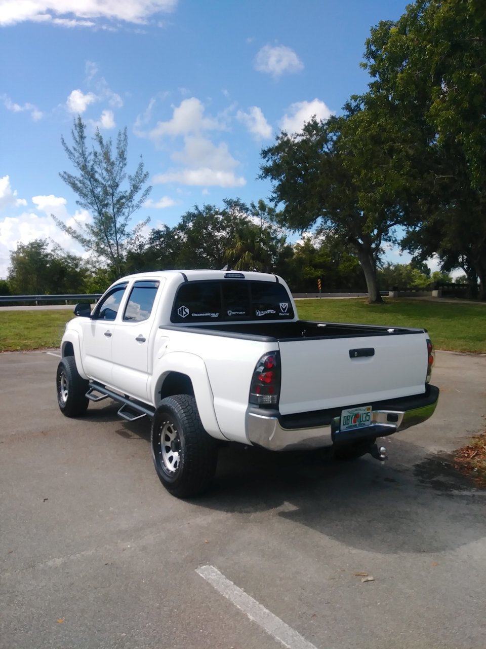

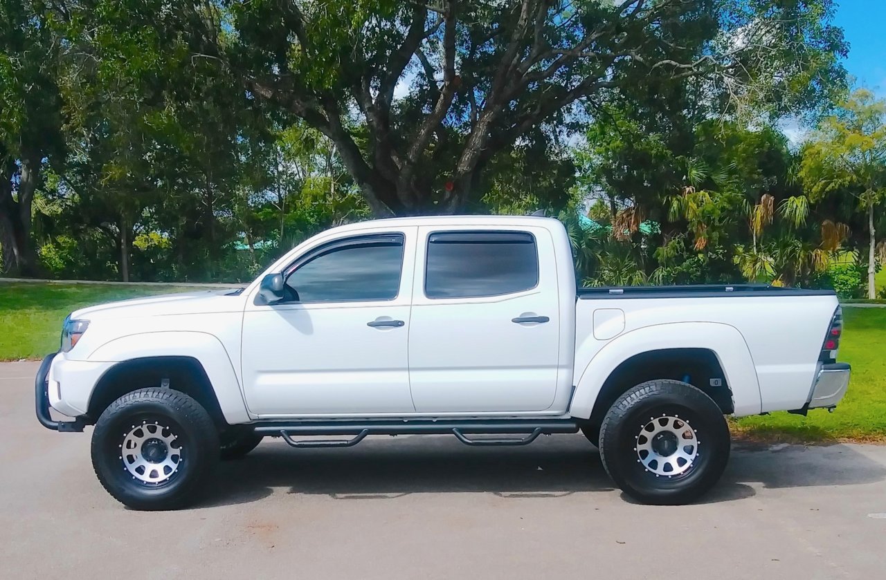

    with 4" - 2" and 265/75r16

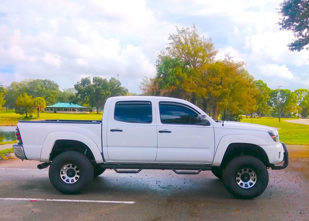

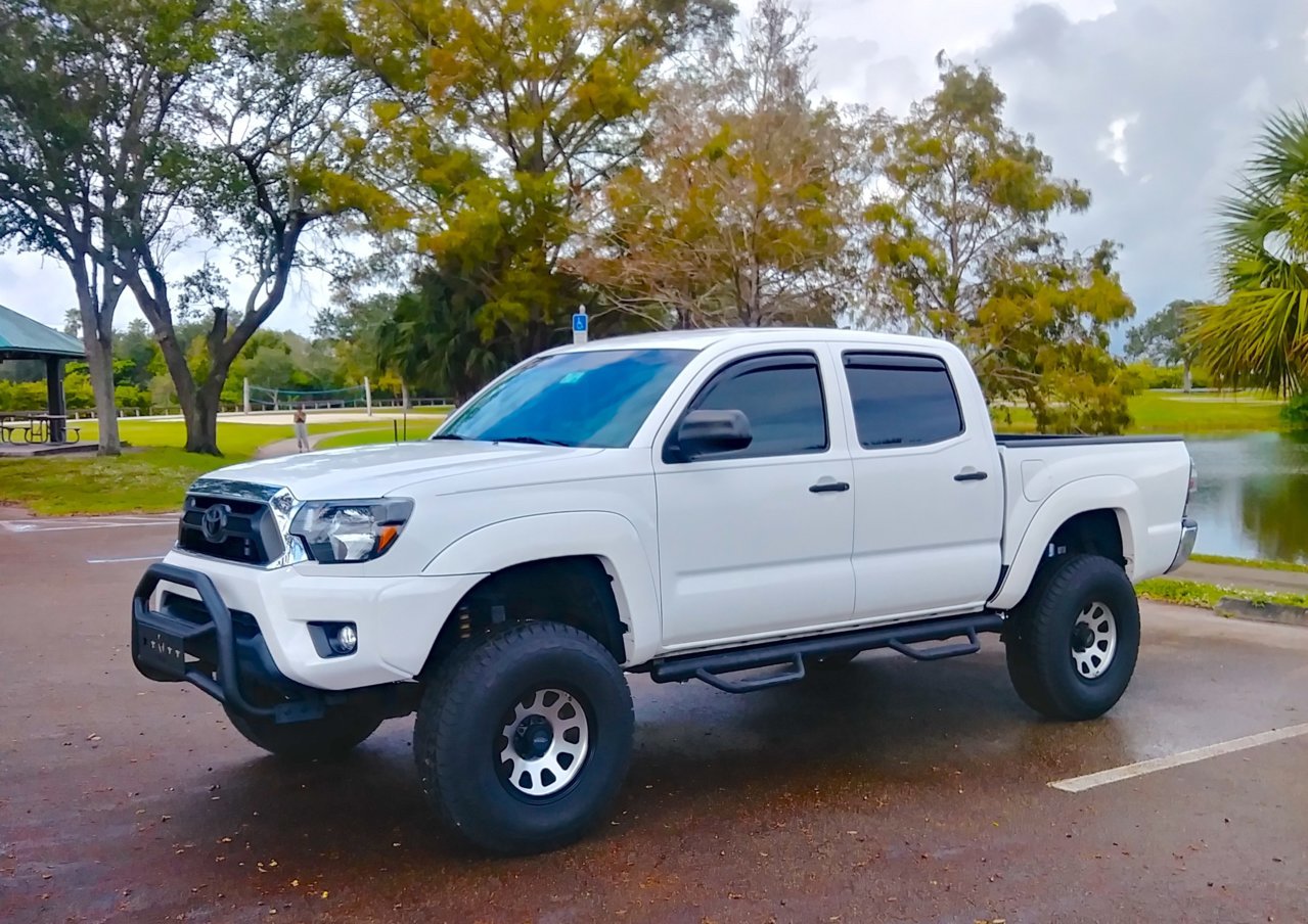

    And this is how the truck looks right now with 5" - 3" 285/75r16
