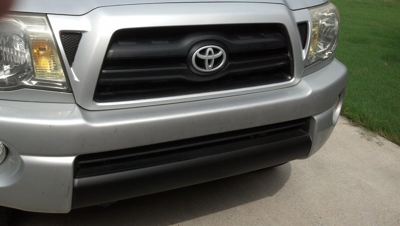

    Hey everyone,
    My apologies if these already exist somewhere, but I couldn't find exactly what I was looking for when I searched here and Google.
    I want to see what a set of Hella horns (supertone or sharptone) looks like behind a factory 2005-2010 grille. I got a set of sharptones to install but can't decide if I want to bother painting the horn grilles silver or leave them yellow (truck is silver streak). If they're not visible I won't worry about it. Otherwise bright yellow just won't do with a silver truck I don't think.
    Thanks!

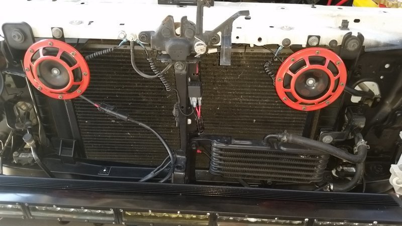

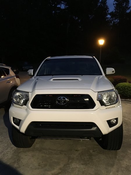

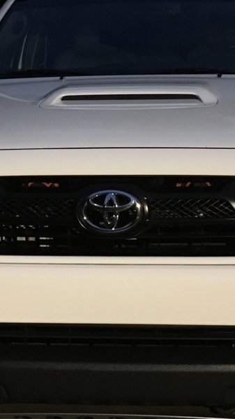

    I know you asked for 2005-2010 but here are a couple of pics from a 2012. I have Hella Supertones with red grilles. Instead of using the factory location for the horns, I wanted each one somewhat centered just because I thought it would look better so I mounted them to the left and right of the center of the grille. You can see them behind the grille but they are not really that noticeable.

    How did you mount them? Was drilling necessary?

    I had to drill 1 hole on each side for the mounting bolt if I remember correctly.

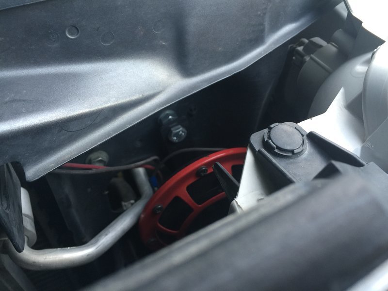

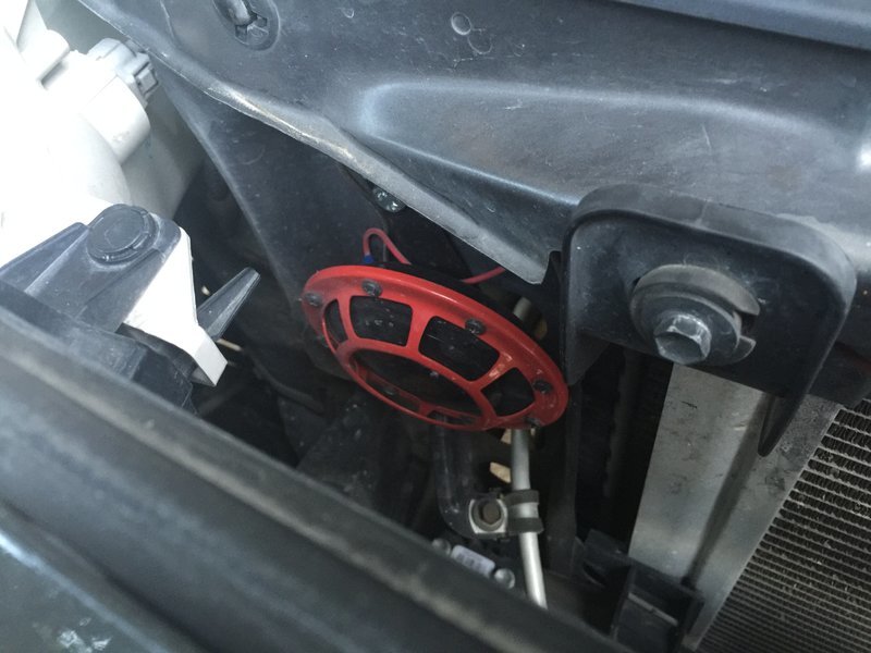

    I installed mine without drilling anything. They ended up more behind the headlights than behind the grille. Keeps the grille area looking clean, doesn't require any mounting work, and was super easy.

    Any pics during/after install?

    So in his top photo, you can actually see the holes I used to mount mine.
