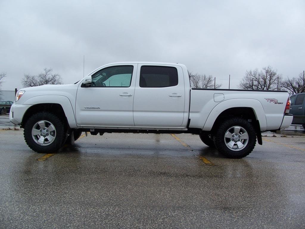

    Looking to get 265/75/16 on my stock 16" rims for an 2009 Tacoma 4 door 6spd manual, with TRD suspension, Those should fit fine correct ?
    Second, Looking at a 1" rear block kit and a Front levelling Suspension kit 2.25", to level the truck out and give it a bit of a lift.
    My final question is how will this look with the new tires on, will they look to small or big enough, anyone have a pic I can reference please.

    5100's @ 1.75" on stock trd springs
    1" readylift block in the back
    265/70/R17 pretty much the same as the 265/75/R16
    just to give you an idea....

    265/75 will fit fine on a stock truck
    a majority here will tell you to stay away from spacers and do it right, for good reason
    Might I suggest 5100s and an AAL for a "bottom of the price range" set up
    If you google toyota tacoma 265/75r16 or search it on here you'll find a ton, it will look fine with a mild lift (ie. 5100s set at 1.75 and a 1.5 AAL) or and Old Man Emu set up
