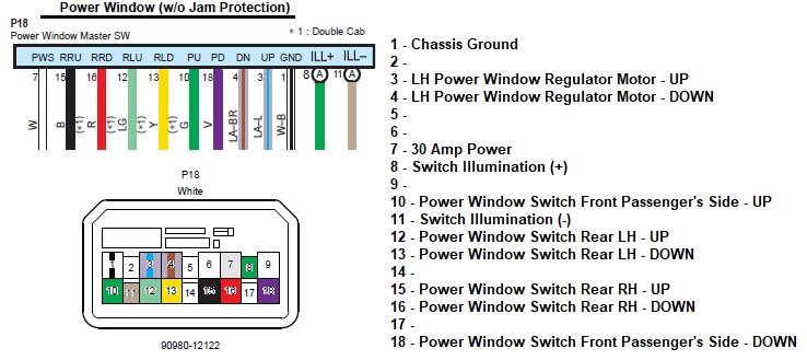

    Would like a picture of this connector to confirm the wires as exposed here. It's for truck without Window Jam protection. It's the window control on the driver's side.

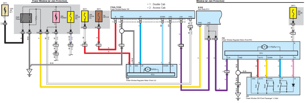

    Hey guys, I accidentally yanked a wire out removing the door panel replacing speakers on drivers side. It is the (7) gray wire on the diagram for Window with Jam Protection. The diagram here says that wire 7 is for LIN2- Towards main body ECU. What does LIN2 mean? Can I drive it around for a while until I get a chance to fix it next weekend? The only thing I've noticed is that the drivers side window automatic up does not work.

    It's important, but not essential. LIN talks to the Main Body ECU, and in your case, to control the anti-jam feature of the windows, sliding roof included and any auto features of the window(s) controls.
