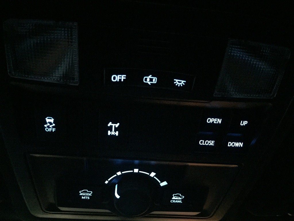

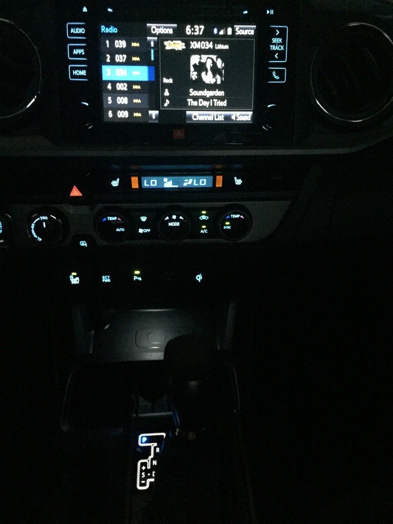

    All buttons and knobs are illuminated which I wasn’t expecting. Even the over head buttons and knobs. Also a decent light in the phone charging area.

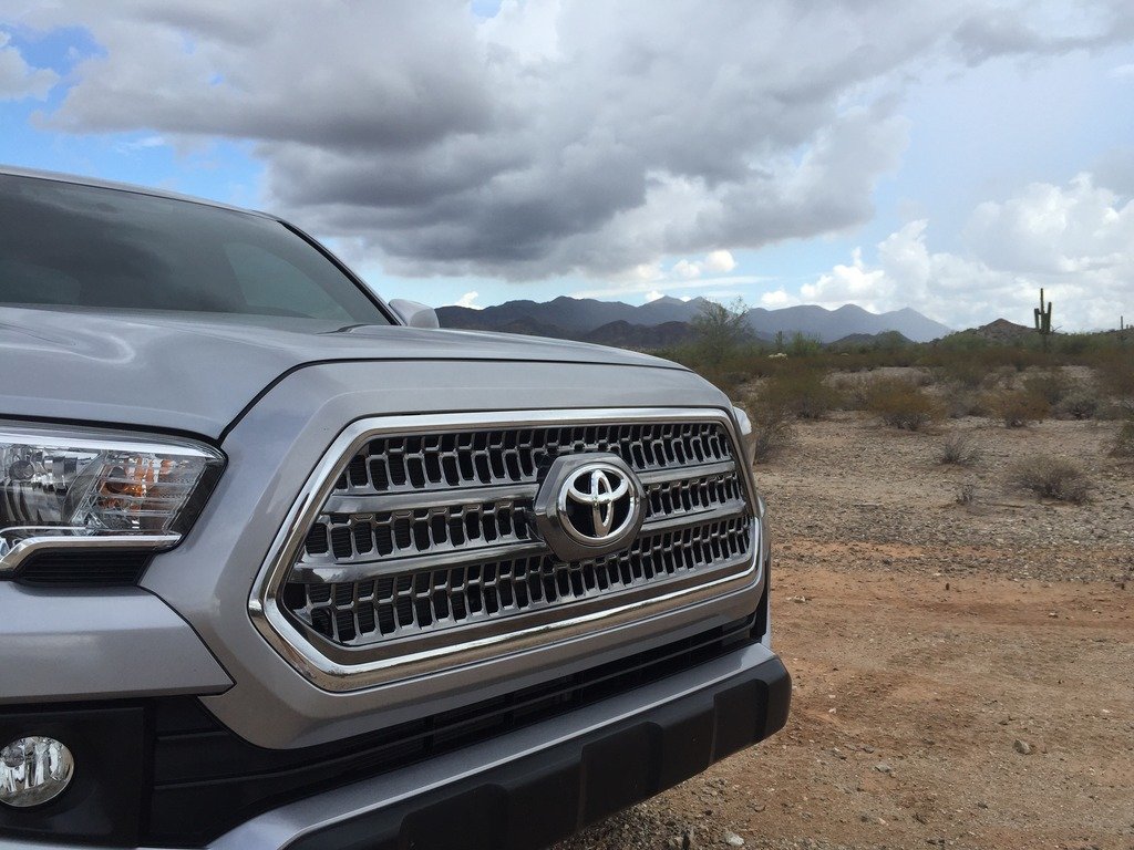

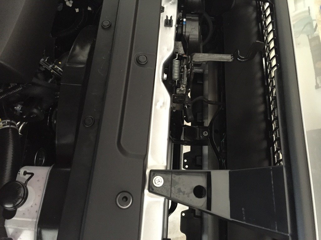

    There’s a lot of room between the grill and the radiator.

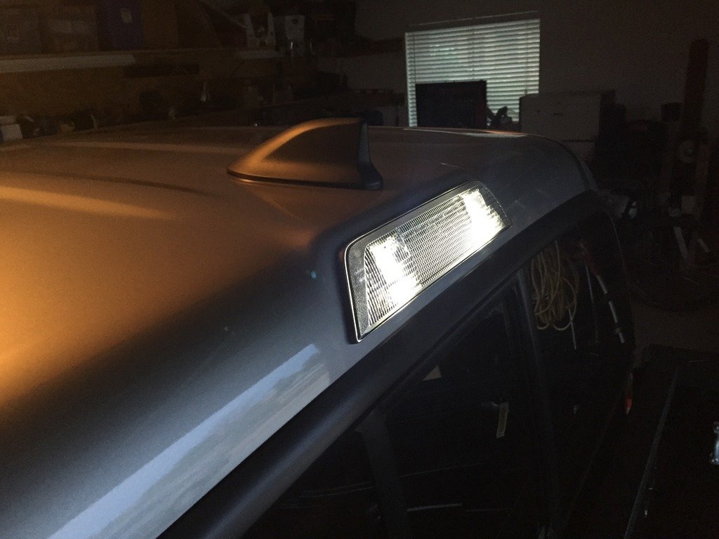

    Bed light and I think the XM antenna?

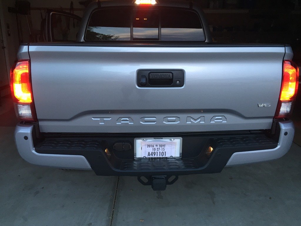

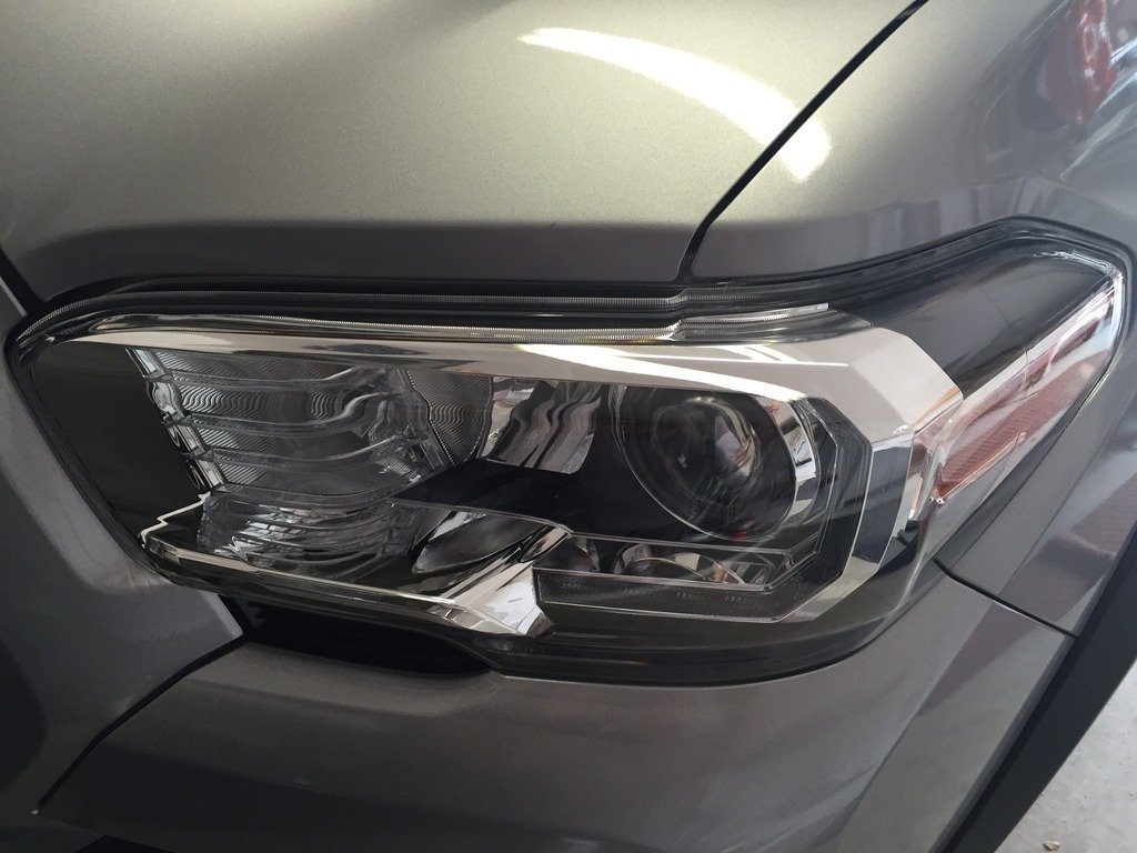

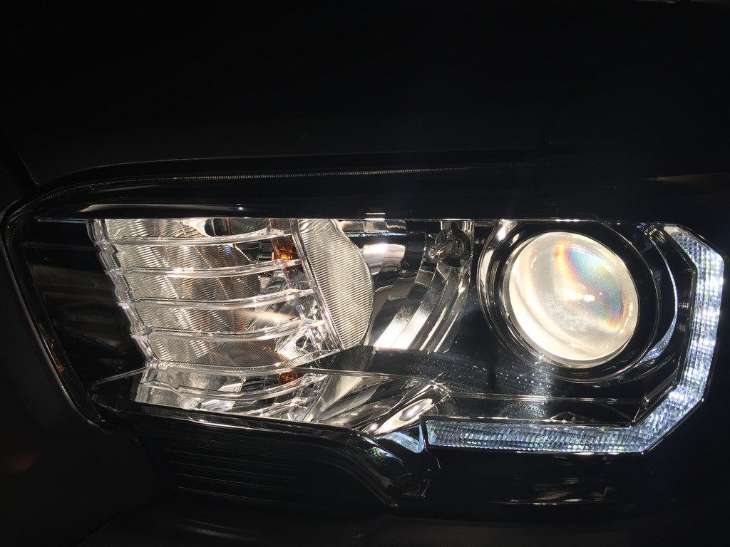

    Crappy pic’s of head and taillights. Tails with and without brake lights:

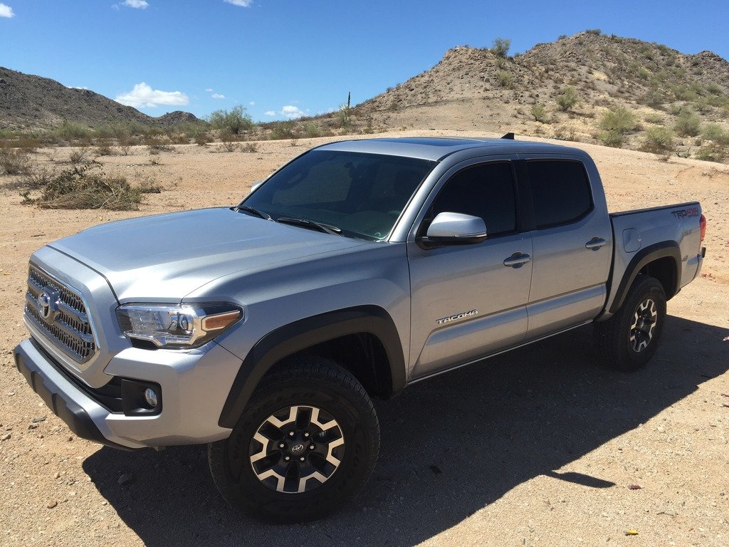

    I will try and get more photo’s and a better side profile photo tomorrow in the sun light.

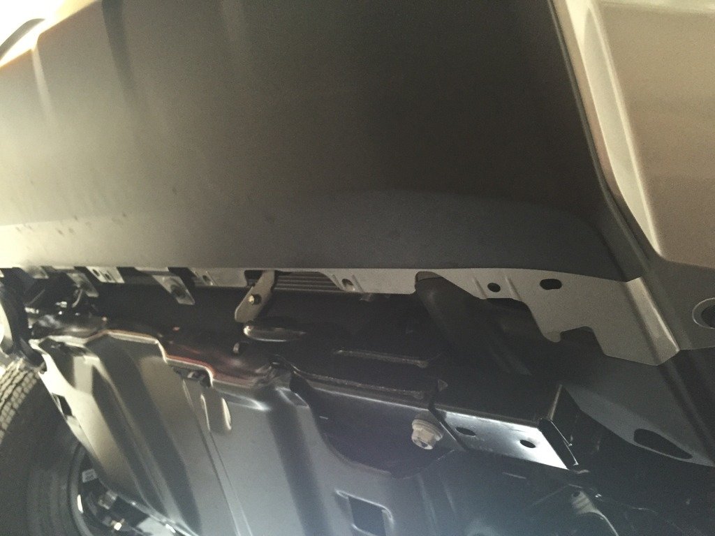

    Engine and frame pic’s.
    What should be bolted to this bracket?
    I remember reading about how this exhaust is routed. Should only be an issue if you get high centered. Looks like they flattened it out a little.

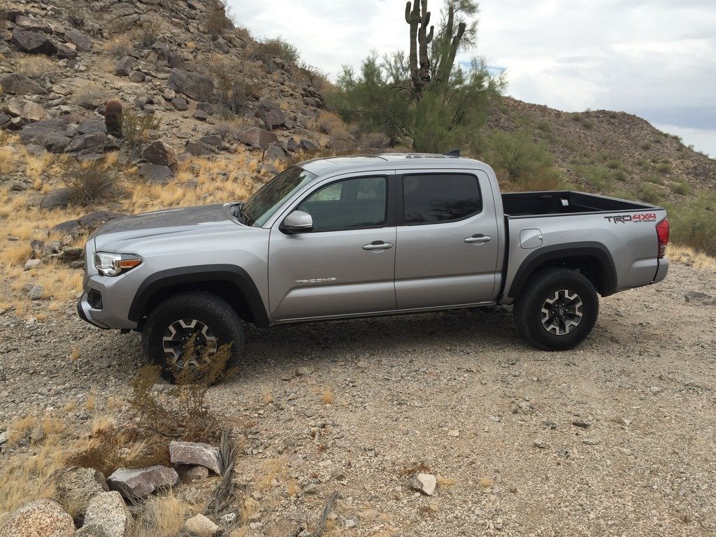

    Took it offroading. Basically just a bumpy dirt road. It’s overcast here today so it doesn’t look as nice as in bright sun light. Misc pic’s:

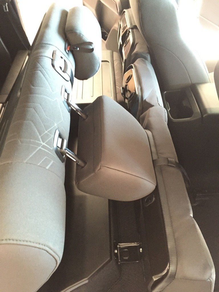

    I do not like having to remove the headrests to fold the rear seats down. Even with the headrest folded I could not fully fold the rear seats down. WTF?
    Nice storage area under the seats and a pocket on one side.

    Also I am not crazy about the way back seats seats fold. The head rests tip forward but you can't fully fold the rear seat flat with the heat rest tilted, it must be removed. I also wish the plastic on the back of the back seats was something less slippery. My dog jumped in yesterday and slide into the door on the opposite side. I'll need to find a 2 piece non skid type of mat that I can attach to that plastic. Suggestions?
    Passenger leg room in the back will be an issue for an adult if an adult is sitting in the front seats and has the seat slid all the way back. This is a non-issue for me. I got the quad cab (had an access cab before) to keep things in. Passengers back there will be rare for me.

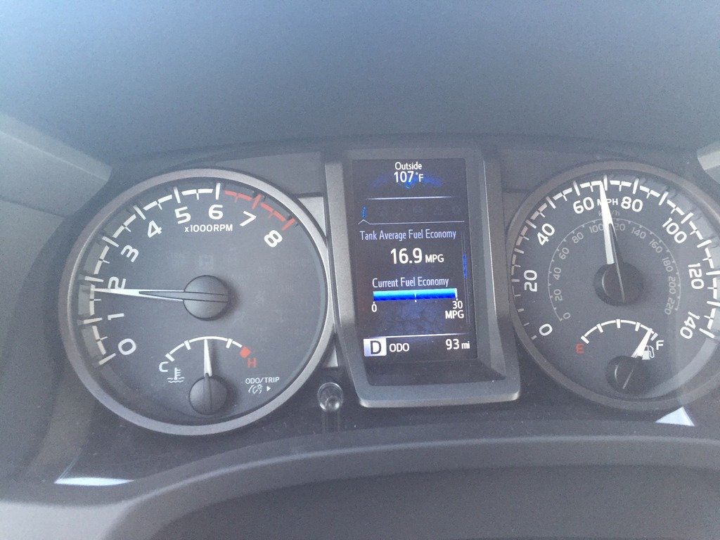

    I topped of the tank for the 1st time today. It automagically reset the average tank MPG which was I was not expecting. After 30-40 miles on mostly highway at around 70-80MPH it went to just over 17 MPG.

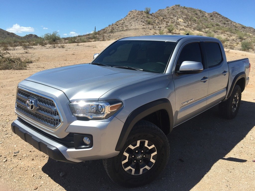

    Here’s a few better pic’s of the tint. The windshield is not near as dark as the photo’s make it out to be. Must be because the back windows are in the back ground making it look darker.

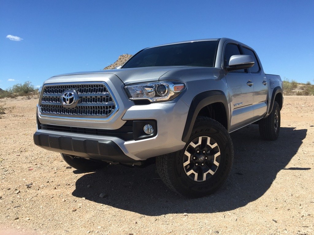

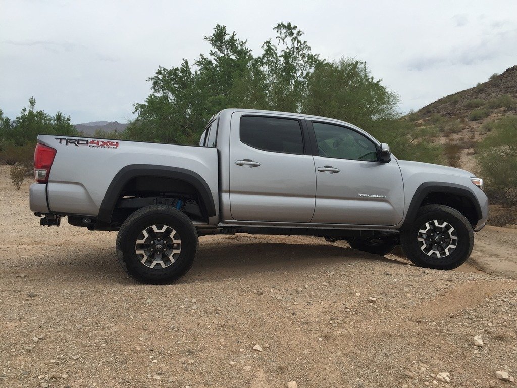

    Took it out off-roading today. Nothing to crazy. Tried all the systems (4Hi, low, crawl, terrain select) and they seem to work. Would be nice to have the locker and terrain selection in 4Hi instead of just 4L. Probably a mod for the locker and I will get to that at some point. It seemed very ‘sure footed’.
    I do not like how long the hood seems. Makes it hard to see right in front of you at upcoming obstacles. Also I noticed the bed seems to ‘jiggle’ a fair amount.
    Suspension seemed to ride very nice off-road. I though it was very plush going over bumps, rocks, etc. Only time it seemed rough was going up a sandy wash. Had to keep the speed up and it did a bit of hopping. However lower air pressure would have helped that. I also drug the hitch through a gully. Pulled the hitch cover out.
    I topped off the tank about 5 miles before I left the pavement. MPG was just over 17 in that 5 miles then dropped to just over a consistent 10 for the few hours I was out there.

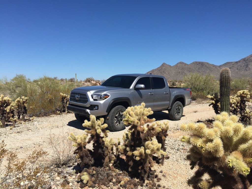

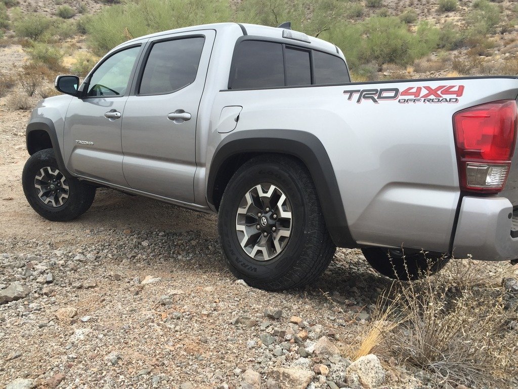

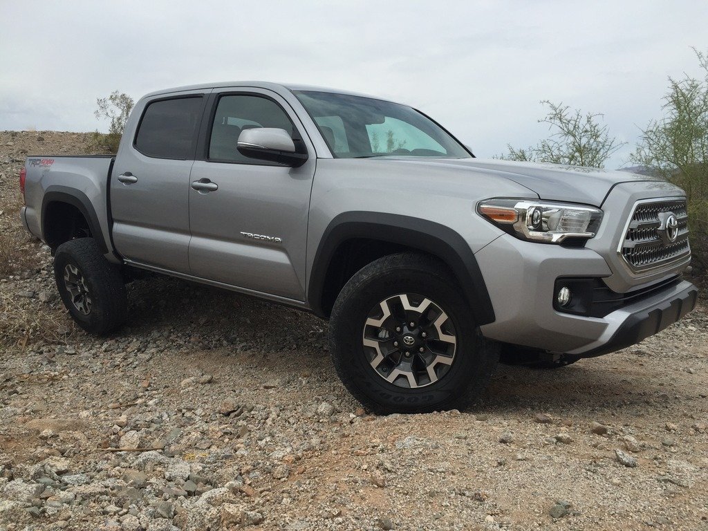

    I stopped to take this pic:

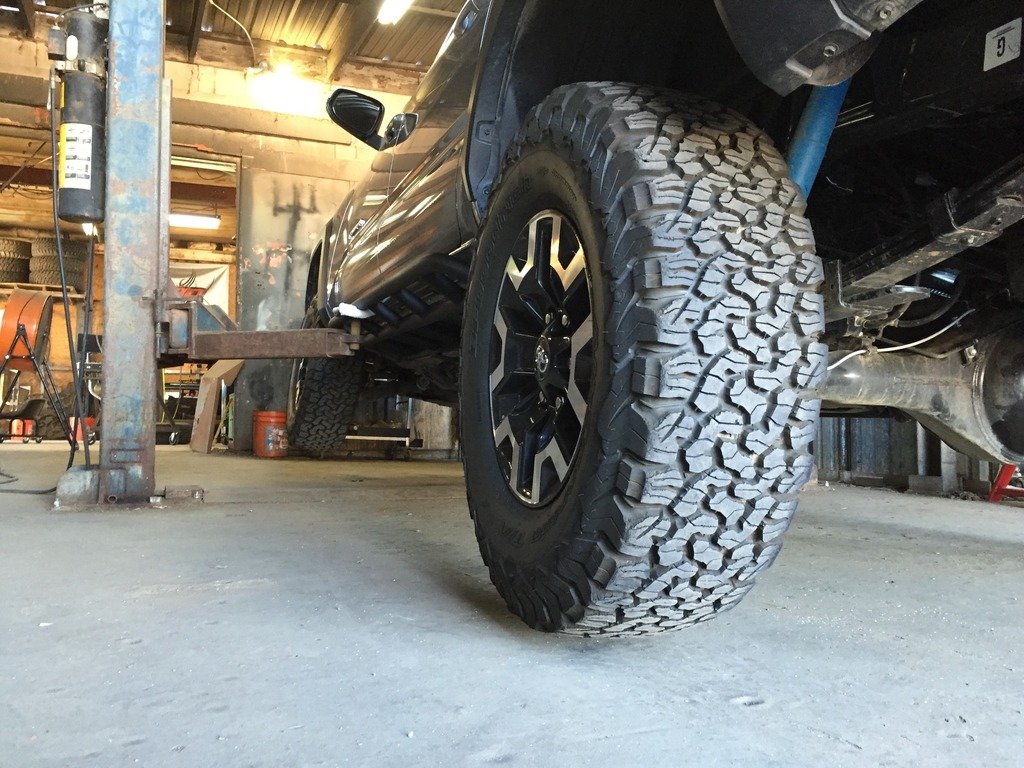

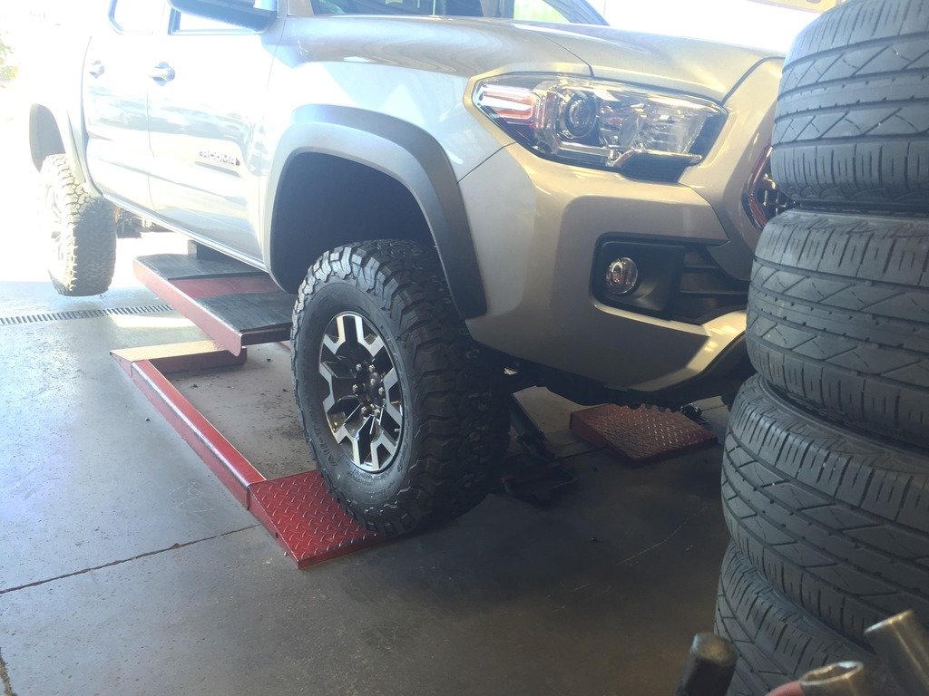

    As I got out I heard a hissing noise and figured it was the AC system. Decided to look on the other side of the truck and saw the front tire halfway deflated. I drove to a flat area to change the tire.
    At 1st I figured it was the cactus stuck in the tire but once it was off the truck I was able to compress the tire easily and knew there was a bigger hole somewhere. I wasn’t standing in the heat anymore (only 95ish today) and headed out of there. Once back on the pavement I noticed more cacti in the spare tire. Got to Discount Tire and they showed me a non-reparable ¾” gash dead center in the tread. With no confidence left in these “Kevlar” tires I decided to buy new ones. Not something I wanted to do with less than 400 miles on the ‘old’ ones L

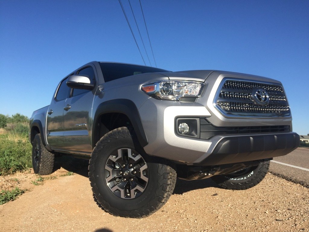

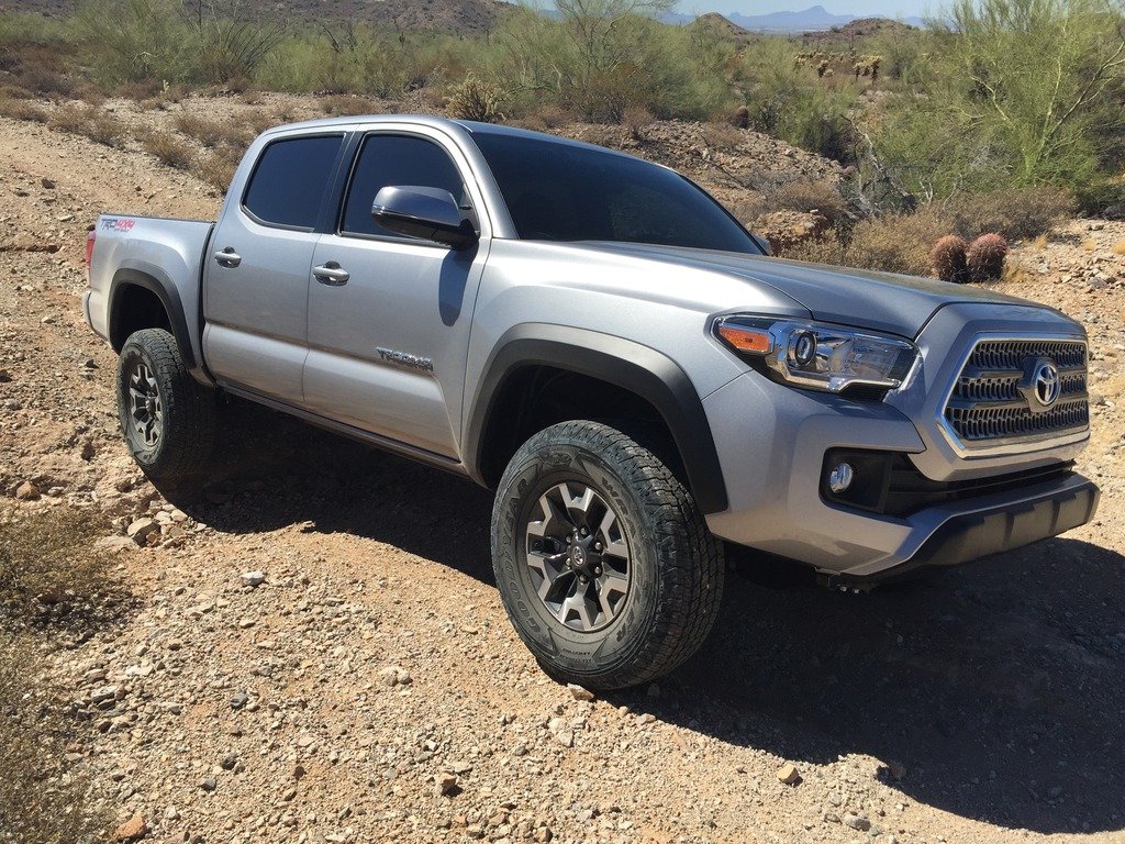

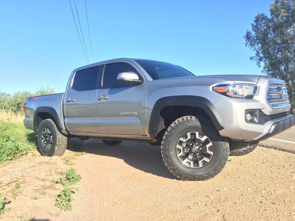

    Went with one size bigger BFG KO2’s, 265/75/16. They are about an inch taller. They seem a touch stiffer on the road. No rubbing but I have not been off-road yet.
    I saw a number of desert pin stripes in the dust on the body. Most seemed like they were just in the dust and not a scuff in the paint. After running it through a car wash I found some minor desert pin striping. Some in the paint and some on the fender flares and black covering on the doors between the windows.
    Guess it’s broke in!

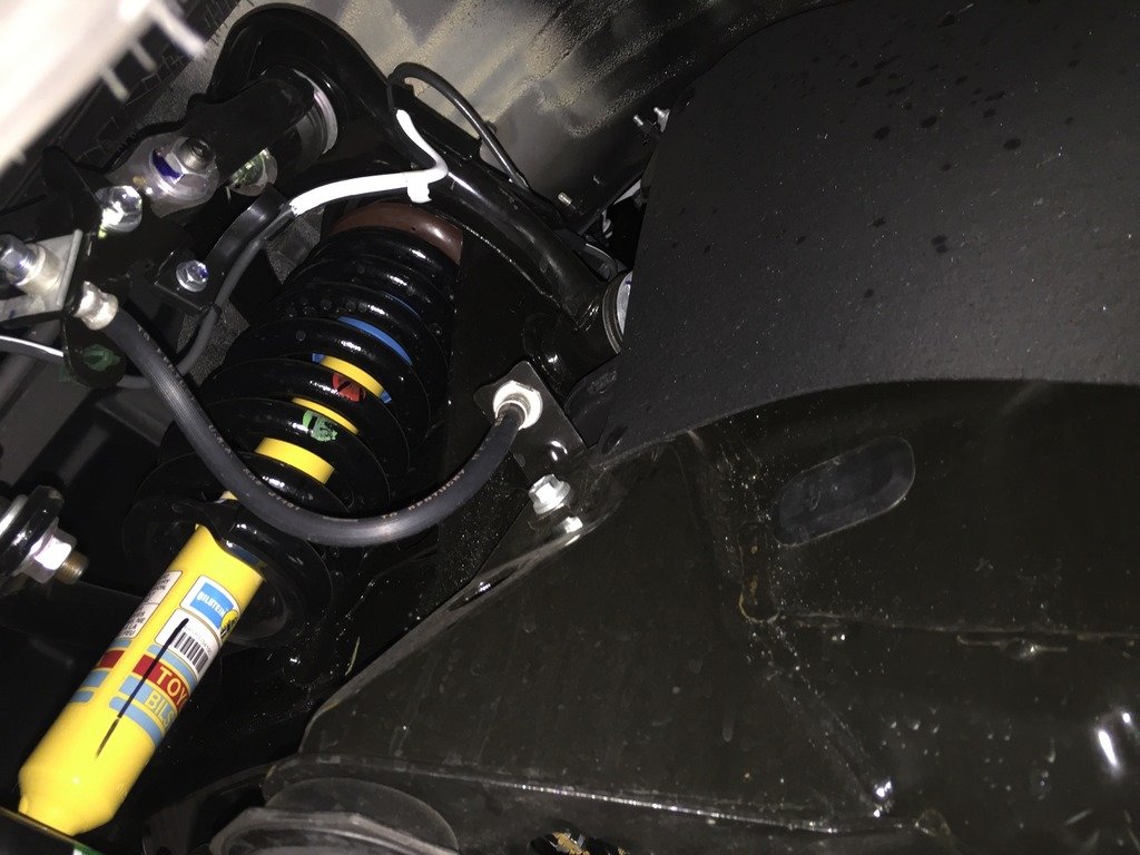

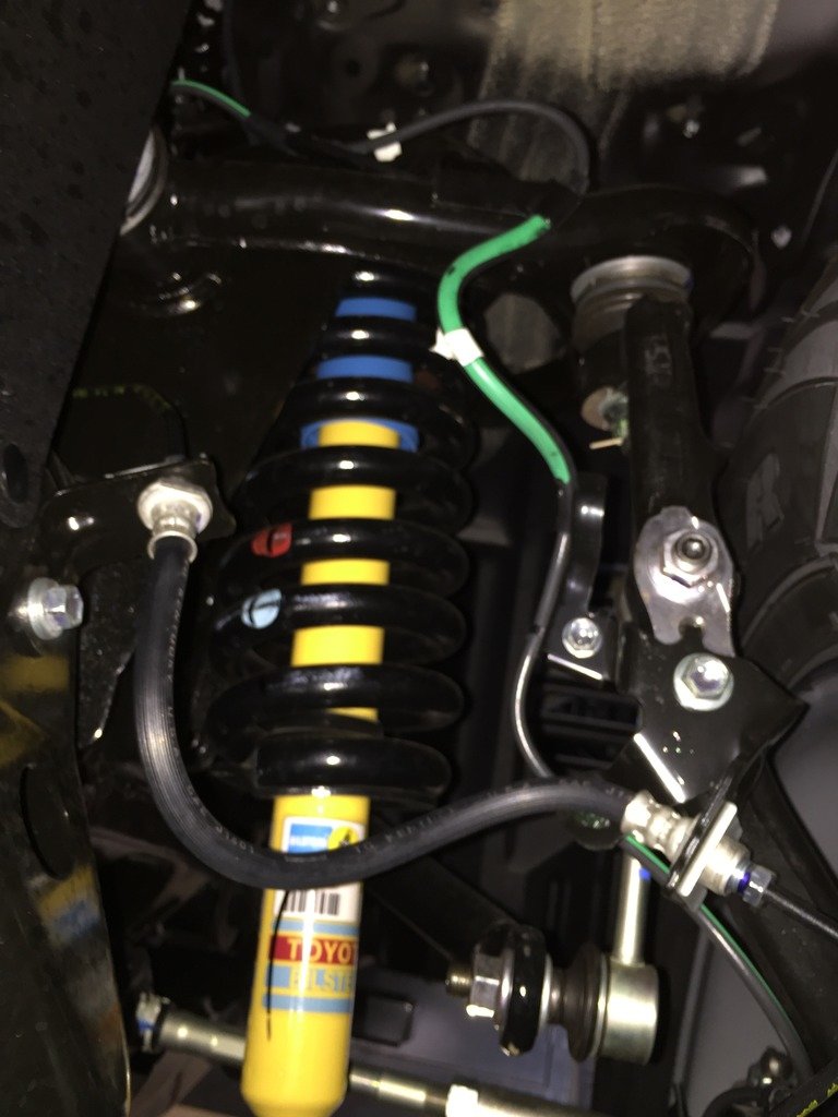

    Couple suspension pic’s while the tire was off:

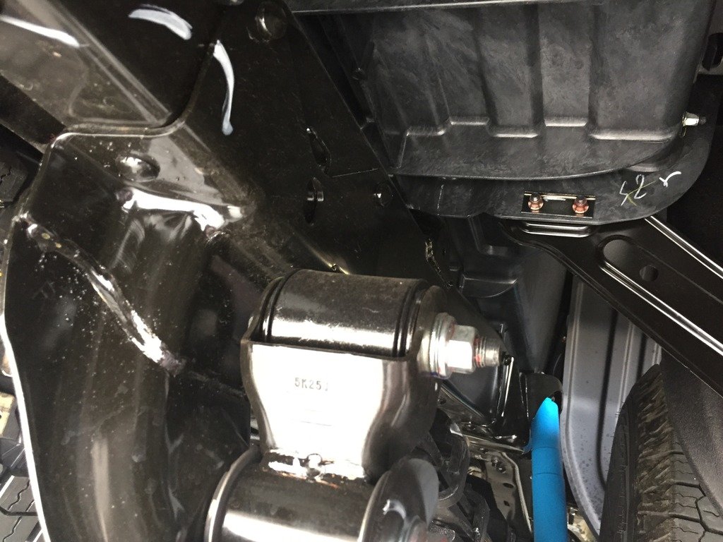

    Cab Mounts:

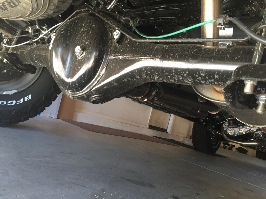

    Rear axle:

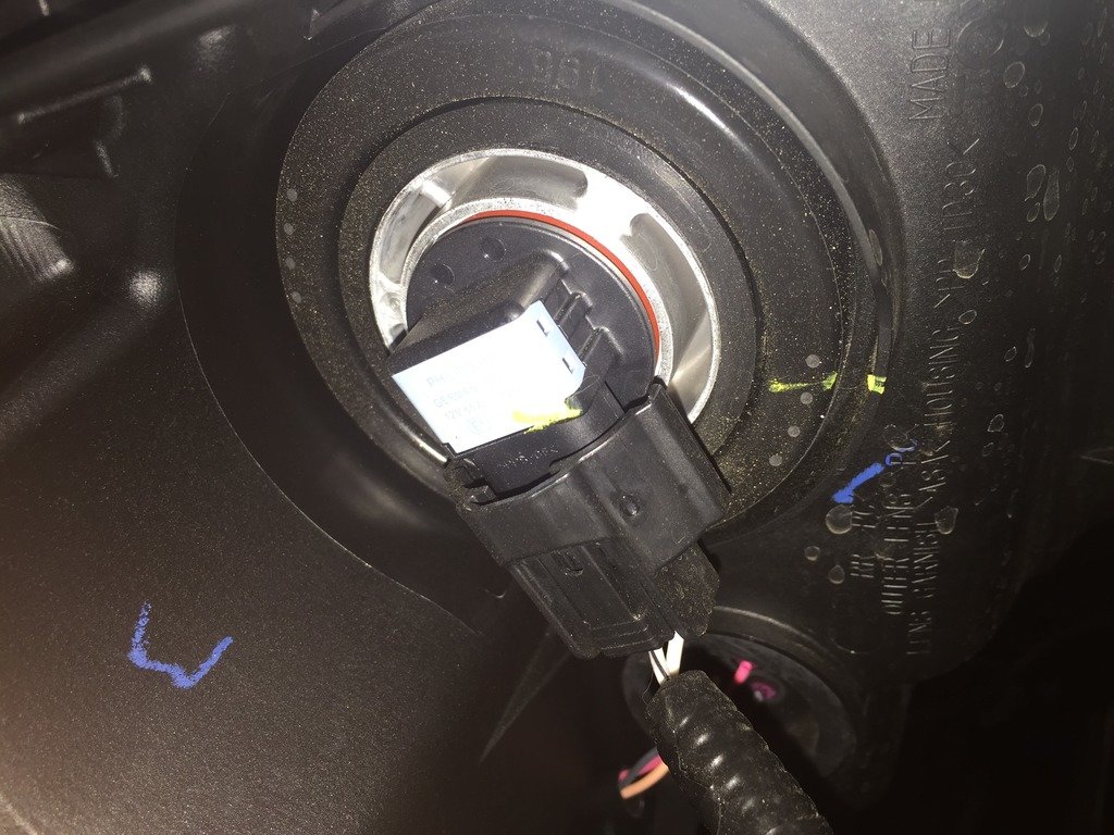

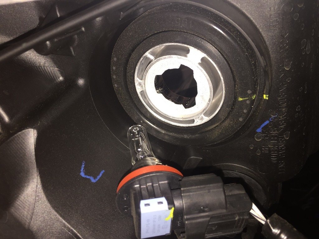

    Back side of headlights:

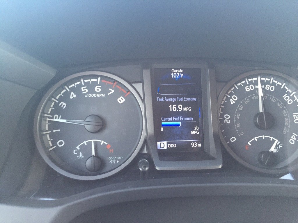

    Drove it some today. On one leg of running around the Trip MPG, mostly freeway and a distance of about 15 miles was 19MPG. Average MPG for the past few days with most of it on surface streets is 16-17.

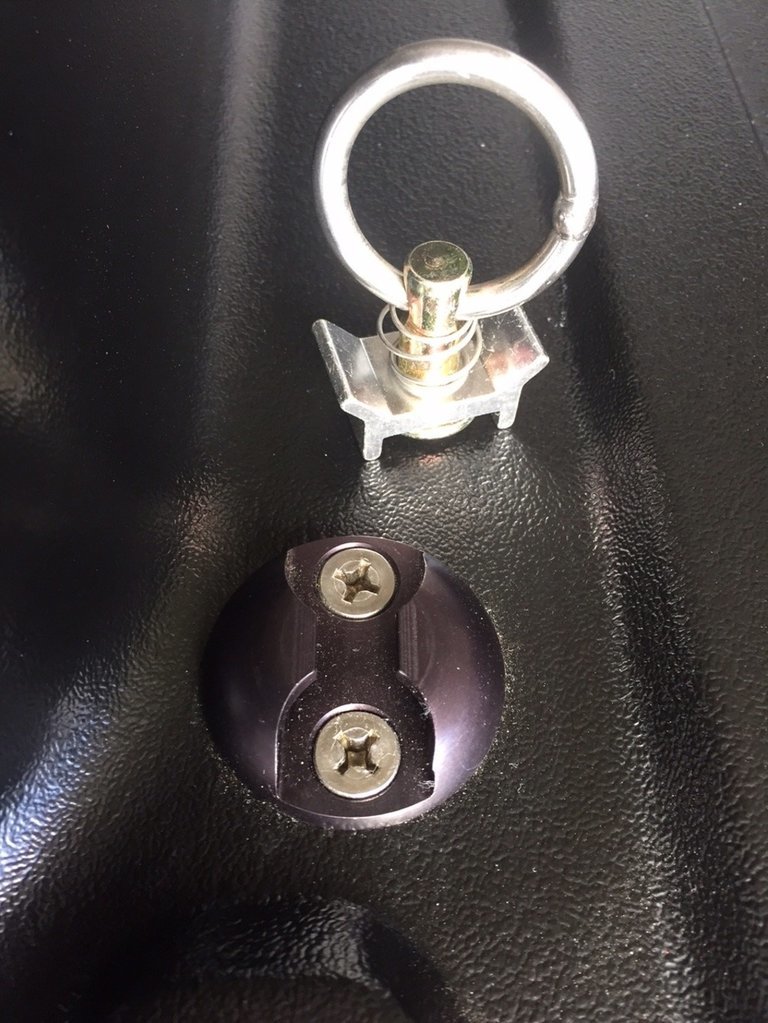

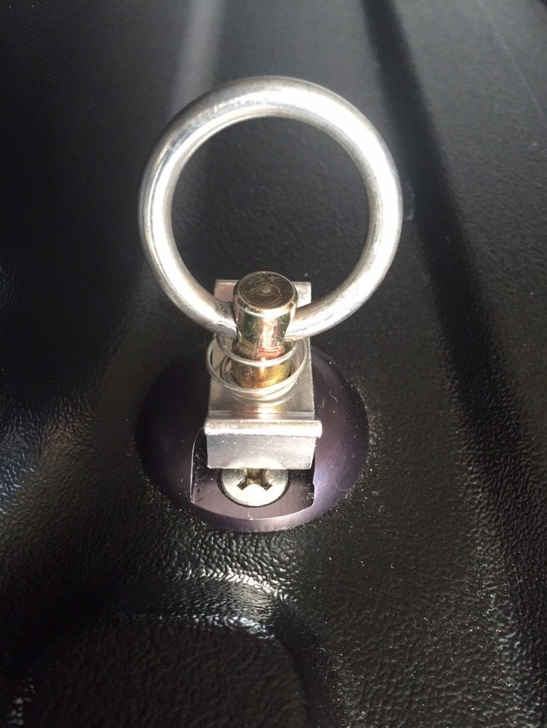

    Added some bed tie down points from Macs Custom Tiedowns. I have had these for a few years (had them in my last truck) and they are very handy. Won’t be for heavy loads since they are mounted to a composite bed but they do feel very secure. Plus they have the same size backing plate under the bed. These are quick release incase I want to remove them, bases are permanent. Drilling the holes in the bed I noticed more of a fiberglass smell.

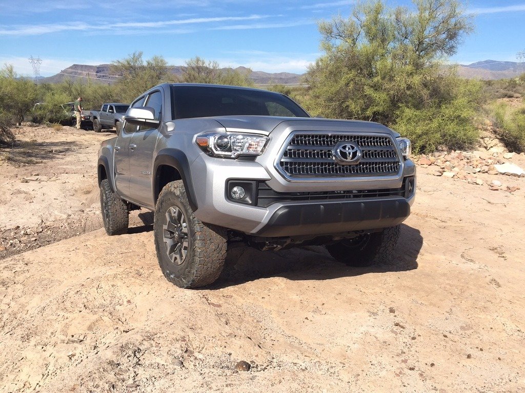

    Did a quick off-road trip today to check out the new tires. No rubbing and they seem to work well off-road. The rain was rolling in and I didn’t want to experience a flash flood J
    The hood still seems very long, not sure I will ever get over that but will have to get used to it. Have to plan way ahead or get out and look in some situations.
    The average MPG’s is hovering right around 17. Keep in mind that’s with the AC always on. Current average miles per tank at around 100 miles is 16. Mix of freeway and city driving.

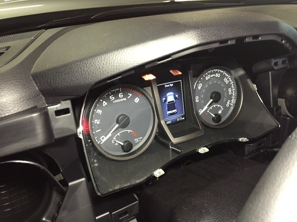

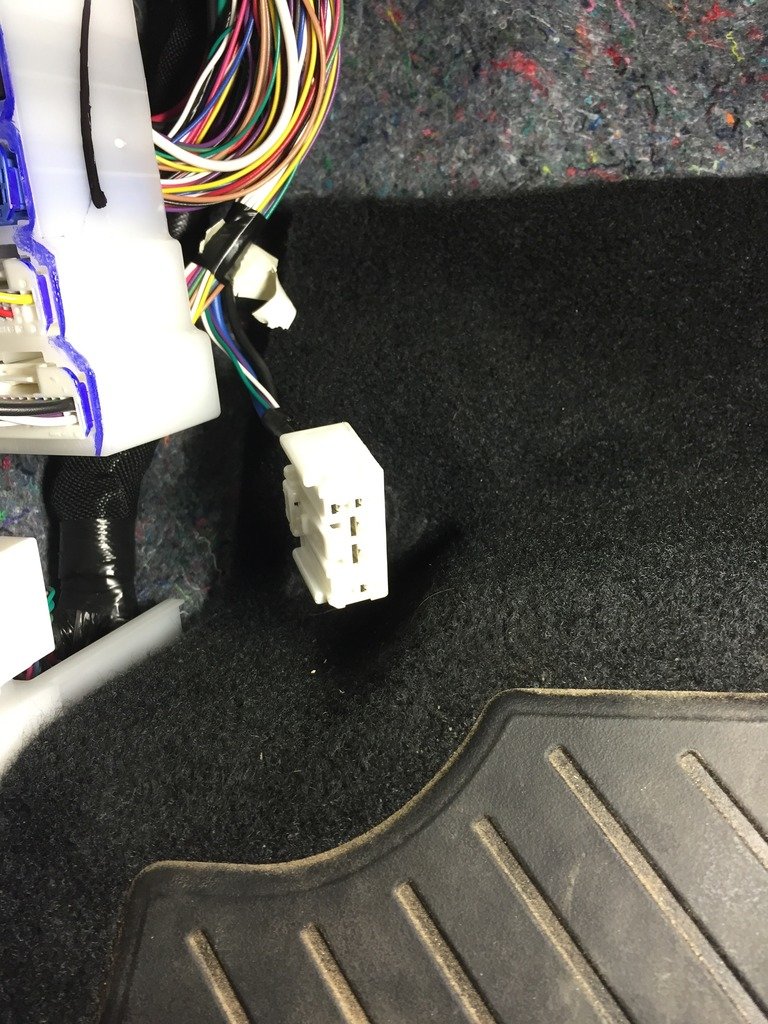

    I took some panels off in the cab today to wire in a radar detector as well as just to look around. There is a mini (the extra small fuses) fuse panel down there but tapping into it wasn’t an option with the parts I had. I ended up tapping into a constant hot wire from a plug that is not in use on this model, shown below. All the panels pull off with the exception of the panel below the wheel having 3 screws as well as push-ons holding it on. I had a hell of a time getting the kick panel back in properly!
    Below the steering wheel:

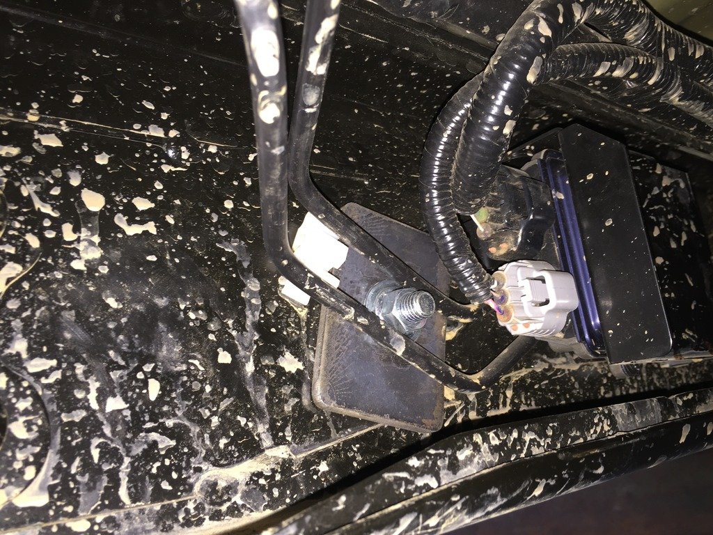

    This is whats under the drivers foot rest:
    Plug I tapped into:

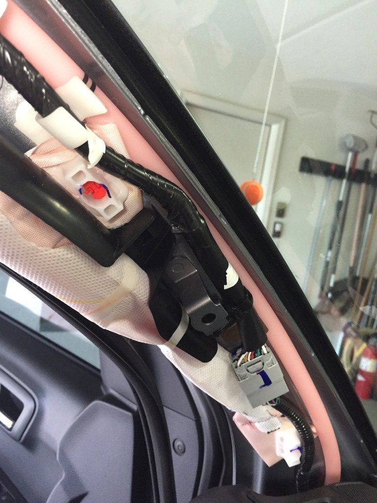

    This shows what’s behind the A-pillar panel. The red hose is the sunroof drain tube. It runs downs and out of the rear of the front fender.

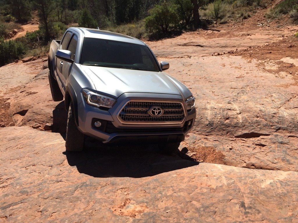

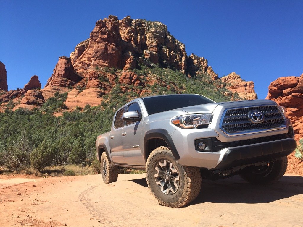

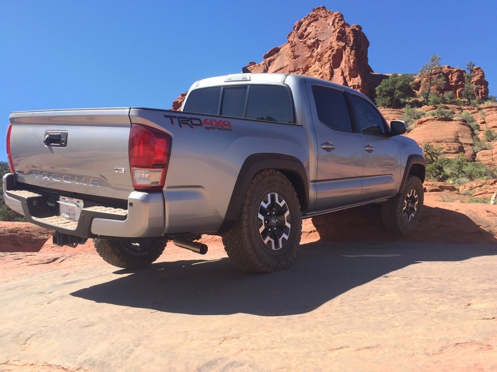

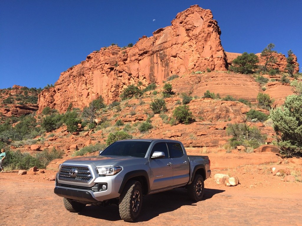

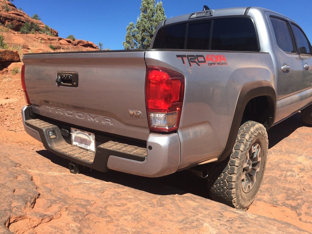

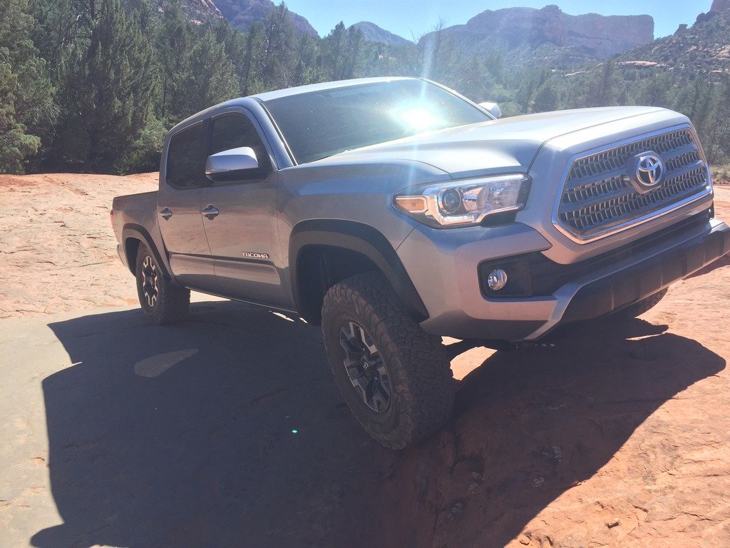

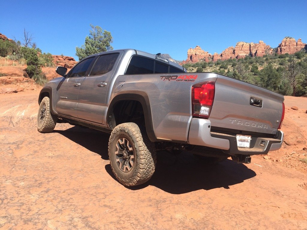

    Today we took a day trip up to Sedona, AZ. It’s about a 4500ft elevation gain.
    At the bottom of the hill my average MPG was just over 17. Once at the top it was down to 16. After a 4’ish mile loop on an offroad trail, Broken Arrow, it was just over 15. By the time I got home I was in the low 16’s and the tank average was 17. Seems odd the tank average was more. We filled up at the bottom of the hill before going to Sedona.
    Driving up to and back from Sedona the transmission does shift A LOT! I drove at 75-80MPH for most of the time and did not use cruise control. Coming back there was a good headwind. It would sometimes shift on a slight down hill to maintain speed.
    I assume since 6th is so low all the shifting is normal, just takes some getting used too. Sure would be nice if this motor had more torque!
    I also noticed a strange air noise at freeway speeds in windy conditions. At times the wind would catch the door seal area just right and make what sounded like a Kazoo (kids instrument).
    The hood still seems long! Makes it really hard to see upcoming obstacles. I do not like this but there isn’t much I can do about it.
    In 4 low the gearing seems taller than my previous 1st gen however it has been a while since I used 4L in the 1st gen, which had a manual transmission. In the 2016 (auto trans) in 4L going down hill I have to use the brakes much more. Using crawl control makes for a much smoother assent in bumpy conditions.

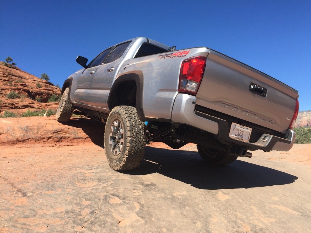

    Crawl control works incredibly well however it is noisy. One section in the trail I engaged CC for a small assent. There was a hiker sitting on a rock about 100 yards away. As I started down she quickly looked over at us and she must have been thinking, “What the hell is wrong with that truck!” It was almost comical as she did a few double takes looking at us. See the video below going down ‘Devils Staircase’ and notice how loud CC is!

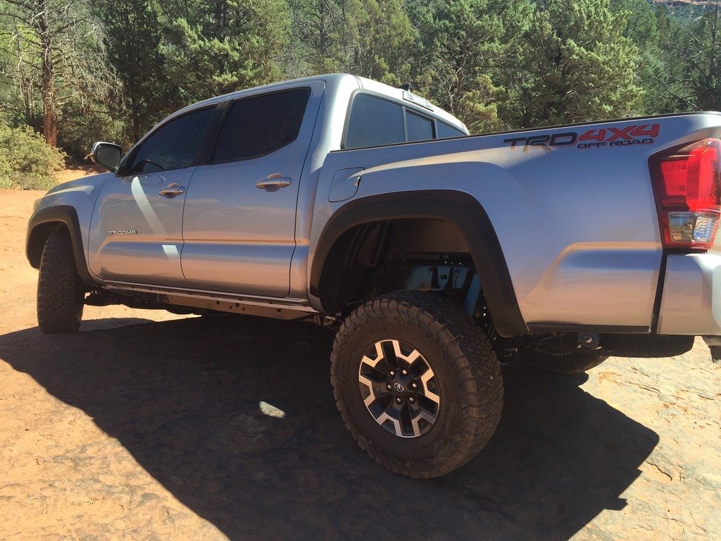

    The BFG KO2’s work great on and off road. No rubbing at all offroad. On road they do ride stiffer than the OEM tires.
    I drug the hitch a few times and scraped the exhaust that hangs below the transfer case once. One obstacle I stopped to take a few photo’s. I ended up backing out of it because if I continued I may have taken out the exhaust and rocker panels. I for sure need rock sliders and I am trying to talk myself out of a lift. Seems to be a loosing battle ;)
    The truck worked very well offroad!
    The scenery is Sedona is amazing and even better once you’re off the beaten path.
    Pictures and a video of the crawl control:
    Ended up backing off of this one. Exhaust and rocker panels were to close for comfort!

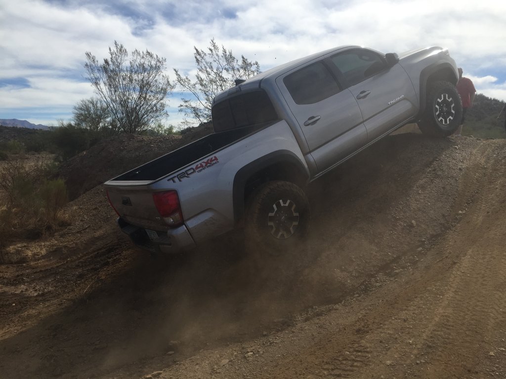

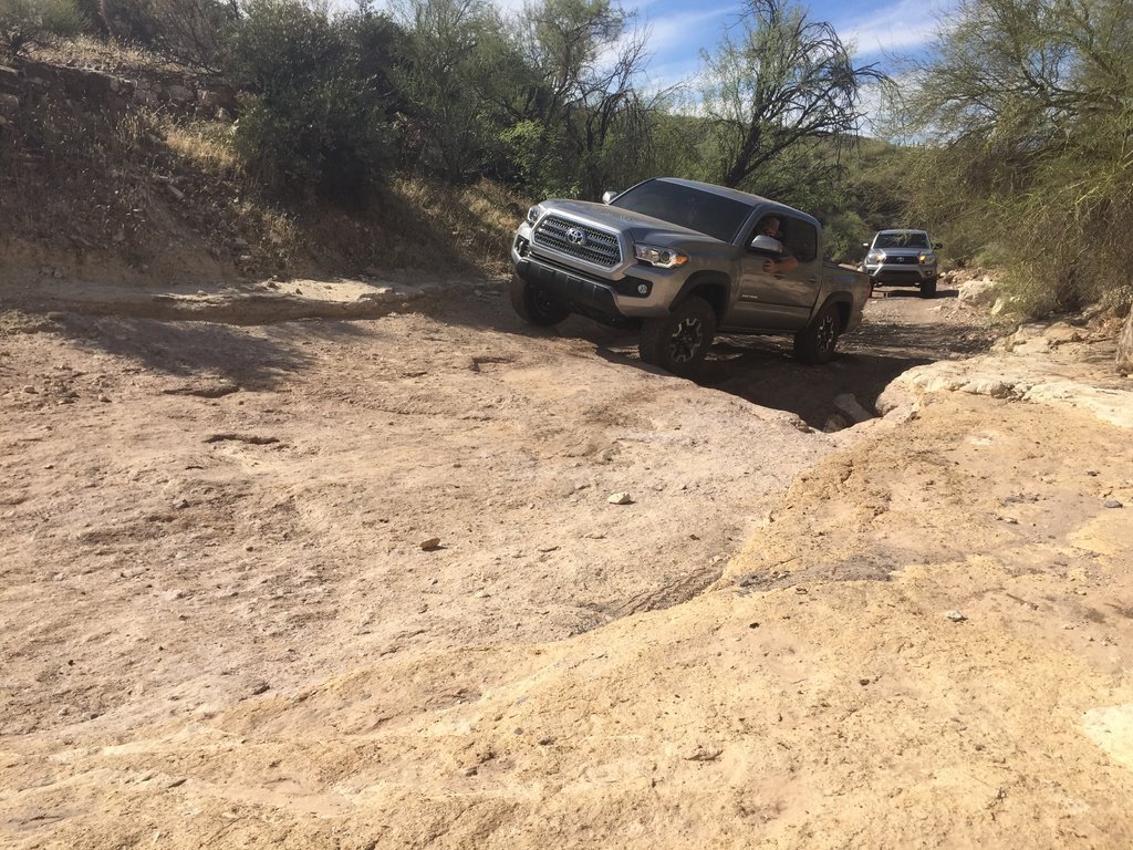

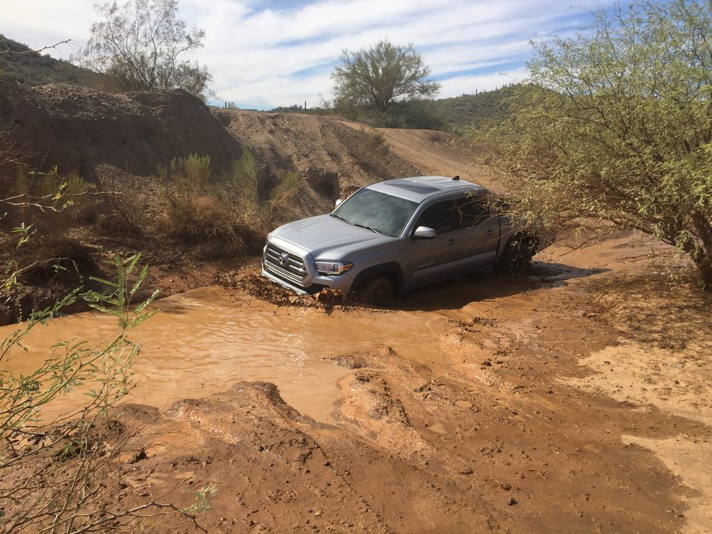

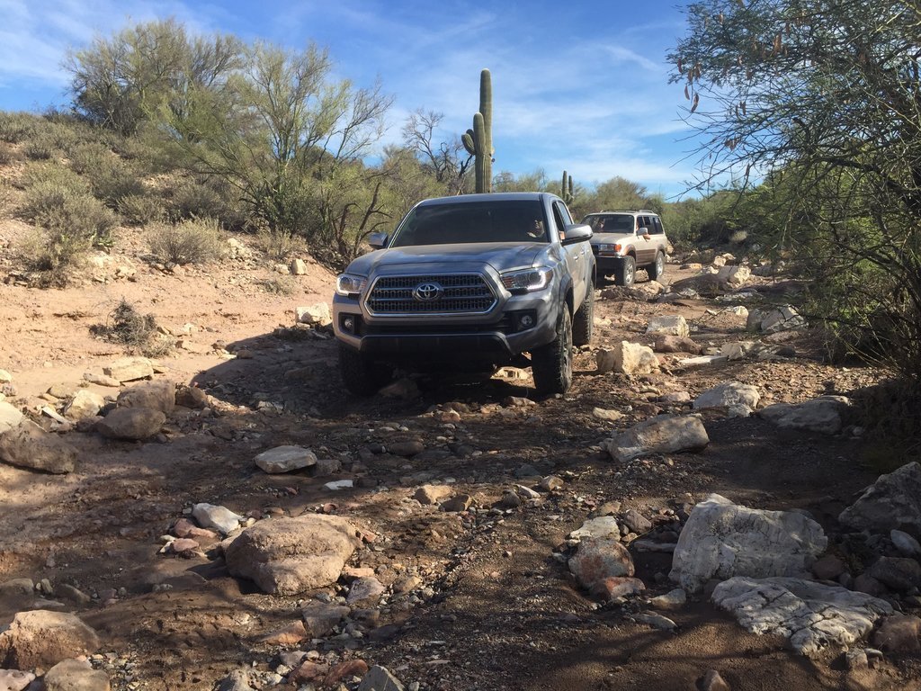

    Did a day trip to Table Mesa, AZ area.
    In a previous update I had mentioned how while in 4L that the gearing was not near as low as my 1st gen. Turns out I was in a higher gear while in 4L than I expected. I figured that while going very slow the trans would stay in 1st gear. I was more than likely in 3rd or 4th. Damn auto’s! For this trip I put the trans in manual shift mode and while in 1st gear it was much better going down hills.
    Also while trying to go up a small hill (as seen in pic’s below) I found that even with the gas pedal massed to the floor it would limit my RPM to the point of almost stalling. I had to back down and hit it again. @RPS1030 said it was the A-Trac kicking in. It was not a good thing! Guess I need to mess with the settings more to disable this or find a work around. Or maybe engage Terrain Select.
    The truck did extremely well today. We went up some long steep rocky hills and it took it with no issues.
    Even got some mud on it for the 1st time.

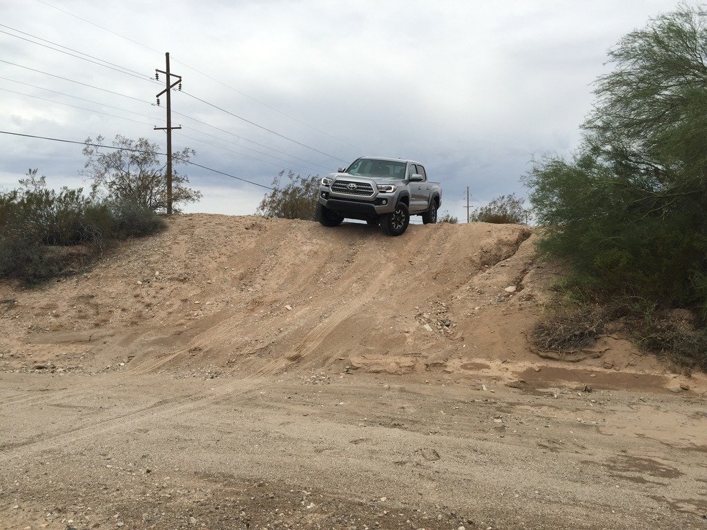

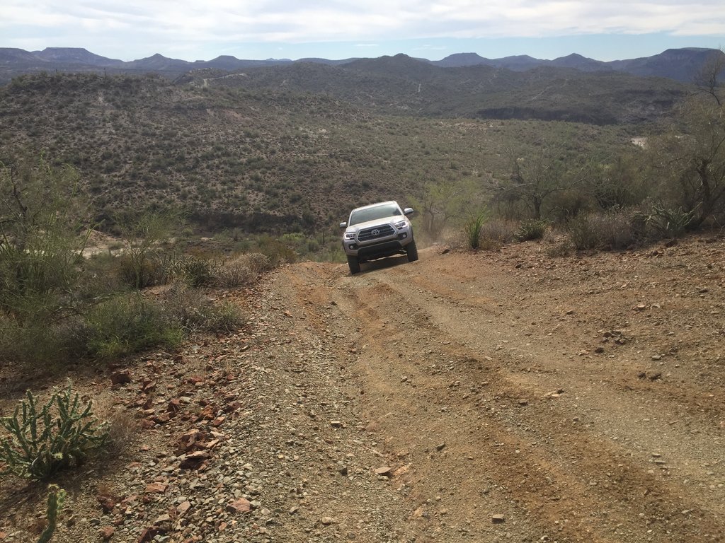

    Few pic’s courtesy of RPS1030:
    This is the hill I had to try twice due to the truck limiting my power.
    Same small hill behind the truck on the passenger side. The hill with the hole where the side view mirror is point too:

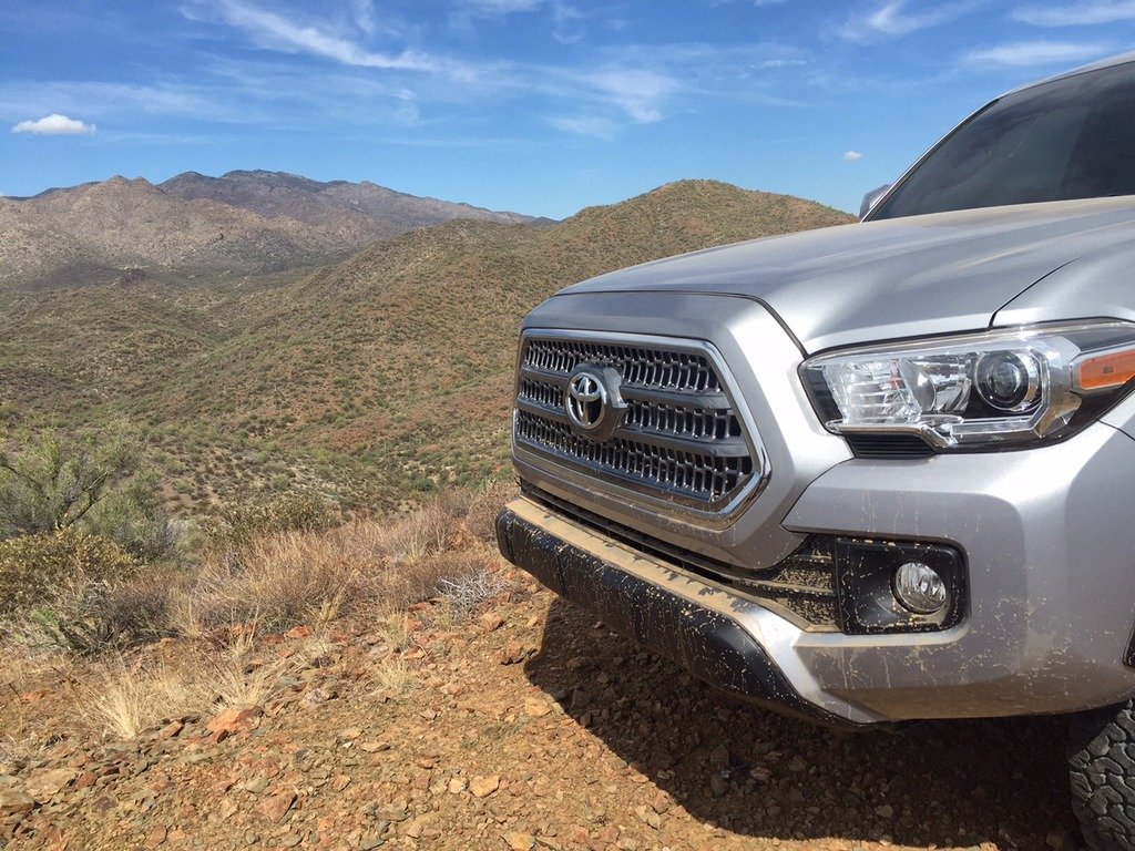

    Few of my pic's:

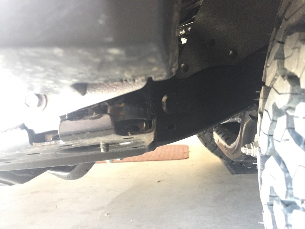

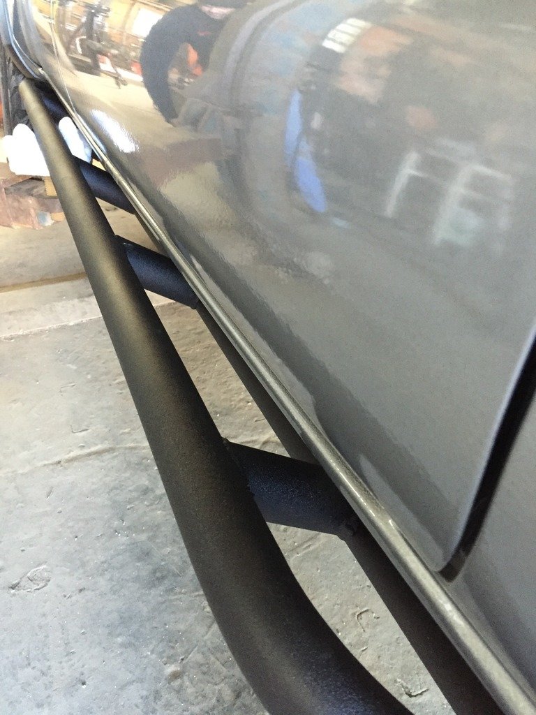

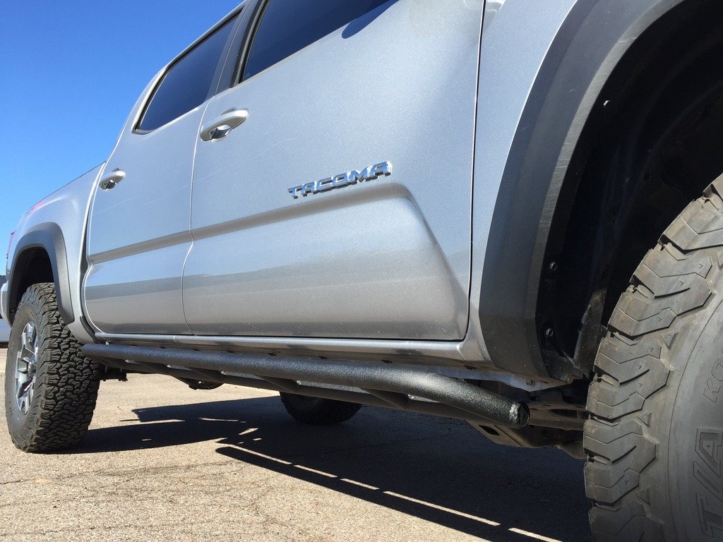

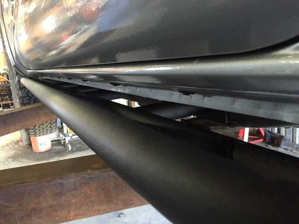

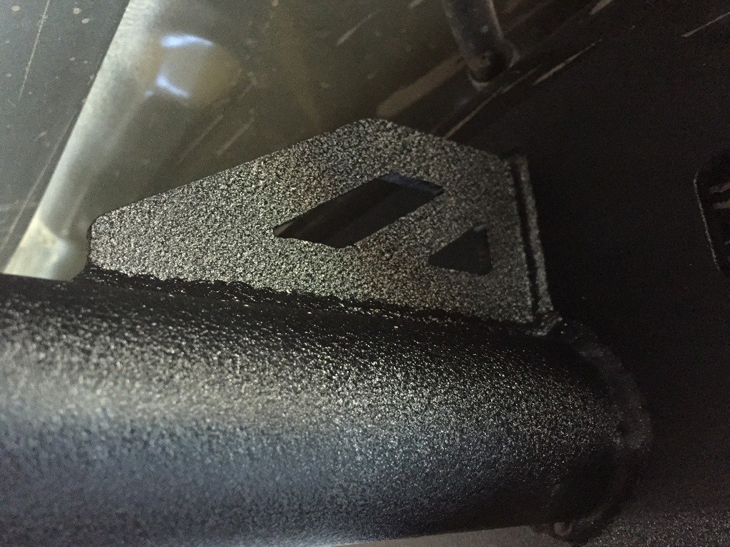

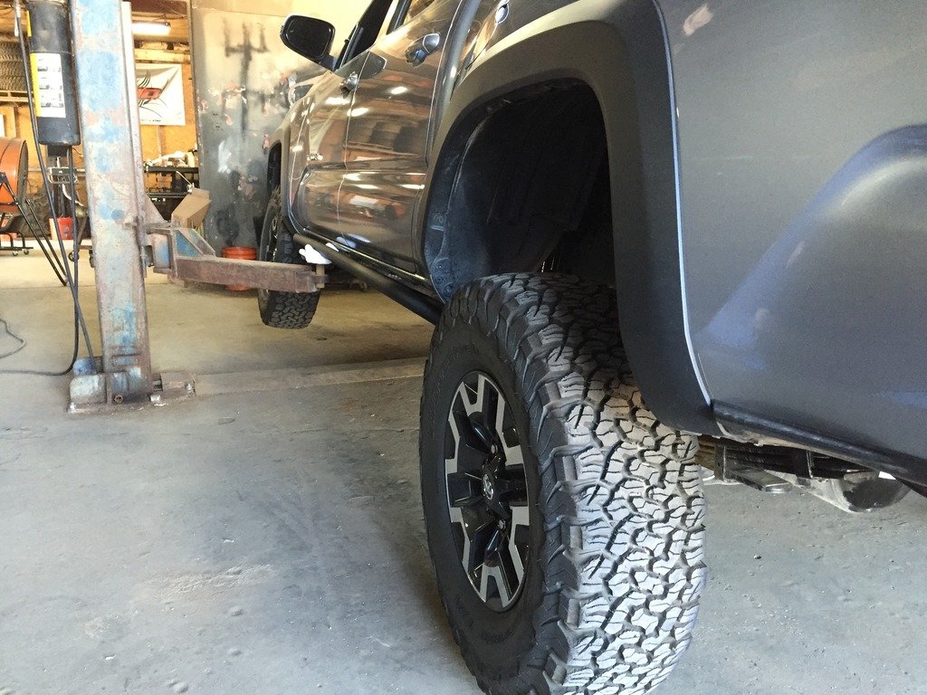

    ---SLIDERS---
    I was finally able to meet up with Brandon at Avid offroad for the frame mounted bolt on sliders. They fit very well! I had him set them inward about a inch more than his previous sliders and up another 5 degrees for a more snug fit to the body and to avoid them hitting my leg as much when getting in the truck. These small changes make them a little harder to use as a step but at still usable.
    The front of the sliders are extremely close to the cab mounts however this is not an issue.
    The sliders are secured to the frame with grade 8 equivalent metric bolts with backing plates on the backside of the frame. Most of the frame is ‘C’ channel however the front part of the frame is boxed. Two of the mounting bolts and back plates need to be put in the boxed section of the frame on both driver and passenger side. Brandon welded the nuts to these 4 backing plates. The passenger side is easy to get your hand in there to hold the backing plates in place when installing the bolt from the other side. The drivers side is a bit more of a challenge due to 2 fuel or brake lines and a bracket being in the way. Brandon removed the bolt holding the bracket in place and was able to pull in back far enough to get the blacking plates in there. Also towards the back of the frame these same fuel or brake lines need to be slightly moved to get the nut and backing plate in place. These lines will touch the nuts once in place and while it shouldn’t be an issue with rubbing you may want to either slightly bend the lines or add a piece of fuel line over them for better protection.
    These sliders are well-built and very heavy duty. They will support the weight of the truck as shown in the photo’s. With the weight of the truck on one slider they flexed upward about ¾”. I had 2 brackets on each slider plate added for future skid pate anchor points.
    Here they are shown supporting the weight of the truck. The rear tire is off the ground:
    Photo while being installed:
    How they look:
    Misc detail shots.
    Couple of the backing plates before paint:
    2 of the lines we slightly bend to prevent rubbing on the nut towards the rear of the frame on the drivers side:
    Same lines a few inches in front of the above photo:
    This is the brackets that needs to be unbolted and pulled slightly back to get the backing plates in place:
    Gussets on each outward tube:
    This (usually has a black cover over it) needs to be removed before installing the slider on the passenger side:
    Just a couple bolts holding the sliders in place. Also shown are brackets I wanted added for future skid plate anchor points.

    Nice! Thanks for the pics! Love that pic of the rear end. Like the painted bumper vs the chrome. Thought they had a 4x4 emblem on the tailgate?
