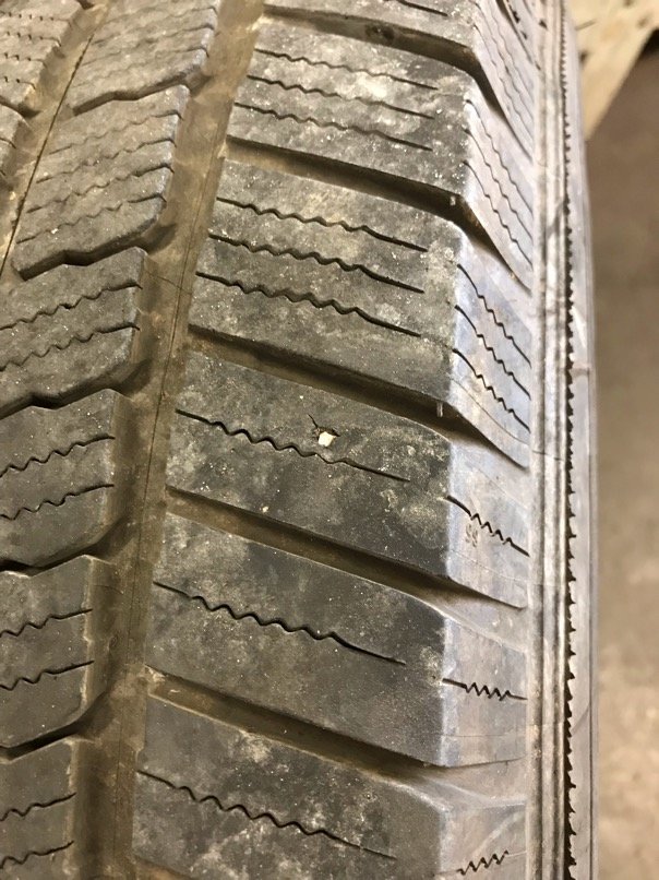

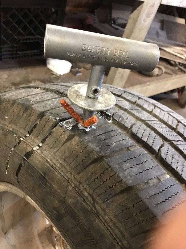

    I had a slow leak in one of my tires so my tire guy (me) took it off today and found this. I ask him if it was to close to the edge, he said no get the plug kit. He plugged it and hopes to get many more safe miles out of these Michelins.

    if it developes a slow leak/leak pull out that plug and use 2 plugs and cement to seal it, I had to do this had a similar situation

    When I used to work on truck/trailer tires at a shop I always pushed the plug thru with a liberal dose of cement (patch goop). Then snipped off the plug flush on both ends (inner and outer), then buffed the inner plugged area and cemented a patch there.
    If the cord was damaged then the tire was scrapped.

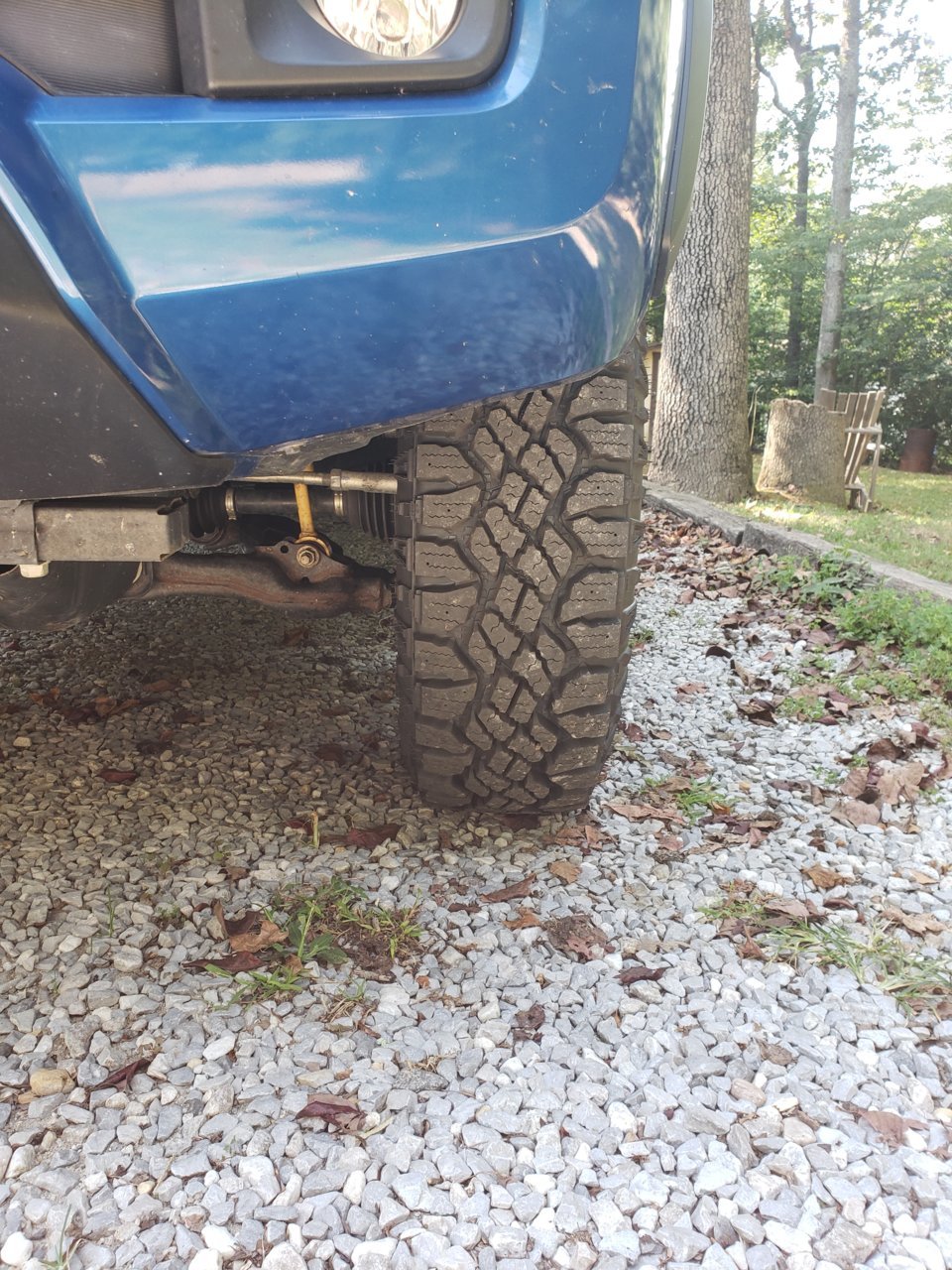

    Just to end the thread on a positive note.... 235 85 16 goodyear duratrac e load. /thread
