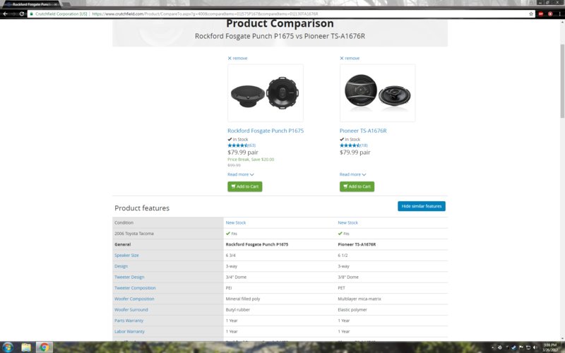

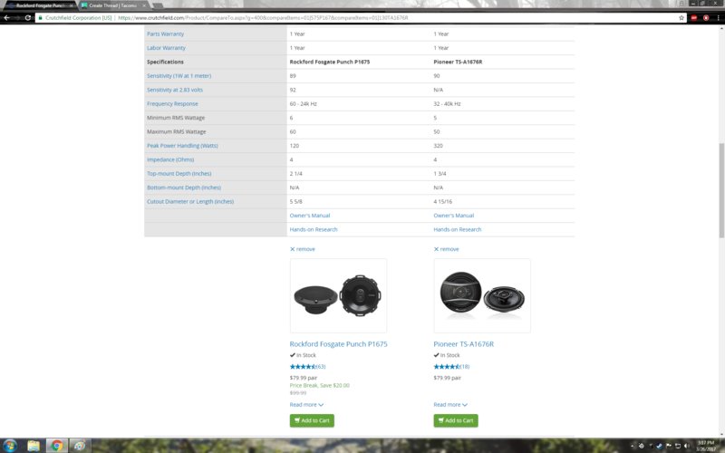

    So guys I am trying to figure out which one these 3 way door speakers to buy for my front doors of my 06 Tacoma Access cab. I have a JVC KD-R775S Head unit and I am trying not to run an amp to the front speakers if I really don't have to. So my main question is, will these speakers hit harder, better bass ETC than our typical OEM speakers with no amp? And also which one would be the better choice, I think I am leaning towards the rockford fosgate but would like some input from the audio side of tacomaworld first. Thanks everyone!

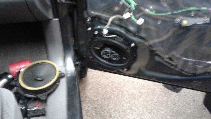

    I put in some kicker 6x9's 3-4 months ago, very happy with them so far. Still have the stock head unit and it still makes a huge difference.
    In my base model 2010 the stock speakers were garbage, anything will make a noticeable difference. I can finally hear the radio/music on the highway without going past vol. level 40.
    Check these out, i think they're a pretty good deal. You could pick em up at best buy today. Don't bother getting the wiring harness, i didn't end up using it and returned it.
    http://www.bestbuy.com/site/kicker-...lene-cones-pair-black/7740065.p?skuId=7740065
    ps, sry for the shitty pic.... its the only one I have from this mod

    Did you have the factory JBL system? Those came with a sub behind the rear passenger side seats... if you are shaking all your mirrors with a stock system then what was the problem? Most people are complaining about not being able to hear the music, or it lacking in bass.
    The new JVC headunit pushes more power to your speakers than what your old HU did so if you get some speakers with a high sensitivity then you should be good. Look for speakers that want about 40w RMS. Generally some cheap Alpine, Kicker, Rockford Fosgate speakers should do fine.
    With the new headunit, you probably lost that sub because you are not connected to the factory amp... if you had the JBL system. That would explain why you lost all your bass.
    Also check out the Alpine power pack. Its a cheap/easy option to add some power to your speakers....

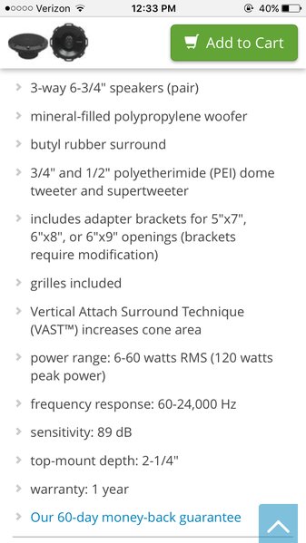

    Heres is the stats of the rockford fosgates, they are saying 6-60 watt rms.

    Now with the new head unit you have.... your after market HU will push 22 watts rms to each speaker where a factory HU is typically between 8-15 watts RMS, so yes the new HU should push more power. But the factory speakers were designed around the factory HU, that is why they sounded better.
