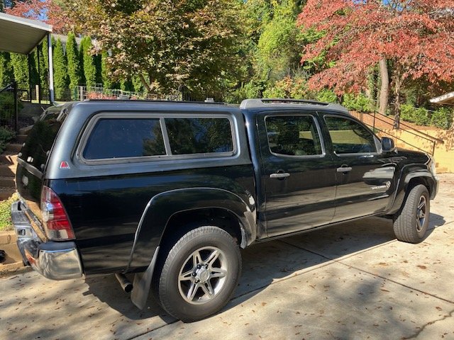

    Thank you all for input - my plan is before I go remove side rail caps and seal around holes with silicon caulk then replace. Install front rail seal.
    Bring a roll of cap seal.
    Maybe after we remove cap I can remove his old cap seal, install fresh to cap, and then cap to my truck.

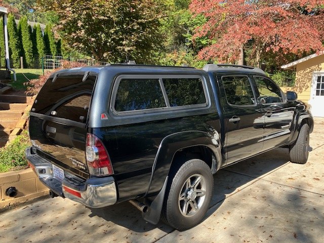

    Happy with the fit and look. I need to figure out and do the work of wiring the third brake light and interior LED. May still need to tinker with the door latch and locking mechanism but it locks as it should. The locking Thule cross bars have been removed unless and until I need them. Will monitor for leaks and tune that as needed. Thank you all again for ideas.
