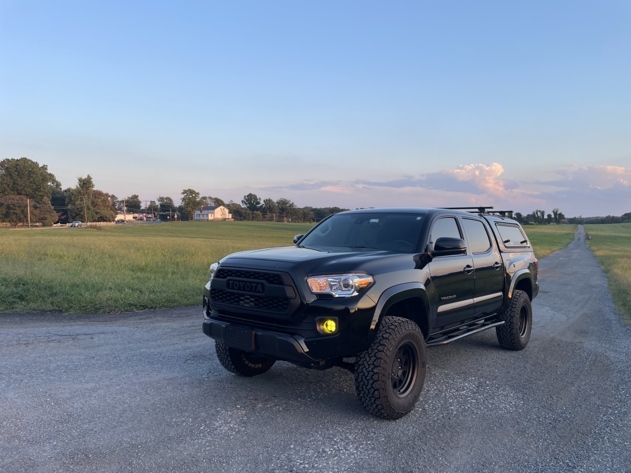

    Here is my truck with 285/75/16 Yoko goo3’s:

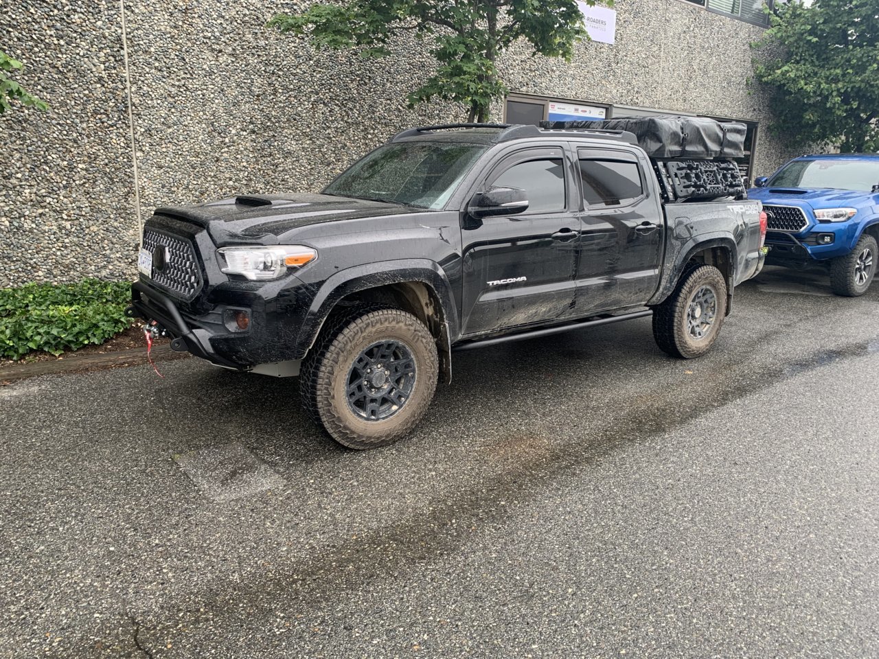

    Here is my truck with 265/65/16 General Grabber ATXs:

    Great looking truck. Those two pics are exactly why I find myself on the fence with tires. They both look good and I am sure they are both just as capable. Thanks for the post!!

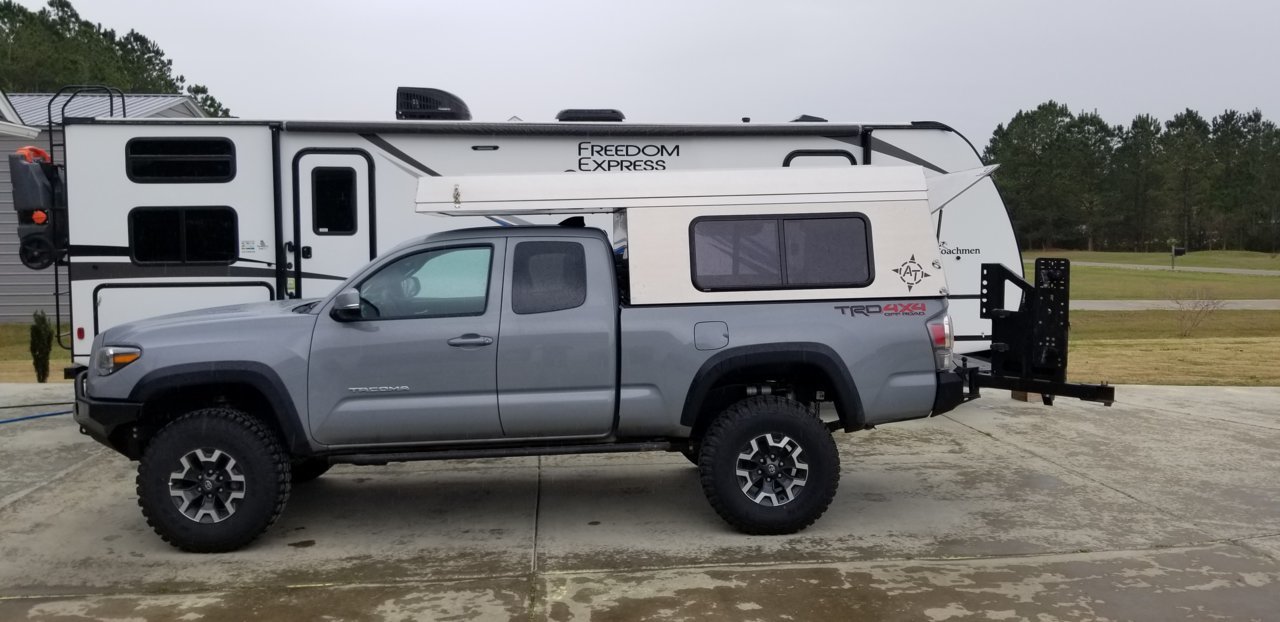

    Good looking rig! How have the 'skinnies' been with towing? Are you towing the travel trailer in the pic? It looks pretty big for the Taco.

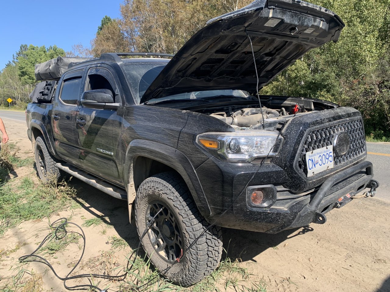

    Love my pizza cutters. They work great on and off-road. I can still get advertised mileage running 33”x10” E load tires. I’m lifted 2” by the way.
    My next set will be a 255/80/17 as well.

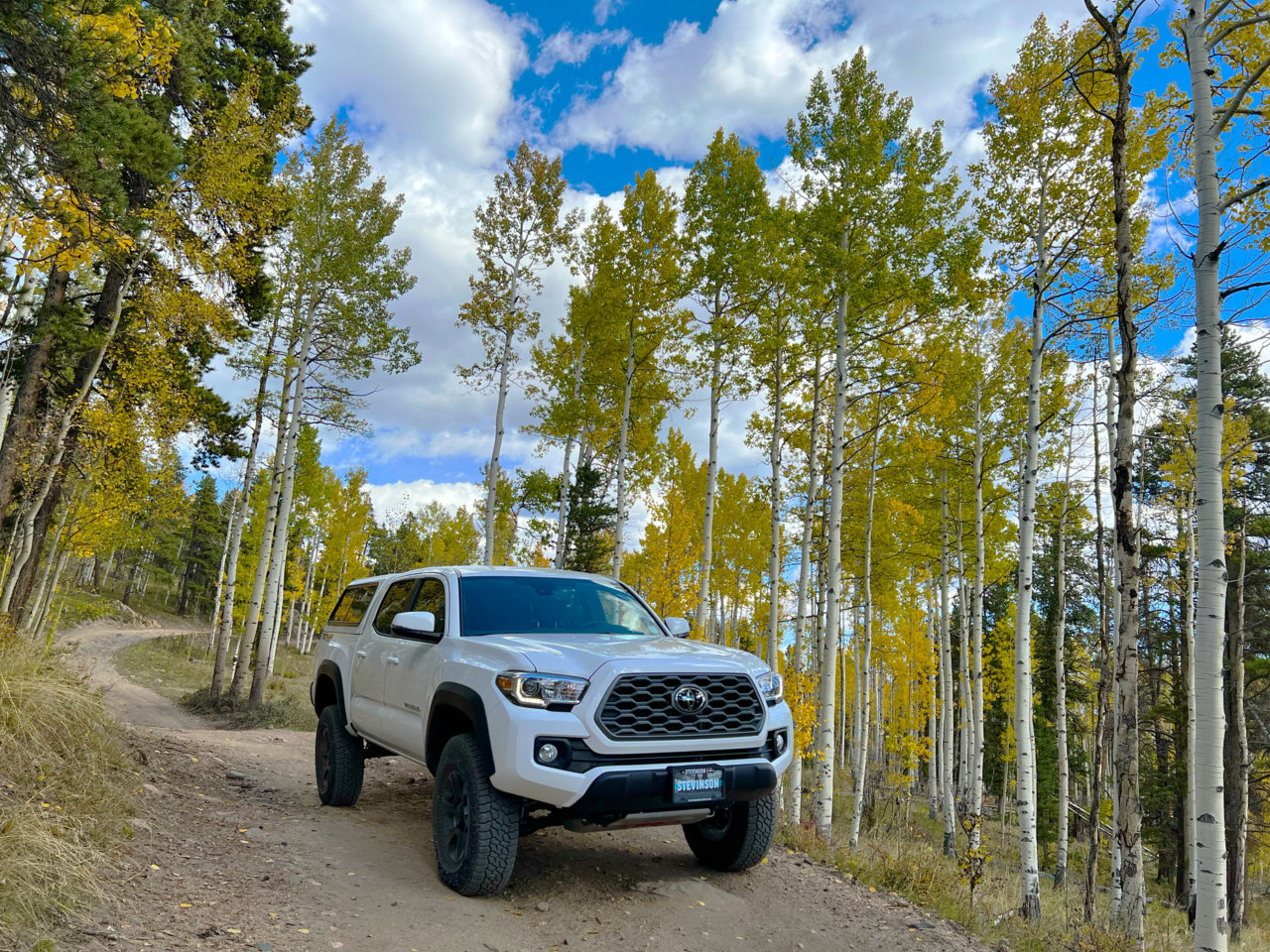

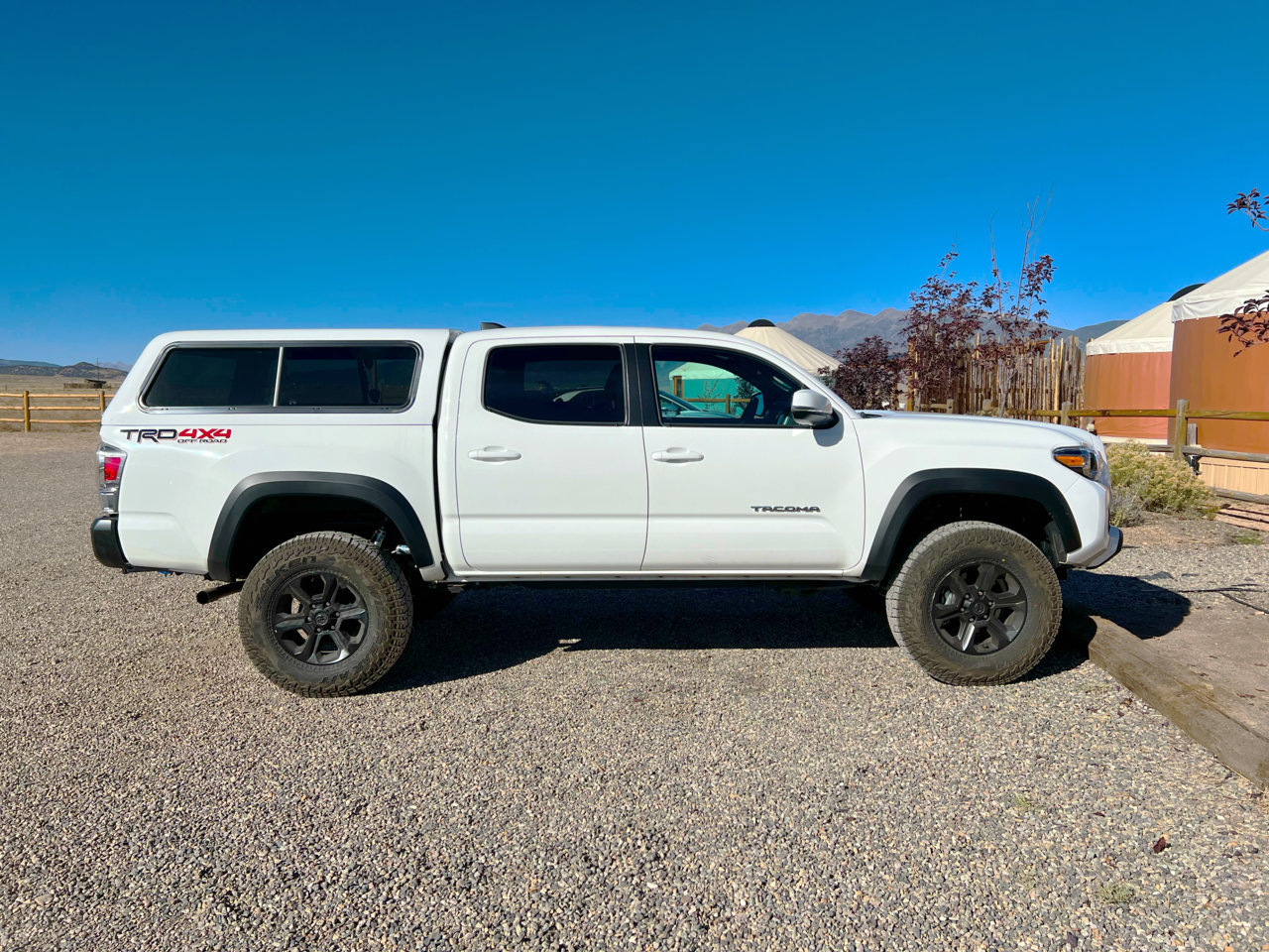

    02BC9699-3929-4AAF-9643-D3D3750772F8.jpg 02BC9699-3929-4AAF-9643-D3D3750772F8.jpg 747FD009-3460-4E1E-8818-18D4D794B180.jpg 255/80r17 Falken AT3W with a 2.5” bilstein 6112/5160 and RXT leaf pack (stage 3)
    dleriche, SunRunner, Junkhead and 2 others like this.

    Thank you! I’ve had everything from 235 to 285 and keep coming back to 255, especially since there are lots of AT options now.
    although I’m drooling over the Toyo AT3 in 34x10.5r17… 33.5x10.5 at 55 pounds sounds like the perfect tire
