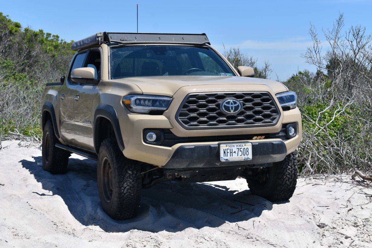

    Looks awesome! Curious what your wheel offset is and if you needed a CMC for your setup?

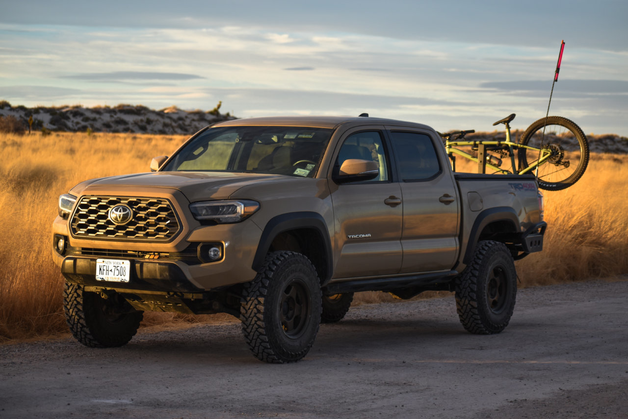

    2020 TRD Offroad Quicksand
    wheels are 0 backspacing. no CMC, no rub at full stuff or wheel lock

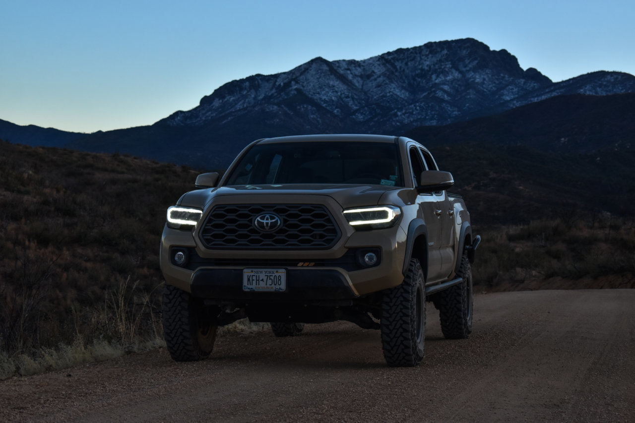

    I was hearing a bit when turning under compression on both sides. Before spacers, it was only the passenger side. I did a very minor trim on some plastic behind the tire where the mud flap used to be, and so far it’s gone.
    Factory lugs didn’t really poke past the spacers, but even if they did, there’s recesses on the back of the stock OR wheel that could accommodate.

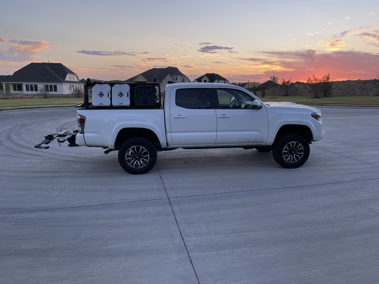

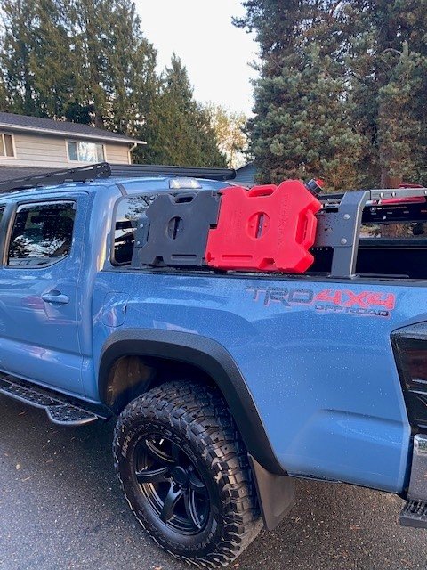

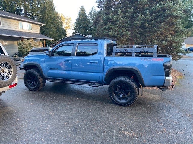

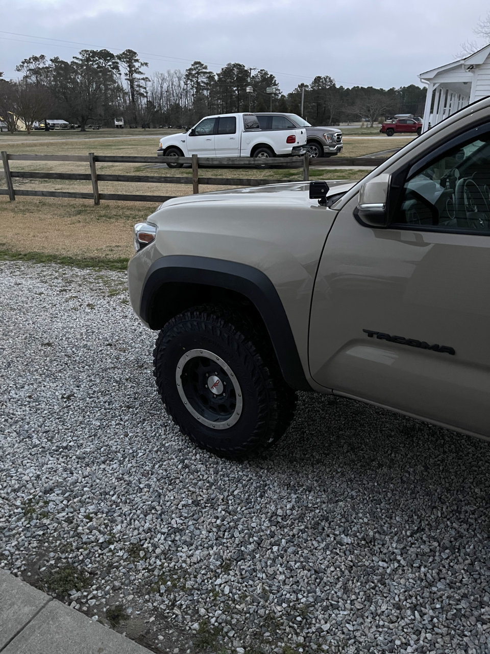

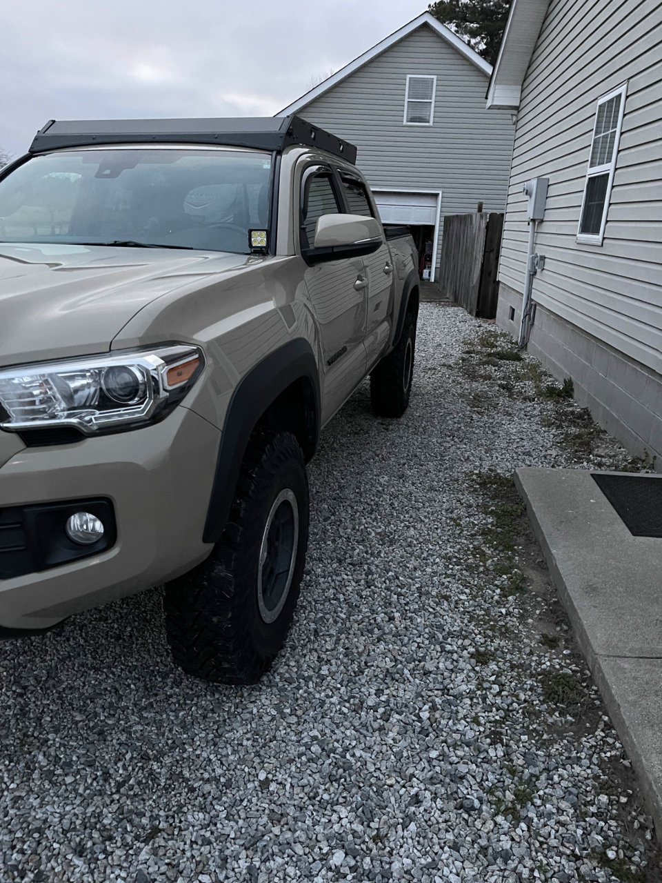

    OK, as promised. I got the 255/85R16 Geolandar G003 M/Ts installed/aligned today. Pics are below. Haven't driven on them enough to develop a real opinion, but I do like the looks and they did seem to ride pretty smooth.

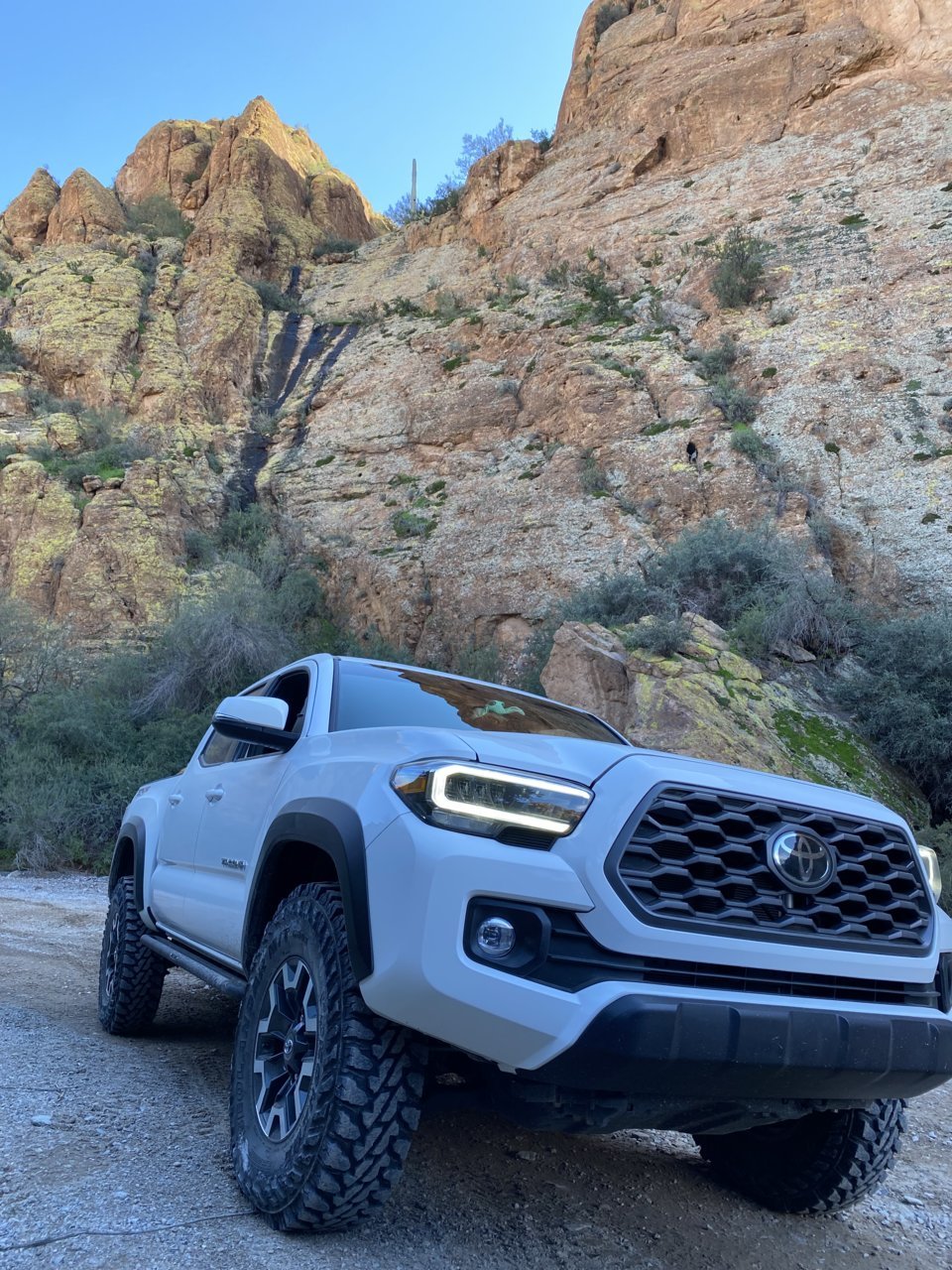

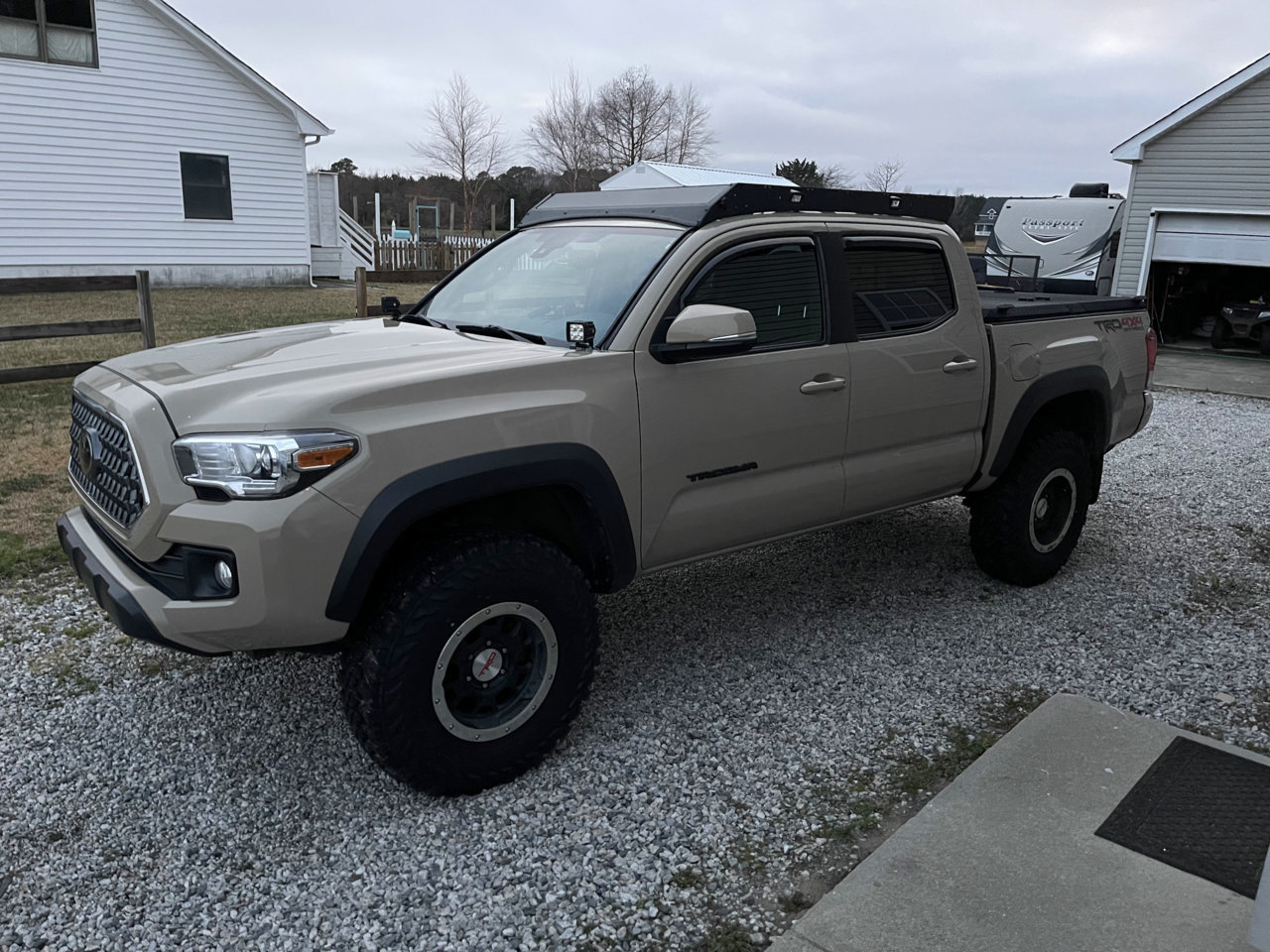

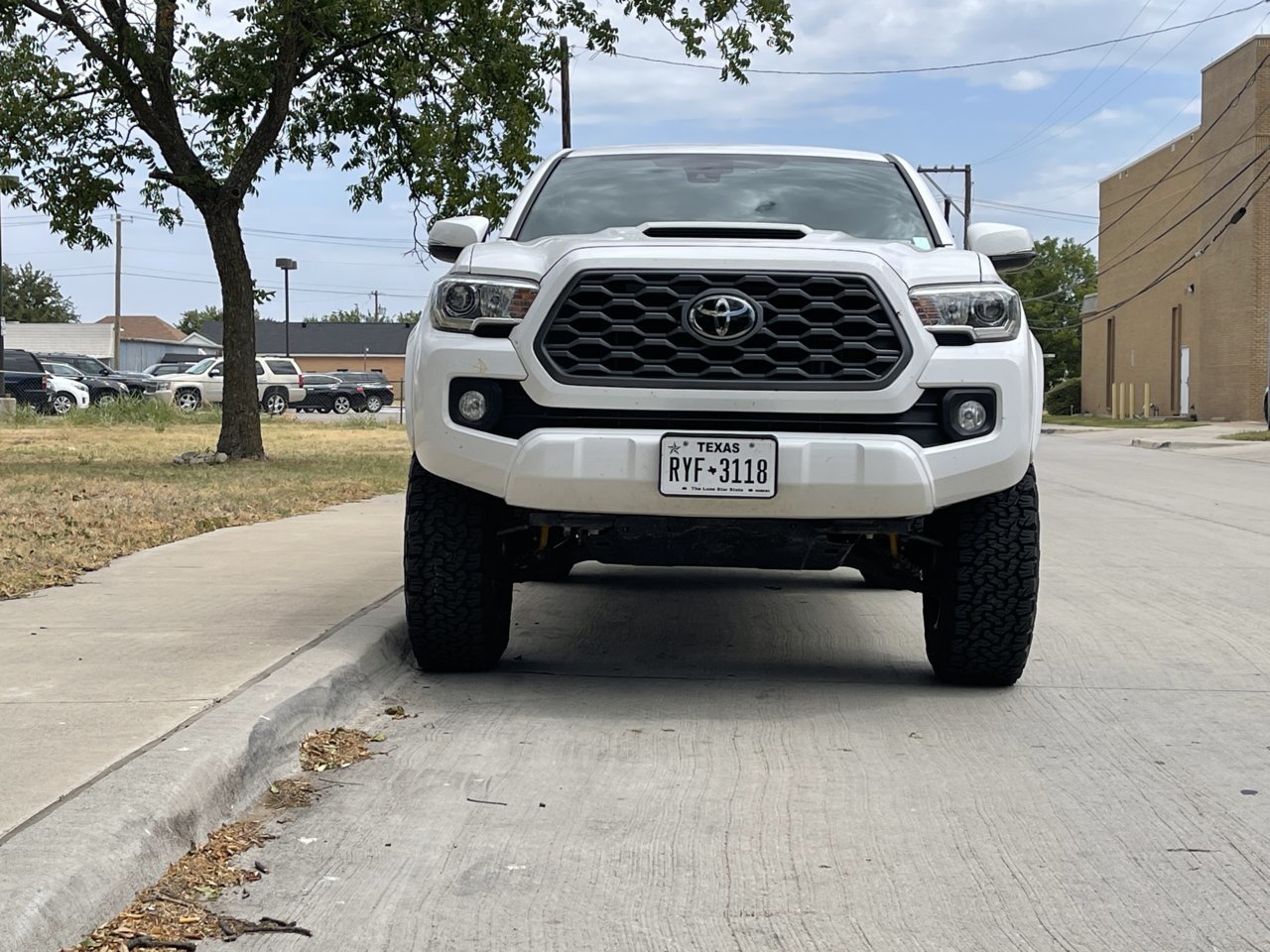

    Here’s my ride 255/85/16 geolandars. Figured I’d try here since it’s less busy but anyone here have a negative offset with skinnies (debating between 0 and -10)

    I added 1” spacers to the stock OR wheels, which essentially makes them a 0 offset. Gotta trim some plastic.

    As I understand it, the TRD Baja Beadlock rims I have are -10 offset. You can see how they look in the post above yours. I don't think they sit any wider than the OR rims (at least by looking at your pics). It's been rainy and nasty this week but I will get out there this weekend at the latest and see how we are looking for rubbing. I think your set up looks pretty good.

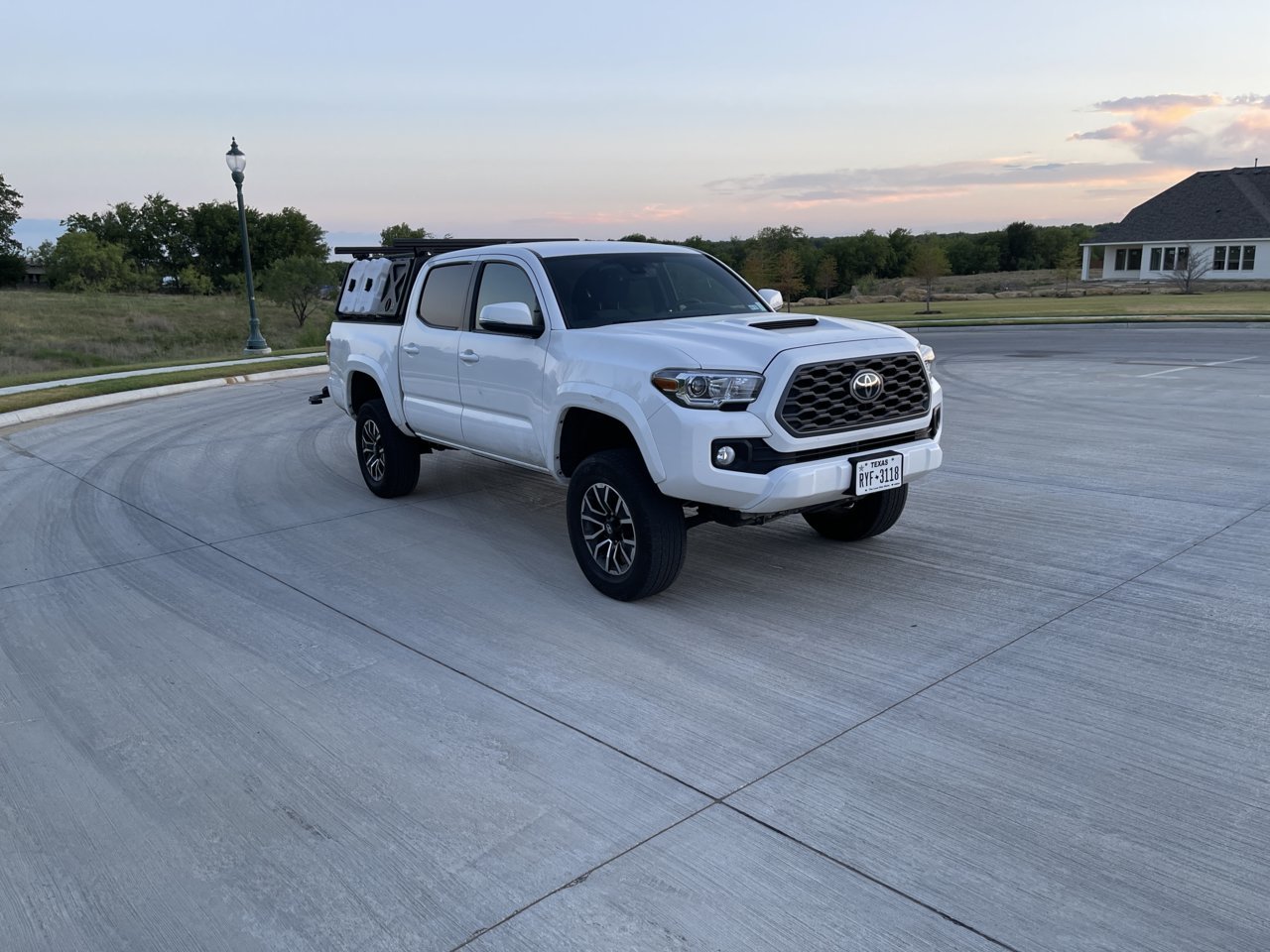

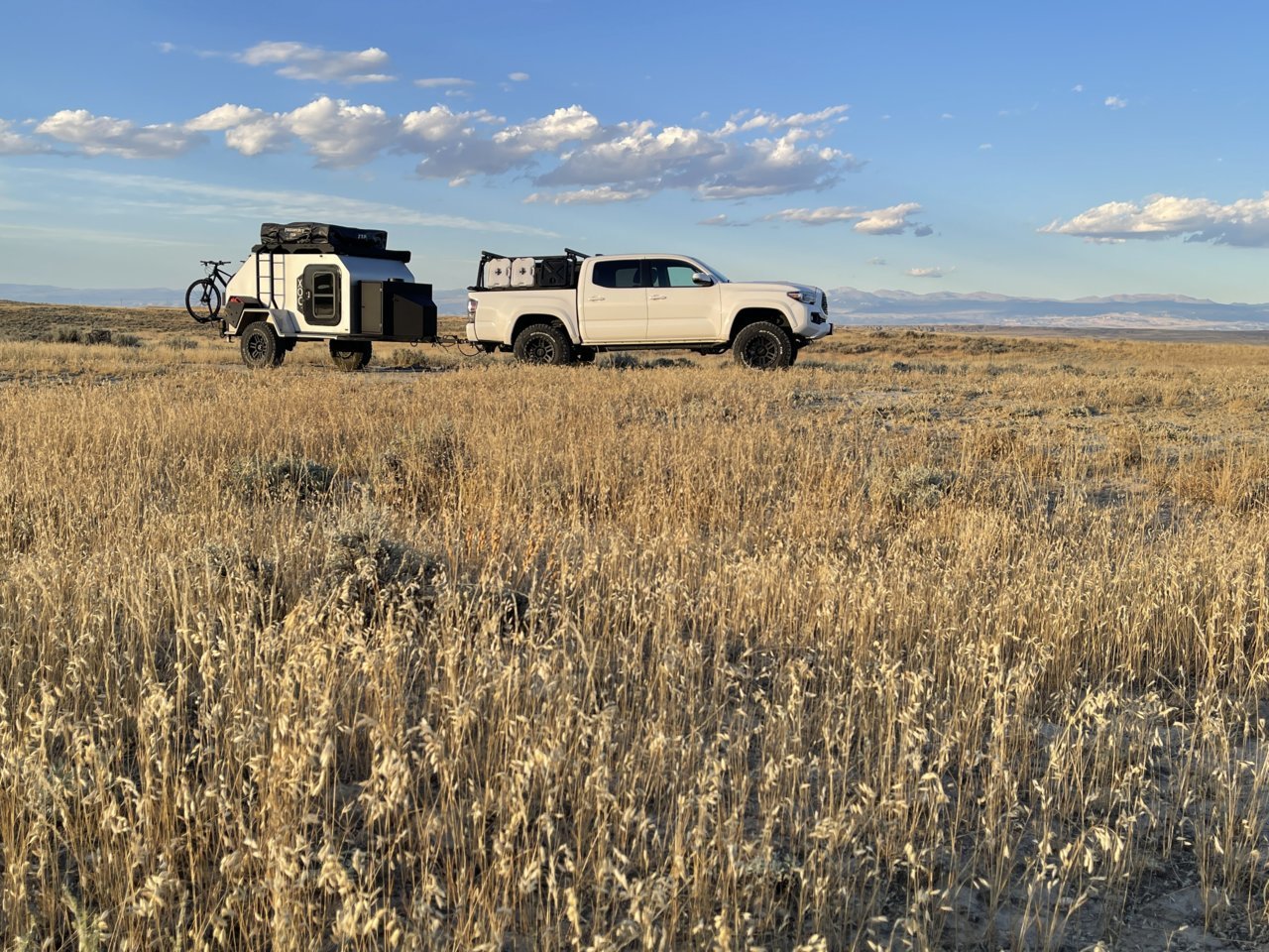

    '21 DCSB TRD Sport 4x4 Auto

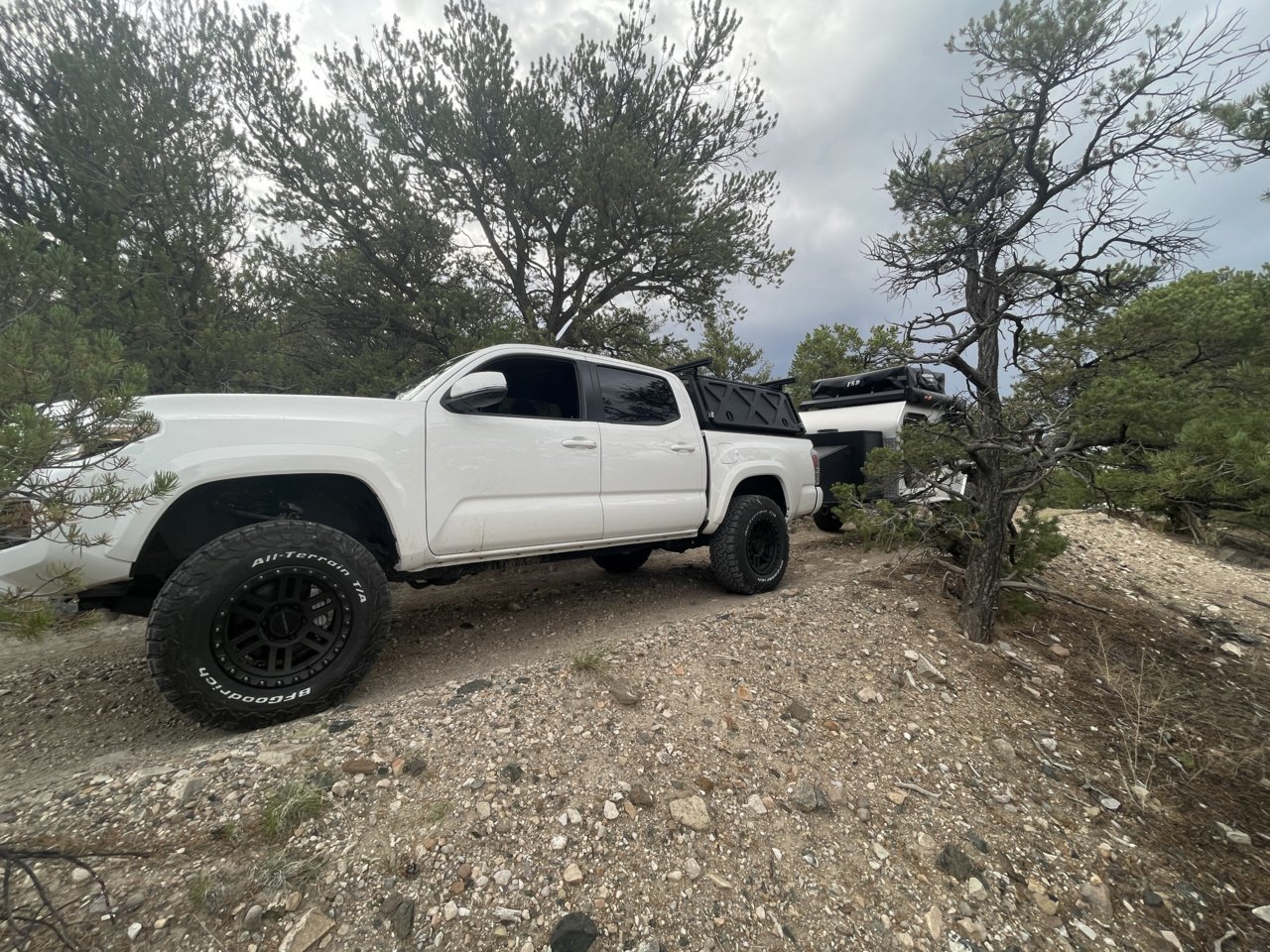

    • The pics in the subdivision are stock 17in wheels and the stock 265 Toyo A30s with an OME-005 2.5 in Heavy Lift kit. This is just after I finished the job and the truck is sitting 3 inches higher just because the heavy kit hadn't settled.
    • The rest of the pics are with 275/70/17 KO2s on Vision Manx II 17x9 in wheels with +12mm offset. Trailer is sitting on 285/70/17s on the same Manx 2s.
    No CMC and no rubbing 99% of the time. The only time I rub is at full stuff with the wheel locked and that rarely happens except for extreme off road situations when I am towing which I tend to avoid.
    Stock 17s and 265 Toyo A30s sitting on a 3in lift
    Upgraded wheels, tires, and suspension settled to 2.5-2.75 in
