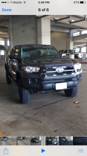

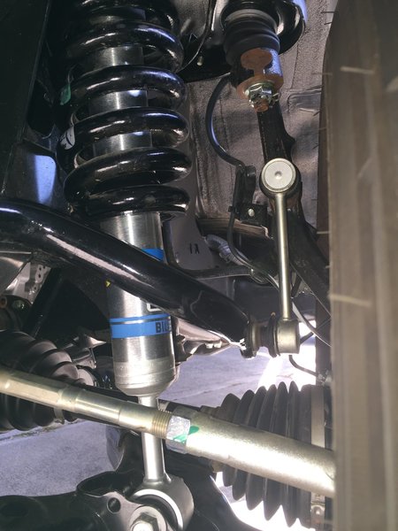

    I got mines installed today and it seems nose high in my opinion lol is this how your shocks looks ?

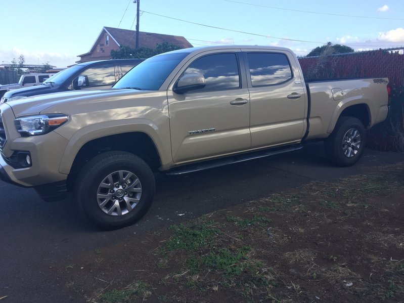

    Yes, my shocks were set on the .85 setting, second notch from the bottom. This is what the results look like. If you get the time maybe take a similar side photo and post it for comparison.

    It looks fine, but I think the small stock tires need to go, when you add your new upgraded tires the look will be perfect. What tires are you looking at?

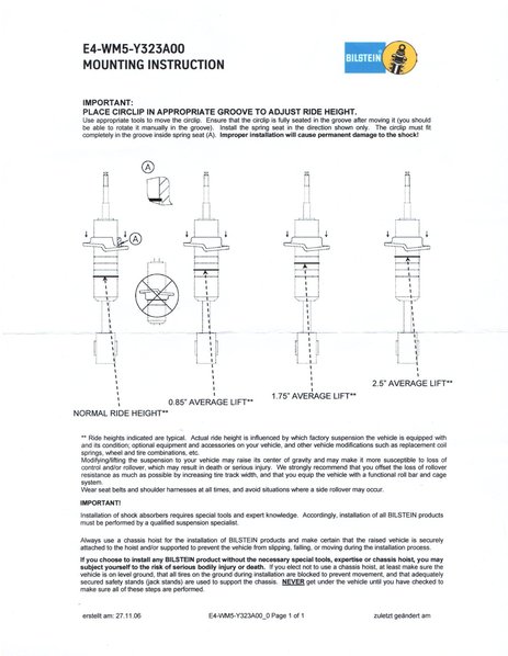

    I'm new to this but does .85 mean under 1 inch? or is there setting on the shock that reads .85?

    This should help
