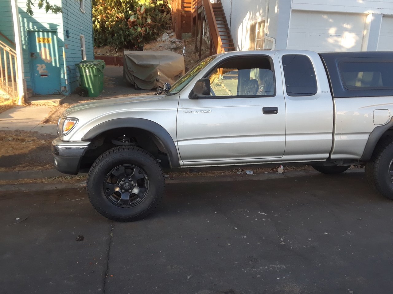

    20170725_173412.jpg rago fab.

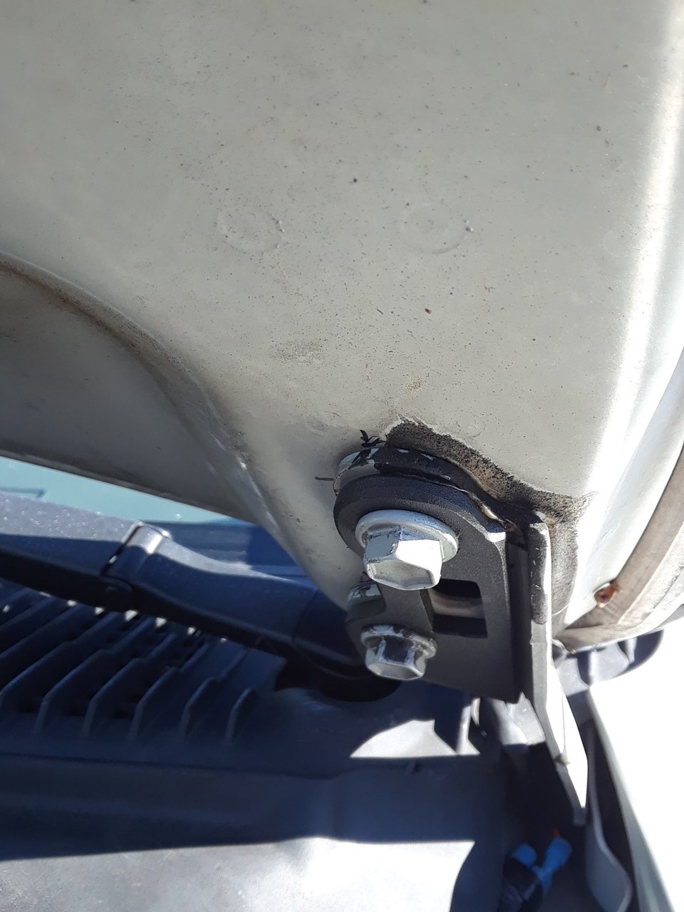

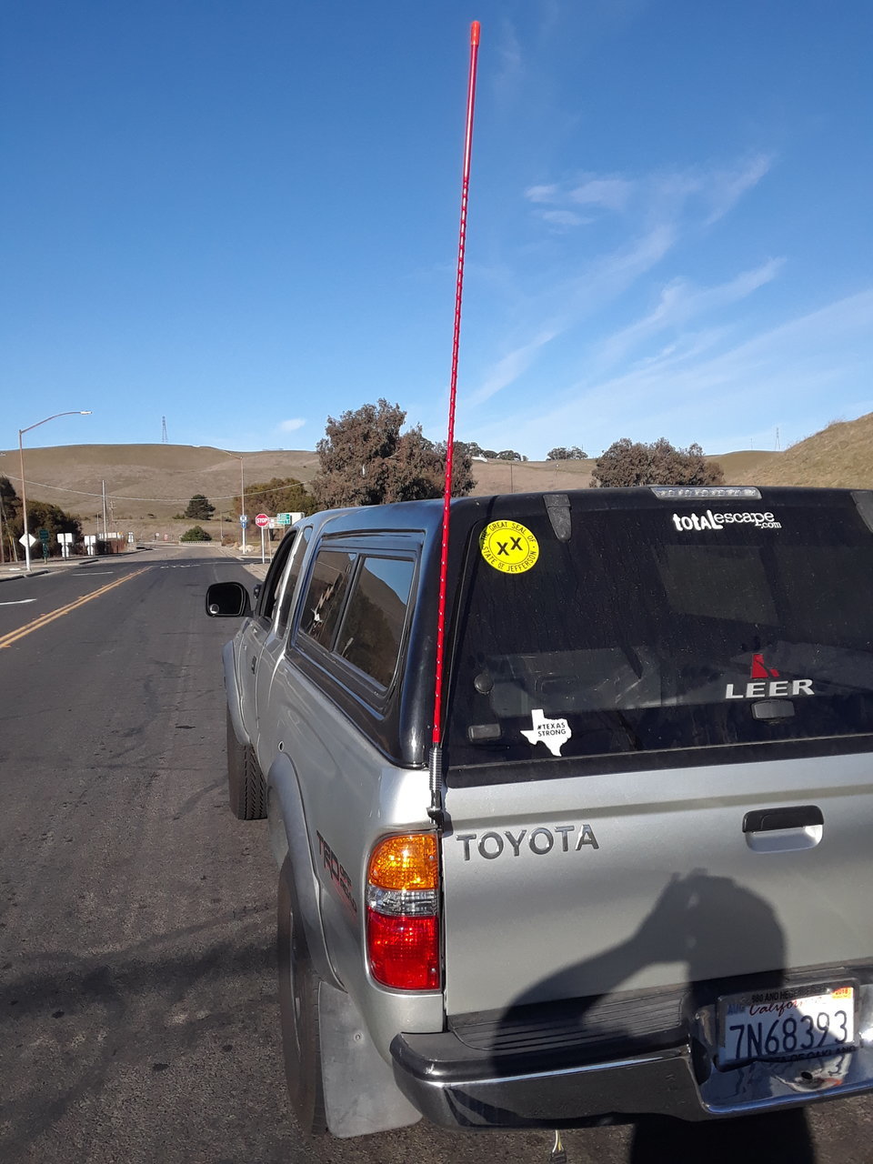

    The rago brackets use the hood bolts, maybe 7 mins per side. The rear cb mount took 3 mins. Just a 4' Firestick and mount. Ditch lights are Amazon cheapies. I work on the south side of richmond ca. So im not putting big money lights up there. The wife loves cruising back roads with the ditch lights on at nite. Sees all the critters out there

    Rago fab.like 65.00 bucks. 1st gen brackets. No trimming. Easy install. Buy a cheapie wiring harness it'll have a switch and relay. Plug and play.

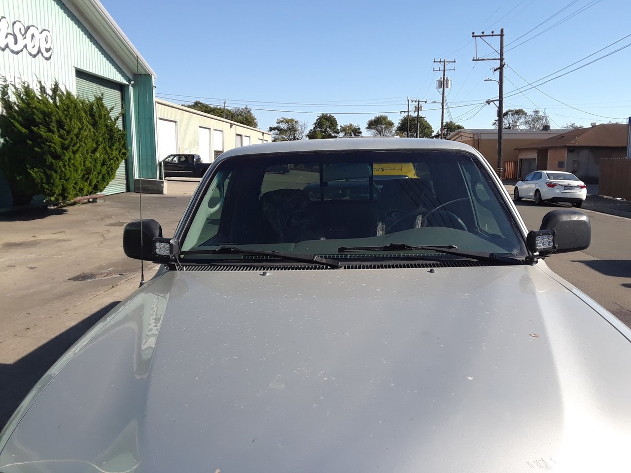

    20171015_173444.jpg the way they mount you barely notice them.

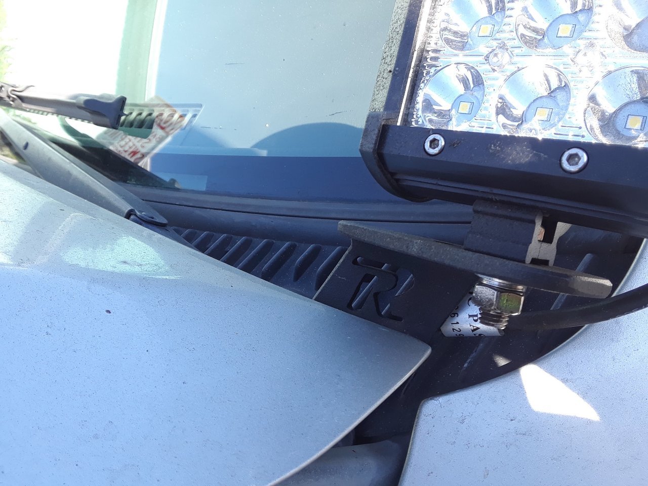

    20170725_173405.jpg how they mount to hood. Uses the stock hood bolts.
