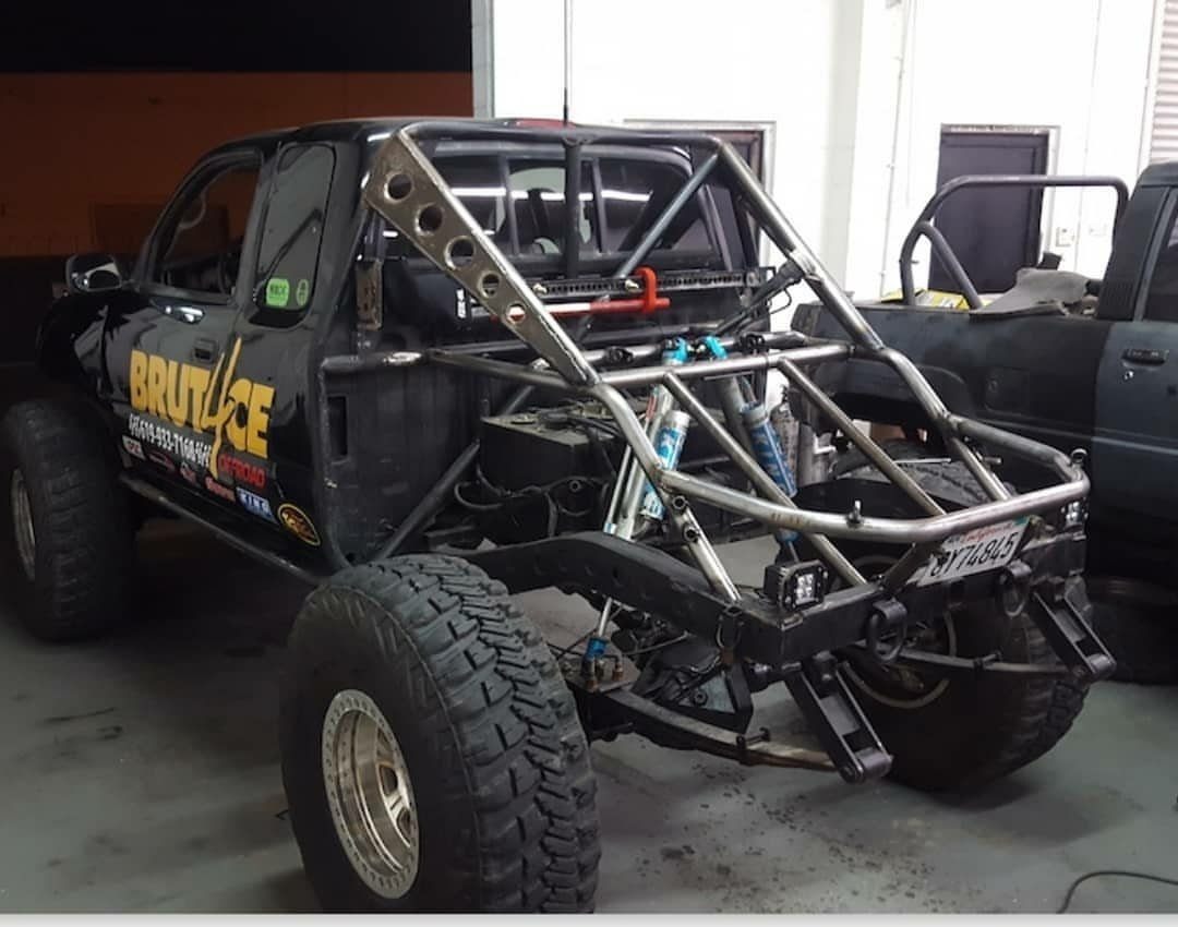

    I am more of a Rectangle tube frame builder I had a company that could bend the tubing the name slips my mind.

    Maybe not quite this extreme but the back half of this thing is kind of what I am thinking about.
    I would still like to have some open bed area so I can still haul junk with mine.
    Of course I would still be running leaf springs.
    They pretty much ditched the whole back half, bent up some tube and built their own set up.
    JudoJohn likes this.
