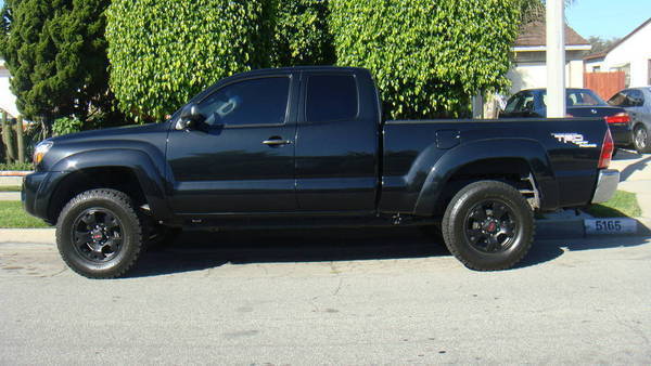

    I would love to see a pic of a taco with 1.75 setting on billy 5100s up front and nothing done to the rear.
    Thanks!

    So the one on the bottom sits pretty level... mines an access cab as well and was wanting to sit level. how is the ride quality btw?

    heres 1.75 no tsb i was still a little higher in the rear ....now Im at 2.5 and a 1.5 aal [​IMG]

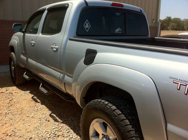

    1.75 in the front with 1/4" spacer on drivers side for taco lean... stock non tsb rear... just a hair higher in the front.

    Taco lean??

    taco lean: nearly all tacomas well 2nd gen's at least, tend to be a little lower on the drivers side, most likely caused by the battery, the driver, the gas tank etc.. alot of heavy things all on the drivers side. so a common "fix' is a small spacer on just the drivers side.
