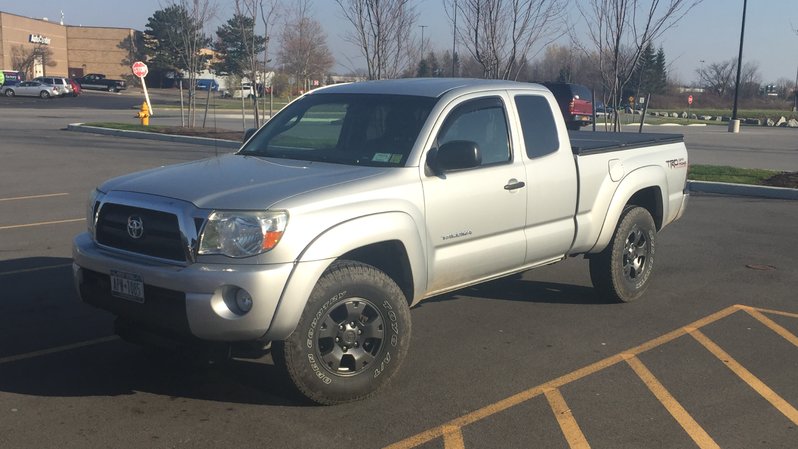

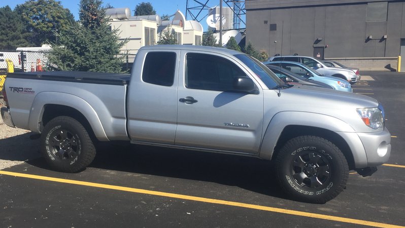

    5100's at 1.75, 265/75/R16 Toyo Open Country, I have the stock rear springs after the recall. I do have Firestone air bags in the rear but I normally dont keep them aired up unless I am towing something. It really depends on how much your rear leaf springs sag. I think before the leaf spring recall mine did sit just barely nose high but it was barely noticeable.

    I may have a few pounds of air in the airbags in my pics. I honestly dont recall. I can raise and lower my rear end using the air bags. Of course it stiffens the ride, but I like it slightly stiffer.

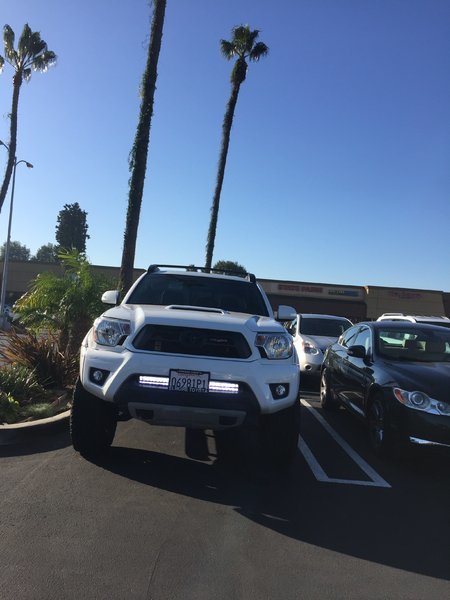

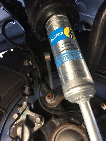

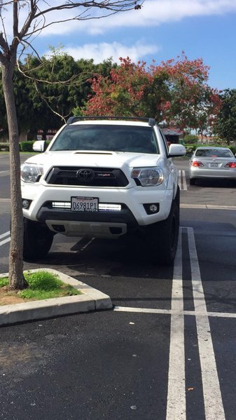

    5100s @1.75 on Sport coils.
    Before
    After

    I also jumped up to 265/70/r17. At first there was "bro lean" but it has leveled out now. Anytime I carry anything in the bed though I sag in the rear.

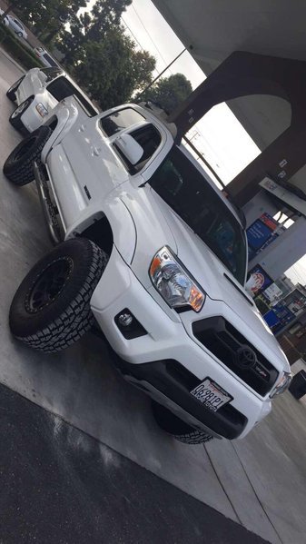

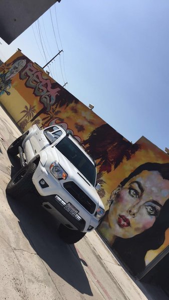

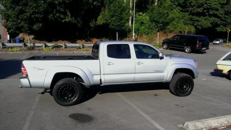

    This is how my truck sat when it had 5100s set at 1.75" and the stock Dunlops.
