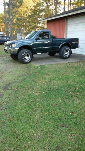

    I have the setup you're looking for on my 97 Tacoma. I replaced the front coil springs with new OEM Toyota just because of age. It really doesn't ride bad at all. Actually rides better than the way it was (original). Also, it's not that much higher in the front than the rear. I had planned on raising the rear an inch or so if necessary, but it it looks fine the way it is & I don't tow anything heavy.

    That's about as level as it gets. Looks good
