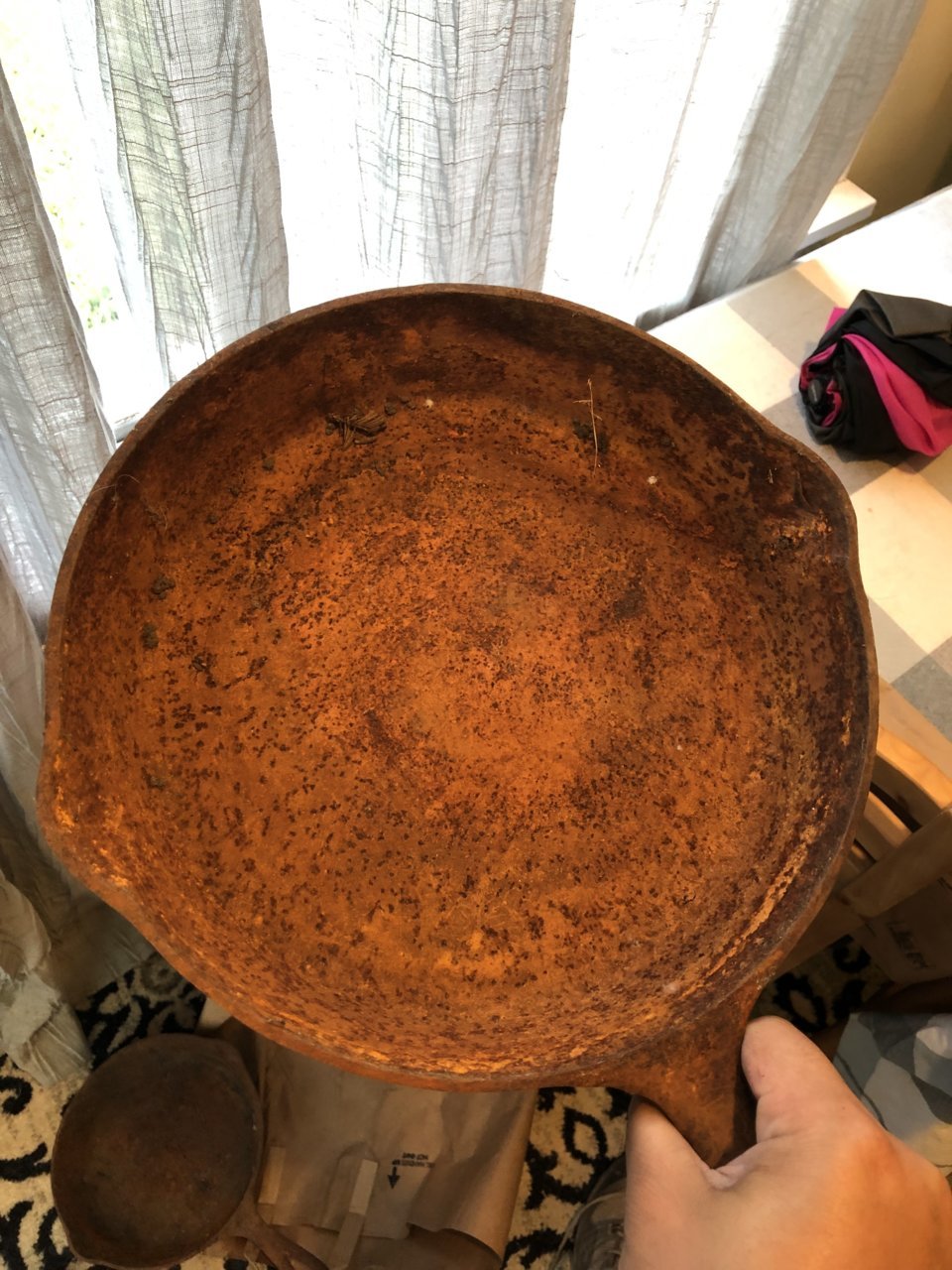

    I think the "mod" is to sand it smooth then season it ;)

    Id try the vinegar soak method...Id soak it overnight and see what it looks like.

    It's a manufacturing method that Lodge does. The process for seasoning a smooth pan takes a lot longer than something bumpy so Lodge deliberately makes theirs like that so that way the seasoning process during manufacturing is a lot faster and they can produce a larger volume ready for sale. At least that's the reason that I've seen some others on youtube talk about.

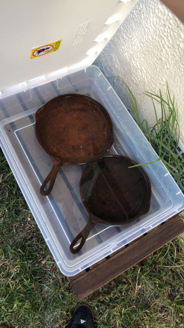

    That's what I plan to do. I'm going to get a tub and vinegar at target friday and let that go overnight and then hit it with a wire drill saturday. In the mean time, they're no longer being stored outside in the rain we've been having here in the bay anymore.

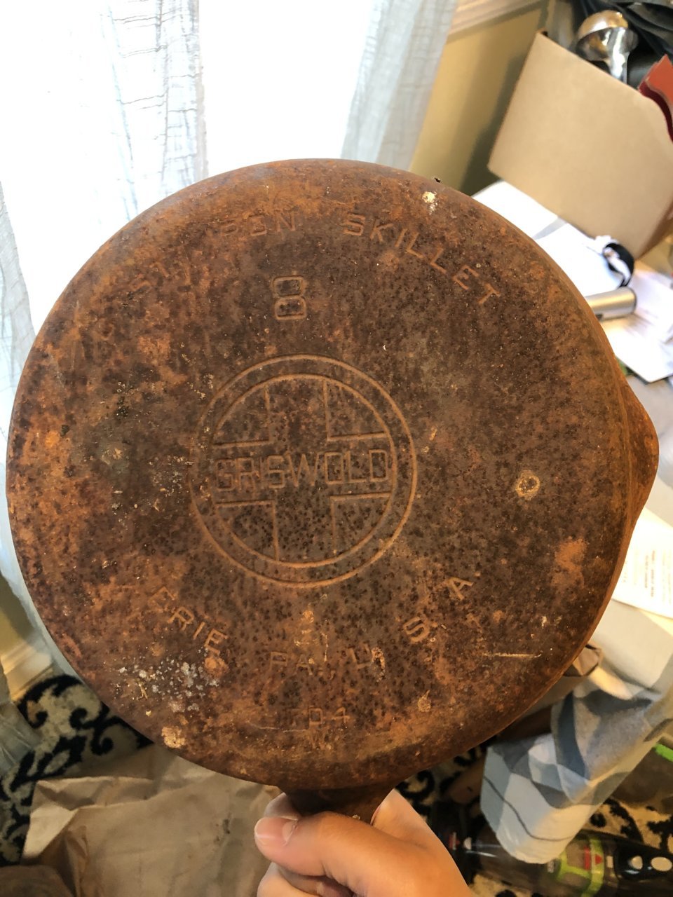

    Can do! I'm a little curious about the number 6 skillet mostly since it's pretty bad and I can't quite date that one as readily. The bigger one I would say is sometime between 1924 and 1940.

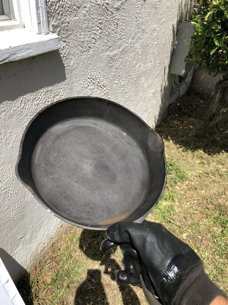

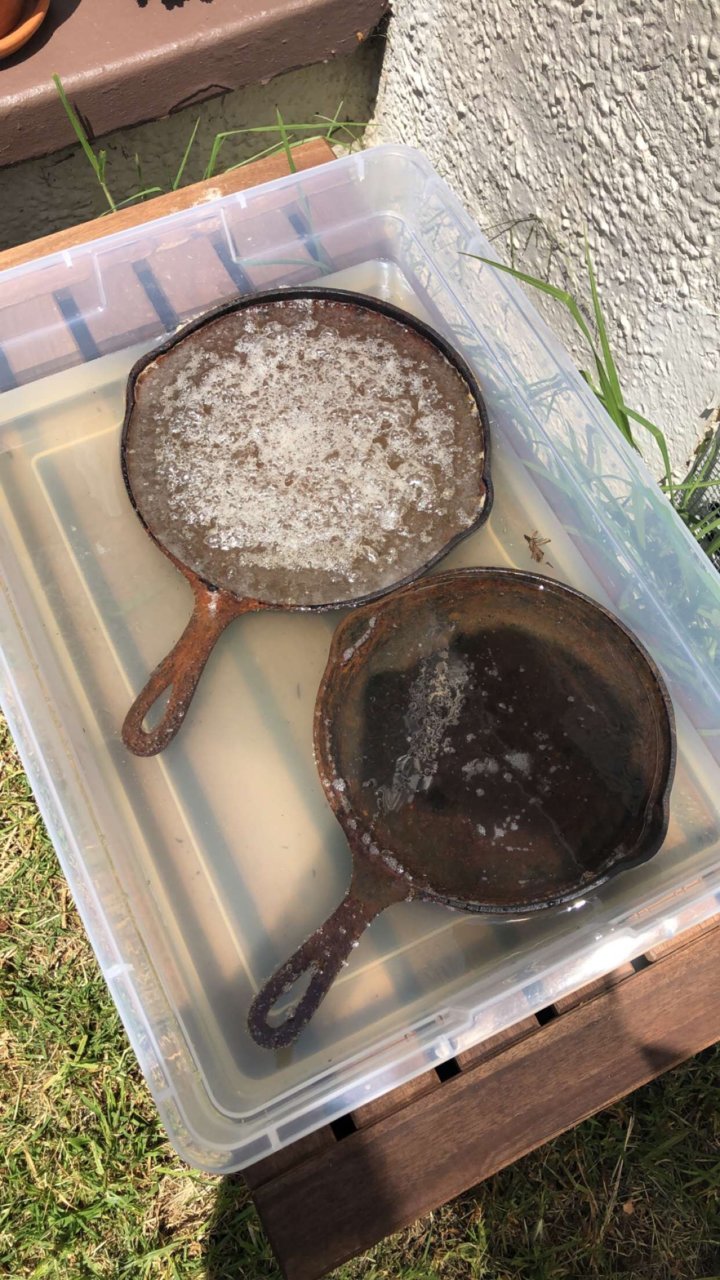

    So pans went into the vinegar bath last night and this morning, I was amazed to see on the No 8 skillet bare iron through the rust already. They've both had a preliminary working down with a Nylox and a S/S wire brush and they are starting to look like actual pans again.
    They'll soak for a little longer, but I might have to wait until Monday to finish up if it does rain tomorrow.

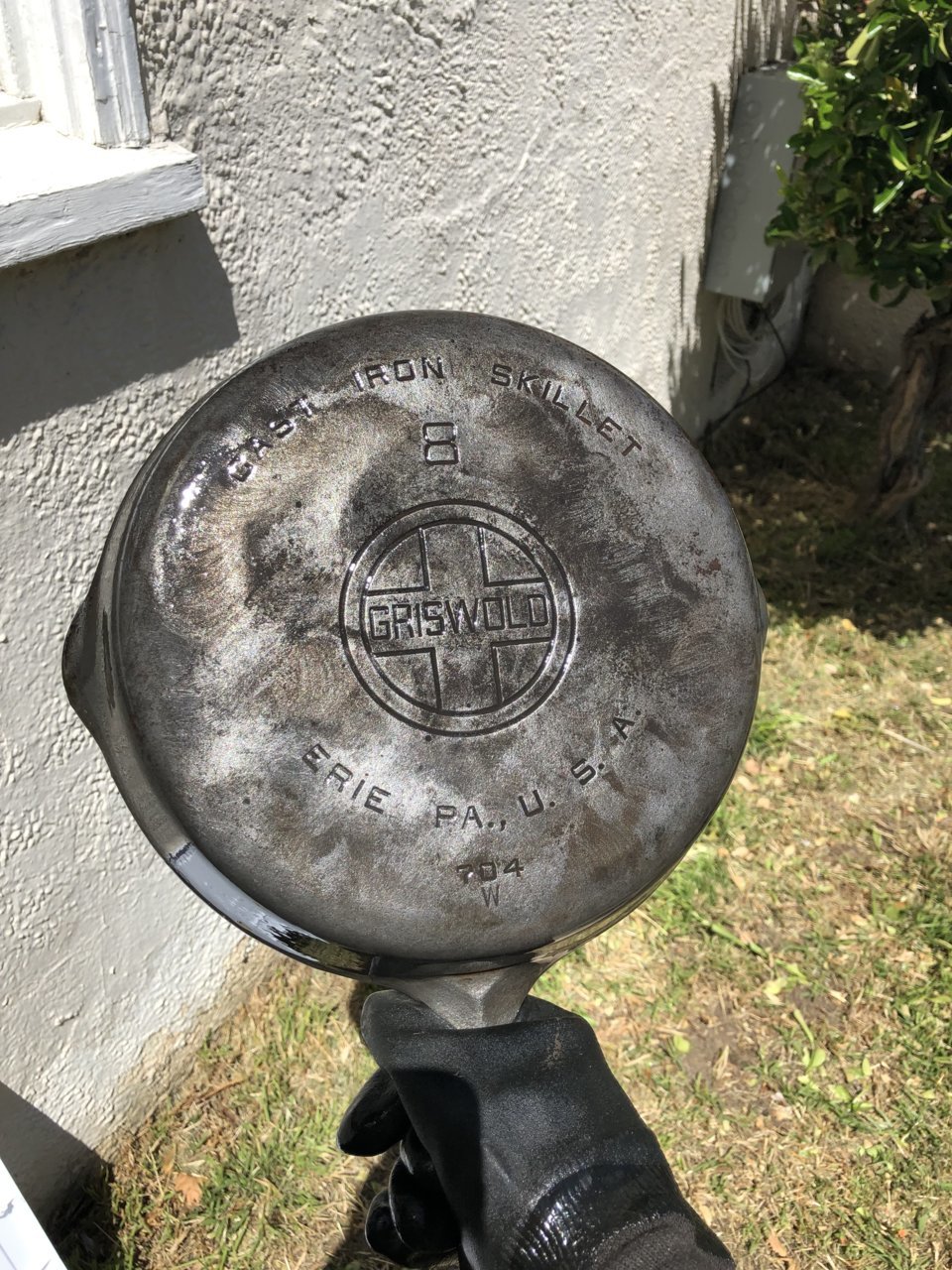

    06F32760-365F-4C82-9E31-A998A091F72F.jpg A426693F-2054-4829-8FE5-A06889BB74E3.jpg
    The no 8 cleans up real nice. It's in the oven baking it's first coat as we speak.

    The number 8 in the back with three coats and the number six as bare as I could get it. Right now, they're getting their final and second coats respectively.
