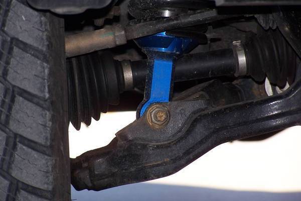

    heres mine with 2.5" of lift with diff. drop.got 5000 miles on it with no issues except the mild vibes between 35 and 38mph.[​IMG]

    I'm new to this and all, but that angle doesn't seem harsh at all. Correct me if I'm wrong though... Any idea as to the vibes? Does it feel like its coming from the rear (lifted rear?), from the diff?
    Thanks for posting the pic, I really appreciate it.

    STL im pretty sure its from the front(vibes).it a long drawn out story but it seems to b some get it and some dont.cant answer why though.i do no i had the 3" spacer lift and the vibes were REAL bad.took all that JUNK off and went to foxs set at about 2.5" and its a bunch better.so im going to say the cv angles were to much imo.again,some people get it and most dont.but it deff. wouldnt stop me from doing another one,thats for sure.

    Like to OP, I'd like to see the cases of 2.5" in the front. The first picture looks encouraging.

    3'' seems to be a bit far. the pics of 2.5 dont look bad at all!
