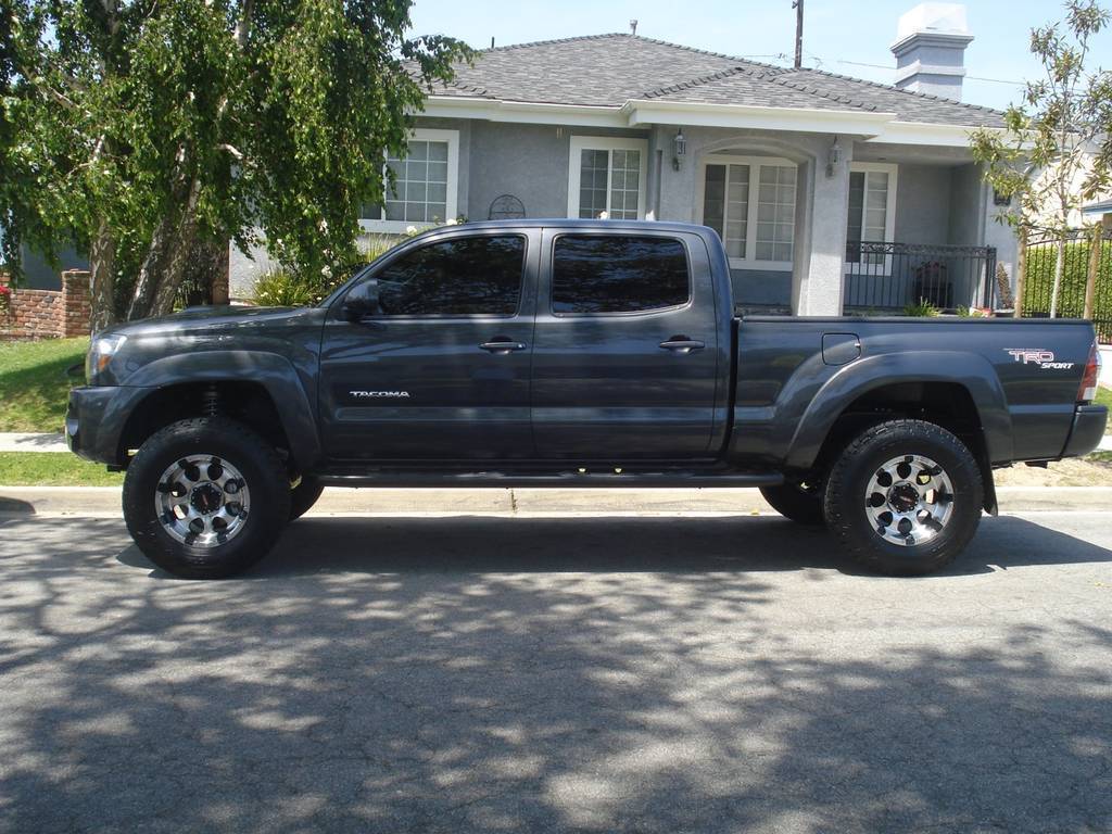

    can u guy please post pics of ur 3" lifted truck from the side and tell me what size rims and tires you have? im torn between 275 and 285 so this should help
    i gunna throw this question in...in a 285/70/17 tire the second number is the height right so why does it look much bigger than a 275/70/17 and only the width change?:confused:

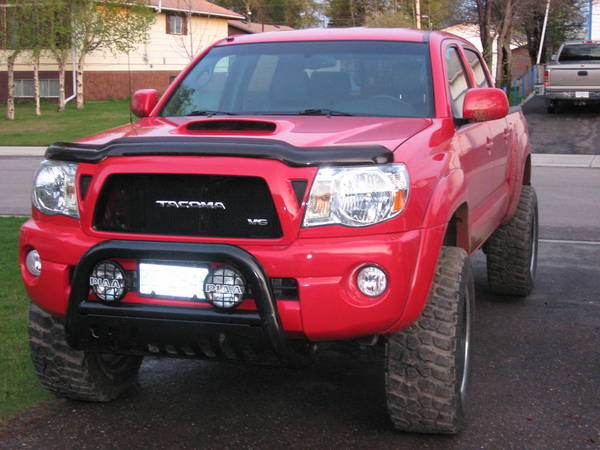

    305/60R18

    My tires rub though, I should mention that. I already trimmed the body mount, but they still rub a teeny little bit on full steer. oh, and I got a 3 1/2" lift on the front.

    Probably because of the width of the tire but what is your offset and back spacing?
  12. May 27, 2009 at 10:01 PM
    mneuls
    mneuls Well-Known Member
    Jul 9, 2008
    #7836
    279
    Fort St John, British Columbia, Canada
    5100's and dakar leaf 3"lift, Satoshi grill,
    Bilstein 5100's front and back, dakar 3" leaf springs, Westin bull bar, piaa driving lights, piaa replacement bulbs, H/U, 2x10" mtx tt65 subs, 1000w clarion monoblock, Mtx surround speakers. green wire mod. Flowmaster 40, airaid intake. scanguage II.
    i have no idea. :notsure:

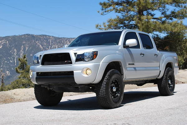

    3" w/ 32's......
    3" w/ 33's......
