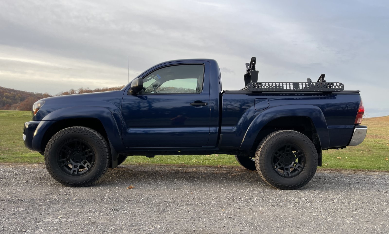

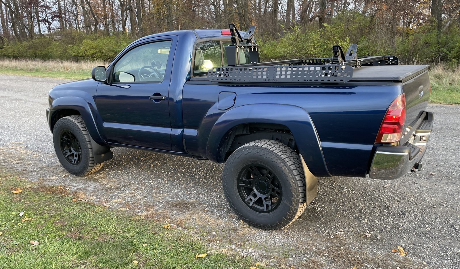

    These are 17x8 FN Wheels f(x) Pro with zero offset. Front tires are 265/70R17 Falken Wildpeak A/Ts. And rears are 285/70R17! I went with staggered sizes to fill up the rear wheel well better - it's a 4 cylinder, 5 spd, 2wd PreRunner so don't need them to be the same size. I removed the stock mud flaps and had some rubbing behind the front tires on at the bottom of the fender flare - so I trimmed the flare. Then, added some WeatherTech mud flaps that are pretty significantly chopped up to clear the tire. Front suspension is stock, and rear is lifted an 1" on Deaver springs, but was not necessary to fit the tires...
