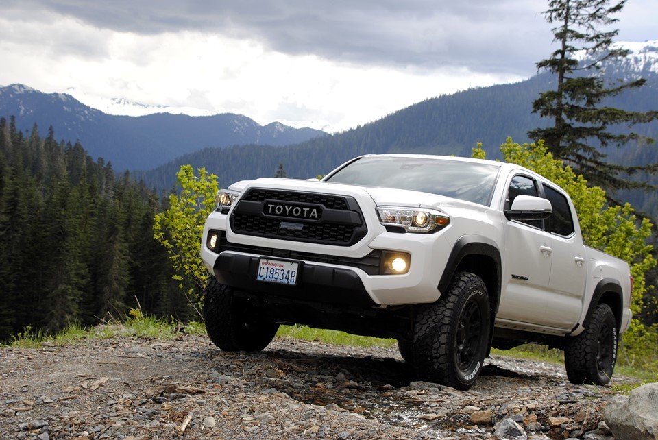

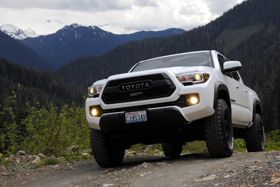

    Here are some angles

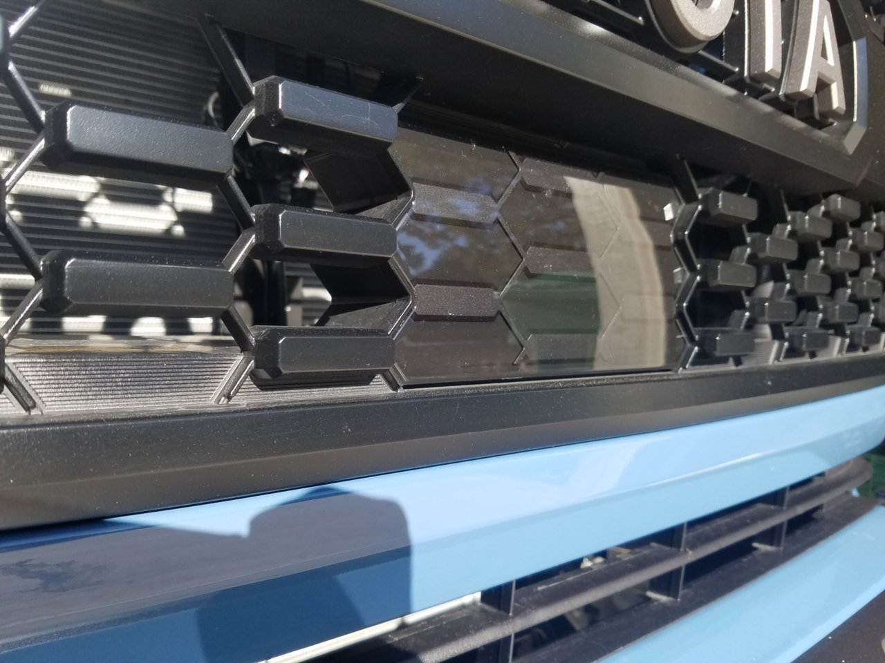

  5. May 30, 2019 at 5:22 PM
    ToolPac
    ToolPac Well-Known Member
    Apr 28, 2019
    #291602
    238
    Show Low, AZ
    2018 TRD Pro, 1998 TRD

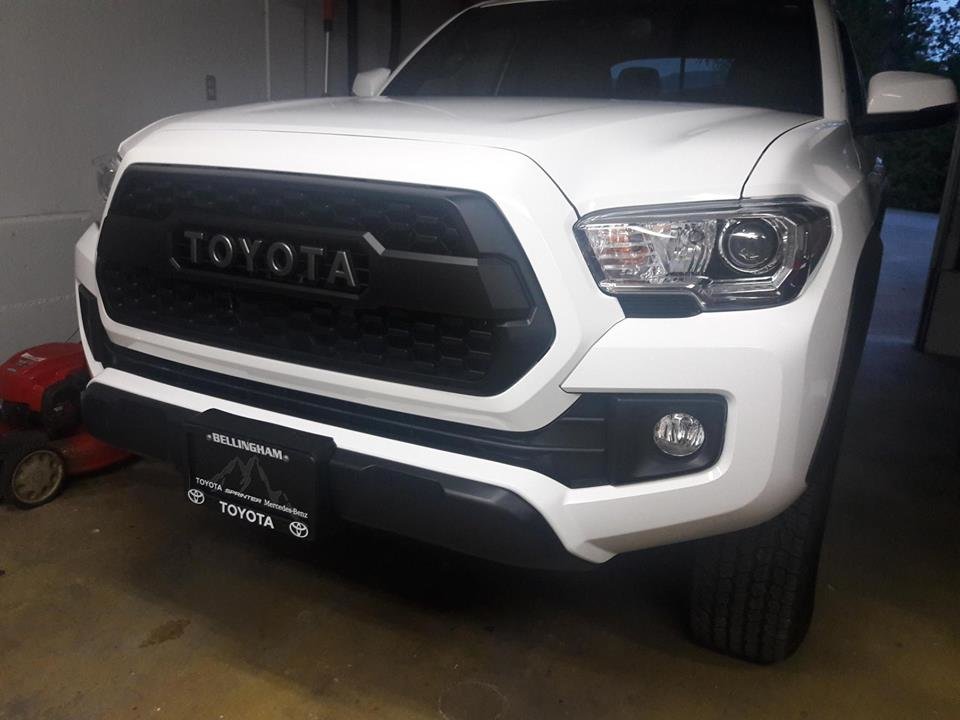

    KY_Rob[OP] and 71tattooguy like this.

  7. May 30, 2019 at 5:35 PM
    KY_Rob
    KY_Rob [OP] Well-Known Member
    Apr 11, 2019
    #289780
    809
    Rob
    North East Ohio
    2022 DCSB TRD-OR 6MT
    OEM: TRD Pro Grille & Garnish, TRD Pro Skid Plate, TRD Pro Rear Tail Lights, TRD Pro Shift Knob (MT), Tailgate Remote Lock, Black Chrome Exhaust Tip, Black Emblem Overlays, Bed Mat Vorra65 AC Drain Mod Kit FBC Harness Solutions (aka daveeasa) D-I-R Harness with Aux out Total Chaos Bed Stiffners Taco Garage Dashtop Multi-Mount MESO: Gashole, Total Tails Stg1, V5 Switchback Mirror Turn Signals, HitchPod + S1, Vent Rings AJT Designs: Radio Knobs, Door Handle Covers (Removed) Black Forest Industries Shift Knob for R8…using an adapter MountainHatch Tailgate Insert KTJO4x4 Drivers Side Grab Handle Cali Raised Catalytic Converter Shields BajaDesigns NextGen Squadron SAE Amber fogs Bilstein 6112 Front & 5160 Rear ICON Add-A-Leaf pack ICON Sway Bar Relocation Blocks ECGS Bushing 17” SEMA Gunmetal Gray Wheels with LT255/75R17 KO2’s Active Off-Road U-Bolt Flip Kit w/Timbren Bump Stops Redline Elite Hood Struts
    This! Right there, what you’ve got! Just like that! This is what I needed to see...and I think I know why...

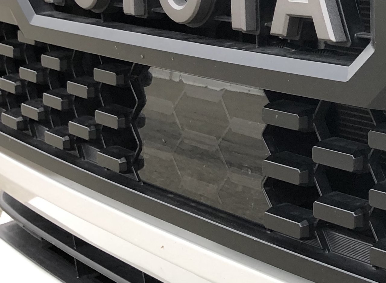

    When I got my garnish in the mail, I opened it up a bit hurriedly, and felt something snap. Turned out to be a wee thin little plastic tab at the top, right between the 2 pins that push through the top of the sensor pocket in the grille. Damned little tab was so thin, I was thinking it was possibly molding flash or something. I disregarded it, and went on about my business.
    It bothered the hell out of me, that the top of my garnish sat hugely recessed into the grille pocket, versus the bottom. In my mind it should at least be even, if not flush.
    I’m now thinking, that the irritating and far too small little tab, acts as a spacer against the top of the sensor, keeping the garnish even at the top and bottom.
    Thanks for posting the pic!

  9. May 30, 2019 at 5:41 PM
    ToolPac
    Apr 28, 2019
    #291602
    238
    Show Low, AZ
    That tab you're talking about actually has a slot in the grille that it slides into. Don't ask me why. It may serve to align it in some way but it can't really keep it flush because if you put it against the grille and not in its slot the garnish will be angled down.
    KY_Rob[OP] likes this.
  10. May 30, 2019 at 5:44 PM
    KY_Rob
    Apr 11, 2019
    #289780
    809
    Rob
    North East Ohio
    You’re right on all counts...I think it protrudes through the grille rests against the frame of the sensor itself.
  11. May 30, 2019 at 5:46 PM
    ToolPac
    Apr 28, 2019
    #291602
    238
    Show Low, AZ
    I only know these things because mine was missing the lock washers when I bought the truck. I took it back and told them how to fix it. That's how they gave it back to me. If I had it to do again I'd probably just use some rubber washers so I could adjust the angle better. Those things aren't coming off now though.

    @ToolPac here’s what I ended up with in 3 steps...pardon the photo quality, I know it sux, but it gets the point across. Initially added (3) 1/2OD x 1/4ID x 1/16 thick rubber washers over the top garnish studs. Ended up removing 1 from each side.
    This left enough room to get new Star lock nuts pressed on the back, and the garnish is pretty much flush. No TSS errors when I moved the struck into the garage to start working on the raptor lights (which is turning into a total Charlie Foxtrot, but that’s a different thread).

    Looks good. Now if the star washers hold on you'll be alright. It looks like they're just barely hanging on. I guess that's why mine had to be crooked.

    They are just barley hanging on. I’m going to pay attention to them for a while. The good thing about them, is the more force is applied, the harder they bite. I’m hopeful they won’t become an issue.
