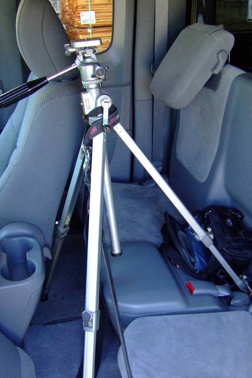

    Holy cow there 4W4B!!!:eek:
    You got (high riding) balls to go through 3 feet of water!
    And probably the diff breather mod too.
    I guess those 1/2 inch spacers did the job.;)
    I would love to see a video from the outside.
    PS: How did you mount your camera in the middle?

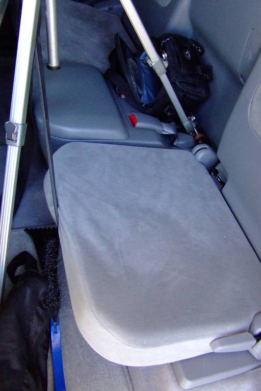

    No 1/2" spacers on mine Bill. Just the 885s.
    The camera is mounted on a tripod strapped under the rear seats & hooked to the outer hinges.

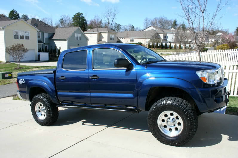

    886's, no top plate (obviously), Dakars - LR UCA, 285's.....
