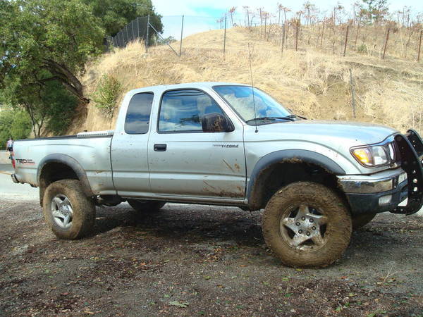

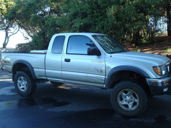

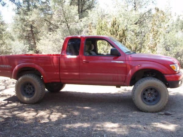

    Heres two pictures of mine. The rear is a revtek AAL with a 1'' lift shackle. In the first picture I have a revtek spacer lift and in the second I have 2.0 Sway-A-Way coilovers

    the revtek lift was $900 installed and aligned (I was uneducated and got ripped off). And I got the Sway-A-Ways for $600 installed myself. very easy install.

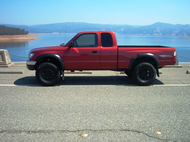

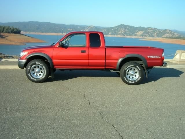

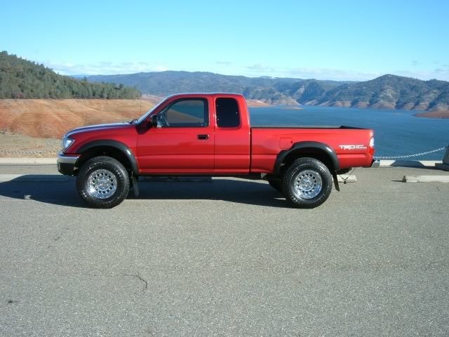

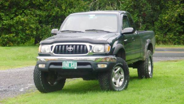

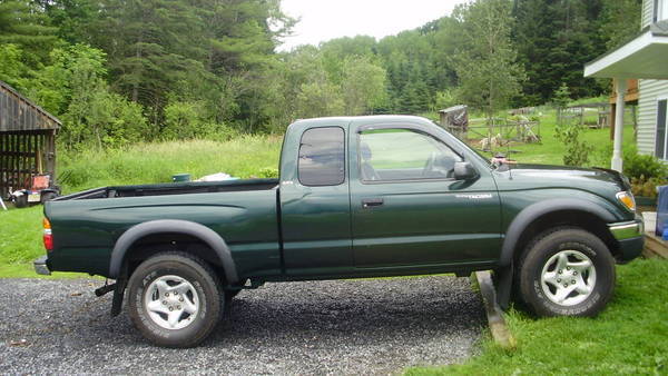

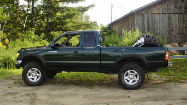

    Heres my 2.5 inch lift
    With 265/75/16 Tires and no lift:
    With 2.5 Inch Lift and 265/75/16 Tires:
    With 285/75/16 Tires:

    tacoman, how are your 285/75/16's fitting on your stock rims... do you have any rubbing on the frame or UCA??

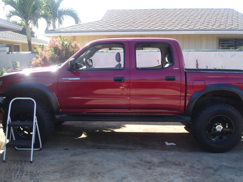

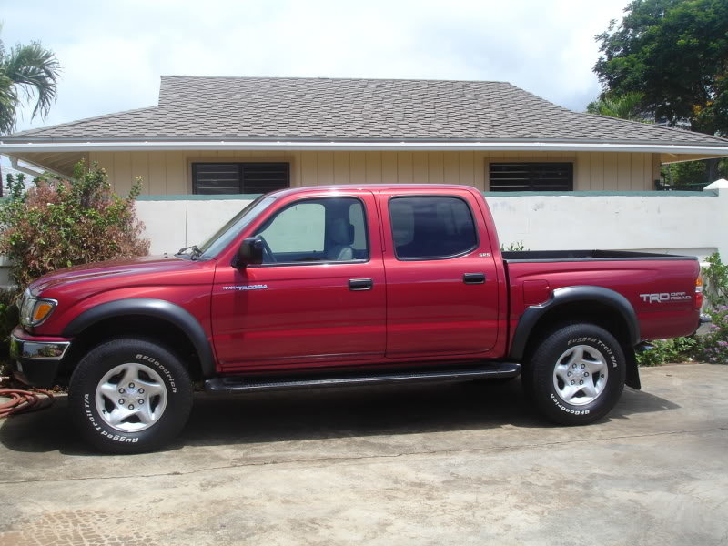

    STOCK:
    LIFTED:
    3" Fabtech lift coils in the front blocks in the back

    The 285/75/16 fit perfect on stock rims, they don't rub the UCA mainly becuase I have a 1/4" spacer in the front. I think you might be able to squeeze by without the spacer but it would be a tight fit. At full turn the tires rub a wee little bit on the frame, but it only happens when I park

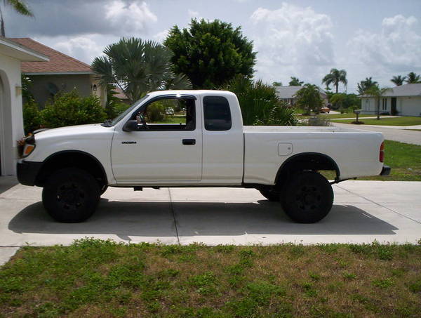

    Before... bone stock.
    After with a modest 2.5" lift using pro comp front spacers, and rear Skyjacker AAL's. Total cost $225 self installed. Also i have my original size "DONUTS for tires" 235/75/15's. I am going to 32/11.5/15's after Christmas.

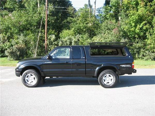

    Before. When I bought it.

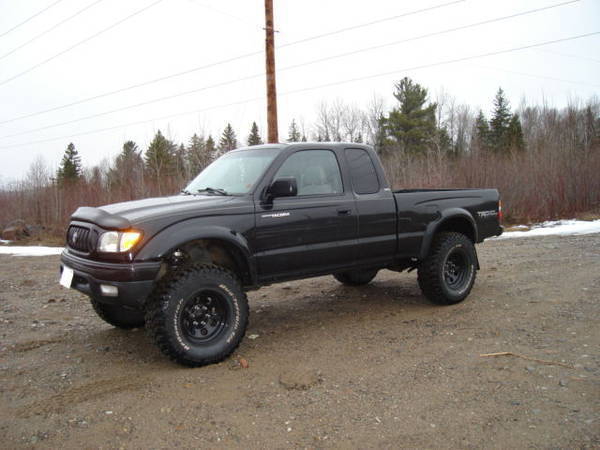

    After. Toytec ultimate lift. 305/70R-16 BFG MT's. I later made custom lift shackles for the rear to raise it about another inch. I also put on 285/75R/16 Firestone MT's. No decent pic at this time.

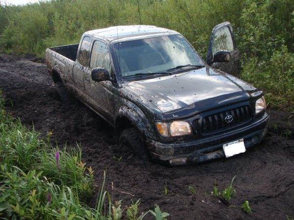

    After...After
    :D
