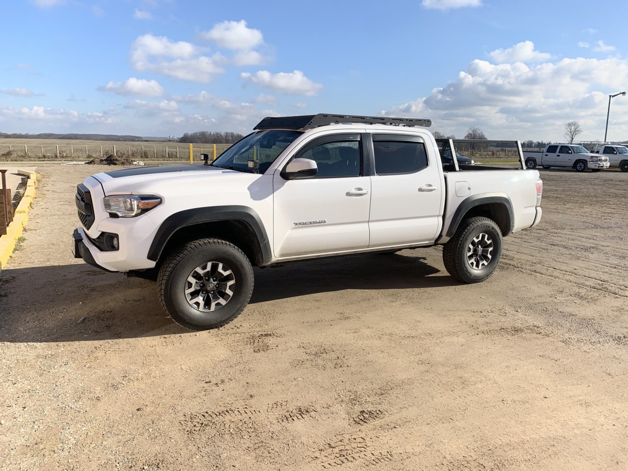

    Ok so I didnt install anything but....I did just order my Bilstein kit from Headstrong. 888 coils with ICON 3 leaf AAL. I myself have a 2017 Tacoma DCLB. Does anyone have a pic with the same kit here? Also is it possible to add the 3 leafs to my stock leaf pack or just to the overload? Thanks in advance

    Just finished installing the icon 3 leaf aal
    Took a bit longer than I anticipated but I did do it alone with hand tools.
    I will take pics I’m the am
    Had to cut one bracket off the stock leaf spring as per instructions and left the stock overload out.
    5100 in the front and 5160 with aal in rear 2.5” front- 1.5 “ rear
    265-75-16
    Do the ecgs bushing while you have the front end apart

    So mine is installed as well, but for sone reason I only got 2 in the front and 1 in the rear
